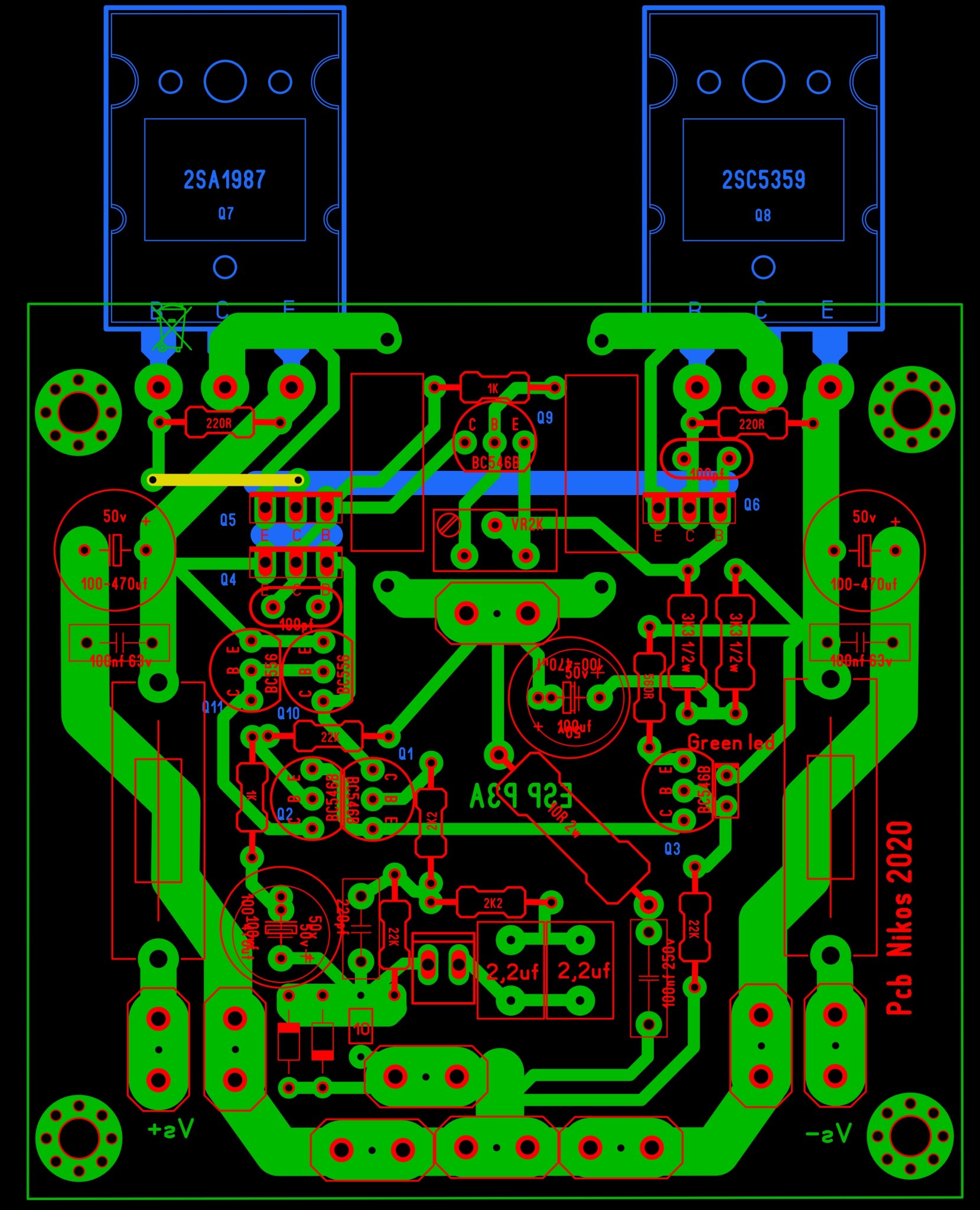

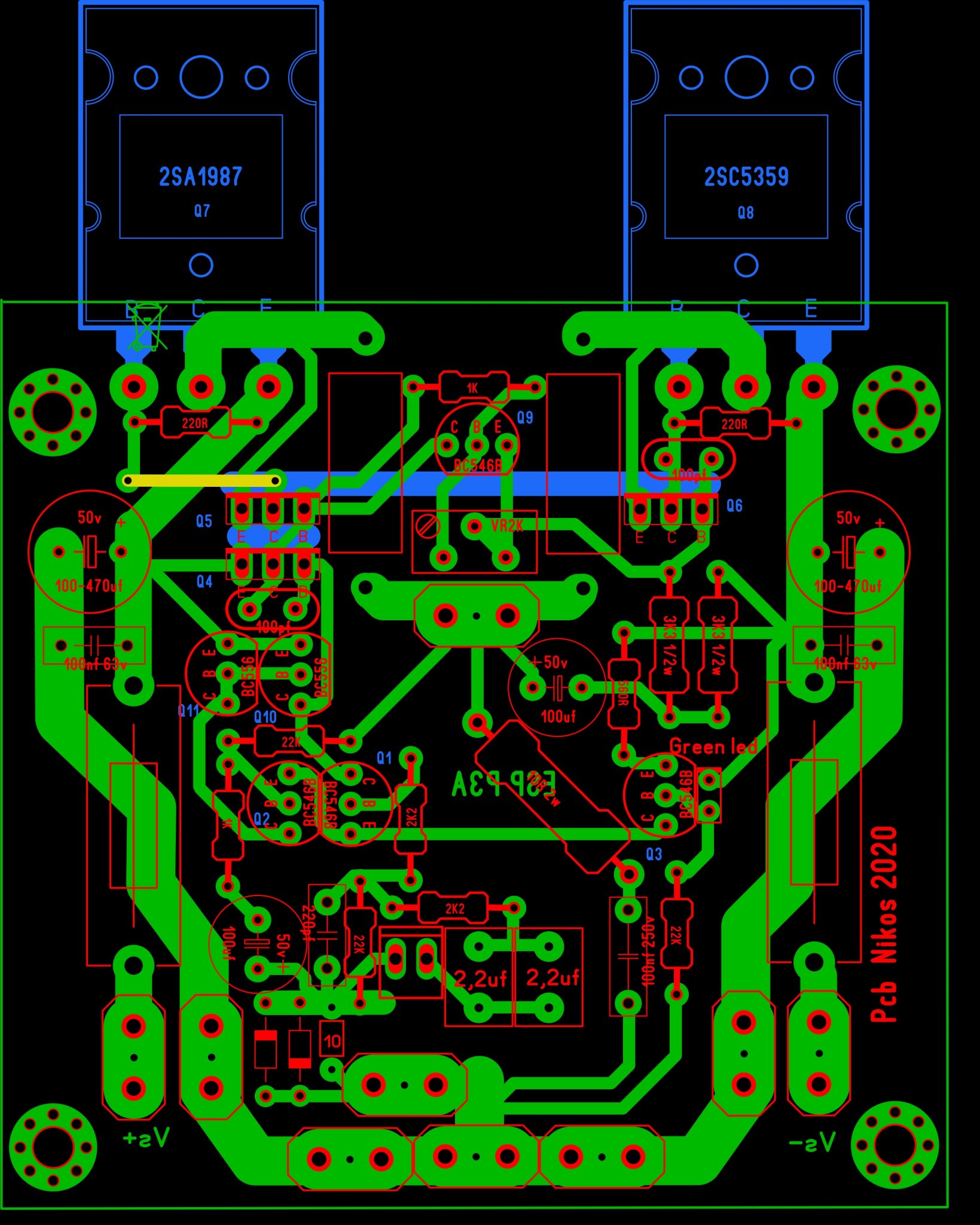

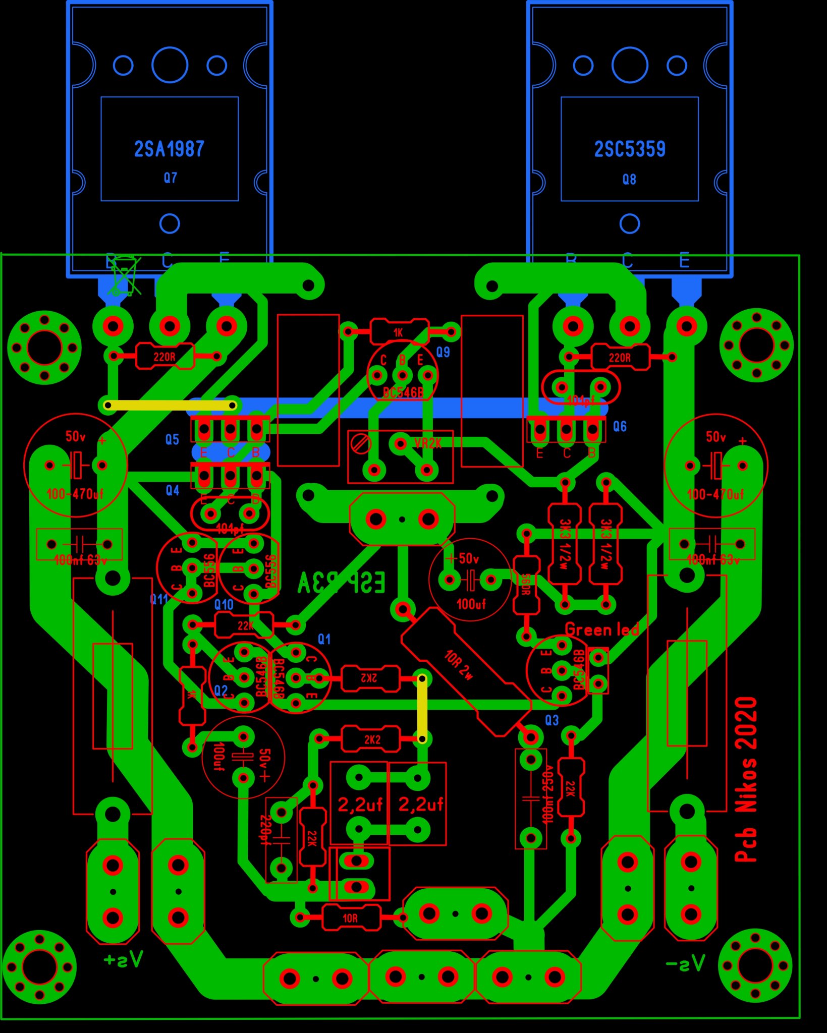

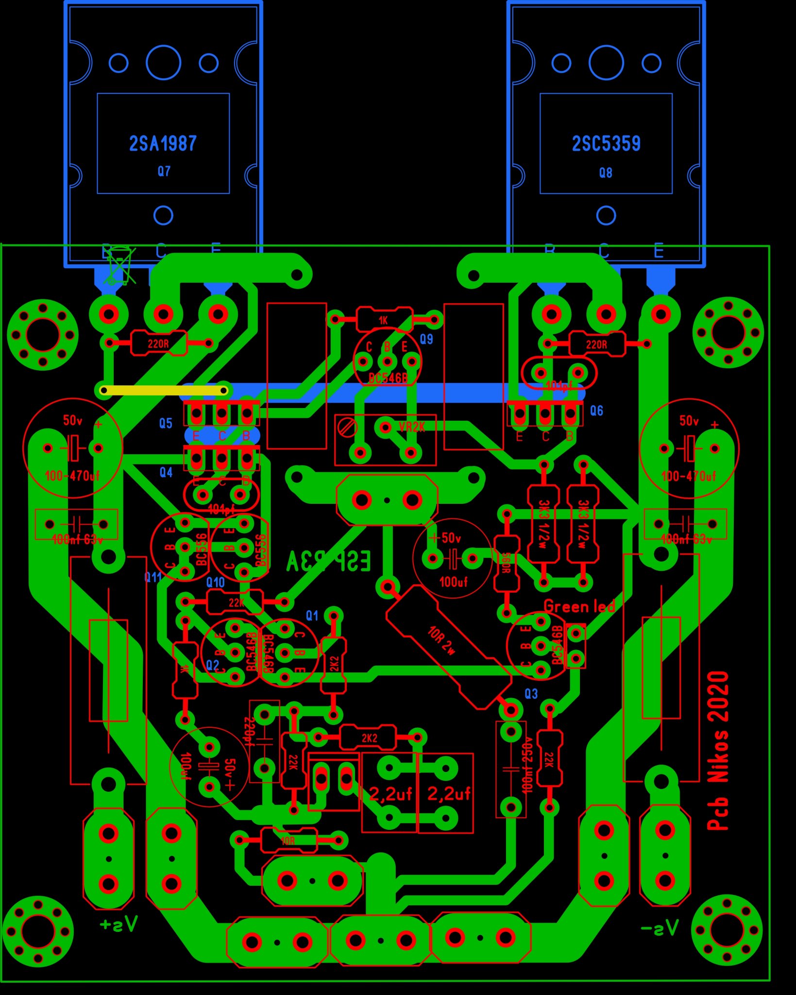

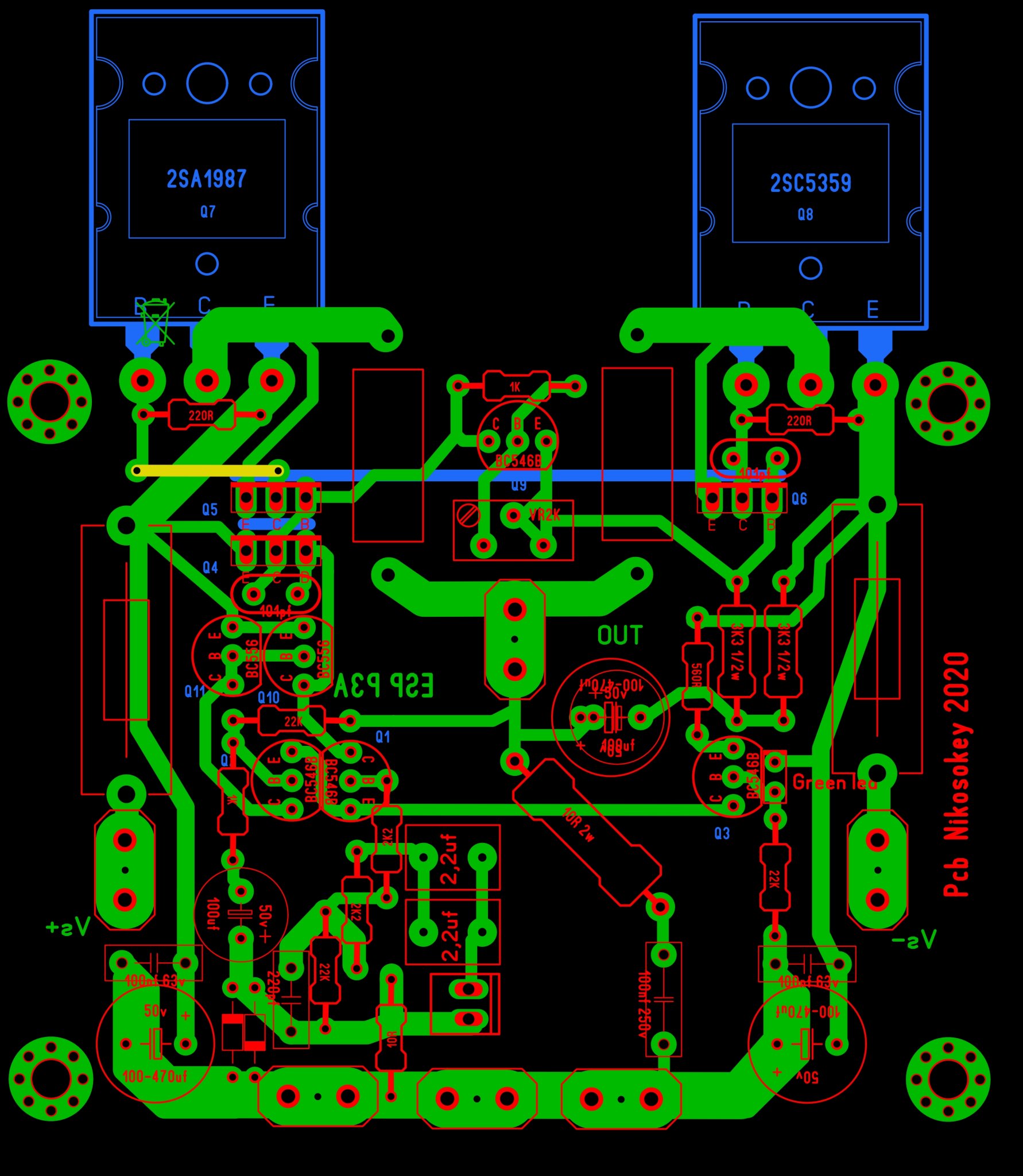

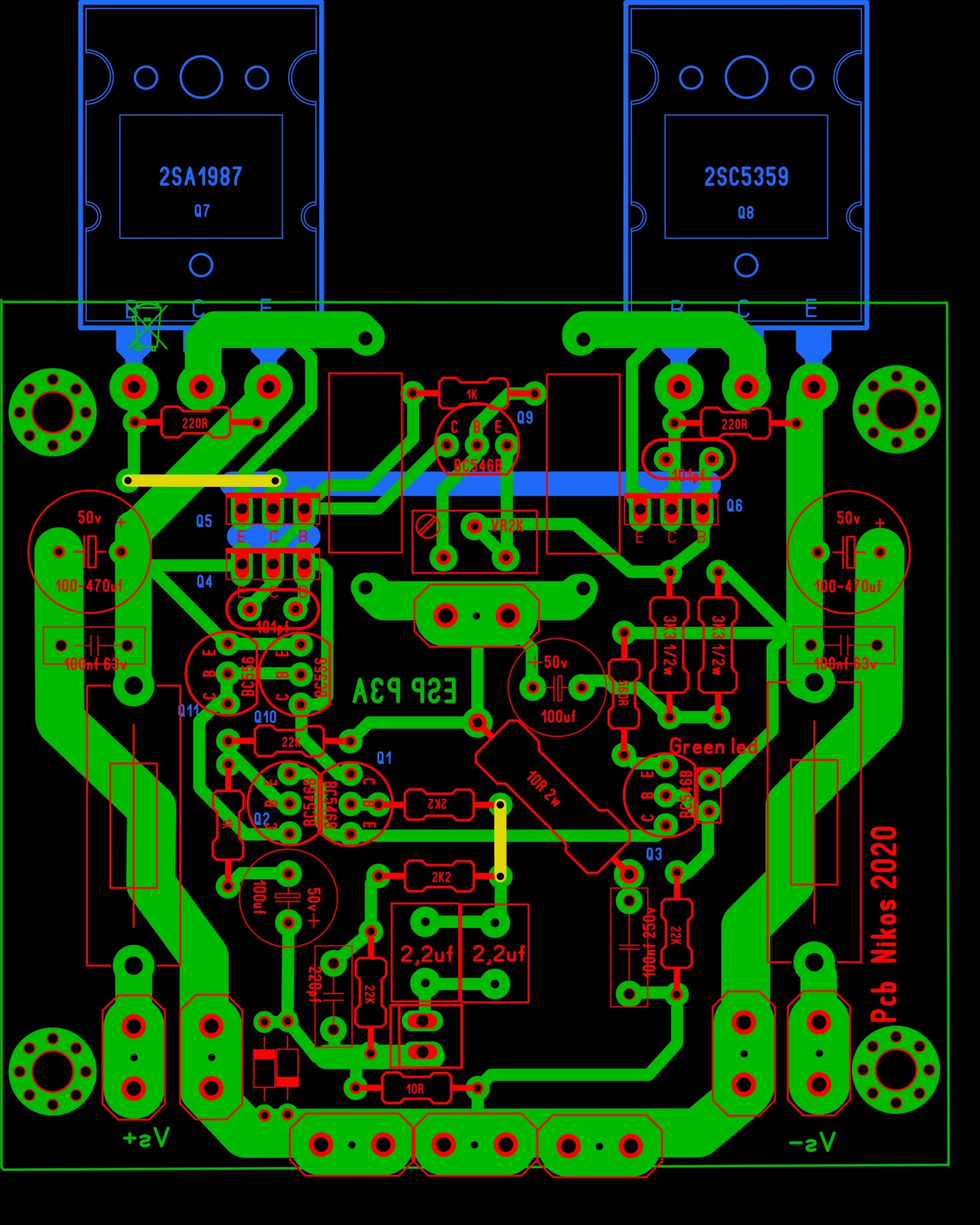

I made a full version, that looks like NAIM style (PSU - AMP - Speaker Protection / Delay) if you're interested @Carlos Pereira :
Australian technology... 🙂
@Stuey that's not the point, i made my PCB from scratch, it's an improved P3A, you can't say the opposite 😉

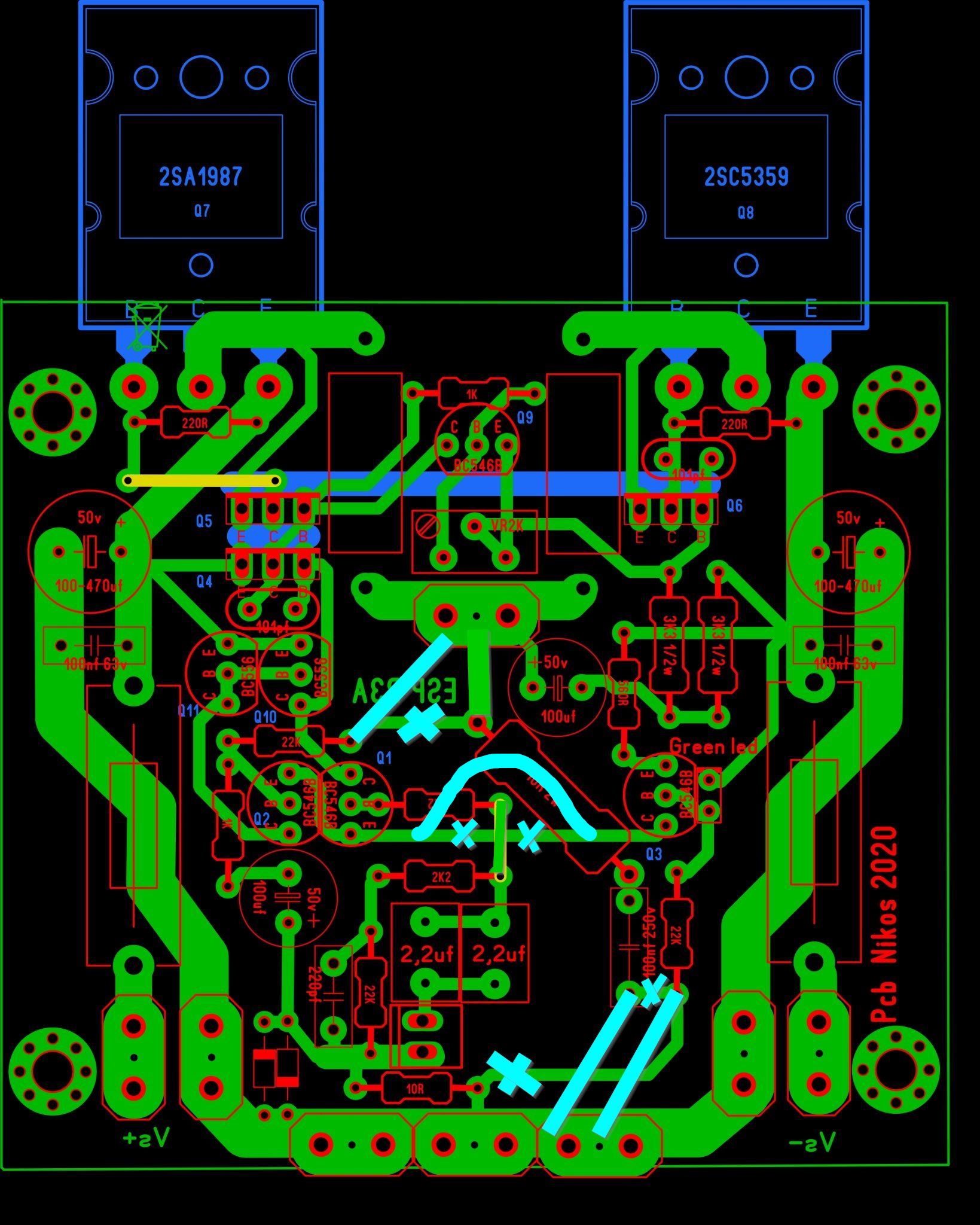

Super likeI made a full version, that looks like NAIM style (PSU - AMP - Speaker Protection / Delay) if you're interested @Carlos Pereira :

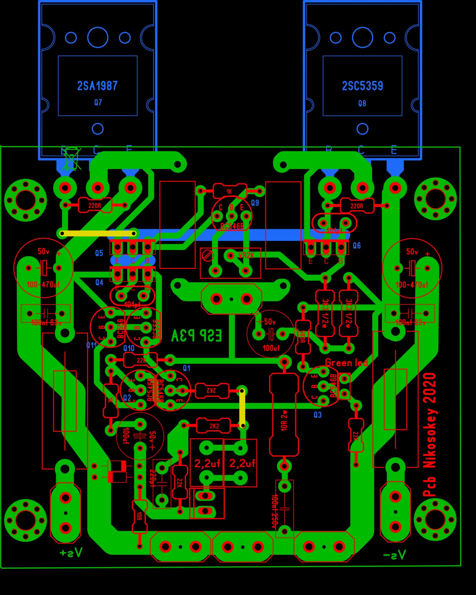

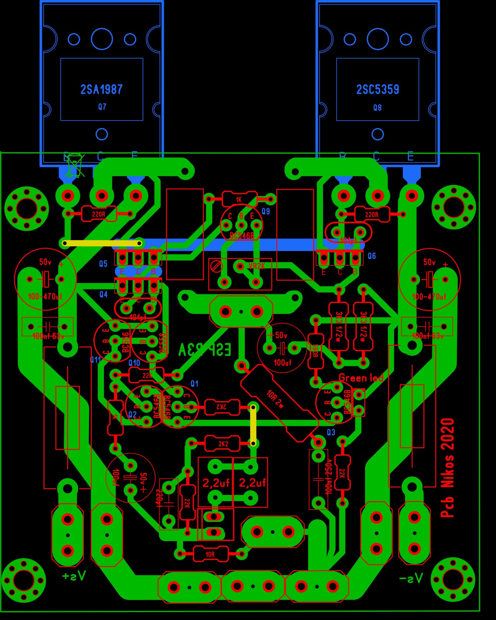

Nikos,

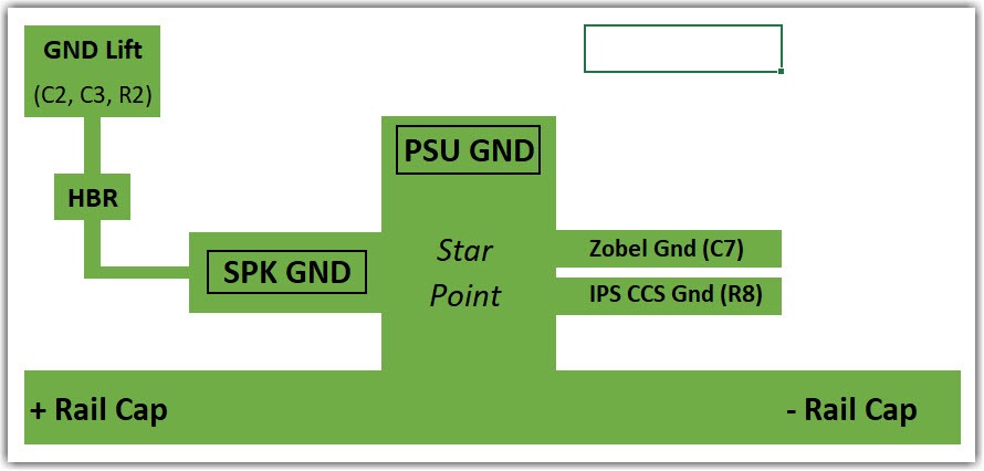

Do you have a schematic to accompany this? This doesn't appear to be the standard P3A. From a quick review I can see what appears to be a ground lift and current mirror on the IPS.
Two comments on the layout:
- I'd suggest a different ground layout for the 100u caps. The positive and negative caps should tie then join to the ground point. Any other ground connections would connect between this and the PSU ground connections (T grounding). As you have it layout out, the 22K CCS ground resistor connects to a leg of the "T", not after the center point. It will be subjected to large ground currents between the main caps.
- The main rail caps should ideally be close to the output devices. As you have it laid out, the caps are at the opposite end of the boards. I realize this is tricky to change with the layout you are using.
Those are good suggestions. Also, with a CFP output stage, the Vbe multiplier transistor (Q9) should be thermally coupled to one of the drivers to track their temp. You can it isolated. If you look at Rod's PCB's you can see that he has Q9 & Q5 next to each other. This allows the builder to use a zip tie to bond them together.

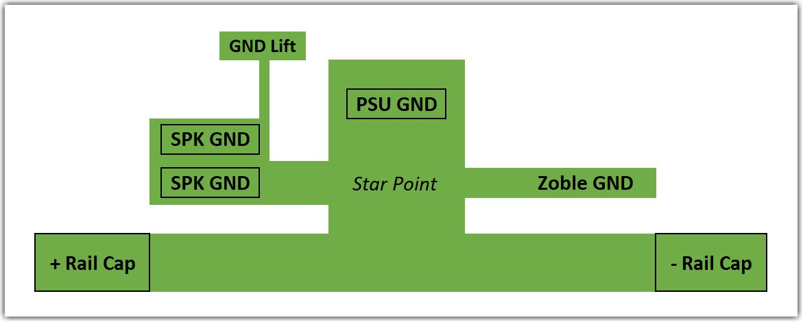

If you want to improve the grounding further, here's a quick drawing showing how to use the "T" grounding approach with a star point. This is the same grounding architecture the Wolverine Amp uses.
This approach allows the heavy currents from the rail caps to converge and resolve before flowing to the return.
The Wolverine team also found that tying the ground lift to the speaker ground and allowing that to resolve before joining the star point produced better results.
Forgot to mention, I would suggest that the input and feedback use the ground lift (Signal Ground, C2, R2 and C3) and the CCS ground (R8) and Zobel (C7) go to the star point.
I mention this because the IPS CCS ground going to the star point is not explicitly show in my drawing in Post 33.
