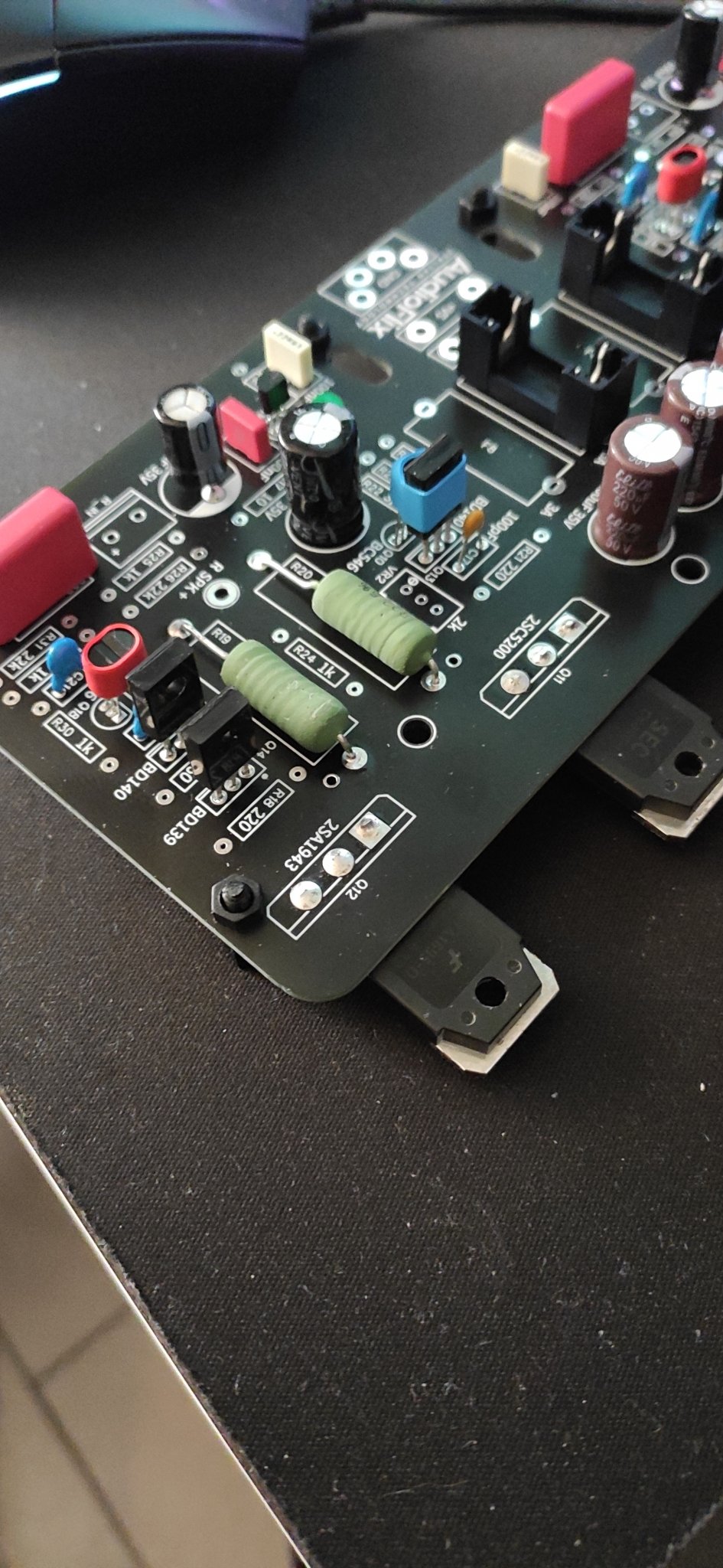

Well after hours, right channel gone.

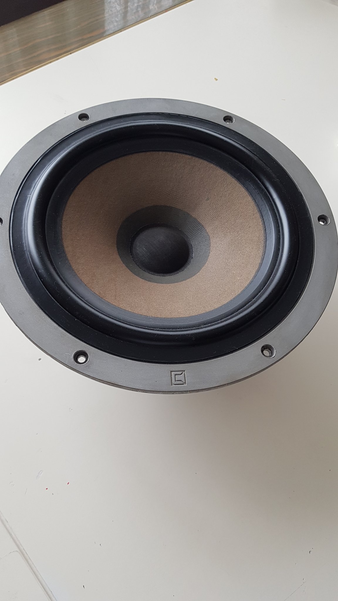

Bass driver is gone, one coil is gone. other drivers and xover parts are ok.
So don't use this driver&output combo.

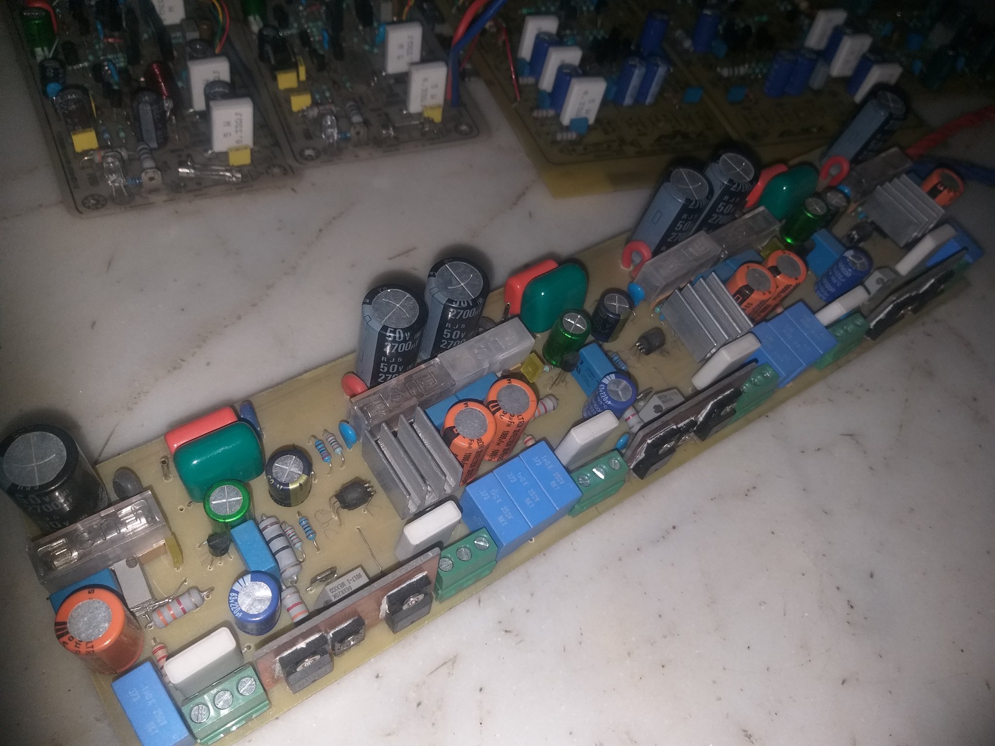

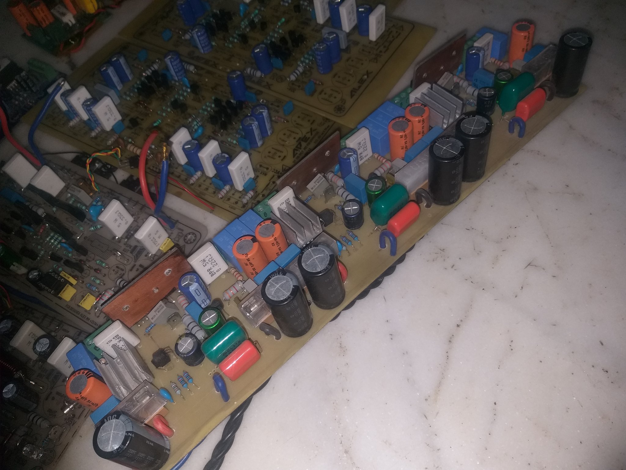

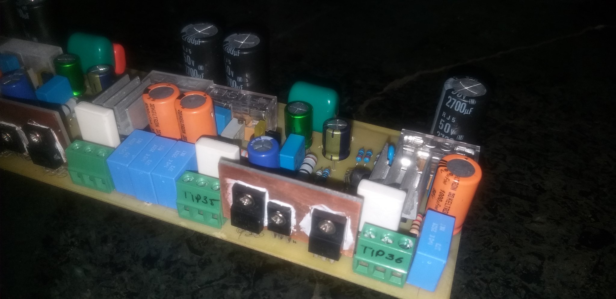

I already build a P3A amplifier.
Here is the pictures
I just love to build new project and then move on to new project, it's fun doing this audio amplifier stuff, I do it only for fun.
No commercial activity.
