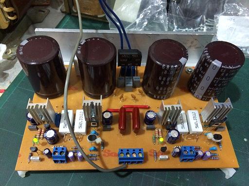

So i was ordered to complete one LJM AUDIO L10 amplifier for a client configured as dual mono with 2* 500W 36+36 AC trafos 2*15.000uf per ch .
The schematic is well known, client got only PCB i had to install the parts All semis are original and measured and selected by hand for parameters and outputs was the Last version of 1302 and 3281 where the PNP is no longer green but black and i got them from qsc as standard transistor installed in the PLX amplifiers they made ... Drivers are 1930 and 5171....Miller compensation where ever needed according to the schematic are syroflex MIAL at 630V.
Project was completed client wanted 50ma per transistor ofset was 12 mv for one Ch 16 for the other
So i decided to keep it for a week in my house to listen to it to make a detailed listening
I listen to EFP amplifiers every day in my shop after those are finished repairs but for the latest 15 years my listening is P3A both in the shop and in my home ....In the shop amplifier plays from 10.00 in the morning till 9.00 in the night at home is 5-10 hours per week .
L 10 produced 200 clean Watt before clipping almost 3 times the power of my P3A...trully i never heard the my Visatons play like that ... Obviously those can handle the power easy and remain clean and with low distortion almost at any level....Very very impressive !!!!
The first impression of the the EFP is that things are in order ...meaning that instruments give impression that are descrete and the boundaries of each instrument is very sharp ... compared to a P3A i could say easilly 10-15% percent more sharpness.
The low and had a bit of punch more .... bass was at least 10-15% more tight than the P3A .... that in the beginning sounded diferent the punch was impressive to begin with, but after the first impression and a more detailed listening a realised that the bass was Less than the P3A.... Not especially less ( i dont know if i can describe that correctly remember English is not my native language )
If you have a song that has a kikc drum then yes the diference in kick/punch is imidiatelly noticable , but when the bass joins in in lower frequencies it seems there that L10 is not that live .... Indeed copaired to a P3A where the bass is far more rich and extensive to more lower frequencies but then the bass appears a bit wably and lets say that when very low frequencies flood the program it appears that you loose control .

One is constantly playing in my shop two more are installed in my house
through the years there have been loads of variations , various set ups and enlosures as integrated or as a pre and main combo
many pcb many power supplies small variations in the circuit and mixmatching of parts
Bottom line is that the basic circuit is the same as the original and outputs always 1302-3281....and most of the times with standard bias of 75ma
Latest version is dual mono amplifier not integrated it has a preamp P37 X6 gain behind ,Phono stage included (as described a few posts before that)
Driven of 43+43 rails it produces almost 85W at 8 R .....
IT drives a pair of VISATONS which are made with 2*8" Woofer 2*3.5" mIDS +one Tweeter front bass reflex obviously at 4R
Now i know very well that this trully on the risky side but since its for home use and hardly ever pushed hard i took my chance and for 2 years is working flawless ....
