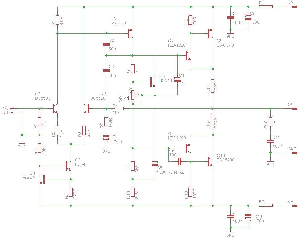

Nikos,
I would like to see results concerning your build of P3A in this thread.
While we patiently wait for Nikosokey to repost his P3A I thought I'd share my experiences.
Well this is one of the first amplifiers I built, and for some reason I just can't stop tinkering with it. I'd conservatively estimate that over the past year, I've experimented with over a hundred different component substitutions in the quest for something different.
What I love about Rod's design is that it's so simple, yet produces very good sonics, and can be modified for even better performance.
For me the heart of the design is the bootstrapped voltage amplifier, and of course Rod's compound pair output stage. I've found that the best performance gain comes from simply substituting a better VAS transistor, reducing the miller cap and adding a phase lead.
Small input degeneration resistors seem to add some small refinement to the sound, without changing the sonic signature. This was most apparent when tested with the low noise & high gain BC550C LTP transistors shown. The added advantage of these degen resistors is that it make it trivial to balance the collectors by fine-tuning R4. I've tried adding a current mirror (with and without degeneration) - no difference in sound.
A high quality bootstrap cap is beneficial; I currently use a Nichicon KZ with excellent results. I've tried replacing it with an active current source, but prefer the sound with a good bootstrap cap.
I only listen to modern, digital sources, therefore, some of the other component values have been recalculated for a Low Impedance design.
The input filter shown is representative of my PCB design and a simplification of Rod's schematic. I don't advocate DC coupling per se., however my preamplifier (B1 buffer) has an output coupling cap so I've omitted the input cap on my PCB. HPF caps (when fitted) are soldered directly to the RCA connectors.
The circuit can be improved further but not without adding complexity. I like this version because its simple and still sounds like a P3A
