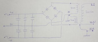

The silicon does seem to be a better idea as opposed to hot glue so I'll go with that, and I'll keep the filter caps simply as is for now and make them CRCRC at a later date.
This is the layout I'll use which will feed both channels,- initially.
Now, do I connect the * point to the chassis or don't I? I guess I'll try both ways and check for hum.

It seems funny continuing with another build here in the comparison thread if you agree with Kimbo's post. Anyways, why not use ESP's recommended design PSU, P04? It adds a ground lift circuit to reduce the likelihood of hum with DIY builds.

Royv,
it is much more important to keep the loop area of the secondary to first pair of smoothing caps as small as possible.
Similarly you must keep the loop area of the primary cabling as small as possible.
Once that is achieved, look to see how you can make the audio ground to Chassis connection, without disturbing the low loop area of the charging circuit.
You can adopt the Disconnecting Network (DN), but save that until you have tested the build without a Chassis.
Only assemble inside the Chassis after you have worked out how to fold the linear bench top layout into a package that fits the case and then tested it on the bench in that folded shape.
When you finally get to add the safety connection using the DN, add the optional switch in parallel to the other paralleled DN components.
Switch closed =direct connection
Switch open = DN in chassis connection.
test it using a temporary DN.
You may find that the direct connection works quietly.
If this is the case, then the temporary DN goes back on the shelf ready to test the next build.
