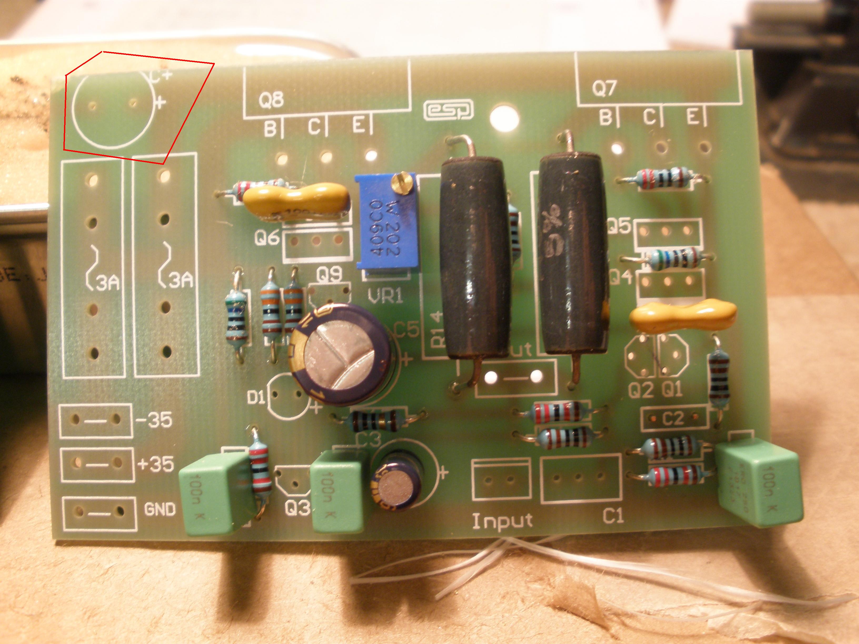

Is this a copy from original Elliot's pcb?Hey guy's
I'm currently fitting the transistors and have Q5 and Q6 on a common heat sink.
Does Q4 need to be on a heat sink too?

Hi Folks,
Yes, they are original PCB's purchased from the Rodd Elliot web site. I have split them because at a later point in time I'm hoping to go dual mono by adding a second transformer, rectifiers and capacitance.
And yes, I have also trimmed the top of the PCB's as I want to mount them close to the heatsinks with the outputs standing up.

Hi Mr Thimios, - The cap you highlighted on my PCB is a PSU decoupling cap which is shared between the two boards. So with splitting them I will be placing a +ve and -ve decoupling cap to each PCB where the fuses go. The fuses will be off board.

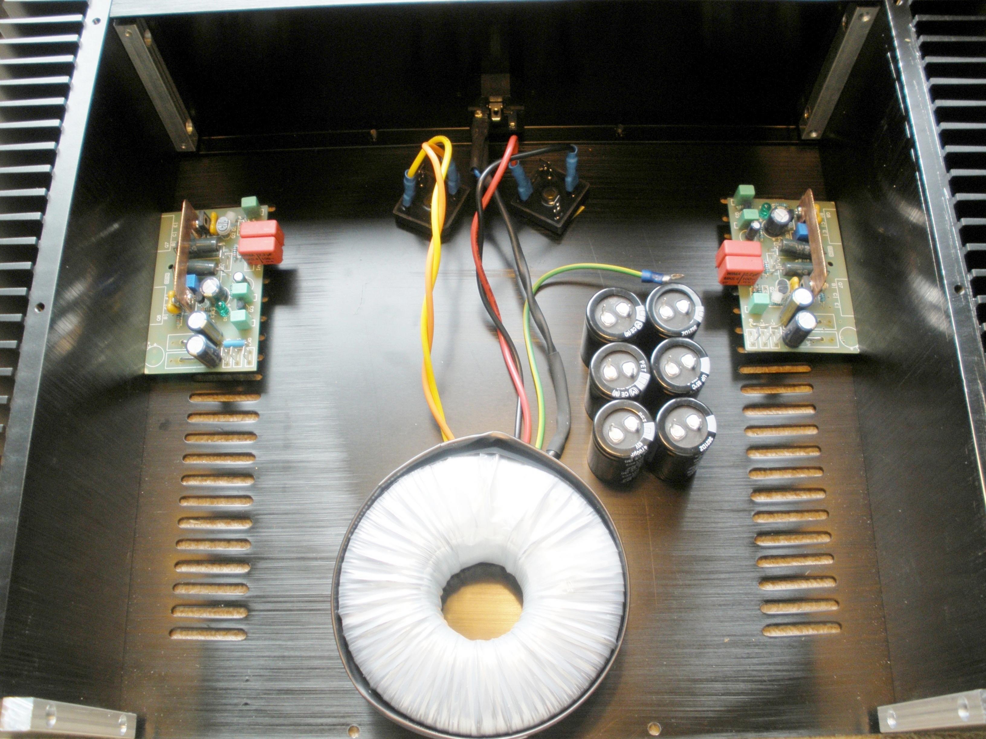

Yes i believe that the right way isn't cutting the board because this piece of board is useful for heat sensing from out transistors to Vbe multiplier
Absolutely. This isn't an EF (emitter follower) output stage amplifier - it's a CFP design and the most appropriate temperature range for bias control is sensed at the driver stage. Note how close Q9 and Q6 are located. That is all the coupling you need with Rod's ESP board, just like it was designed. 🙂The heat sensor om a P3A is to the driver transistors. NOT to the PCB !

Phew!
So I havent bol***ed it all up then! - thats good to know.🙂

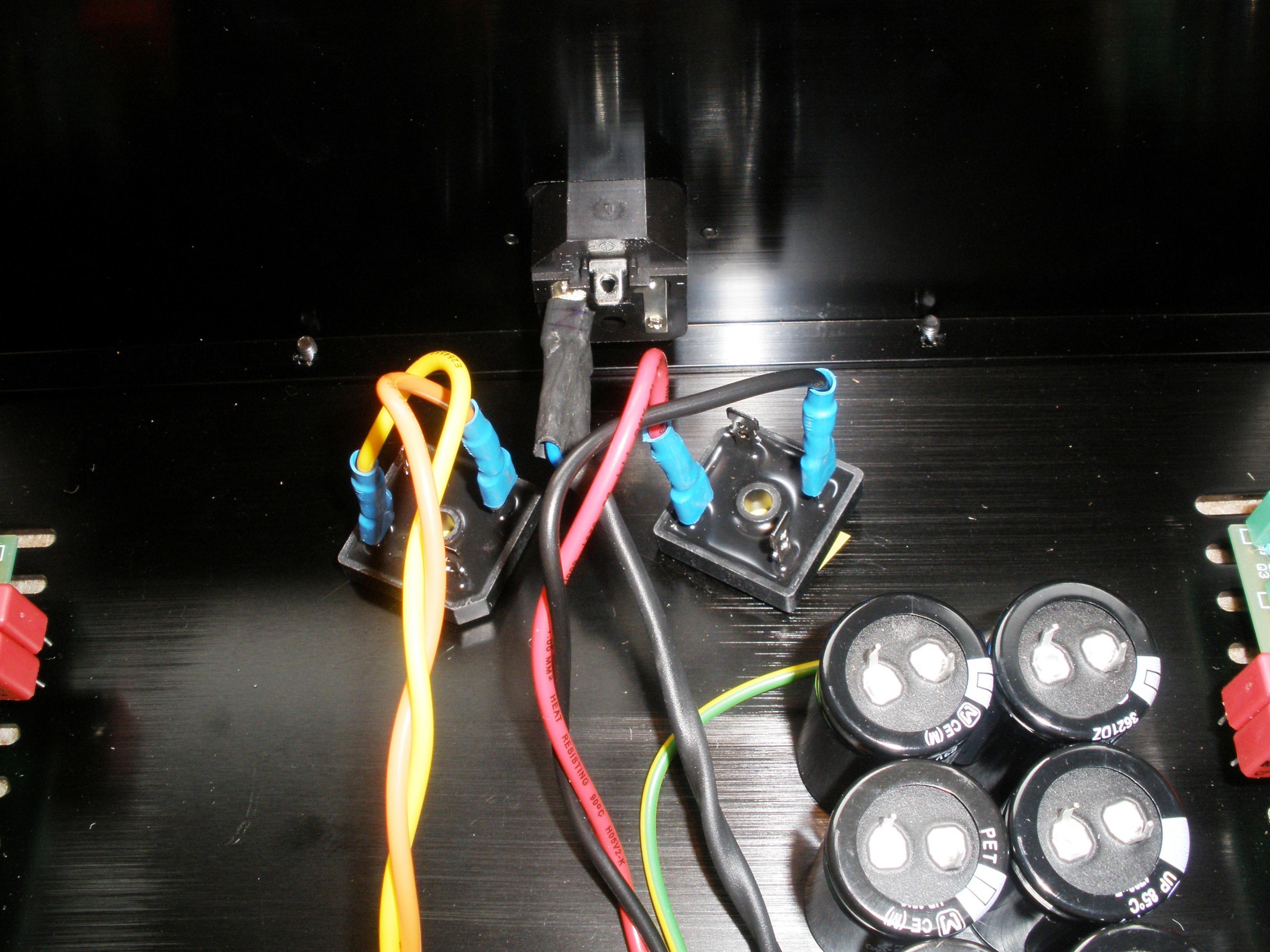

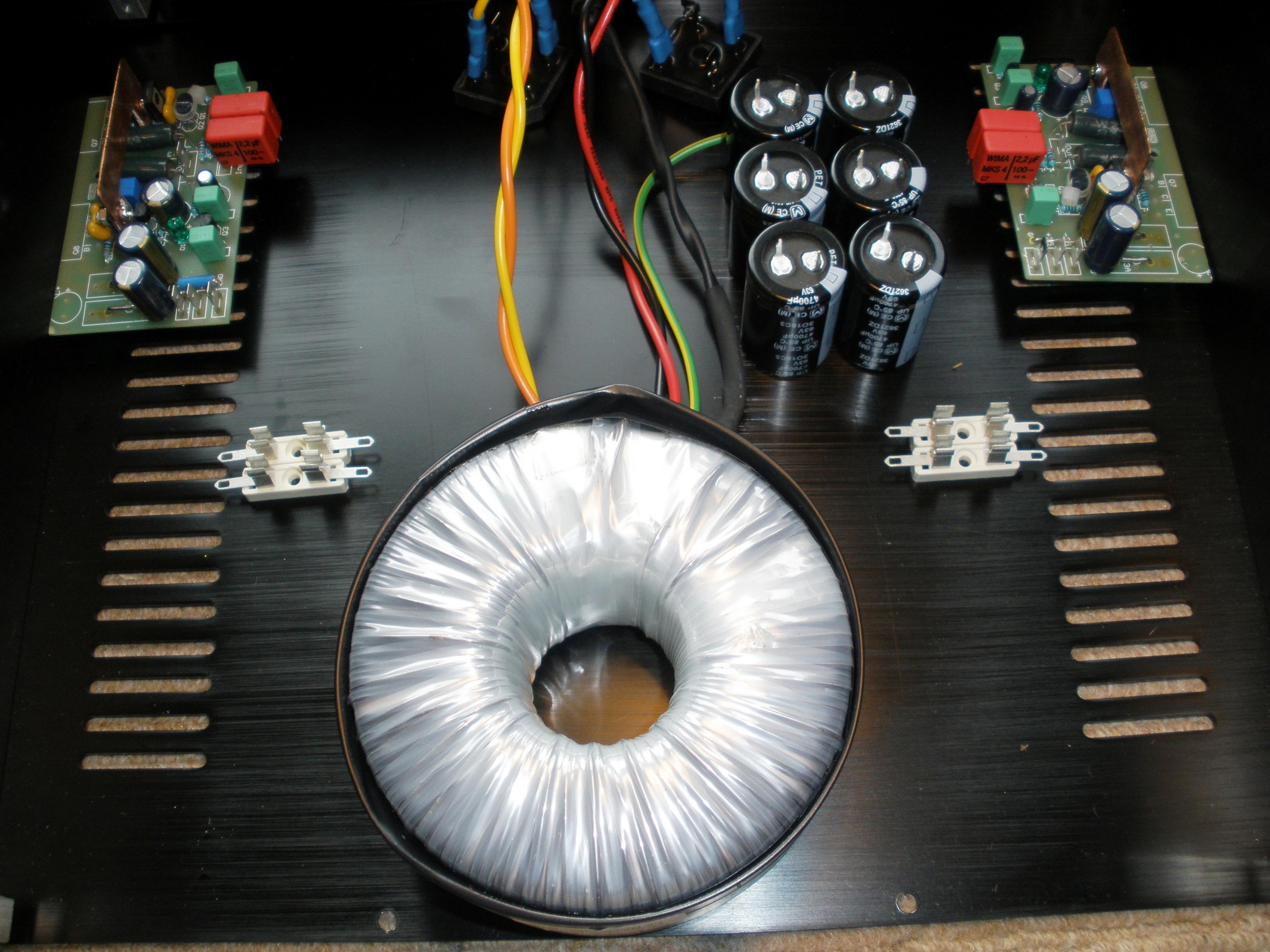

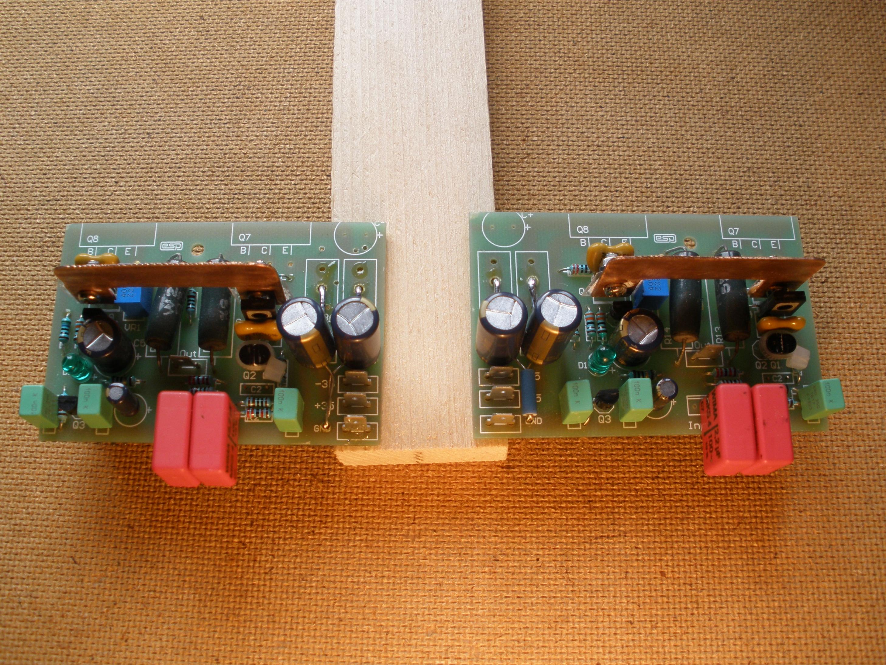

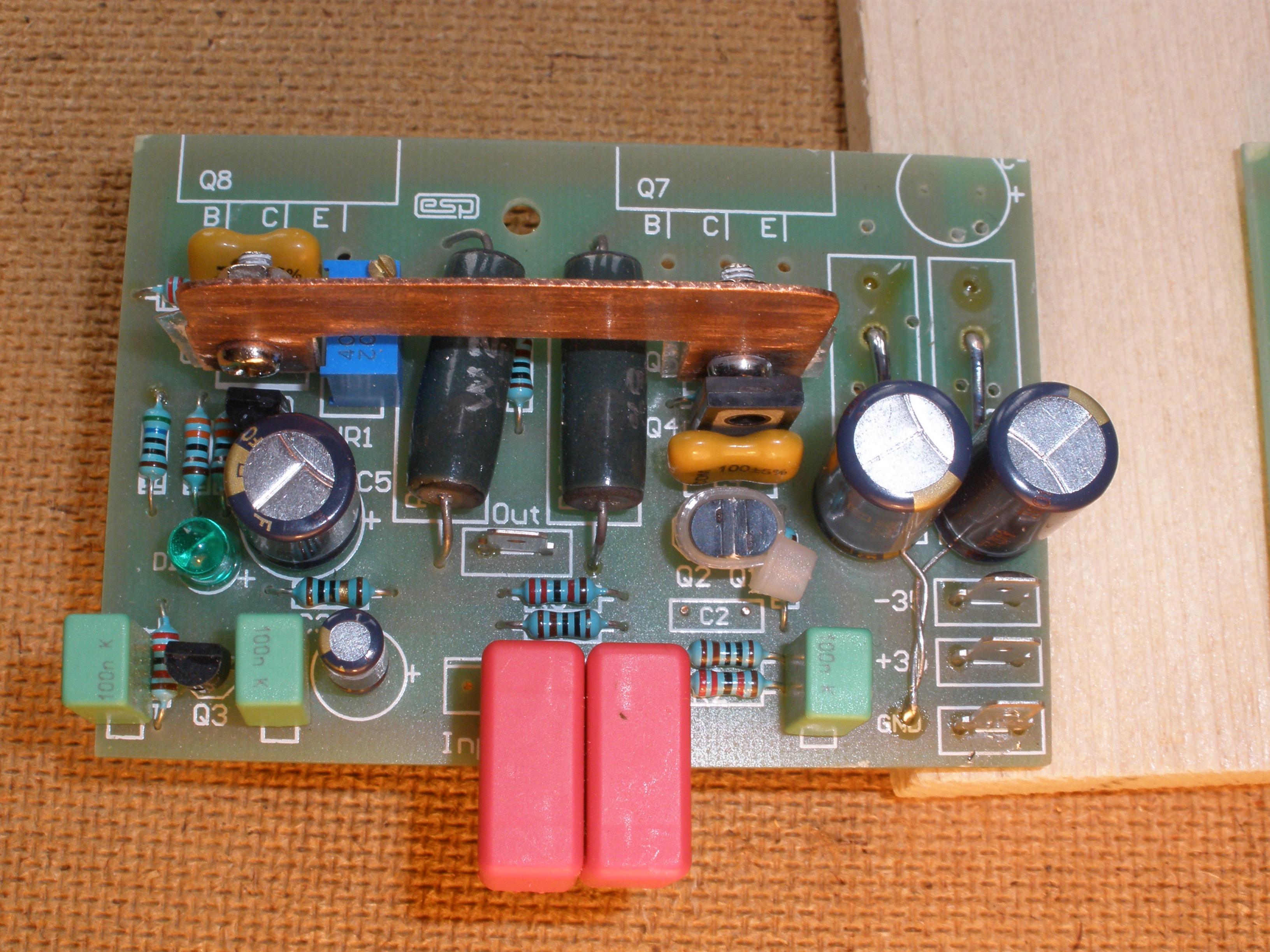

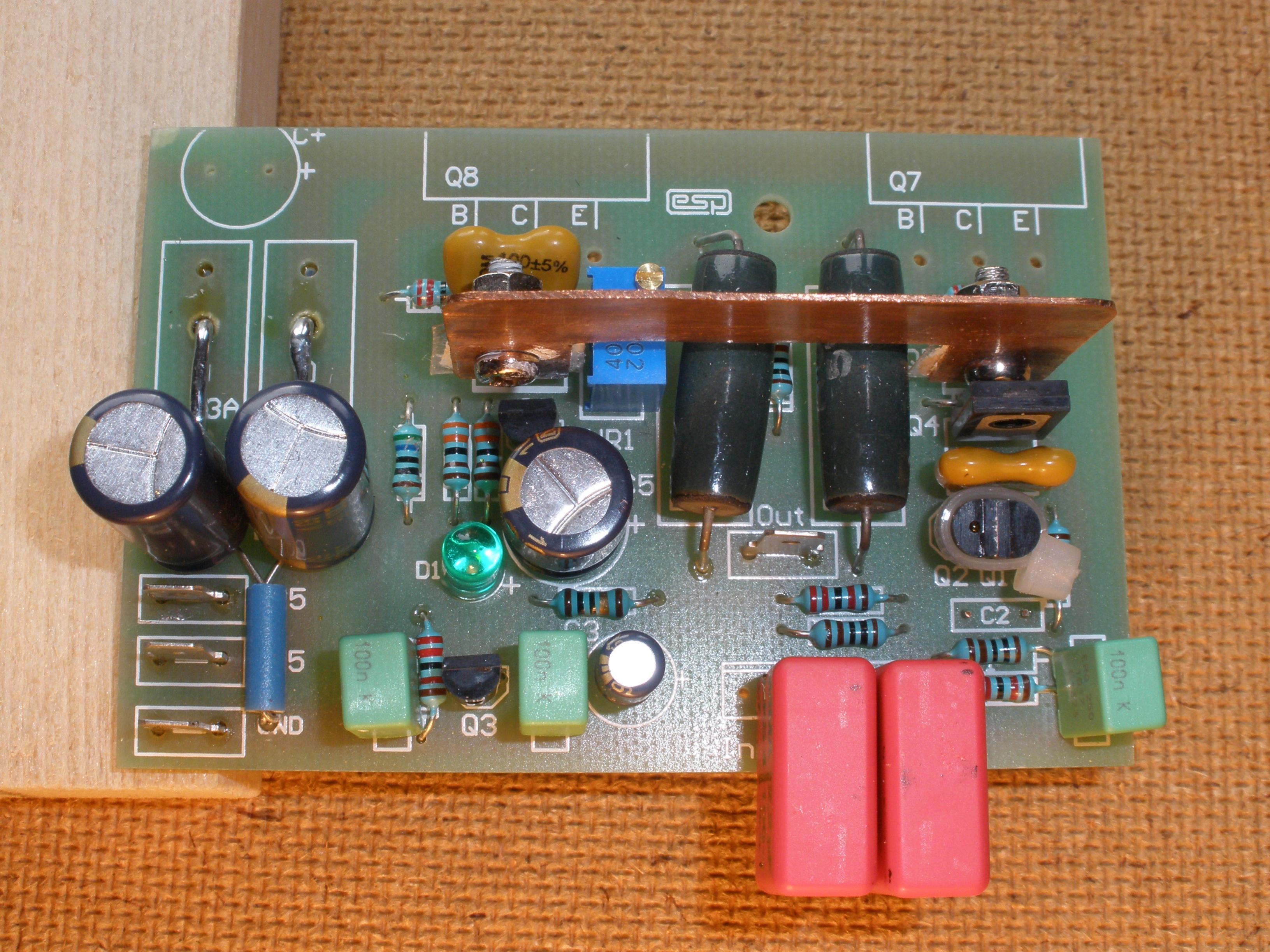

Hi All,
Here's some more pictures showing my progress. Not the prettiest of builds I'm sure but hopefully okay. Boards are complete now apart from the outputs and I am ready to build it all into the case. Trouble is, I'm not really sure about how to lay it all out. I was thinking about making it dual mono once I knew it worked okay. But now I'm wondering if having two transformers would really make that much difference. Could I have just have one tx feeding two sets of rectifiers and capacitor banks (one for each board)?
Any way I'd be grateful if you could have a look over my boards and let me know if there's anything amiss.
Also, does it seem okay the way its laid out, or is there a better way?
