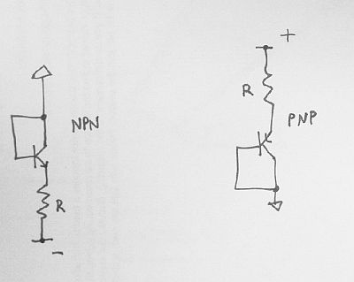

Hi Andrew, do you have a circuit for 'a little test jig' that I could use?
or I could use this one perhaps... Transistor_matching, - would this be suitable?

I would not test them using that jig.
Base is shorted to Collector.
That results in Vce = Vbe. Very few circuits operate that way, Vce >>> Vbe
You can't measure base current.
But the corollary is that the Vbe of both DUT and REF is identical.
That is very important to revealing the difference or similarity of the collector current.
How do you set the collector current to match the current when in the final circuit?

I'm not sure you need to do any matching, but generally I read that matching the LTP devices can help minimize dc-offset and reduce distortion. However, it probably does more to reduce 2nd harmonic than most anything else and some 2nd harmonic distortion isn't likely to be an issue.
Anyhow, I don't see an issue using the simple approach to matching - Andrew has perhaps more experience than I but what I've done in the past is
1) hfe (base input impedance): use an old DMM to measure the hfe/beta of the transistors and try to select pairs that are reasonably close - implies they will have similar impedance into the base (helps with dc offset too). Out of a large sample of transistors (PNP and NPN) I found they were all very close except for one part - so if you don't have a meter handy it might not be anything to bother with.
2) Vbe (nominal turn-on voltage): The idea of connecting base to collector would seem reasonable to me - i.e. good enough, for matching Vbe (Nelson uses this approach to match MOSFETs by the way and he has much more experience than I do). I would use the circuit shown attached. You size the resistor R so that you get a current flow through the device that is close to that in the final application. So if you were aiming for 1mA and had a 9V battery for your supply then you have a voltage across R of 9V less the 'diode drop' across the transistor so you want R is approx = (9-0.65)/1 kOhms, i.e. around 8k2 standard value. Then measure the voltage between the base and ground to get the Vbe of interest.

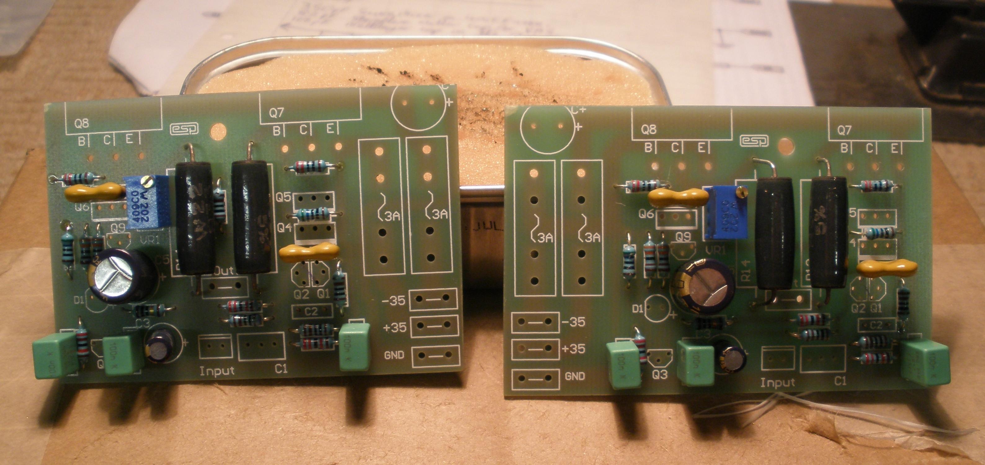

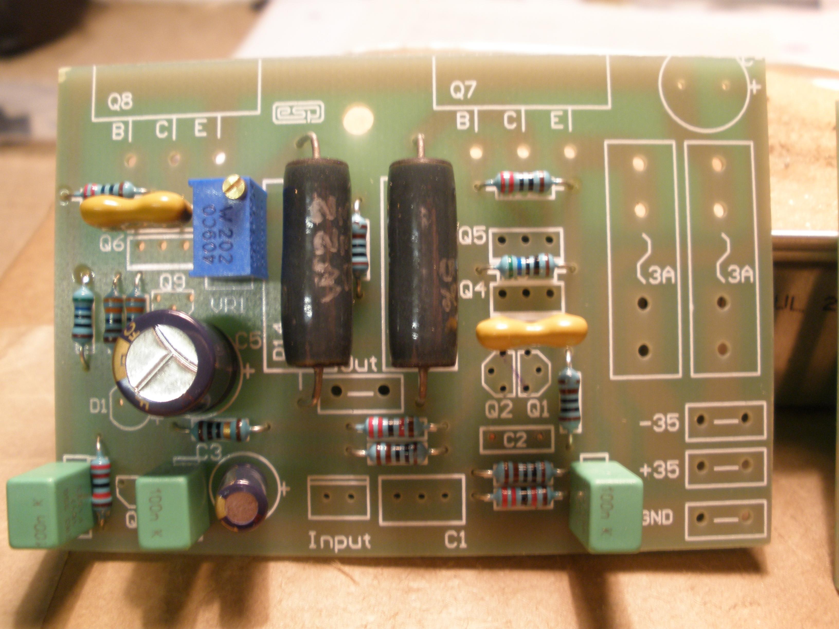

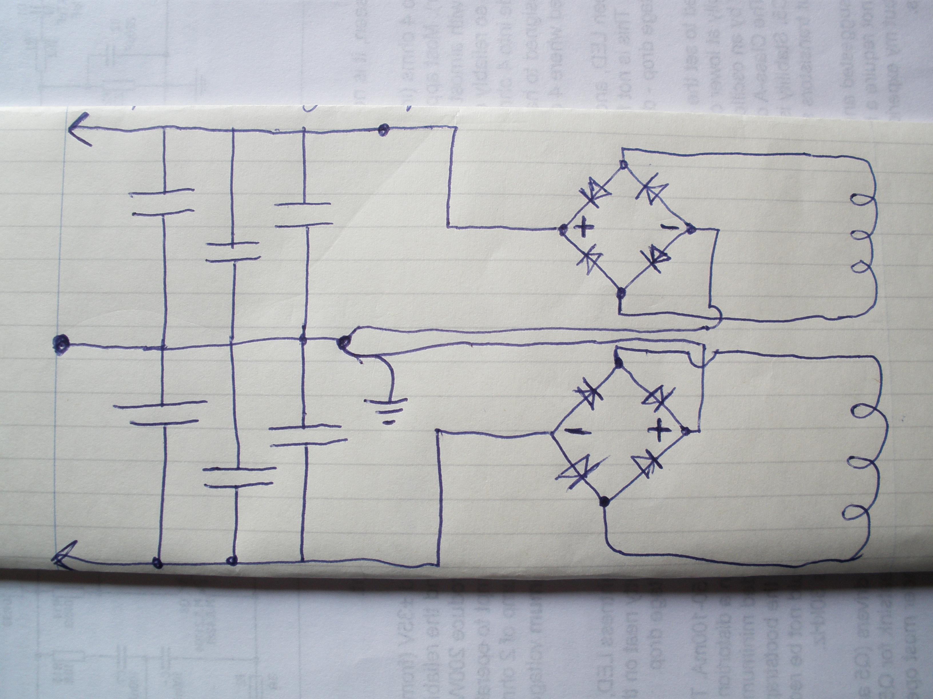

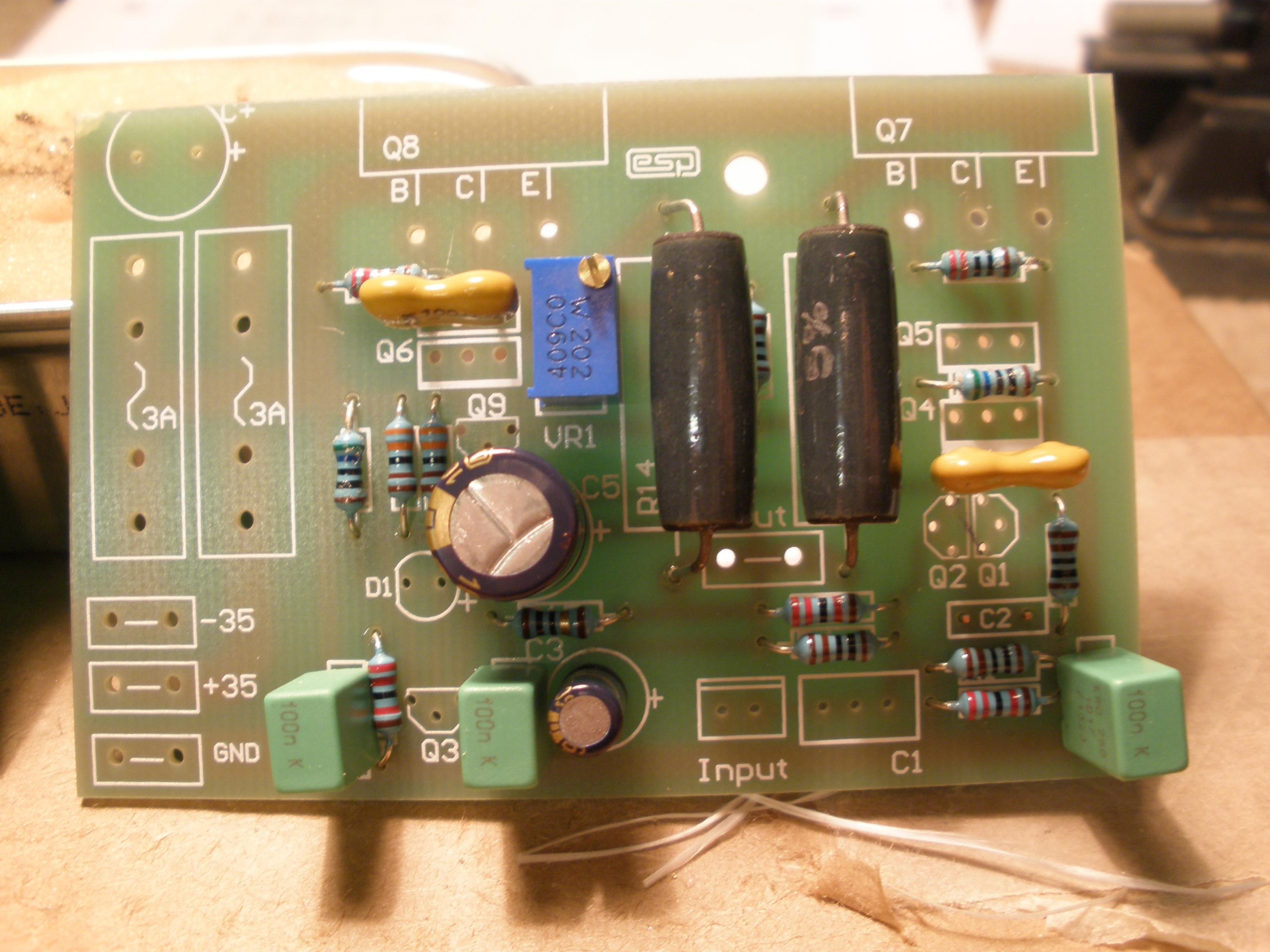

Thanks vzaichenko/gmphadte.
So here is where i'm up to at the moment.
C2 is installed but I had to put it underneath because of its phisical size. C1 also is too large to fit completely so I will have one end soldered to the board and the other (input end) hanging free off the board.
Looking at pic's 2 & 3, - I think Ill mount the fuse holders off the boards and use the space to mount the + and - 100uF PSU caps. Because I've split the boards into two singles I don't think there is enough space for them otherwise.
The last picture is how I intend to do the power supply. My transformer has two separate windings of 30vac each.
Hope this all looks OK so far, any comments or suggestions will be greatly appreciated.
Thanks.
Kind Regards
Roy.
