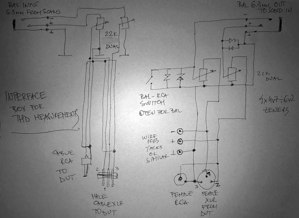

EMU1212 bal out , bal cable to box
bal 6.3mm female on box , to 22K bal pot attenuator , then RCA on cable to DUT (taken + as hot and gnd ) , also XLR on cable to DUT , obviously taken both hots and GND to
you choose which cable goes to DUT , second one unused
then , again in box , in parallel (logically connected) RCA and XLR and 4 wire-screw connectors (two gnds , one + and one - hots) , leading to 22K bal pot attenuator , then to bal 6.3mm female , then bal cable to EMU1212 input ;
at that last pot connected switch for grounding negative hot , for RCA (unbal) tests

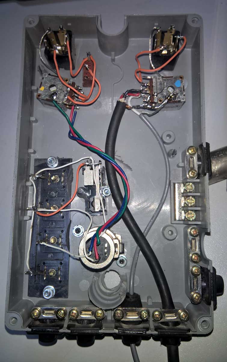

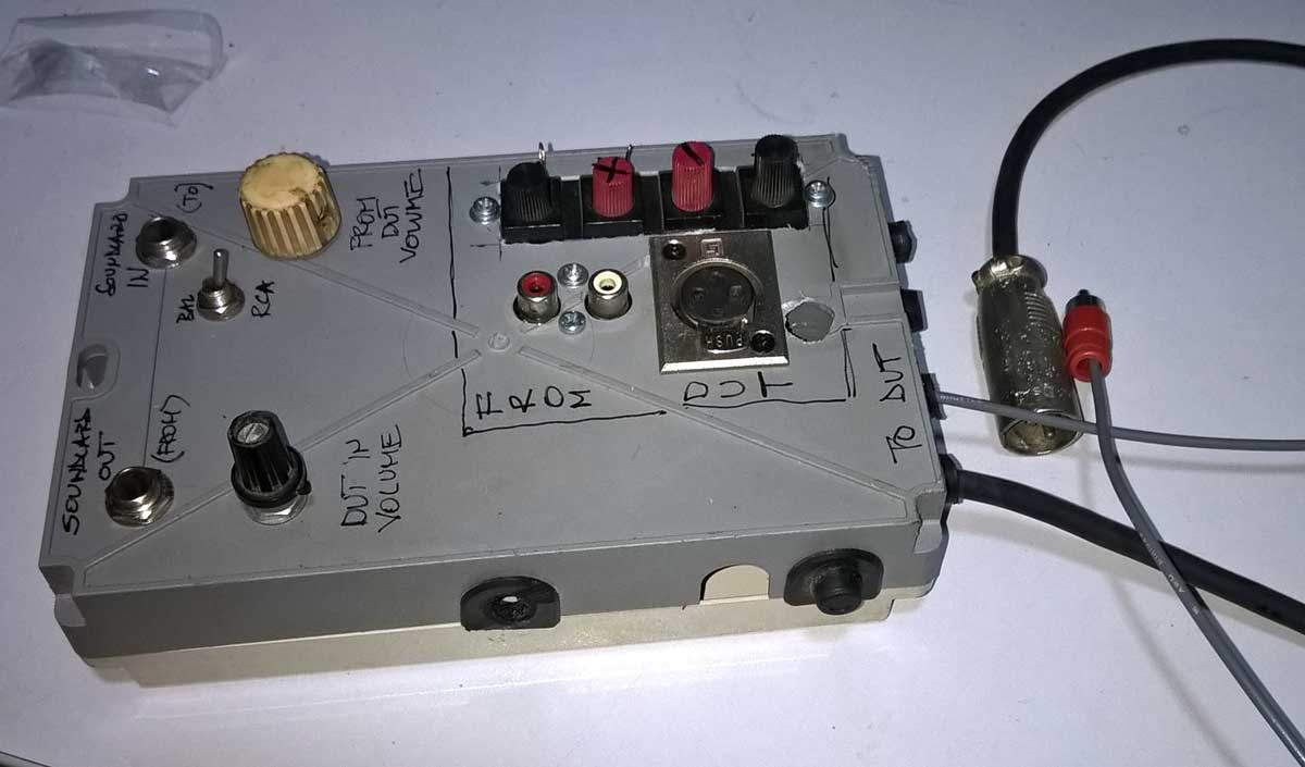

pics enclosed , some of procedure explained in Babelfish M25 , AKA M2 on steroids , AKA M2-XA25 bstrd
anti series , or anti parallel zeners (say 6V8 to 7V5) connected between second pot wipers and gnd , as soundcard input protection ; you'll not see them in pic of course
procedure is - all levels all the way up on EMU (ARTA help will tell ya) , first pot sets needed input level to DUT (say that you're shooting at 1W/8R , some amp ; whatever goal it is - you need to observe that with scope)
crocodile clip thingies from amp out to 4screws thingie on box , switch to RCA (grounded neg leg on EMU input) , level to EMU set with second pot (look at desired dBFS figure)
use metal box , short cabling , do not use autoformers if you want blameless measurements
tricky to draw all these connectors in any program I have in my PC , scanners ....... 3 of them , none working at wcrap 7 , lazy to bring 4-th , so I can scan back of napkin schm
just look at pictures
and yes: 6.3mm jack - tip is + hot , ring is - hot , sleeve is gnd

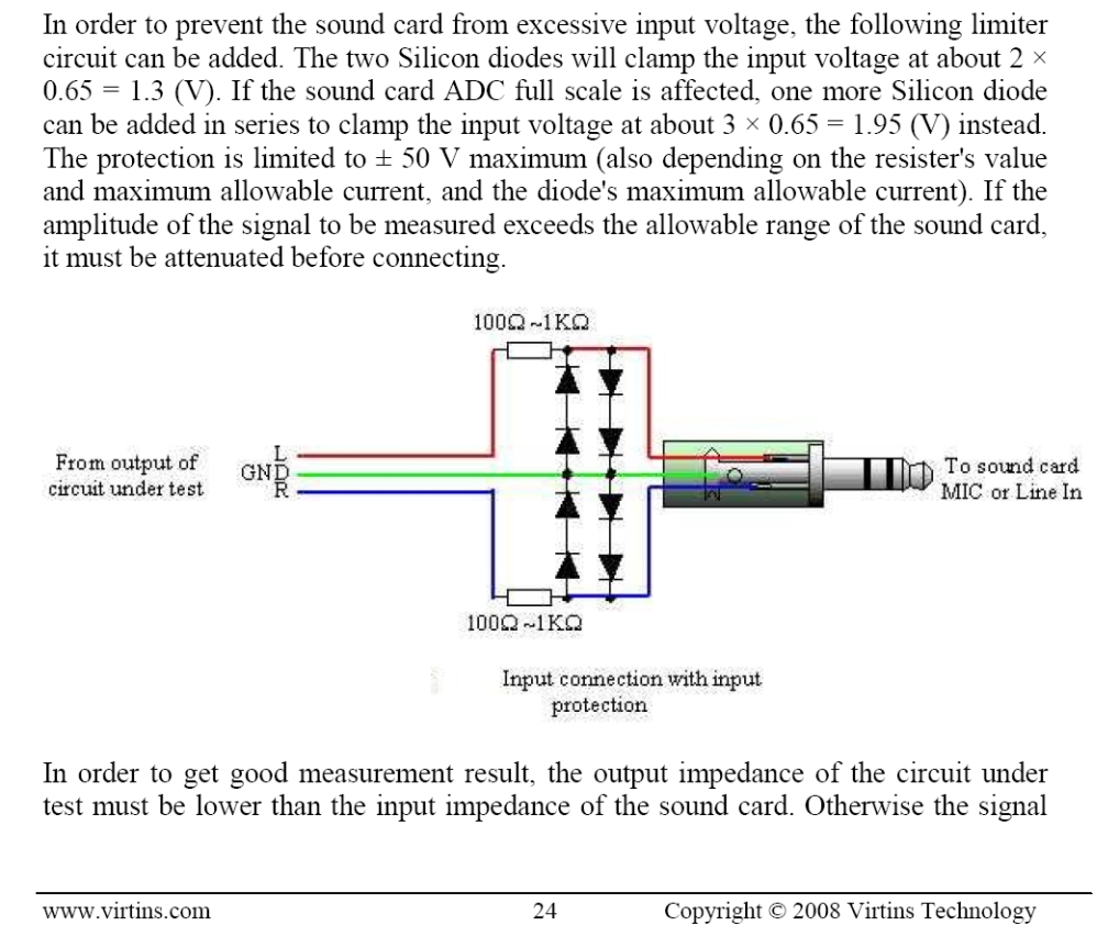

I really like the Dan Joffe attenuator circuit I linked to in post #44.
Switchable attenuation from -6 to -30 dB in 6 dB increments, and it has clamping LEDs against overvoltage. These also signal if you are overdriving the circuit. 😉

nice one ;
though , you need attenuator also for signal going to DUT ; best results are when output of card is at or near 0db , and usually you must shave that prior to reaching da amp (DUT)
Perhaps a combination of chede's idea from post #44 with added attenuator pointed out by Zenmod? Sounds good, but I might miss good even if bitten on rear end by it....trust these folks though!

started drawing it in paint , you'll get it tonight here

damn Paint
finally took back of napkin approach , phone cam and Photoshop
Steel (box), ZM , Steel !!!
just to have it handy :
6.3mm bal connection : sleeve GND , tip + phase, ring - phase
XLR connection : pin 3 GND , pin 1 - phase , pin 2 + phase

Now for real embarrassing display of ignorance....These drawings represent connection to device under test, from device under test to and from what ever interface, 212, whatever.
Then, connection from interface to computer w ARTA, REW, whatever by some other connection? Or do I have that all mixed up to? Probably need to stare at your pics a while too.
Yup, babe in woods here for this stuff! Sorry.
Russellc
Russellc
Yes, USB.... connection from interface to computer w ARTA, REW, whatever by some other connection? ...
Yes, USB.
Thanks...one more question, for now. Is this the schematic for device used by zenmod in Babelfish M25 , AKA M2 on steroids , AKA M2-XA25 bstrd thread? Or slightly different?
