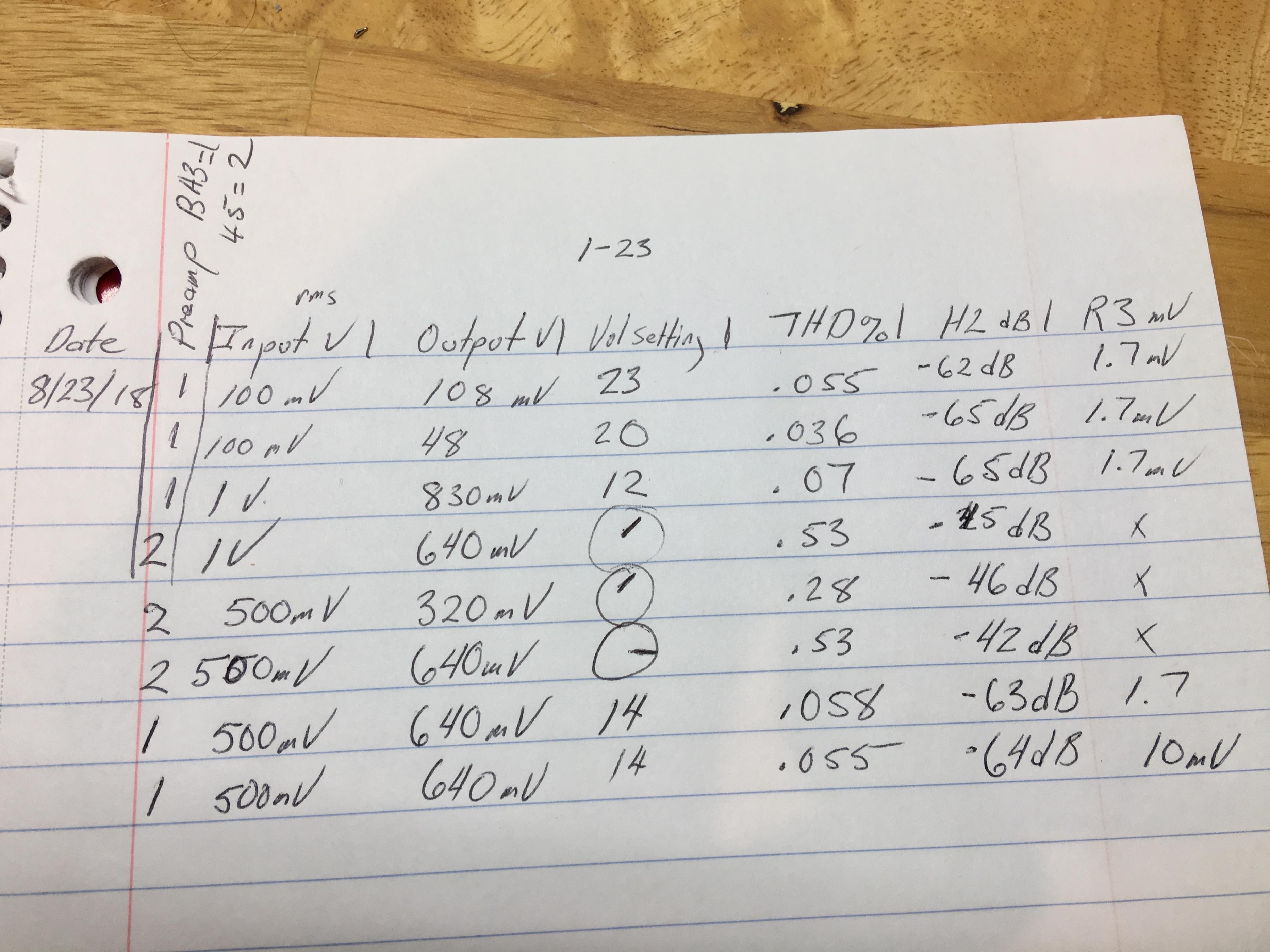

Could you kindly share at preamp output voltage was it measured and how much the H2 and H3 distortion level in mV, dB, % or whatever you measured? Ballpark figure is ok. Thank you.
Here are my notes from last night:
So more than a month later I finally took your advise...I didn’t think reversing polarity would make much of a difference...I was wrong, it makes a considerable difference. Thanks Indra1

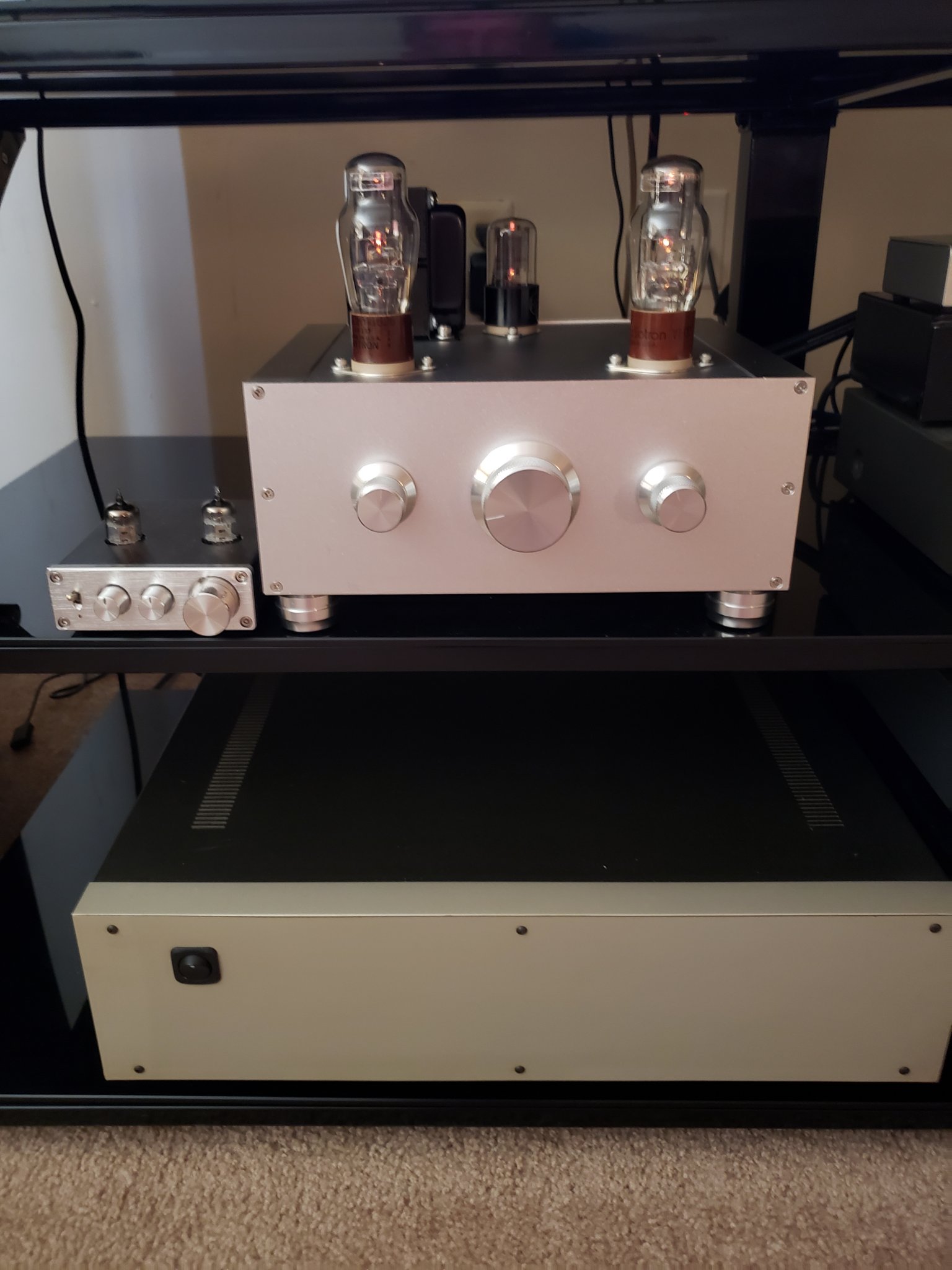

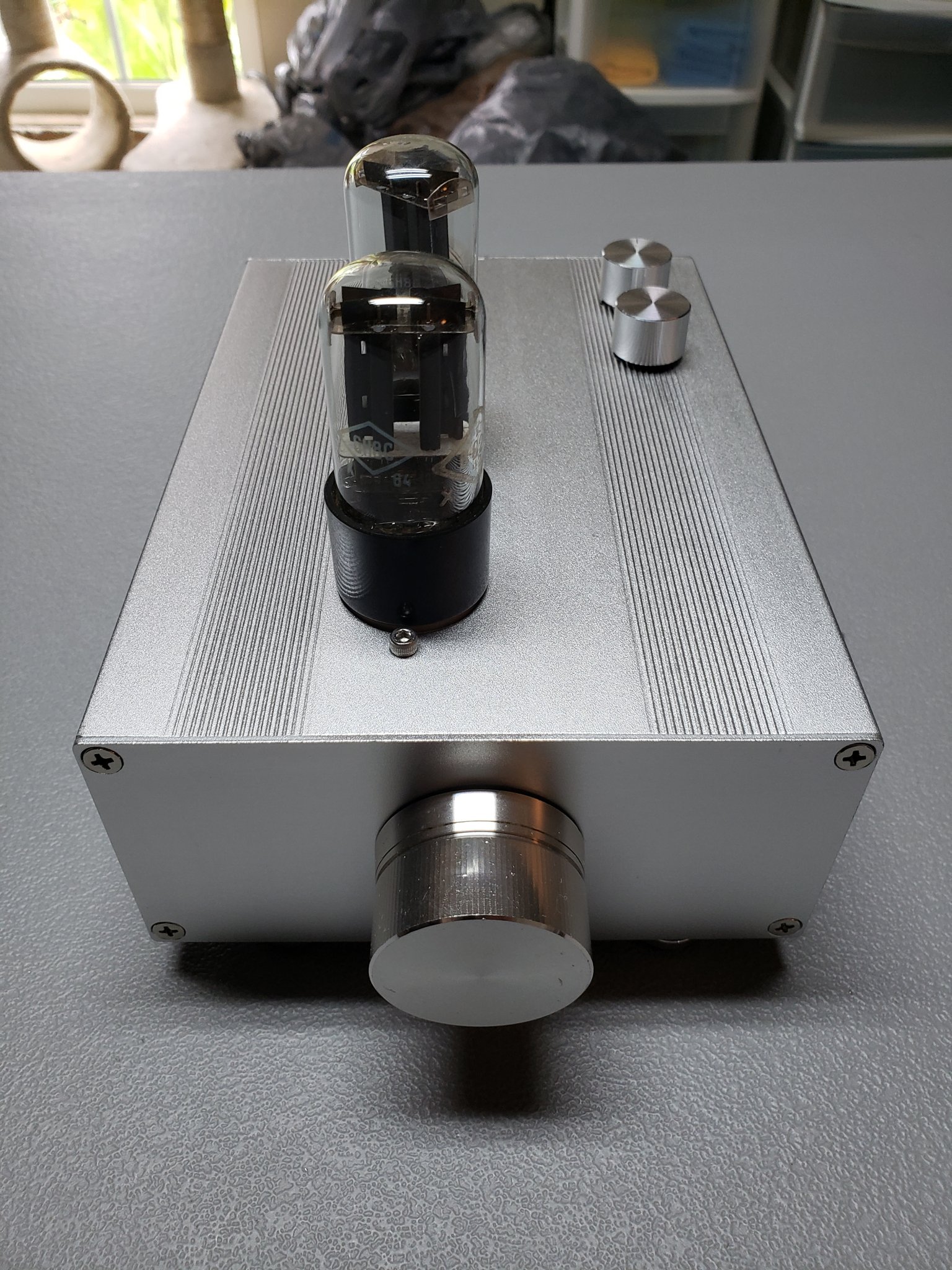

Hi Friend's,
Just finished my F5T ver.2 Amp.
Now I ponder the P3 question ❓
Any new updates since time has passed?
I got in to tube preamps as of late and enjoy the tube sound.
I'm not into extreme low distortion numbers.
Found many audio components of high distortion to sound quiet good.
I just not impressed with the amp so far as my Leach amp and tube frontend seems to sound better, not sure what's going on, maybe P3?
Any advice on adjustments with no scope or not sooo expensive ways to adjust would be greatly appreciated..... Robert

Hi Friend's,
Not F5, but my experience with P3 on the BA3 pre. Without measuring equipment!
Presuming that your P3 was set to the middle position.
Turn it a couple of full turns one way and listen. Then back to zero, and a couple of turns the other way.
Listen at each position.
N.B. you MUST re-bias and zero offset. after every change.
My experience, one way was harsher and brighter, (some might describe it as cleaner.)
The other way was more mellow.
Which is "best" to your ears?
Thanks for your reply, I may try that.
I checked again last night ,P3 for true center it was dead on.
My bias is 350mv with about 2 ma offset.
I like softer, mellow not too bright on the top end.
