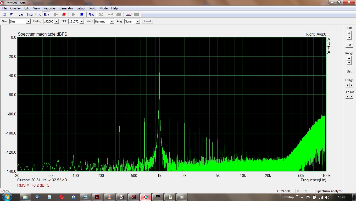

This looks a little better, I put a new battery in my meter.
ARTA Gen set to 0dB 20 bit.
2i2 output level - rear sockets set to 1V rms to DRV134; input gain set to read 0dB on ARTA, dial glowing red; input gain backed off to -0.2dB, dial glowing green, 0.2dB makes a lot of difference. The other plots are the ARTA gen set to -3, -6 & -9dB.

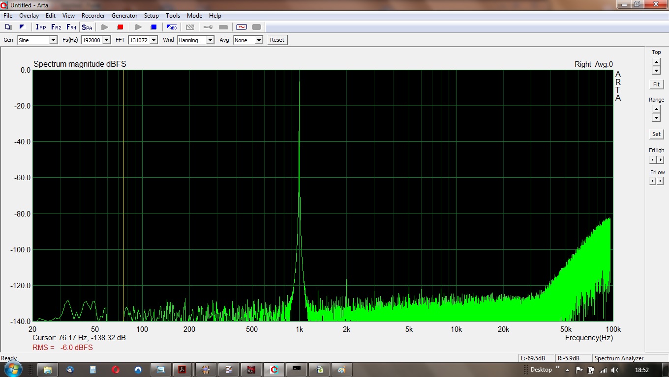

Iteresting. there is quite a drop from -3db to -6db. Looks like -6db might be the sweet spot.
edit: also try setting the averaging to linear or exp. It will hide the noise and leave the harmonics more visible.

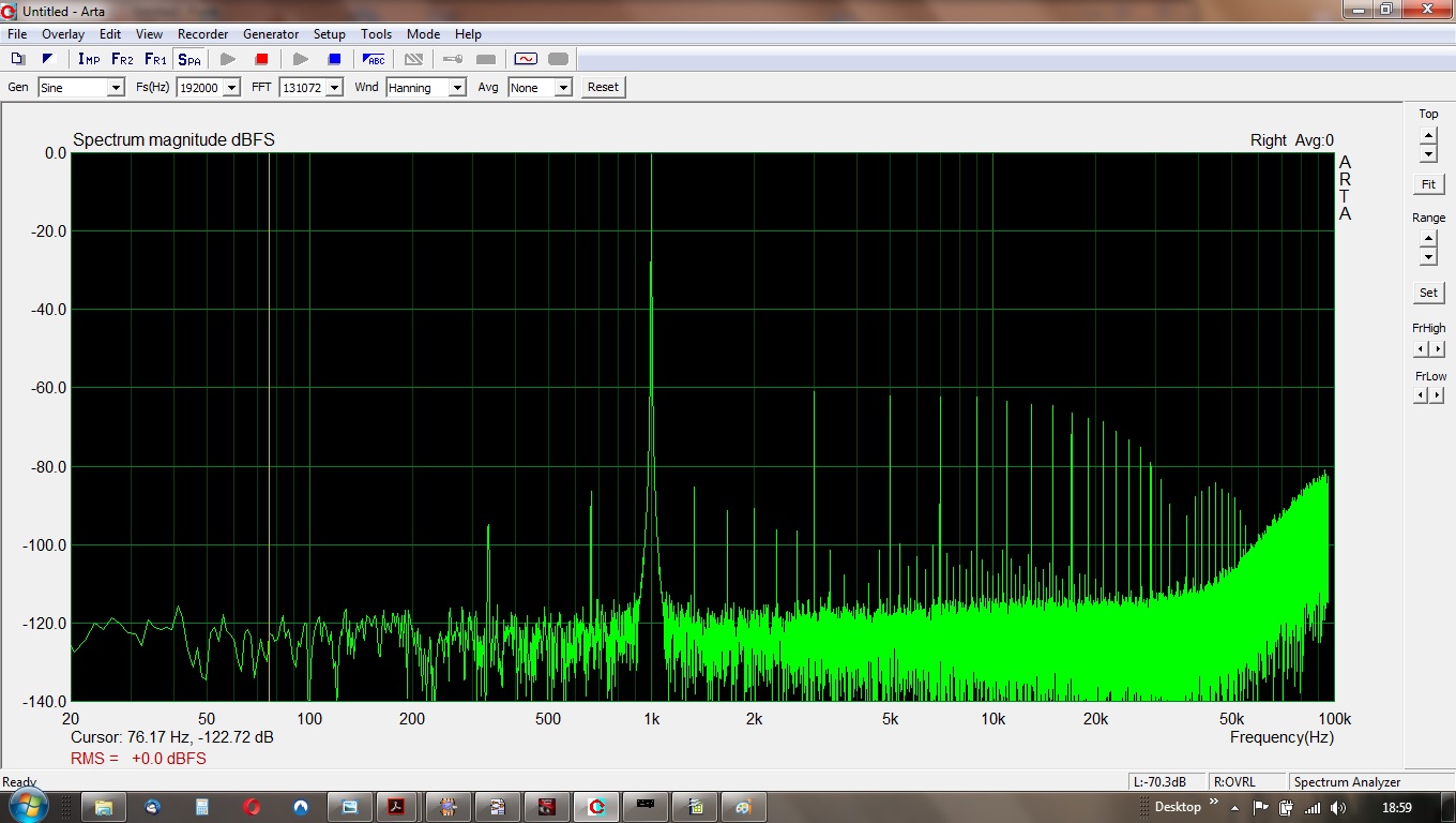

Why not turn on THD and THD+N thru the Setup dialog. I find with my albeit little experience that the setting where THD is the lowest is the best.

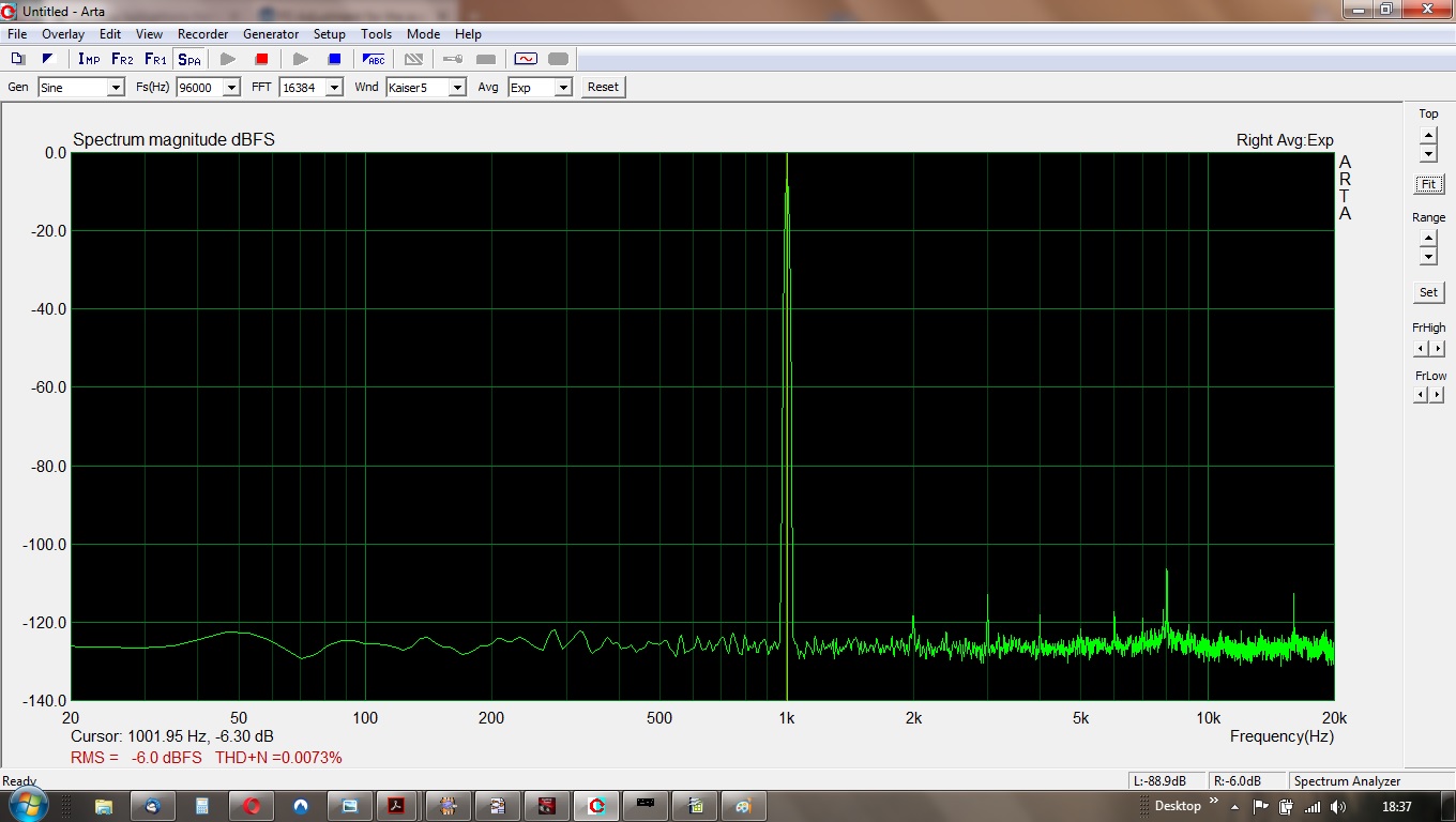

Also, try these settings in ARTA:
FS(HZ) = 96000
FFT = 16384
Wnd = Kaiser 5
Avg = Exp
Still not good.
Still not good.
Looks pretty good to me! What are you trying to achieve?

It's averaging -125dB noise floor, was hoping for better, harmonics are less than -120dB
there also seems to be some pick up - sproggies, there's one at 8Khz
Provided your BA3 is not better than that I think it should be fine. The 8Khz is a bit weird, but could be picking up from something nearby. Try turning off all flourecent lights and devices with switch mode power supplies (or take the whole thing outside and try measuring there). In reality your BA3 should not have anything you would be hoping to measure by the 8th harmonic anyway so it can be safely ignored.
You look to have well over 100db of headroom for your distortion measurements so unless the BA3 is less than say 0.0005% distortion I think you will be more than fine for doing the adjustment 🙂
