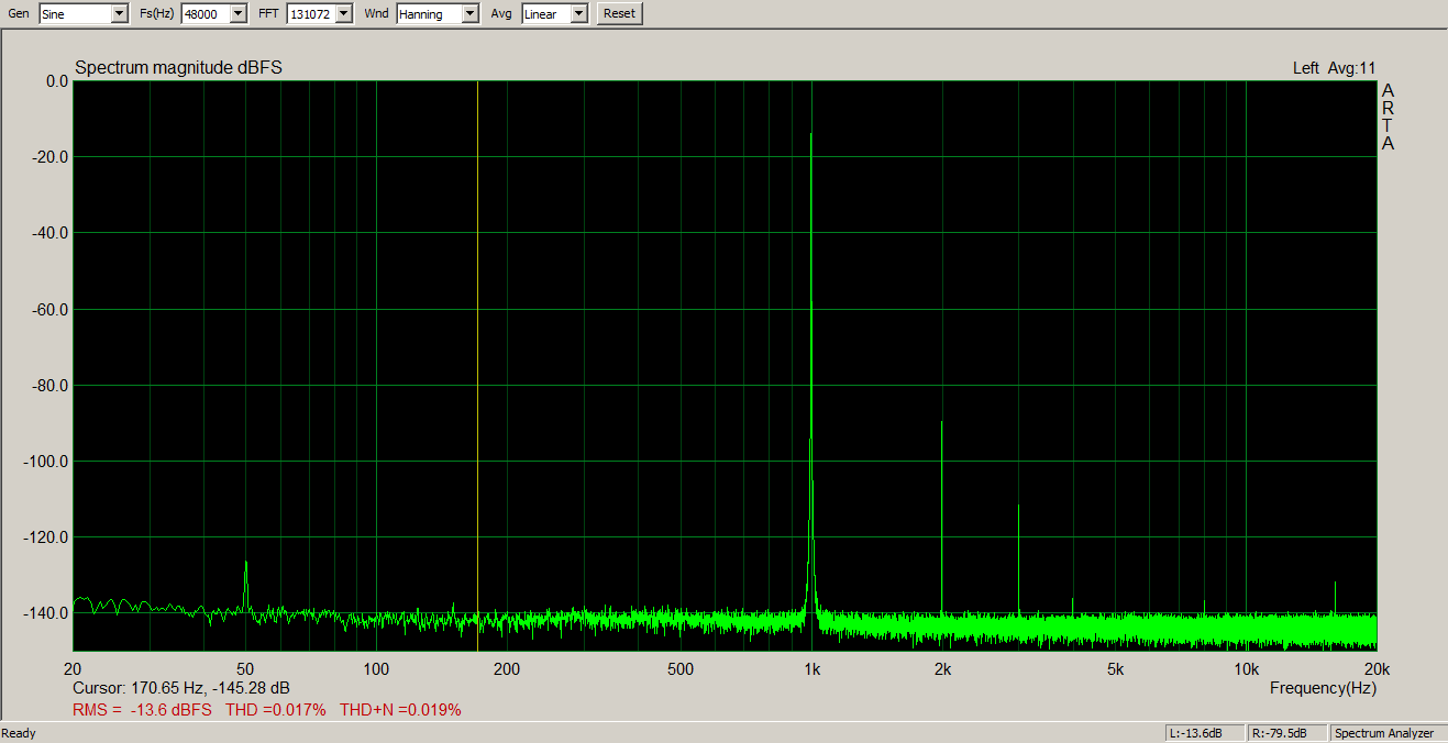

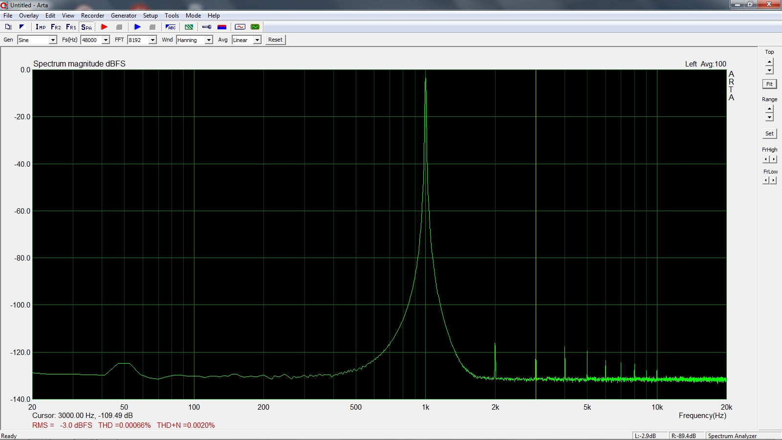

Focusrite 2i2 2nd gen loopback and attenuator teaser
I can only give a small teaser here, because I will be going on vacation with the family tomorrow morning for the next two weeks ...

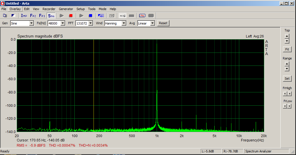

This is my plain loopback spectrum:
I got the best performance at -3 dB, and sampling set to 48 kHz.
I used a plain TS mono cable, no balanced / SE conversion.
This is the cable:
Cordial CCFI 0,6 PP – Thomann UK

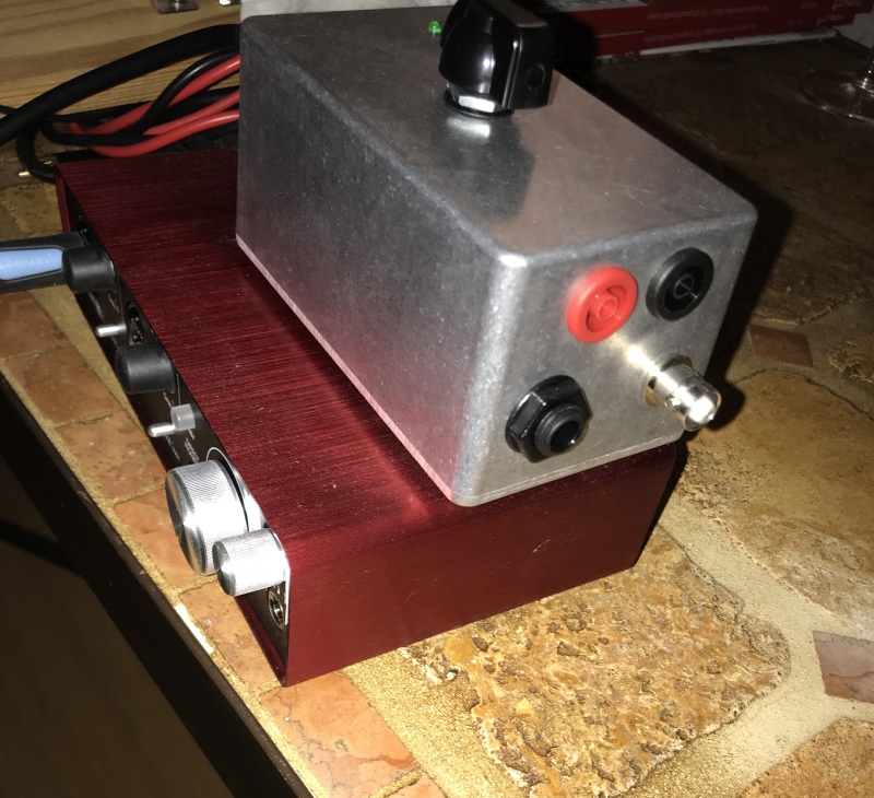

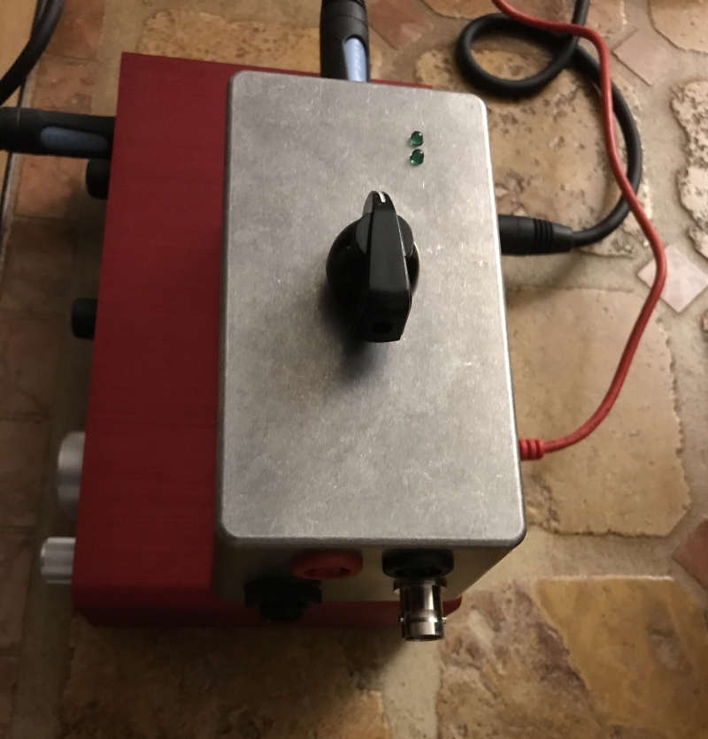

I also built myself an attenuator box to a) protect the Focusrite, and b) adjust input signal to be able to measure power amp output as well and not overload the inputs.

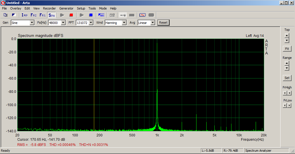

The attenuator I built follwed a design given by Dan Joffe of Akitika,
1 kHz Oscillator
(look to the bottom of the page, where it reads "Building the Switchable Attenuator")
https://www.akitika.com/documents/BuildingTheAttenuatorRev4.pdf
I'm sure I got the pointer to this attenuator from somewhere here, but can't remember at the moment in what thread I picked it up ...

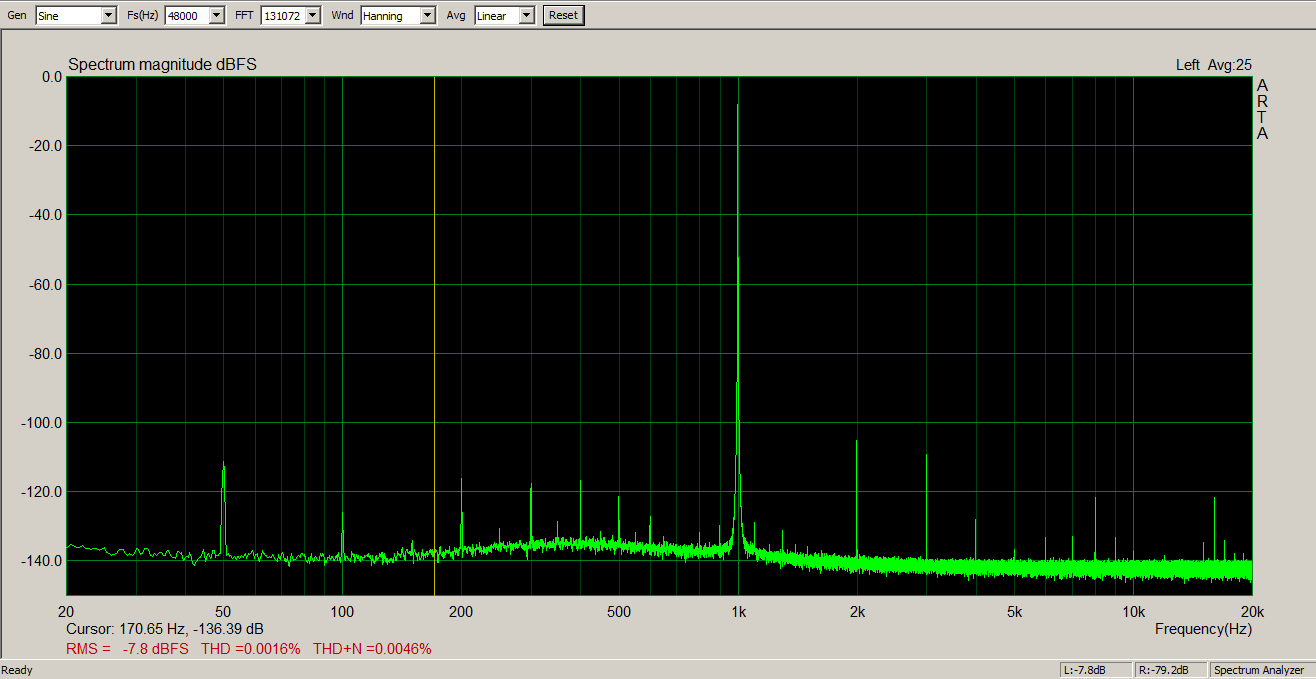

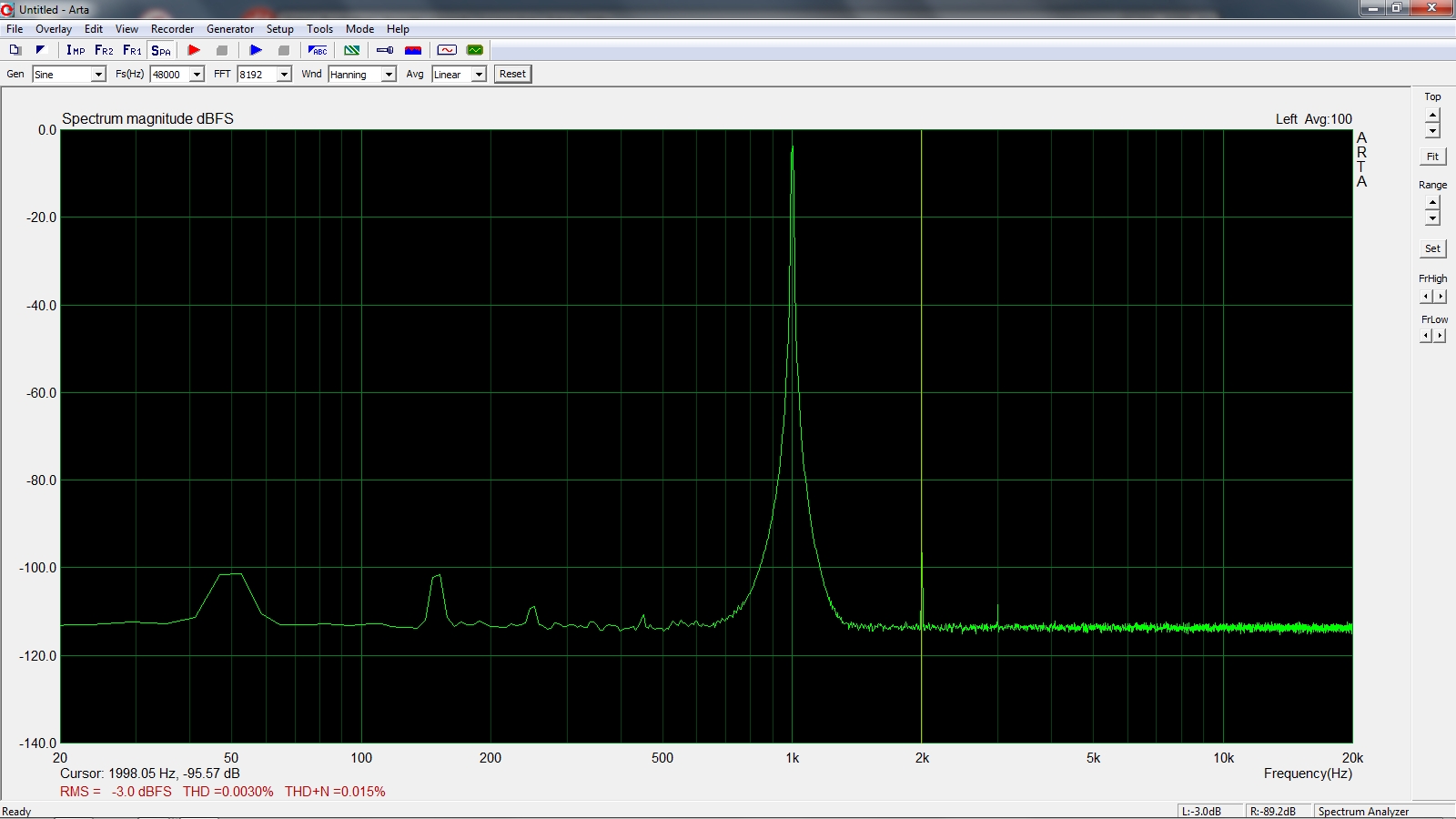

Anyway, the attenuator works fine, but even at the setting with the least attenuation (-6 dB), in my implementation at least, the loopback through the attenuator gives not as good performance as straight loopback:

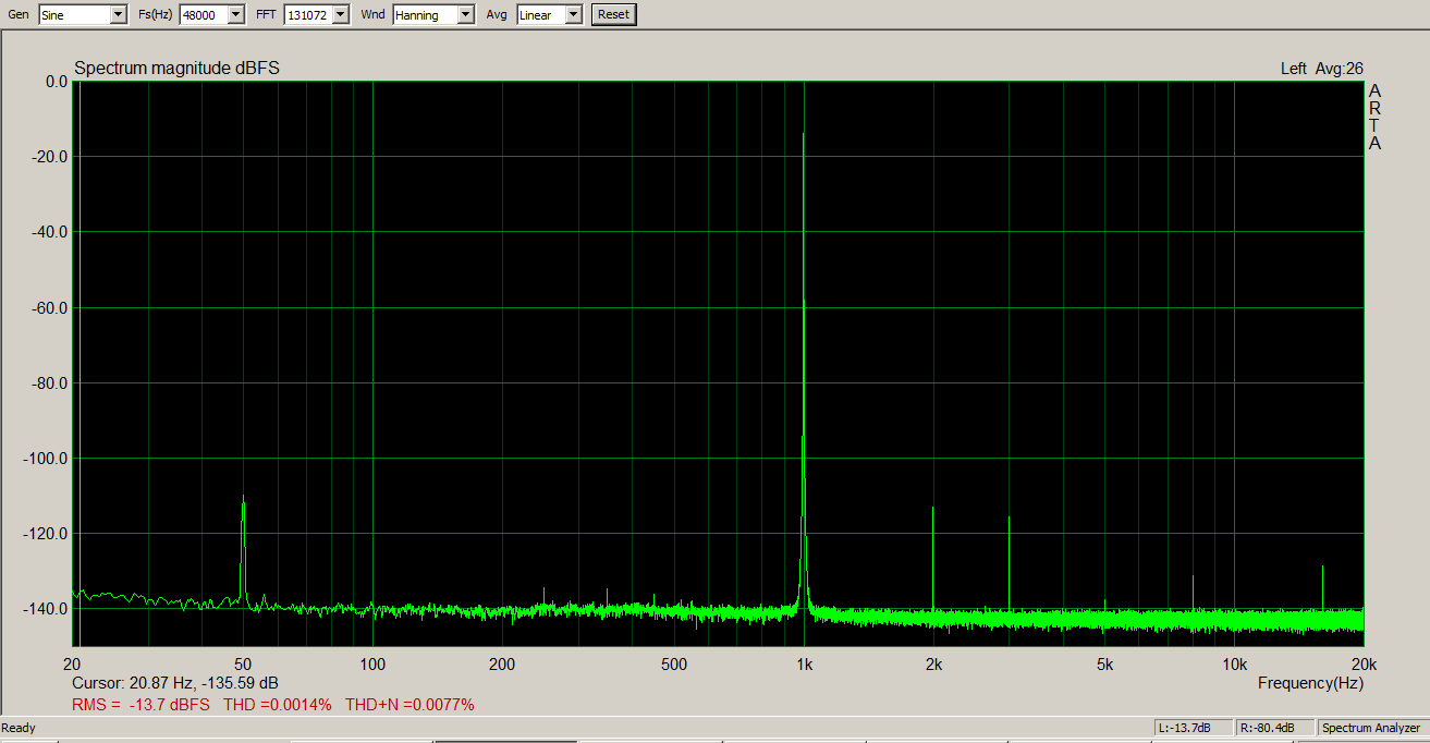

At -18 dB:
This doesn't bother me much, because the distortion and noise figures of the devices I have measured so far are quite a bit higher ... 😛
Here a few pics, at least from the outside - I put several input options in to be able to use a variety of probes:
More photos from the inside, if somebody is interested, after family vacation ... so far, I have measured distortion of an Aikido pre-amp and my M2, and it works fine.

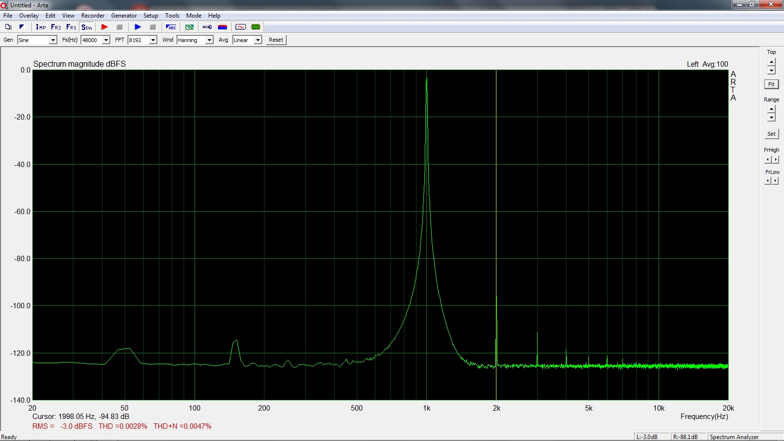

I've done a few more tests this morning on my 1st gen focusrite 2i2 at 48Khz sampling rate, and can confirm that the distortion performance is better at 48Khz for the gen1 as well.
However it is still much better if the Sleeve is isolated. I also did the calibration in ARTA this time. Voltage output at -3db is around 1.6V. All measurements below with exact same settings on 2i2 volume knob at max, ARTA set to -6db on generator, inout gain set to read as close to -6db as I could get it.
First the loopback with TRS loopback cable.
Next loopback using Tip and Ring only, no sleeve connection.
finally loopback using a fender guitar TS cable (I don't have a short TS loopback cable)
So at least for my 2i2 it is quite important to not connect sleeve.

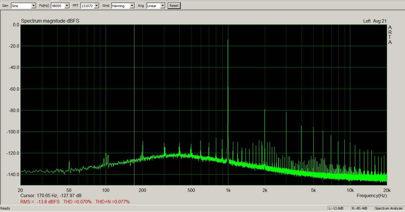

Well the plot thickens!! When measuring my active crossover (unfortunately the best line level device I can try) I get some very odd results!! Note that measurements were taken with ARTA set to -6db as before, and all controls left as they were.
Result with passive only TR cables looks ok, but distortion was higher than I was expecting. I moved outside as the bal2se results inside were MUCH worse than outside, I suspect noise pickup from HTPC and other electronics in the lounge room due to the breadboard.
So the result with the TR cables on the HP circuit. The crossover frequency is roughly 3rd order electrical at 270 hz, and the HP circuit has around 6db of attenuation as well.
Now the result with the balanced to SE converter and then TR for the input. pretty ugly!
Finally with the Bal2SE then HP crossover and then SE to balanced circuit.....
Oddly quite a bit more hum pickup (oddly because it is differential in and out) but the distortion is an order of magnitude lower! the hump in the noise floor is much reduced as well. I think I need to do a bit more experimenting with values in the converters. The Bal2SE currently has 2.2K resistors in it which may be too low.
This is only a test with one (probably quite unusual) piece of equipment, but it shows that loopback tests with different options alone are not enough to determine what will be best when measuring real world devices.

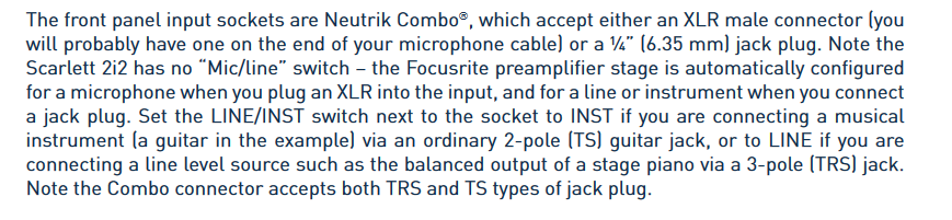

Are all those measurements when 2i2 is set to "Line" (not "Inst")?
I think in "line" the 2i2 expects TRS jack and in "inst" it expects TS?
So you should always use a TRS jack in "line" setting and a TS jack in "inst" setting?
All in line mode. I did a test in instrument mode and it has much higher gain and is not appropriate for line level measurements (specifications show this as well).
I re-checked the documentation and it is a bit ambiguous. It does mention that inst mode is for instruments and it expects a TS cable in that mode (I use a TS cable all the time with my mic preamp without any issues). It doesn't say specifically that you can't use a TS cable in line mode. On the outputs it says you can use either TS or TRS cables.
These results could be specific to the gen 1 2i2, or even possibly to my unit, just something to be aware of if you don't seem to be getting the results you would expect 🙂

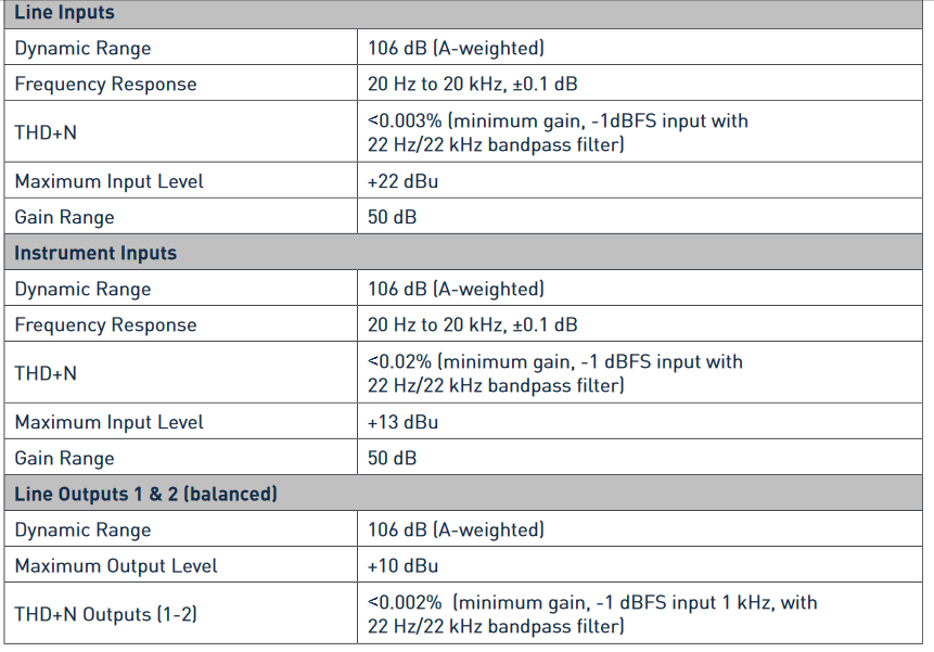

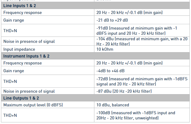

Attached are snippits from the 2i2 gen1 and 2i2 gen2 manuals on inputs, outputs and specs.
This page has more info. Guide to Setting up your Studio Part 1 – Focusrite Audio Engineering
Specifically it says that outputs can be simply TS type but that inputs should be TRS with T connected to the tip of the output and R connected to the shield of the unbalanced output).
I originally made up TS cables as some article I found said that was what you should do, but it would seem the best solution for unbalanced to balanced cables would be to use a TRS jack for the balanced end. A two wire sheilded cable with all three connected at the balanced end, and just the two internal wires connected at the unbalanced end with shield floating at that end.
