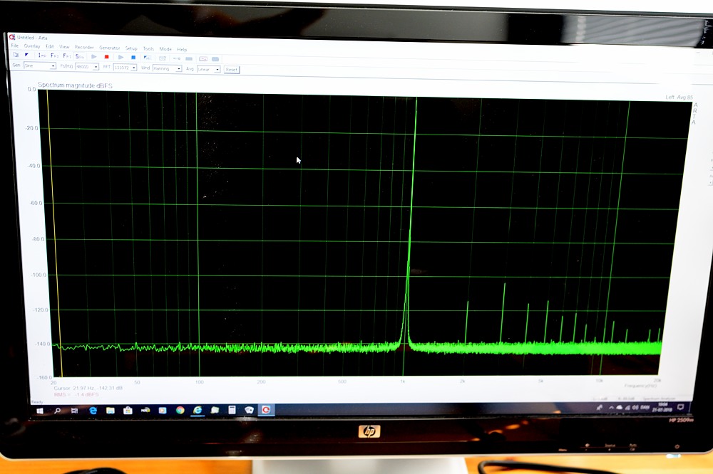

I had my first play with 2i2 and ARTA software. A loop back test with a 1k sine. Fs = 48k and FFT = 131072. It looks very clean. No 2nd and 3rd harmonic which of course is good for a test sine generator. But it looks a little to good to be true?
If I turn up the signal so the green ring goes red......then I got a lot of distortion…..as expected.
What is a good value for FFT?
The number is the resolution? …..higher number better?
The recording takes longer if FFT is high.....which probably is logic.
There is a steep learning curve……...….

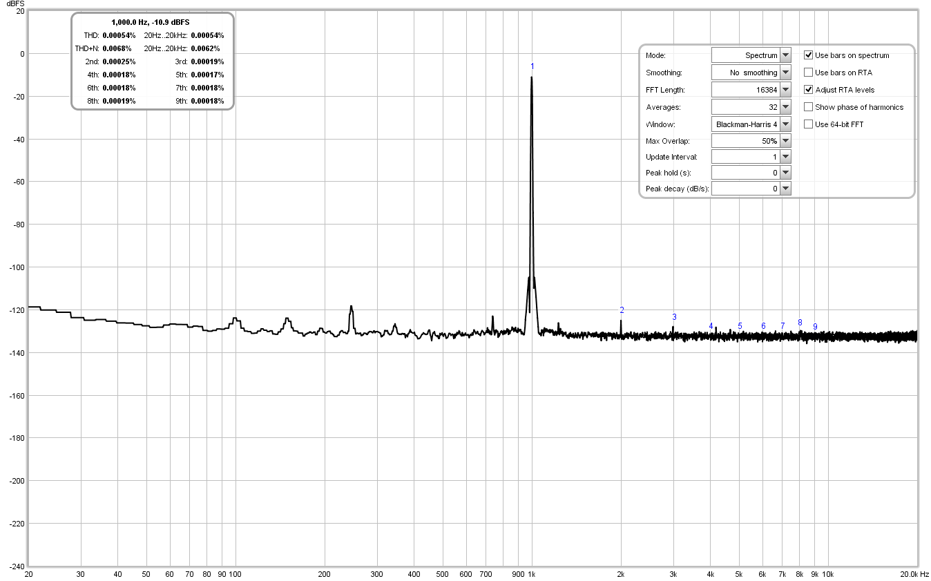

Hmm to me it looks like your noise floor is quite high at -80'ish. Maybe lower preamp gain and turn up your output dial. Did you use smoothing? Here is a loopback from my Mbox3 for comparison. Master volume all the way up (as i think Wintermute mentioned) and preamp around 10-11 o'clock.
attachment.php
That's the lowest distortion i could get. Using balanced cables made no difference, and disconnecting the sleeve from the jack (or corresponding pin on XLR) actually gave me increased distortion.
You should be able to go lower for FFT length, 16 or 8k. I don't think it is a critical parameter, just makes measurements faster (with lower values).

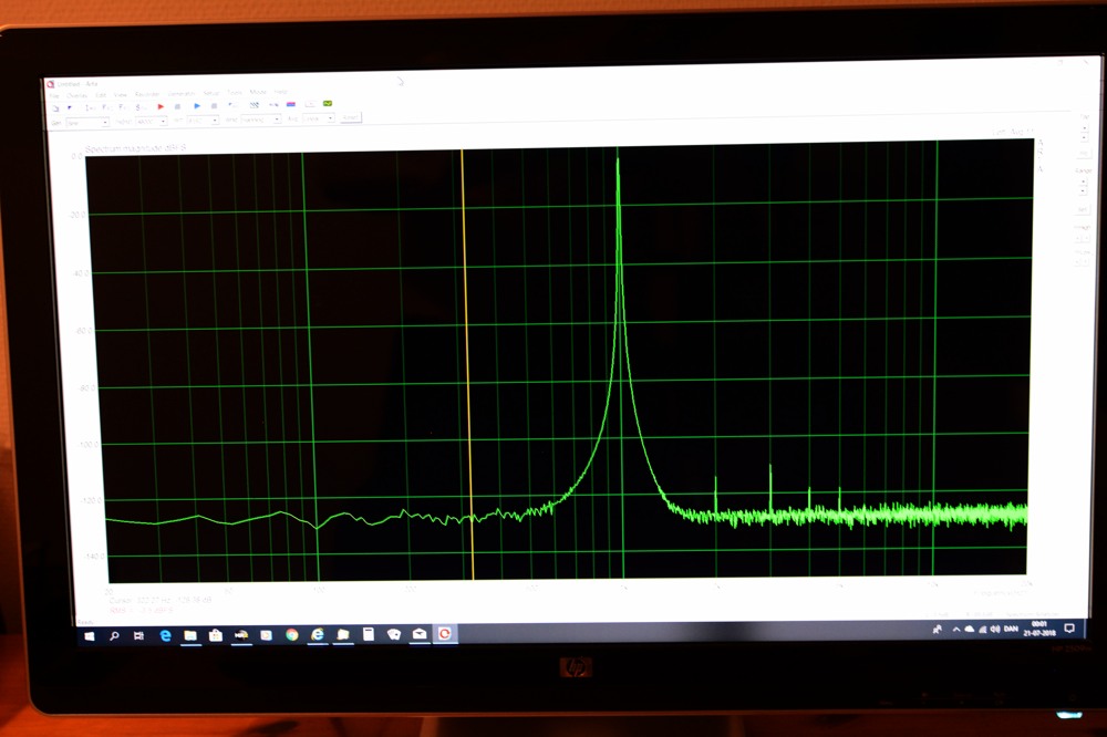

Ok.....I tried again by setting the sine generator to -6 dB and set monitor to max. and then input gain to approx. 11 o'clock. But what did the real trick was to change Wnd from Uniform to Hanning. Avg set to linear. I have 0 dB at top and noise floor is now close to -130 dB. Now it looks more realistic with some 2nd and 3rd harmonic. One should think that output of sine generator will give best result if set to 0 dB for max. resolution in the DAC?
Will play more with that…….

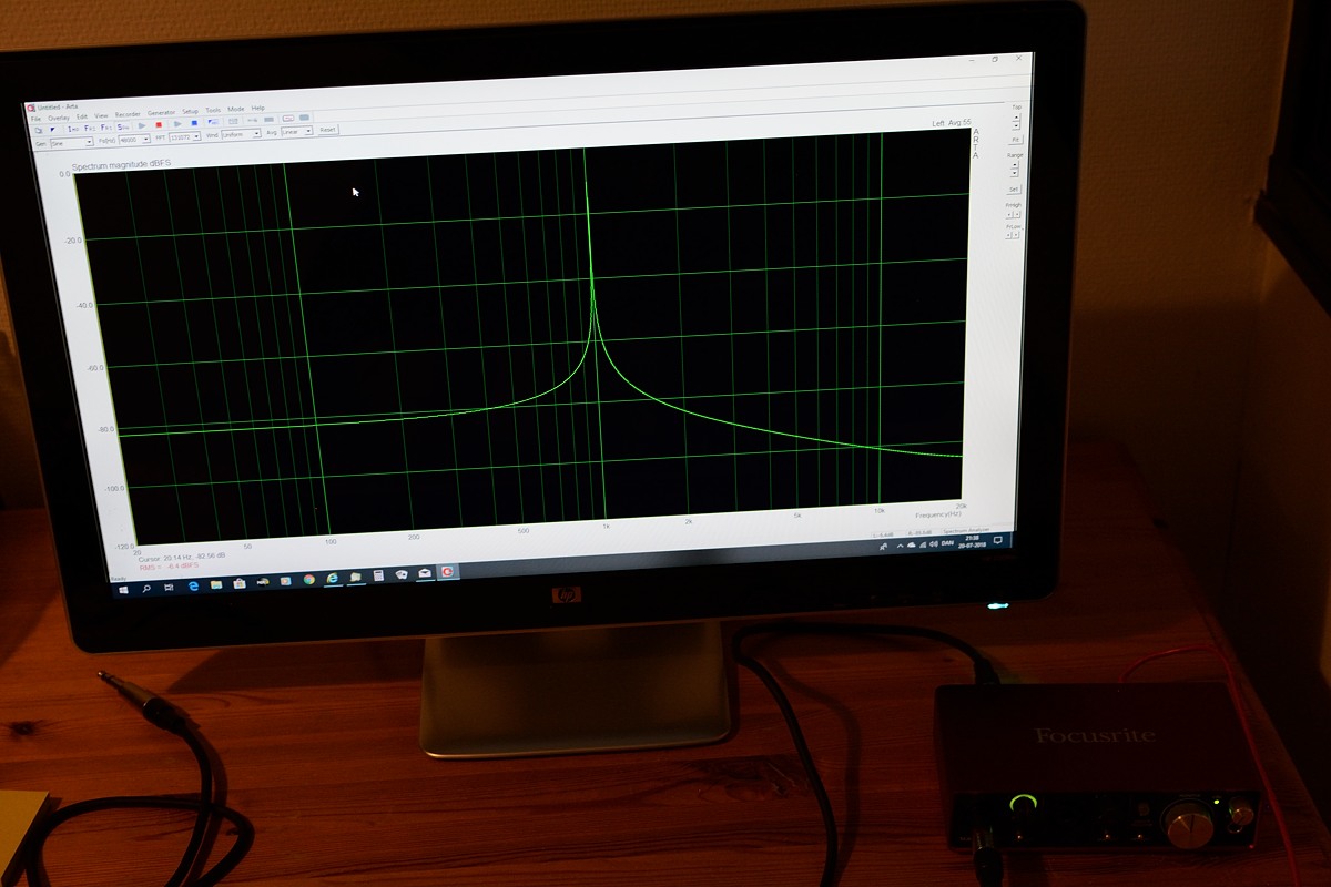

By playing a bit with the settings in the loop back test I was able to get the noise floor just under -140 dB and 3rd harmonic which is the most dominant below -100 dB. All other harmonics are well below -100 dB. Is this considered a quality sine that can be used for testing preamps? ….would I be able to adjust P3 using such a setup? ….it will require that the distorsion of the test generator is much lower than the distortion pattern of the BA3 pre?

ARTA should be able to tell you the the+n figures, which should be close to or less than the ones i showed above. AFAIK that is fine for measuring ba-3 harmonics.
An external test generator is fine (and potentially even better than the 2i2 outputs).
