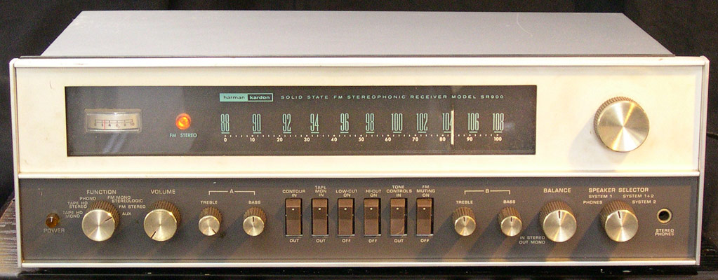

Harman Kardon SR600 (SR 600) equipped with Germanium Power Devices H43020418
by post #12 about
http://www.diyaudio.com/forums/soli...n-harman-kardon-citation-b-1963-1964-a-2.html
you will find the schematics, posted from "Orit" in Italy.
Thank you very much therefore.
This must be one of the first solid state receivers from Harman. Phase splitter transformer is also still in use cause the at that time not available NPN germanium types
Who knows about the industry type and brand name of Harman Kardon's factory number
H43020418
by post #12 about
H43020418

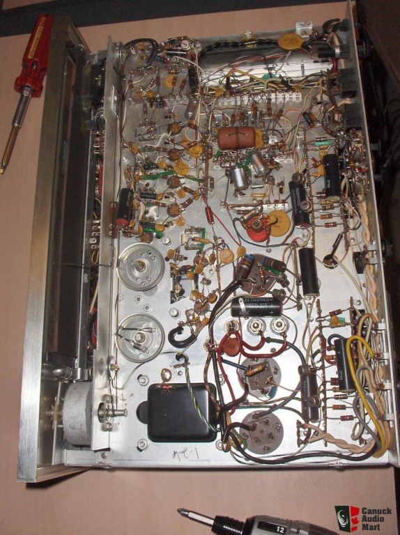

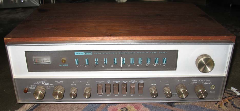

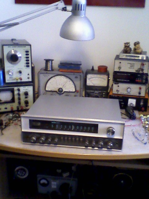

Yes, this set looks identical to the SR-900 I repaired recently. A sticker on the back tells it was sold in Los Angeles, so I suppose it was brought to Italy individually, by the private owner.
Schematic from Lansing's "Solid State Energizer Transducer" (post #5, #6 and #46) still needed.
This would be highly appreciated for a cost estimate to perform service.

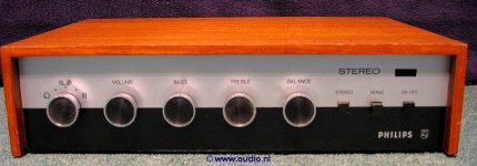

Philips GH295: very clever design
I am presently trying to restore/upgrade one of these little gems. The footprint is as small as an A4 sheet of paper. Weight is only 2.5 Kg.
The attachments are thanks to Welcome to www.oudio.nl !
Just wanted to say I'm really amazed at the ingenious electronic design of this amplifier (release in 1966): for budget reasons, the power transformer has to be small, and subject to voltage drops even at moderate volume levels.
At that time, no voltage regulator chips were available, just the first, low-current zener diodes.
What they implemented is a 20-0-20 V AC secondary, which gives 27 V DC at zero volume, a zener-regulated 18 V voltage amplifier section, and a non-symmetric output stage, where the center is at 9 V, so that one PNP AD149 has 9 V Vce, the other has 18 V Vce decreasing with current increase.
In this way I think that the output stage gets balanced at maximum power, while the unbalance at low power is not very important. The effect of sagging voltage is thus minimized.
Actually the sound of this small amp is VERY nice, if not HiFi, and it's what I call "Electrovoice like", because the schematics is similar to the EV 1144.
Low feedback gives a marvellous "3D" impact to music.
Note also the very low (10 kpF) series capacitor at the input. Together with the 15 kpF feedback capacitor it keeps the frequency response uniform, without excessive loading of the input. If you try to put a bigger series capacitor, the input stage overloads.
I think the only worthwhile modifications could be a 7918 instead of the zeners + 100 Ohm resistor, removal of the tuner feed supply, and a bigger filter capacitor (3300 uF ?). A Led instead of the incandescent bulb could save some more mA. I want to keep small output capacitors because bass is already a bit on the high side now.

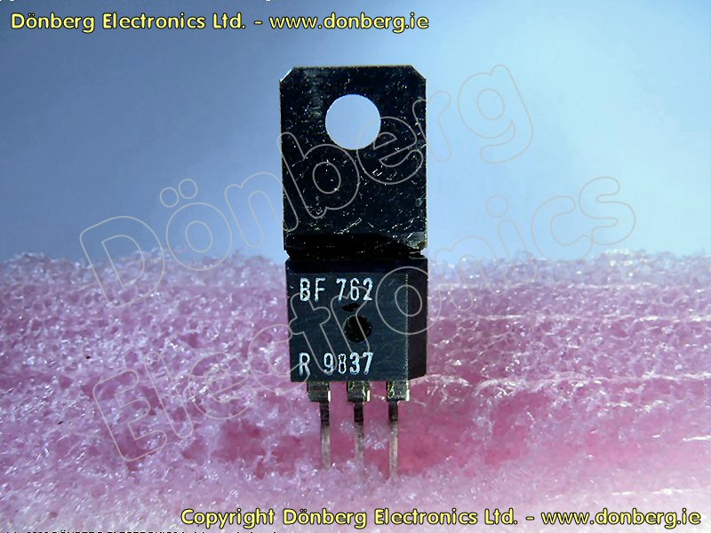

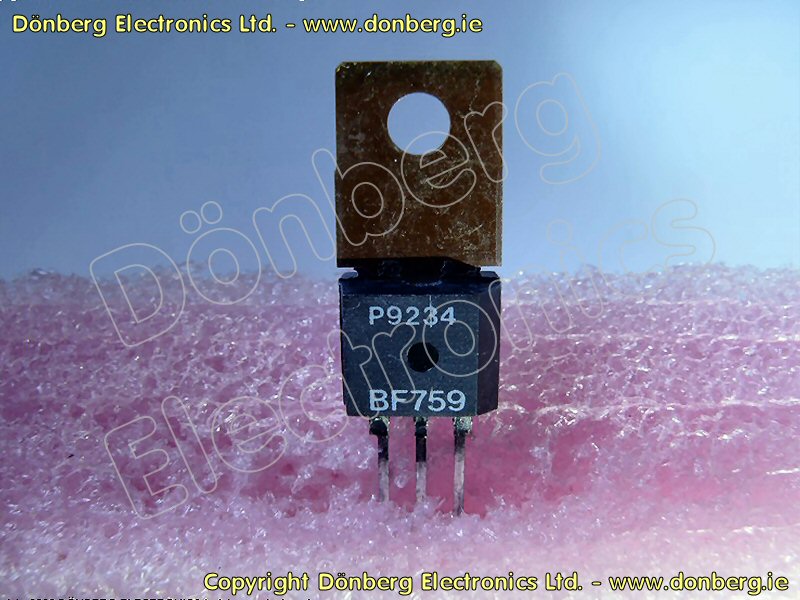

Unfortunately I haven't this. But other types for replacement: BF759/762Hi tiefbassuebertr
Can I interest you in a swap/trade ?
I have some NOS transistors (OC20 something (2) and some small metal cased transistors (don't remember p/n) and I'm looking for 2 pair of MPSU10 and MSPU60. Ric
http://www.donberg.ie/pics/b/bf_759.jpg
http://www.donberg.de/pics/b/bf_762.jpg
both types are also obsolete and no longer available from any manufacturers and there are only parts from remaining stock - independend of the supplier.

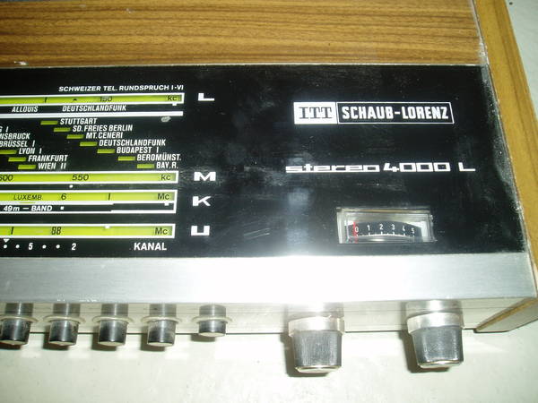

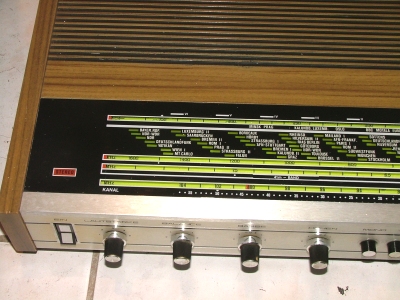

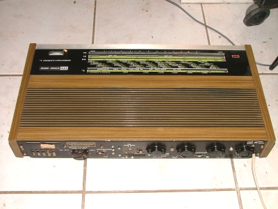

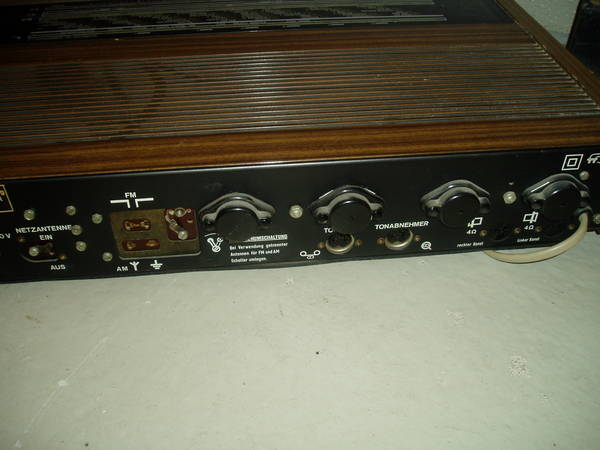

The model-No include the cabinet for the loudspeaker is "ER-123" (ER123)
I dont find any informations about the schematic and photos about the internal construction. Who knows more ??

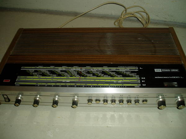

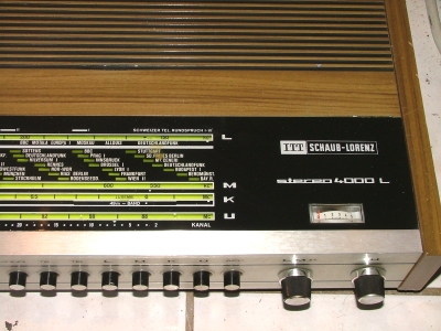

ITT Stereo 4000L 4000 52540107 and "Belcanto 300" 52540121
This internal identical devices was one of the last design with germanium power devices (AD 149) in the output. After performing service (especially relacing of verious caps) sound is clear and tight.
Some URLs, schemas and pics:
ITT, Model: Stereo 4000L (Typ 52540107)
http://www.disquantique.com/english/view_product_uk.php?product=8428
http://www.radiomuseum.org/r/itt_stereo_4000_l_nussbaum_h.html
Graetz Stereo - Steuergerät (New-German: Receiver) "Belcanto 300" (Typ: 52540121)
http://saba.magnetofon.de/showtopic.php?threadid=3998
http://www.radiomuseum.org/r/graetz_belcanto_300.html

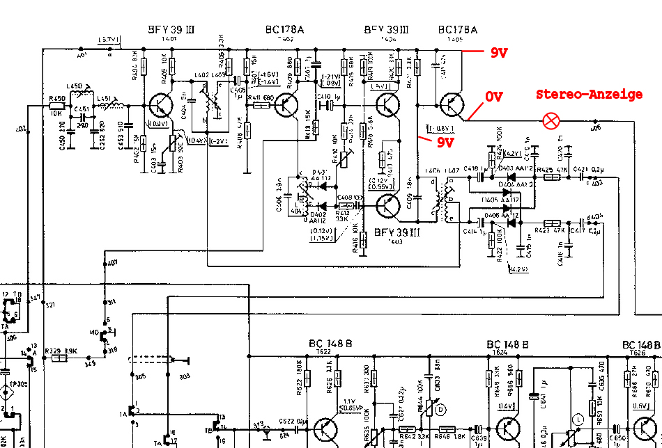

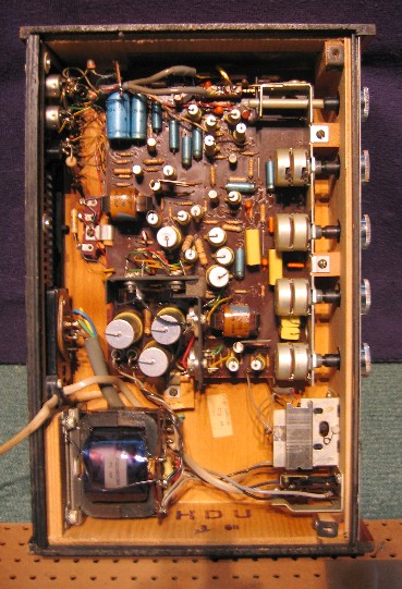

I have an 1144 that I bought new in 1967. It still runs well with the exception of noisy pots and dirty switches. The indicator bulbs are burned as well.
Just downloaded the manual. I could take new fresh photos if anyone is interested.
I love this little amp. I have used it only to occasionally test speakers in the last 20 years, but did use it continuously from 1967 to 1990.
I am planning on replacing the indicator bulbs and freshening it up soon.
