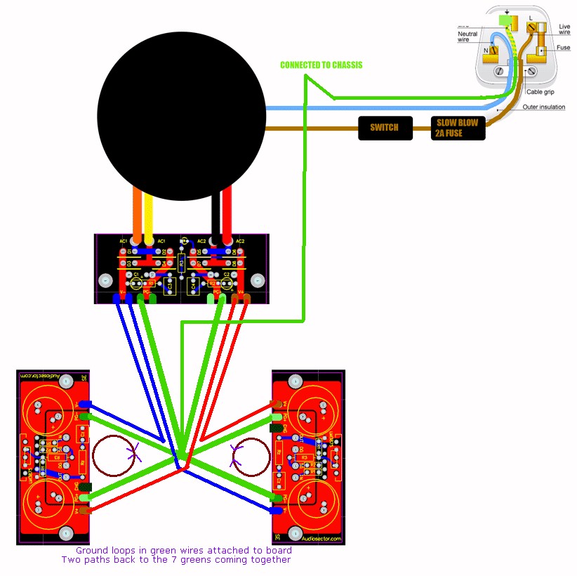

Your right, it is for the audiosector kit, same amp boards, different PSU board. It is always going to be a compromise with these boards connected in stereo. Audiosector try to create a single ground by connecting the two ground planes.
Connect the speakers and inputs as indicated on the amp.

that's the same thing , shows double wires but un-centralized at the PCB.
what wrong with balanced plus and minus supply pairs and a separate chassis wire for each PCB. like it was designed for?

use twisted pairs 2 sets, one for + one for - for each amplifier. (keep star ground at the PCB)
add a chassis wire for class I to each amplifier at PCB ground. ( experts will keep floating from chassis if you have a rated XFMR and are double insulated on mains side. ) should your class I build develop a hum when connected to sources, insert 10-100 ohm on both input signal returns.
note use insulated bushings on all RCA and speaker connectors so only one chassis connection exists for each amp PCB
note 2 the chassis wires for class I says use wire rated greater than the fuse and must be securely connected E.g. crimped and lock washers etc

I think you can use a separate chassis connection at the amp, so you don't have to run gnd wires so far. ( current is only under fault conditions > unlikely except for poor transformers and /or bad mains wiring techniques)

shouldn't be if your reference is the amp PCB ground plane and you don't connect another box at a different reference, in those cases I choose to increase signal level ground resistance slightly rather than solving ground loops with bus bars at the milli-ohm levels.
Not sure what you mean by "increase signal level ground resistance slightly". Are you talking about the Interconnect return or the IN GND - POWER GND connection?
I seem to remember that Peter of Audiosector shows a short thick grounding wire between the two Power Amp PCBs.
He then connects the middle of that short thick wire to everything else.
That is what appears in Mark's post61 drawing.
yes from post 59, on input signal returns insert a series resistor 10-100 ohm. probably the best place to hang it is at RF input filter oops there is none.
( should force any stray ground currents to take a "power path" instead. Eg usually neutral on mains )

Hmm...I finally get around to trying to ground the things better, and I can't find good diagrams (NOT schematics) or verbal instructions on star grounding of these things.
Can someone please point me to a good diagram/picture?
