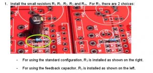

So, I asked a question earlier, about how to fix R3, and everyone threw in a ton of info. (which I can't keep up with, cause I'm a newbie).
Would you please comment on my question earlier about fixing R3? I need clarity. What's second nature to you guys is a foreign language to me. Worrying about ground planes is nice, but the closest one I can see is a 747 at my local airport.
See the attached photo from the build manual. If using the feedback cap, install *over* the first via into the one closest to SG.

That's quite good! Yes, just move the resistor a little.See the attached photo from the build manual. If using the feedback cap, install *over* the first via into the one closest to SG.

Hi
R3 the leg of the resistor needs to be moved to the next hole
ie closer to the label marked SG. this is because you have the
capacitor installed.
To get resistors out that have been soldered in use solderwick
to remove the solder and create a clear hole again. If the
resistor is now too short, obtain another 1k resistor.

Yes, Yes, thank you guys. I get it. I get it. I just wanted to make sure I got it. The word "via" didn't seem appropriate, which is why I asked for clarification. I will likely try moving R3 lead/soldering in a new resistor, but I will have to find resistors first.
