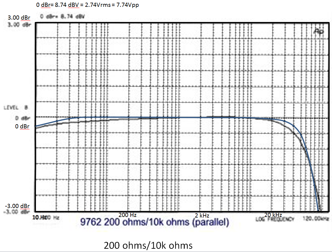

Theoretically I can make some remote comparison measurements like I did for this Sowter' transformer (compareble specs to mine): 9762 DAC Interface Transformer :
But there can be some unaccounted things during measurements at both sides ...
If somewhere in the internet there will be a straight measurement of the branded transformer connected to the real DAC chip, then I agree it will be useful to make similar measurement. AFAIK Jensen/Cimemag/Lundahl/Sowter have not use so called "nanocrystallyne" core material. From practice I know that in terms of Sound Quality it is more important than THD measurements... So that is why I believe the real listening tests gives to me and to my clients much more benefits than the abstracted measurements.
But I am ready to discuss measurements if you will point to any you want to compare with.

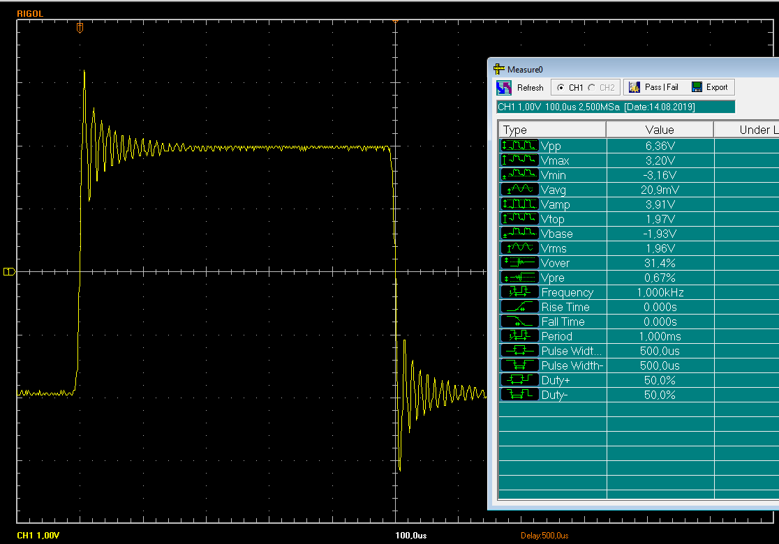

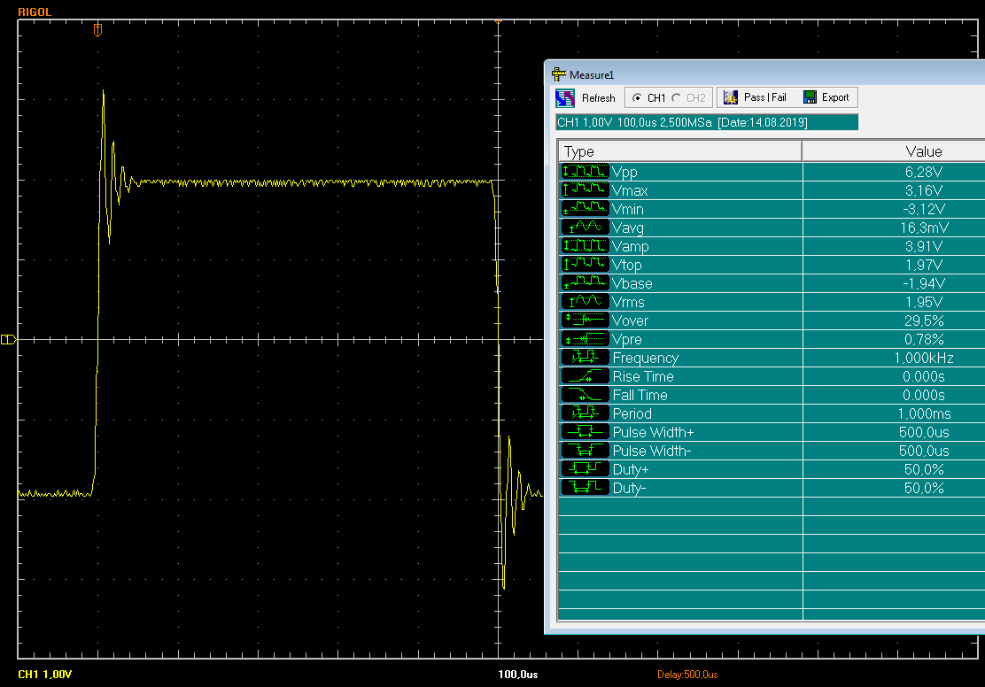

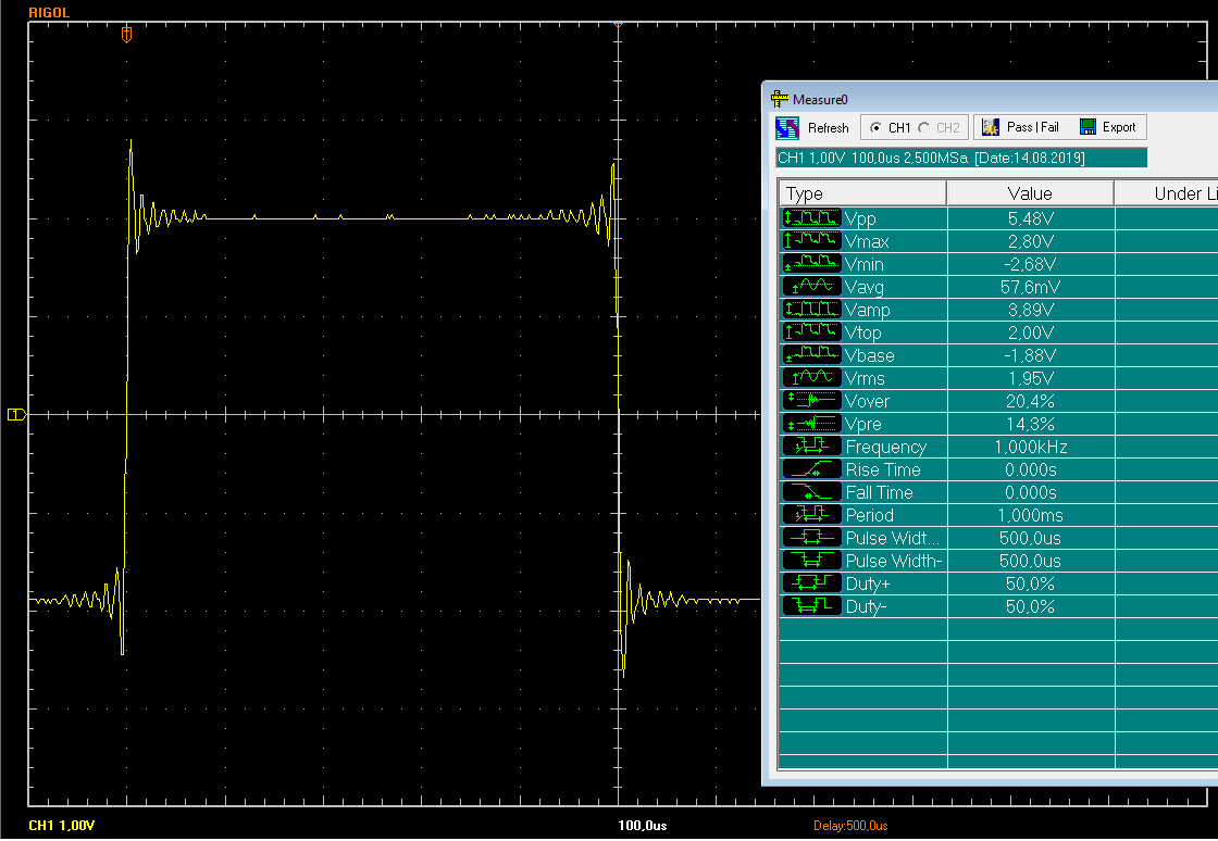

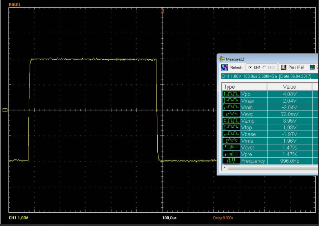

Take a look to the measurements I have made for different DACs and different digital LPFs:
1) PCM63 in NOS (no digital LPF) mode loaded to my transformer (without extra circuits after or before):

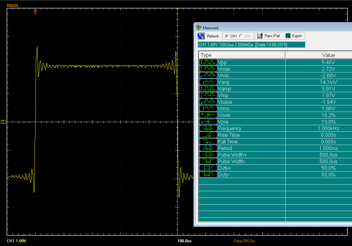

2) ES9038Q2M (chineese Smpcb 1.07) with regular i/v stage on 5532 OpAmp (factory default) in different digital LPFs (it is impossible to use NOS mode as you know):
fast roll-off linear phase
slow roll-off linear
fast roll-off minimum phase
slow roll-off minimum phase
fast roll-off apodizing
fast roll-off hybrid
brickwall filter
Just for reference: as you see the ringing issue is not the transformer's issue. But if you really need to fight somehow with DeltaSigma artefacts as LPF' ringing, then I can recommend to use RC snubber in parallel to the secondary coil.
Here are some findings:
RAWvs-Snabber — imgbb.com
As you see, it is possible to fight with ringing, but the speed of the signal will fall a bit.

Yes, there are a lot of measurements in the net, but I do not see any benefits to make such general measurements without the relation to the DAC chips to which I do making my transformers for.For example Jensen and Cinemag both have THD versus freq and level.
They also both have effect on distortion of varying drive impedance which is really important.

Can you point to this findings\discussion please?Lastly Jensen also have required termination (RC snubber) to achieve proper Bessel LPF response, IOW
no ringing or overshoot with a square wave and linear group delay.

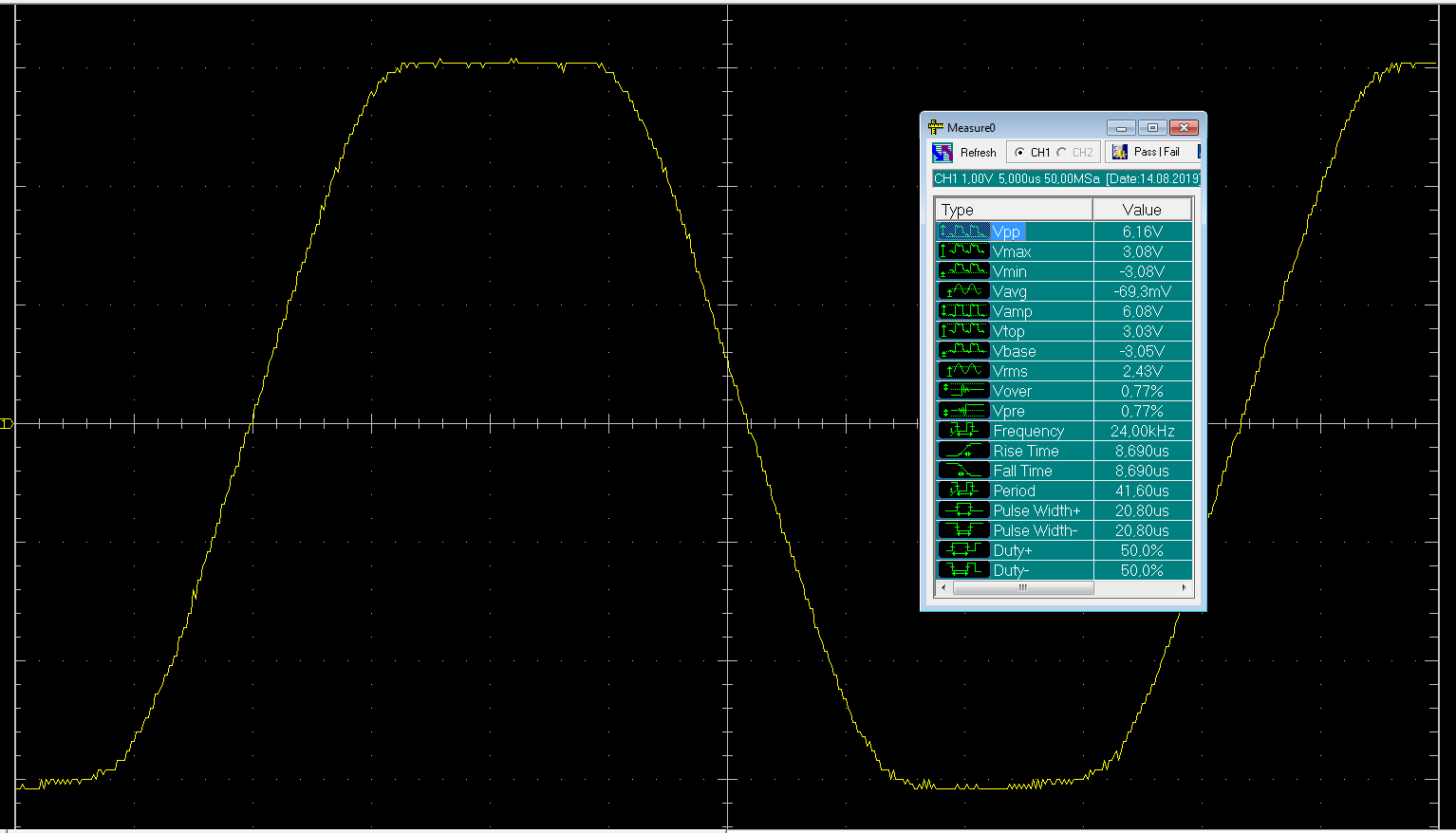

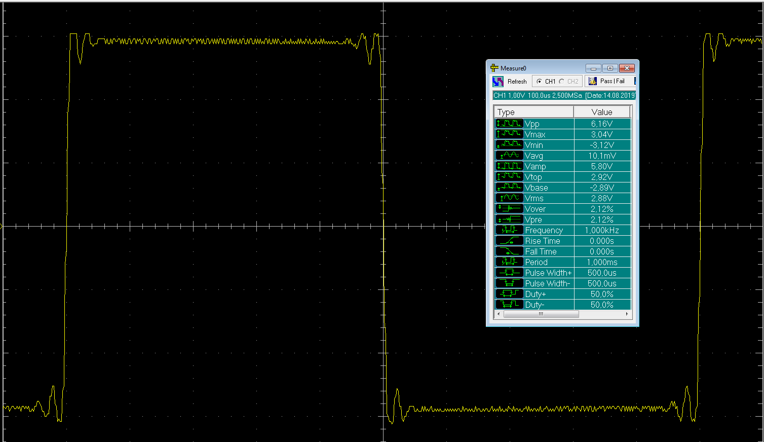

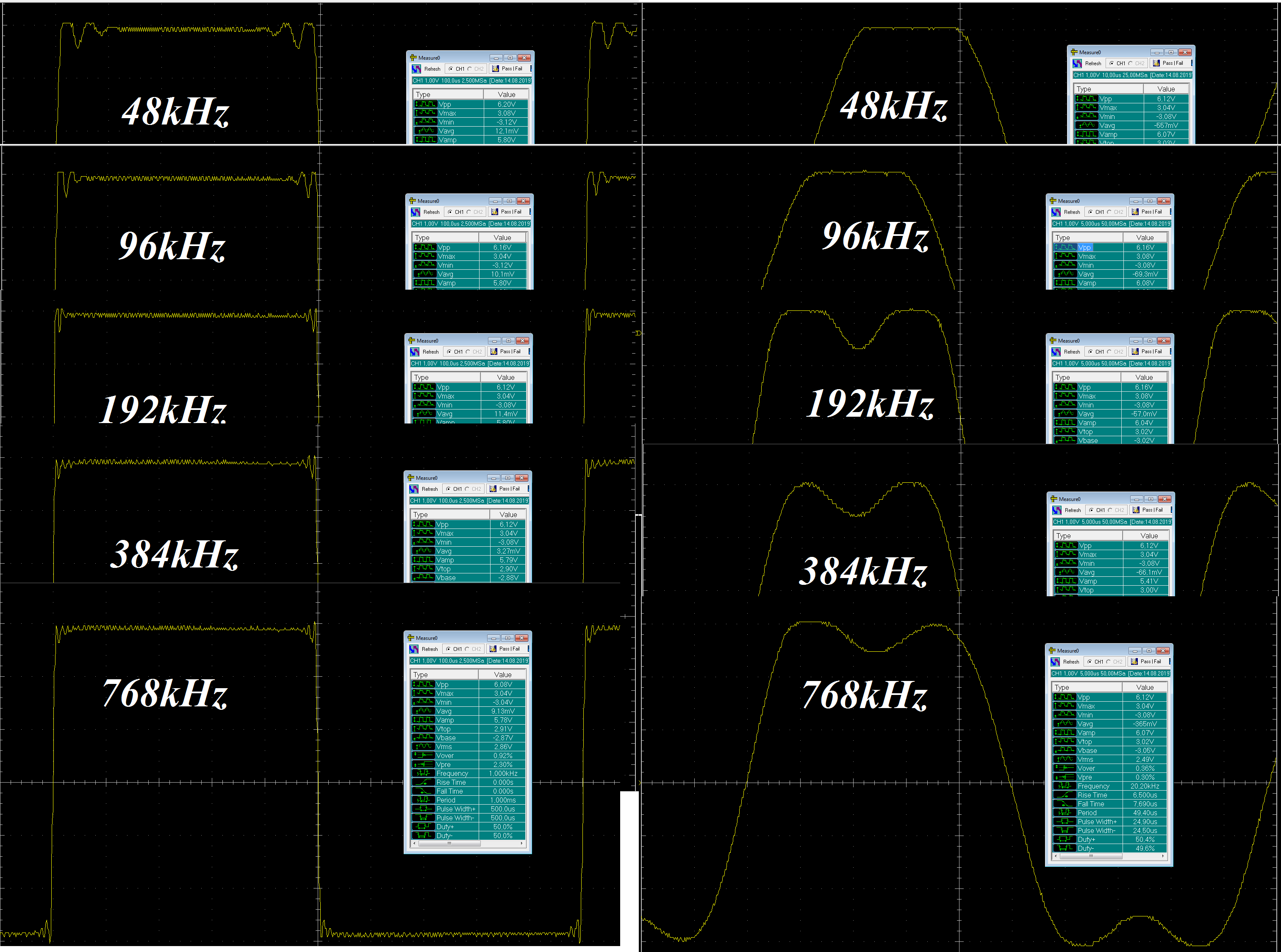

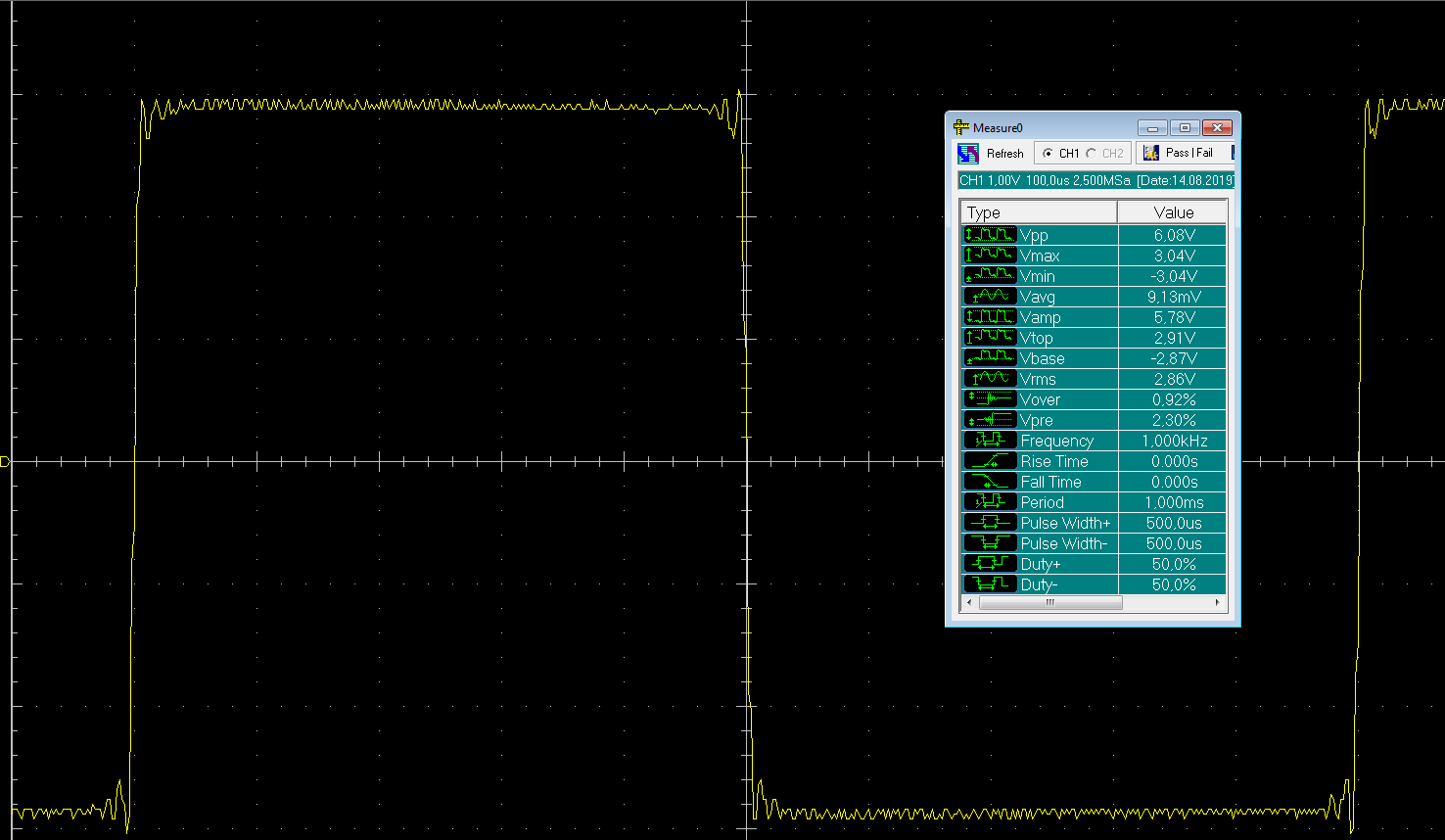

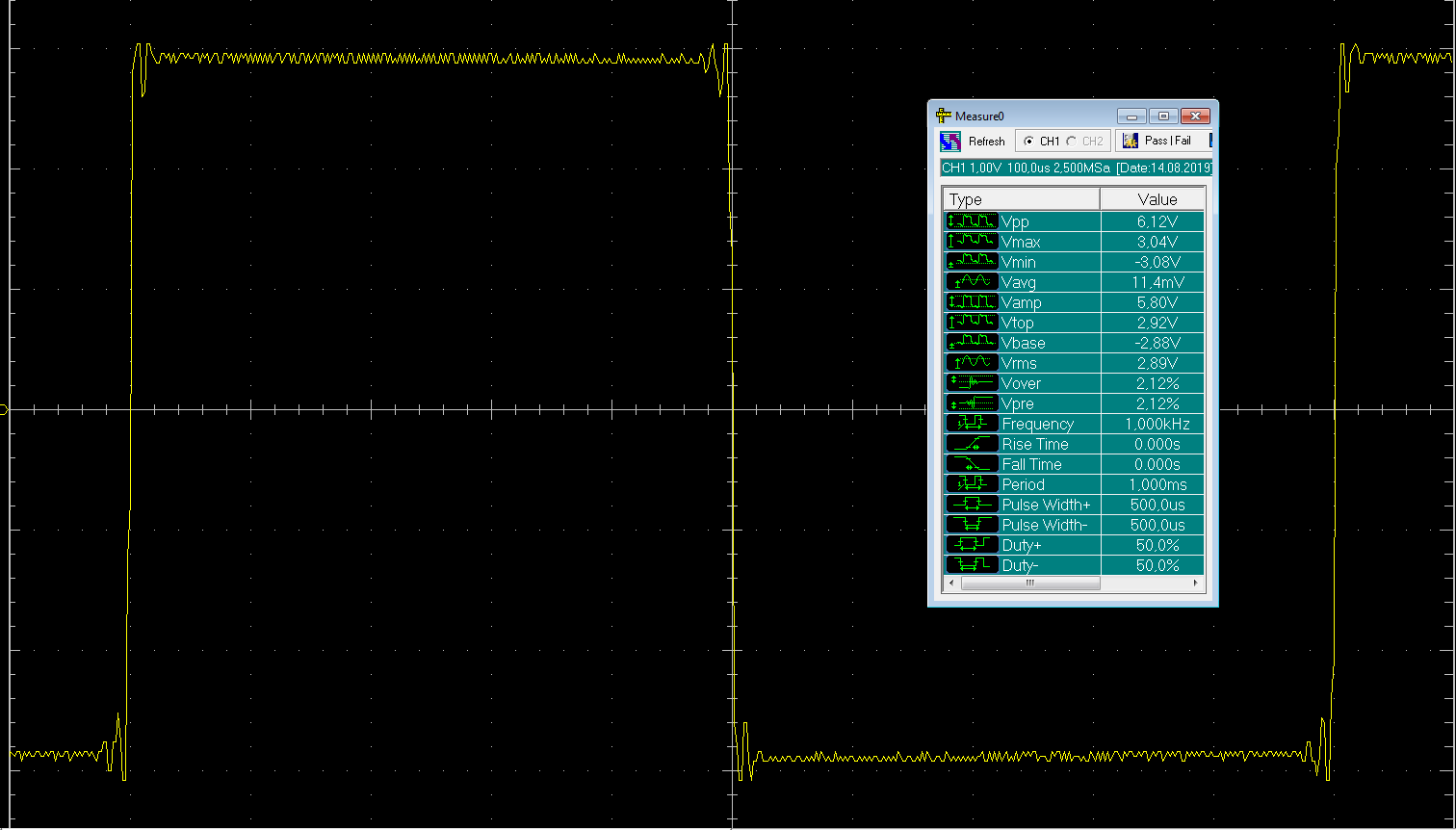

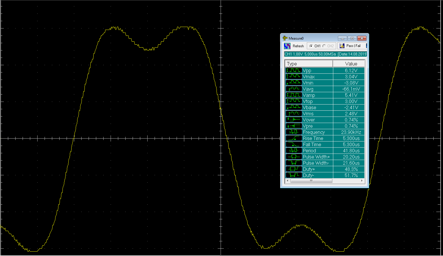

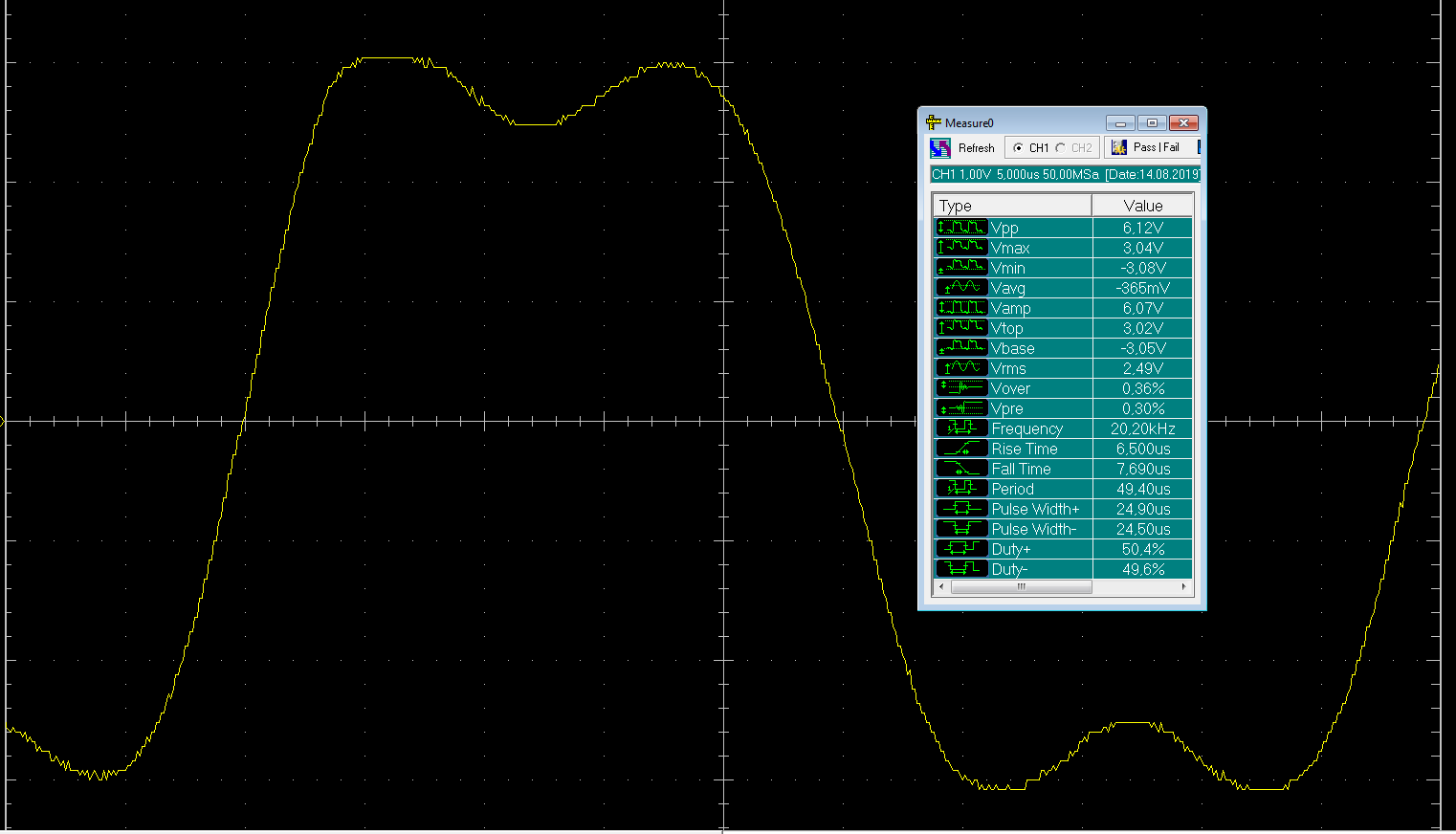

As mentioned above here I just have done the measurements of Ian's Dual ES9038Q2Mpi DAC with my transformers (3.9k Ohm load) for different source sample rates and square signals (filter is linear slow roll-off).
SR768kHz - 1kHz
SR768kHz - 20.2kHz
SR384kHz - 1kHz
SR384kHz - 24kHz
SR192kHz - 1kHz
SR192kHz -24kHz
SR96kHz - 1kHz
SR96kHz - 24kHz

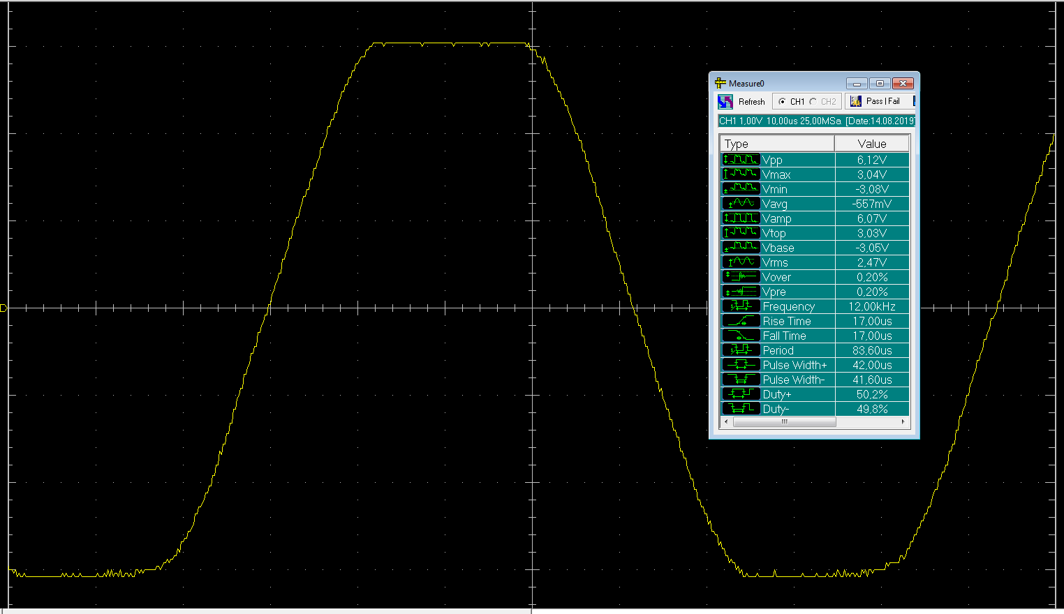

And the final, most popular 48kHz (44.1kHz - will be similar):
SR48kHz - 1kHz
SR48kHz - 12kHz
So there is a question: around what measurement do we want "to dance" trying to fight with ringing?..

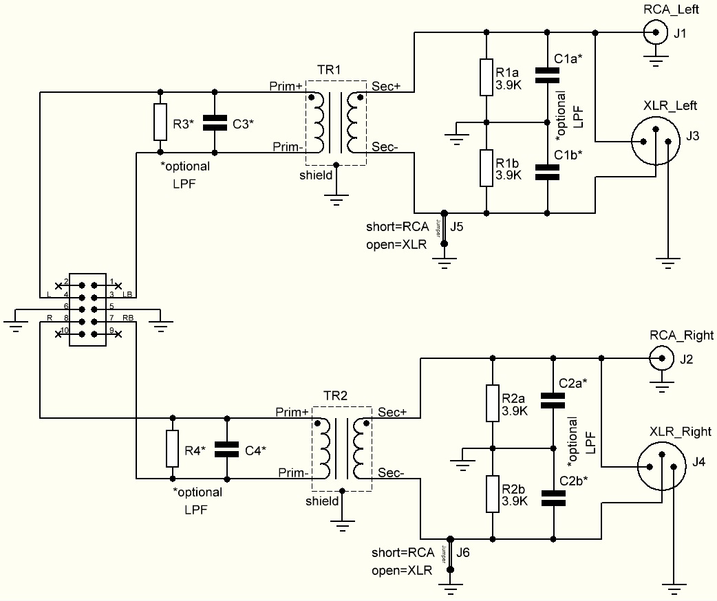

It is the first version of PCB, it was just for my experiments with LPF and i/v at the primary side of transformer (you can find similar components in Ian's LL I/V PCB (DocumentDownload/LL1544aTransformerIvSch.pdf at master * iancanada/DocumentDownload * GitHub). It is not needed normally and probably will be deleted from PCB if the next versions of PCB will occur.

Hi soundcheck,
The answer was here in #146
The given values are the impedances for targeted level: resistors R1a, R1b, R2a, R2b in parallel with the input impedance of the next connected stage (your Abletec Amp for example). Just use the values you needed to be at the desired maximum volume level. Tell me the input impedance and sensitivity of your Amp and I can tell you values of the loaded resistors.
