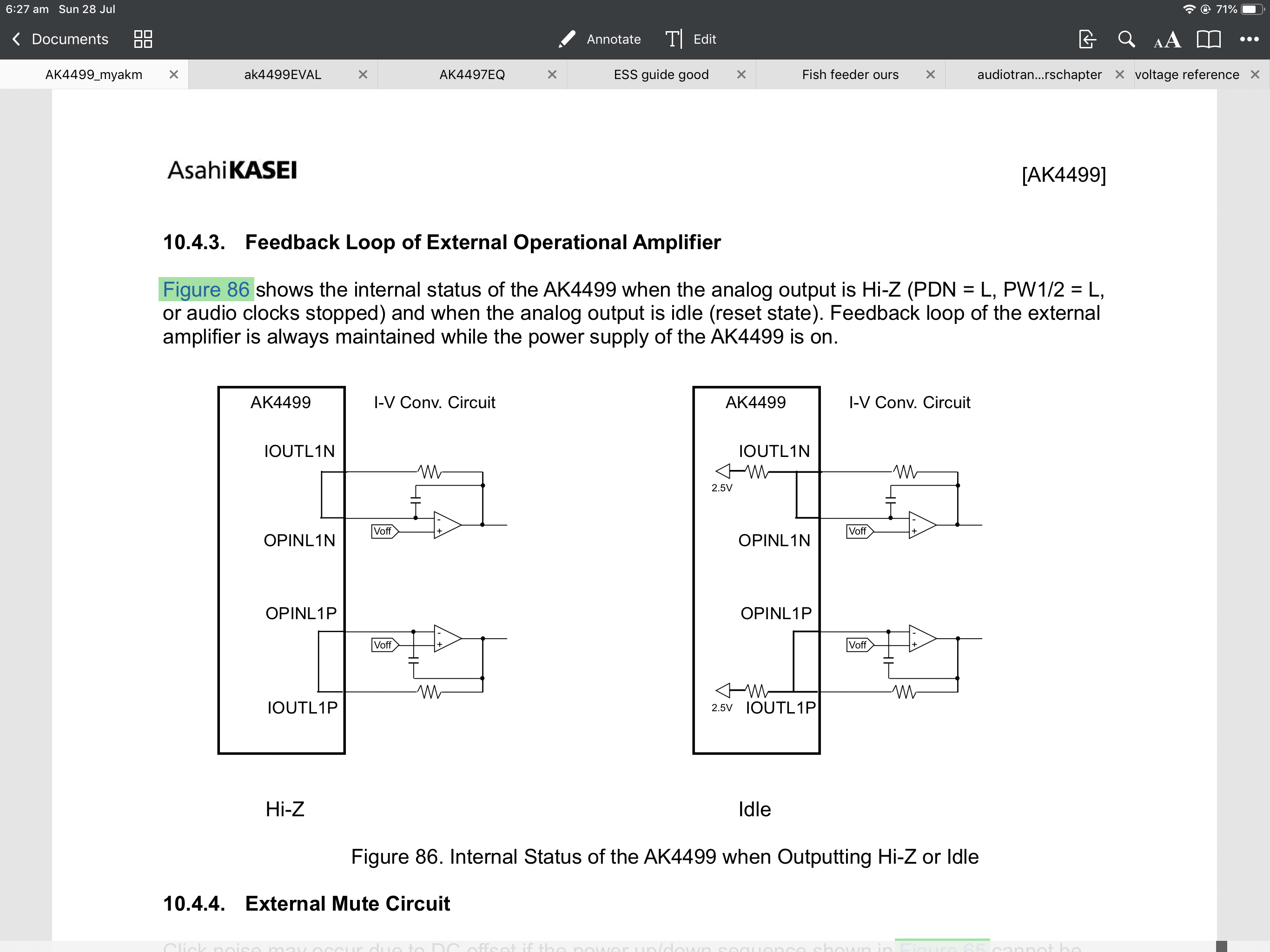

I will do the measurements tomorrow & let you know.
A bit more info.

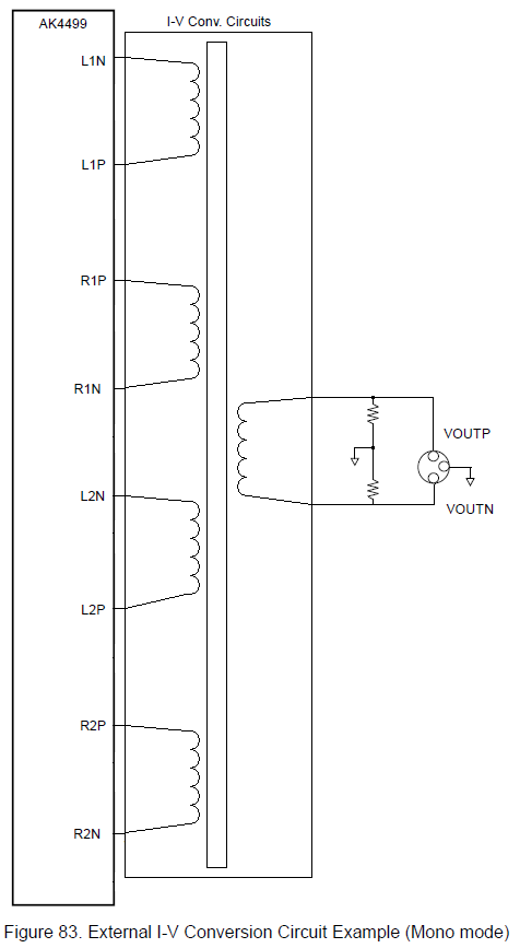

Guys,
When designing trafos for ak4499 keep in my what Taramoto found for es9038pro chip:
Teramoto FINEMET Multi tap Premium Transformer ES9038 Pro DAC (2+2+2+2 : 1+1) | eBay
They found out that is better to do the summing on the output of transformer, rather than summing them at dac level and the using transformer with one pair of input.
Now, since ak4499 has 4 pairs of outputs (2 pairs per one channel) then trafo should have 2 pairs of input and one output and the same for second channel.
It is a good idea, agree. But why I do not remember the similar findings from Ian for his dual mono ES9038q2m DAC?..
Well good point. Ian would have to redesign his dac and allow to do that. Currently outputs are merged from each chip.
Once done, Ian could write thd compensation programme for your trafos as an option :) That would be fun!
I don't remember anyone trying it yet. Ian's dac hasn't been out that long, and I think most that use transformers are using Ian's recommended lundahl one.
Sure, not long. But LL1544A and 1674 or 1684 have enough coils to make such conections. I think simply there was no tests for using paralleled DACs in such conection. Or vise versa it was done with OpAmps previously without any benefits and forgotten...
Hi Guys,
I'm just playing around with my AK4499 test board & wondering if using dual primary windings is the best way to combine channels in a dual mono setup.
The AK4499 is like two stereo DAC's so in the registry settings it is possible to set each
stereo DAC to a single channel & nominate whether it is left or right.
AKM recommends summing channels after the op amp I/V but I want to use bisesik's nice transformers & with dual primary windings it would be another simple option.
I just did a quick test using a 150 ohm to 600 ohm (dual primary) OEP transformer & it seems to work fine but its hard to gauge the sound quality on my basic test board.
Thoughts anyone?

AKM recommends summing channels after the op amp I/V ...
Can you point to this mention? Datasheet?
If you talking about point 10.4.2. External Analog low Pass Filter Example and quote from there: Differential voltage signal after I-V conversion is summed by differential summing circuit...
Then it is not about merging 2 outputs into one. It is about getting SE from differential output. I think it can be easily done by one coil.
Just checked Ian's board under a magnifying glass :D There are direct connections DACR+DACL and DACRB+DACLB directly by traces from pin 3 to 8 and from 2 to 9 on both chips. So I will try to find way for upgrading it and to break DACL\DACR and DACLB\DACRB connections for use with dual primary coils.
