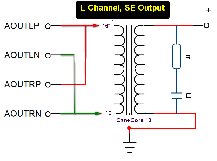

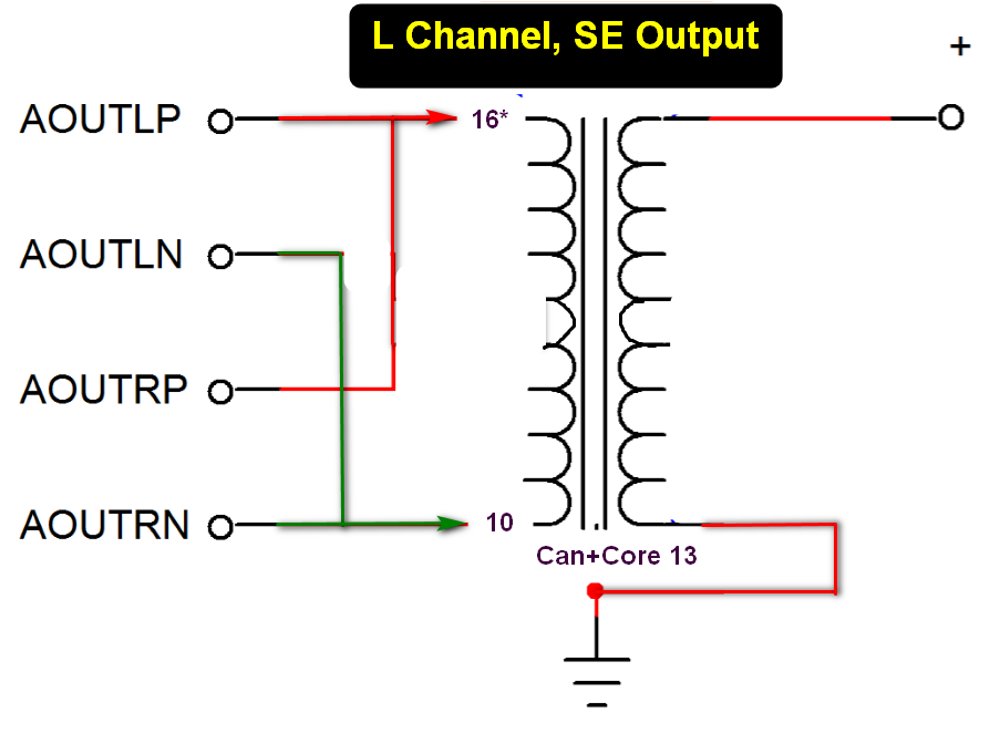

Ooops, wrong connection on schema 2, it is corrected now!
OK, with these setup 2nd (SE)/3rd (XLR), what is the new price for the 1:1 transformer?

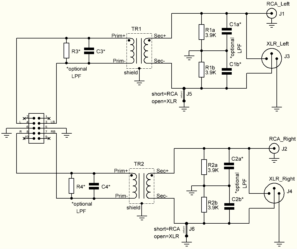

Here is the schematic of the i/v board:

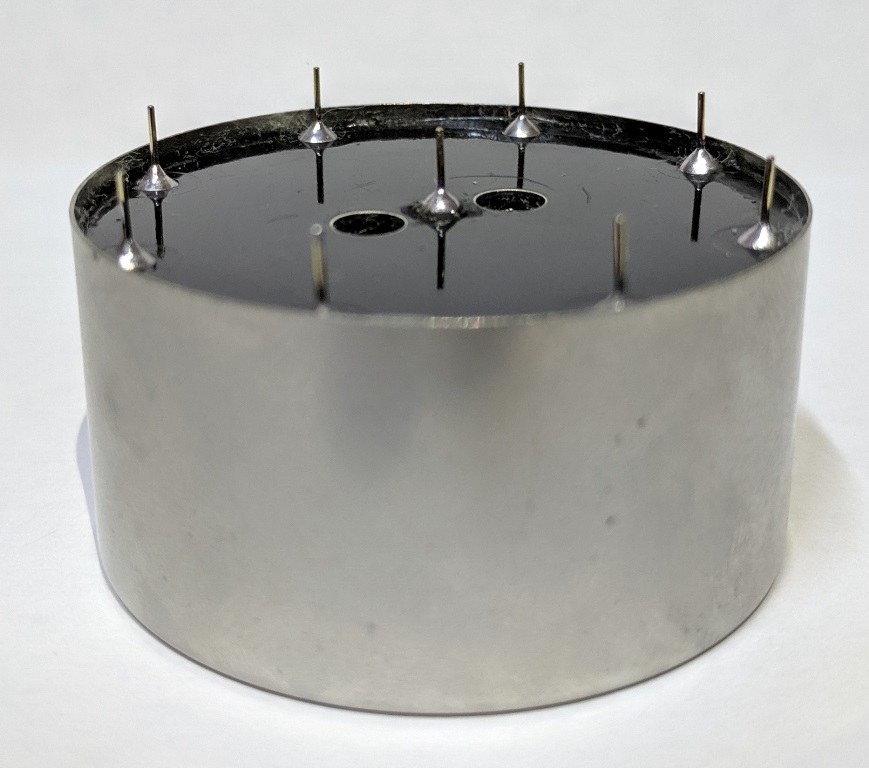

It is very interesting question. To avoid the usual answer that it acts like decoupling+LPF, I asked for TioFrancotirador to share his experience of using Teramoto transformers (same type of core material) with voltage type DAC. Hope it will be helpful.
One addition. All the next transformers will be made in PCB-style.
The center pin called shield and at diagram of i/v seems to connect with chassis.
Usually, we avoided to connect the ground of signal (SE) with the chassis because at the chassis we connect the main Earth for IEC Safety reasons.
Danger for ground loops!
What is the best practice for the center pin, from which part of transformer this pin is connected ?
This must be connected somewhere or it can be unconnected?
This pin galvanically connected to the can (shielding) - nothing extraordinary. Regular practice similar to Lundahl\Sowter\Any_other designs. The one only reason to use it - is the noise control. To use it or not - it is up to the designer (but it really helps to eliminate the grounding noise in most cases). This schematics relates to the i/v board only, usually it is simply connected ontop of the Ian's DAC and in this case we are a bit far from the finished enclosured device - usually it is standalone boards on the wooden plank 🙂
Plus and play Transformer for Ian dual 9038 q2m pro ,also can use with 9038 pro dac without mod ?
I am interested.
Suitable, except of i/v resistors in case of stereo configuration for 9038PRO (4 channels in parallel) - it is needed to lower their values in this case to be at the same output level as DM ES9038Q2M (9038PRO has 4 times stronger current output in this case).
For testing purposes a FFT can give the answer but from practice point of view, I think the best solution is a switch ON/OFF (shield to chassis) at the back side of case.
All I want to say is that the shielding pin if connected to the DAC chip' ground (to pin 11 of ES9038Q2M at least) - it helps to eliminate the noise (FFT proving it btw). All other cases including connection of "shielding can" to the chassis\enclosure\case - depends on the particular implementation and is out from schematic I shared above. It is up to the DIYer, who is building the DAC in particular case. Nobody prevent you to isolate these shieldings from the whole enclodure - just avoid the contact of "shielding can" with chasis - nothing extraordinary.
