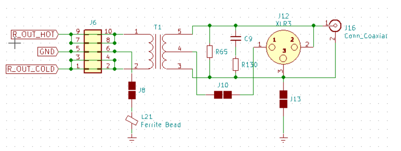

I am looking for a pair of trafos for my DSC dac http://audiodesignguide.com/DSC1/DSC1a.pdf
The ones that I use right now are a pair of chinese that you can find easily 2PCS / 10K:10K permalloy audio isolation transformer, balanced and unbalanced conversion audio isolator-in Transformers from Home Improvement on Aliexpress.com | Alibaba Group .
This is how the manufacturer advise to use them:
And this is how I have them connected in my dac:
It seems those trafos work better when the load is about 5k-7k , so I size R56 according the the preamp input impedance to have that value.
The designer of the dac also recommends Lundahl's LL1527XL/LL1684.
I was wondering if your transformer could be used in my particular application, particularly because they are made with nano-crystalline.
I would appreciate your comments.

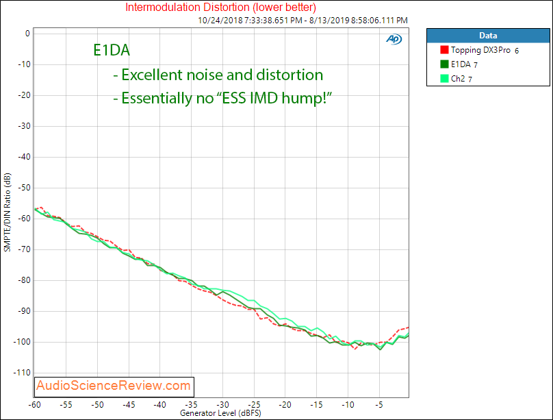

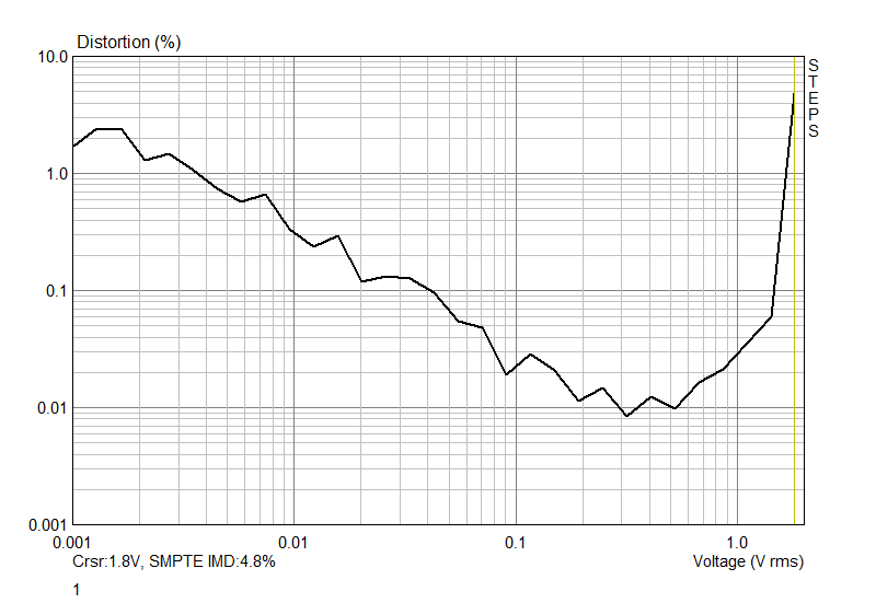

But i didn't found the way to use different soundcards for input and output within "Steps" of Arta. I mean I can't measure on Ian's DAC, because there is no spdif input on it while my soundcard have no I2S output (spdif only). I can measure on chineese board (well known device from smpcb v1.07) via spdif out\line in of my soundcard, but it has strange IMDvsLevel measurement even for stock output on 5532 OpAmp. Too bad totally compared to what I see on picture provided by lemon aboved:
Actually this graph is for 9038q2m without my transformers - it is for stock version on 5532 OpAmp output. SMPCB board sounds much worse compared to Ian's DAC (they are simply from different leagues) that is why I suggest it doesn't matter is there hump on SMPCB or no. If I will find the way to make this test on Ian's DAC, then I will post it, but before this happens, this test gives nothing nor about my transformers nither about DAC and getted sound.
Thx eslei and lemon.
Have you tried the Asio4all as driver?
Usually, you can combined different cards as input and output to one measurement.
