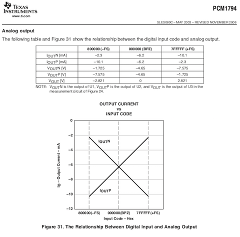

Different output currents - different i/v resistors for the same targeting Vout - simple story. Regarding 1794. Simply use the same values of both poles i/v resistors - and there will be almost no DC-offset across the Pos and neg poles (as the offsets for neg and pos poles has the same value including sign). Connect the primary coil between pos and neg then - that's it.
Regarding specs. I have some technical data, but for some particular trafos versions only. Measuring and collecting info such you described is boring process for me in most cases, so I prefer to interact with the customer on the level of the real project implementation. In such a case the knowledge of electrical parameters you have described is really fades into the background. Parameters are just parameters. They matters for sure, but in most cases within my own transformers, for my own internal needs. I don't want to fight windmills, I have no time for such.
There are -6.2mA of DC component x 4 times, creating offset at the Riv @ direct output?
This produce -0.62Vdc off-set @ 100 ohm Riv resistor. And this -0.62V will run trough the primary of the transformer. If the transformer core is from high permeability (probably is) this can produce core saturation and magnetization.
This is specific only for this dac chip model...
Zoran, you should understand that there is no offset between pos and neg poles. Primary coil has no deal with the gnd, so the real offset that can be found between the pos and neg poles (between Ioutp and ioutn) relates to the internal imbalance of the DAC chip between the two poles output currents. In real it is less than 5mV with the Ra/Rb iv resistors with 1% tolerances. You can make it even 0.0mV if needed by adjusting the Ra/Rb values.

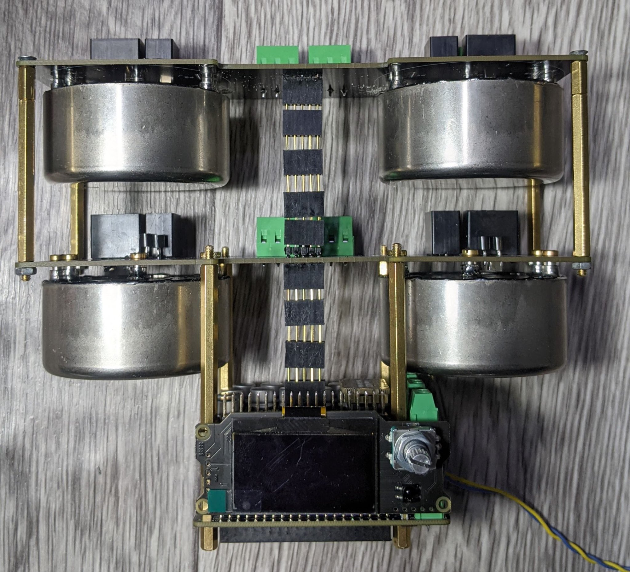

Here is an example of how to "scale" my trafos/buffers boards (using iancanada's DAC II for example, but it works excellent with any other current output type DACs) to allow DAC chip to work on to the very small i/v resistor with the high enough voltage output level after my trafos (boards). Active stage is mandatory (+/-15V) in this case.

Hello,
I would like to connect Headphones (70 OHM Audeze LCD-2) direct and balanced to an Ian Canada DAC (dual mono es9038) with your transformer board. Would this work well (impedance match?) or should I go preamplifier --> Headphone Amp?
thank you
Branko
Hello Werner,
Please use 100R across the primary with ~13k across the secondary coil instead of 4k12 across the secondary. 100R resistors should be as good quality as possible. Wirewound or AN tantalum/niobium or Z-Foils, etc high quality audio resistors.
Sure you can use trafos with D3 or DDDAC.
Ivan.
