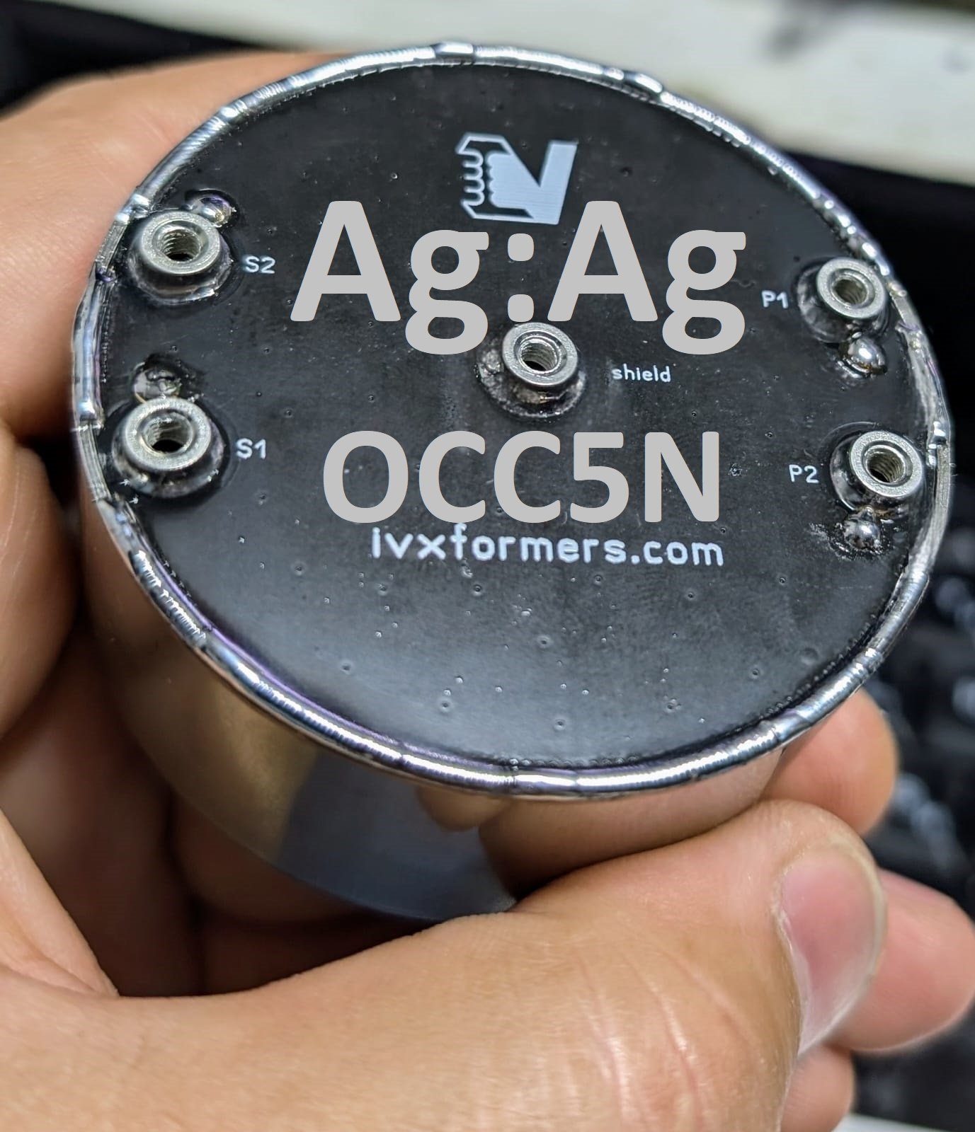

Silver version (OCC 5N) is available for ordering. Initially designed for LOMC cartridges, thus suitable as an after-DAC transformers as well.
Actual prices: https://ivxformers.com
