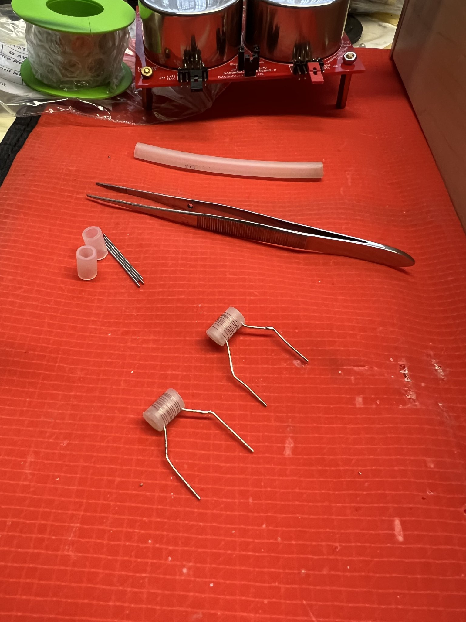

Making resistors for the first time with Constantine wire…a challenge with my less than perfect vision and shaky hands.

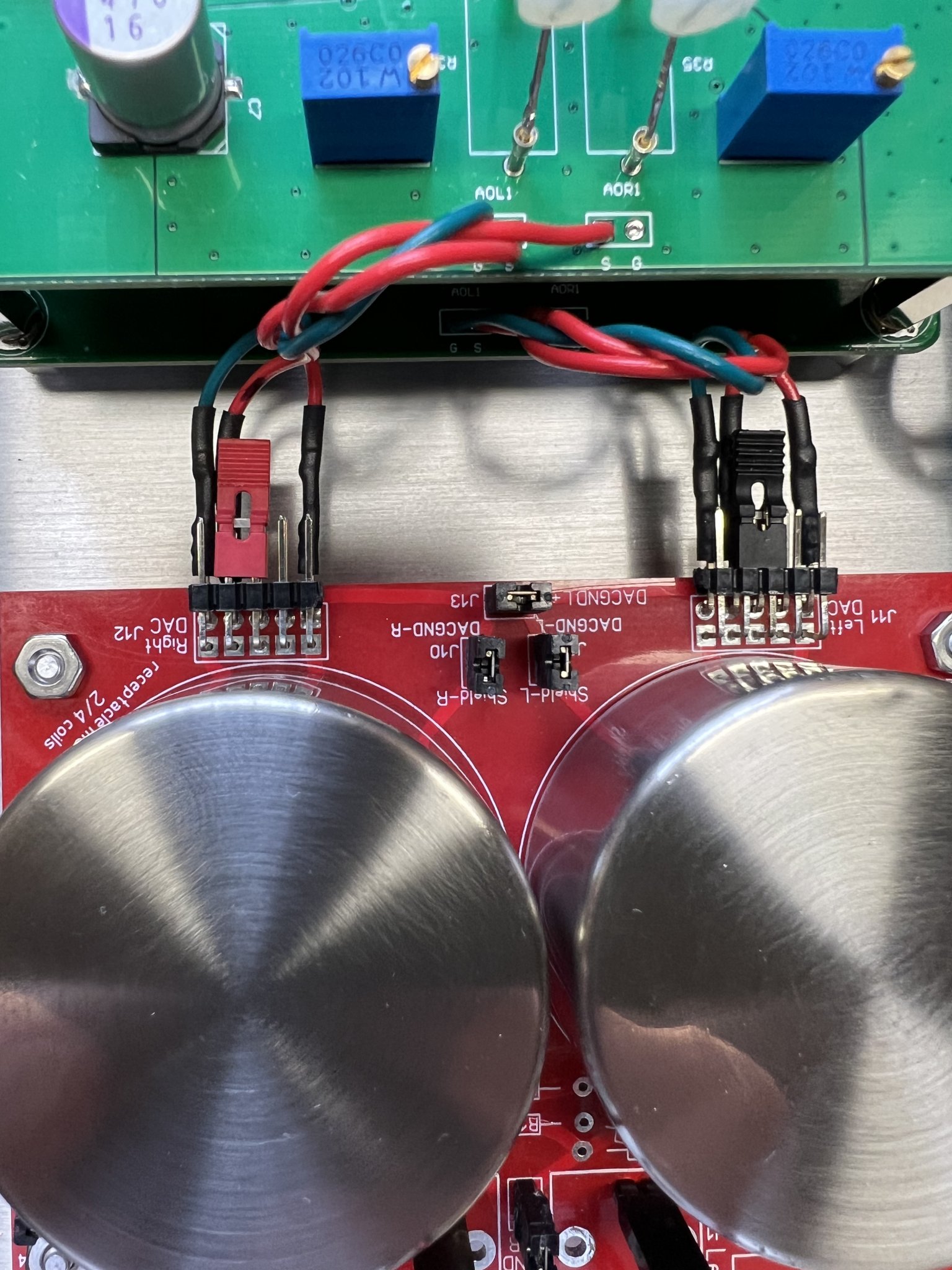

Hi bisesik

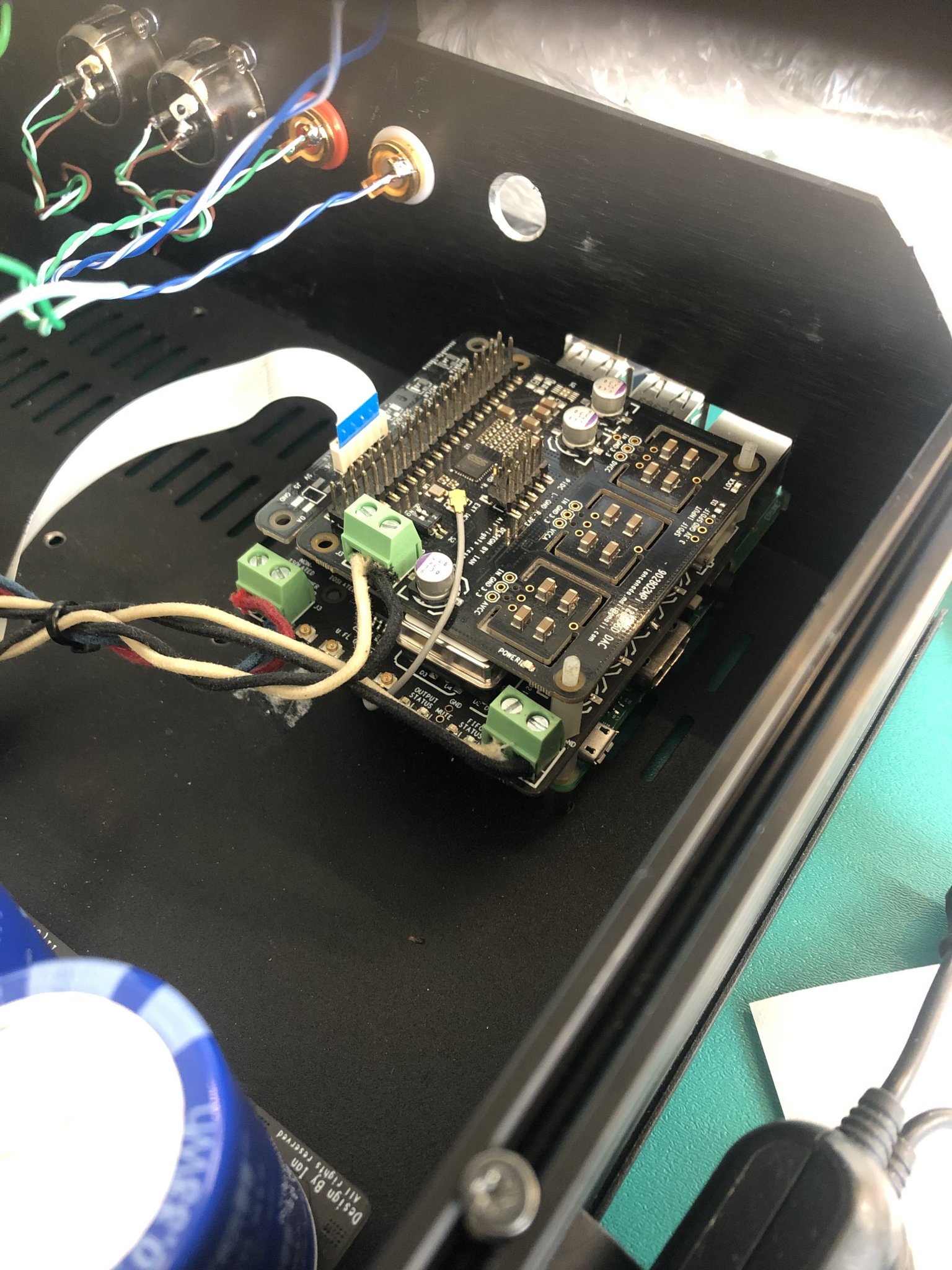

I finally have the transformers installed, wired up and have done a test with music after spending time changing things in my DAC to make it possible.
I am having a problem with buzzing noise coming from the DAC now.
It gets louder as I turn the volume up.
It even causes buzzing in my system when I power the DAC down if I leave it selected as the source.
The only time it goes away is if I select a different source or disconnect the RCA cables from the DAC.
I don’t know if I did something wrong with wiring , grounding or if its how I have them installed in my case?

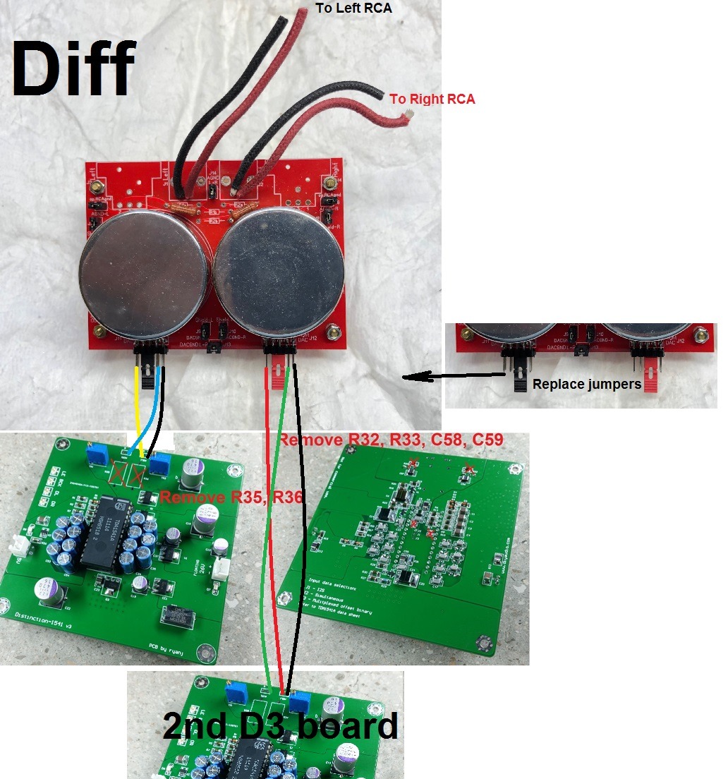

I followed the example illustration you posted for me (pic) to wire the output of my pair of D3 boards for differential output.

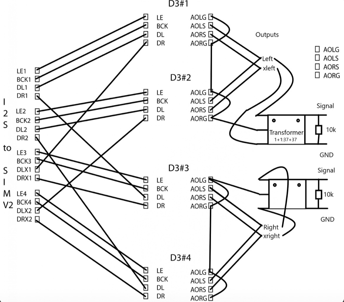

I also searched the D3 thread and used an illustration Ryan posted there (pic) explaining how to make sure the signal cables are connected properly between my I2S to Simultaneous board and D3 boards for balanced output…which I assumed was necessary for differential connection to the transformers.
I removed the 11k iv resistors on the secondaries of the transformers that were installed.
I then installed the wire wound 25 Ohm iv resistors I made on the D3 boards on the primary side of the transformers.
I haven’t removed the current injection resistors and caps on the D3 boards yet. After I installed the new iv resistors I retested and nulled any DC offset at the outputof the D3 boards (it was barely .5 mV).
I’m not sure if I was supposed to bridge or change any of the jumpers on the transformer board (except at the input which I did as you illustrated)…otherwise I left things alone.

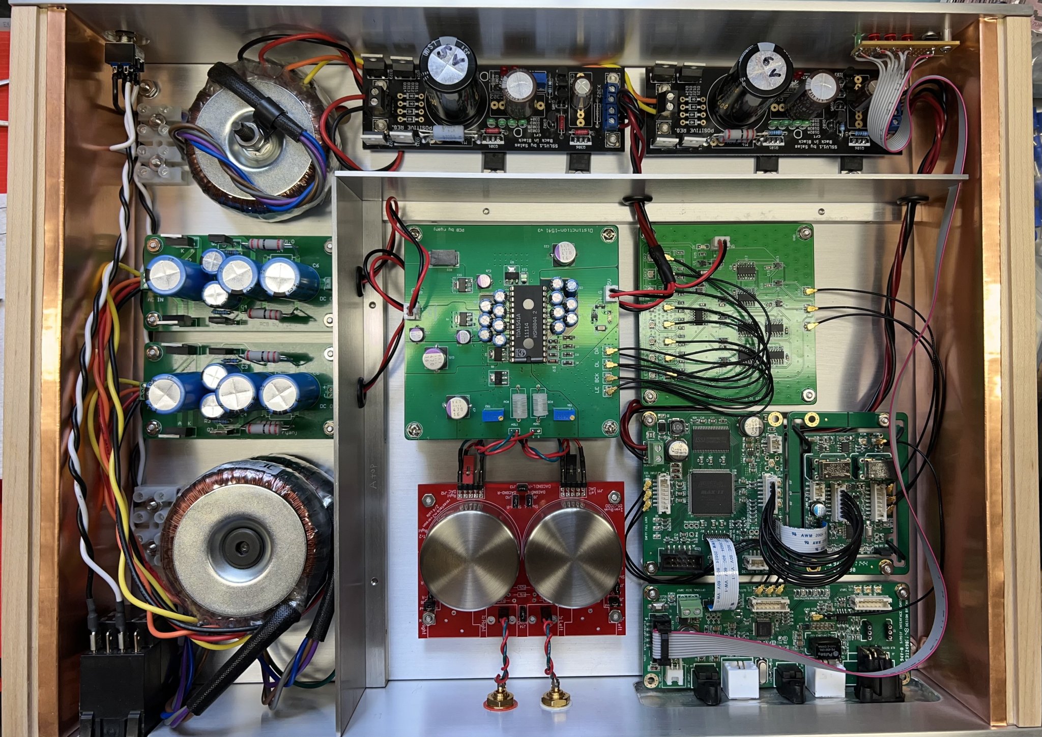

I’ve posted some pics of how things are currently installed and connected.
I hope you can help me troubleshoot the problem.

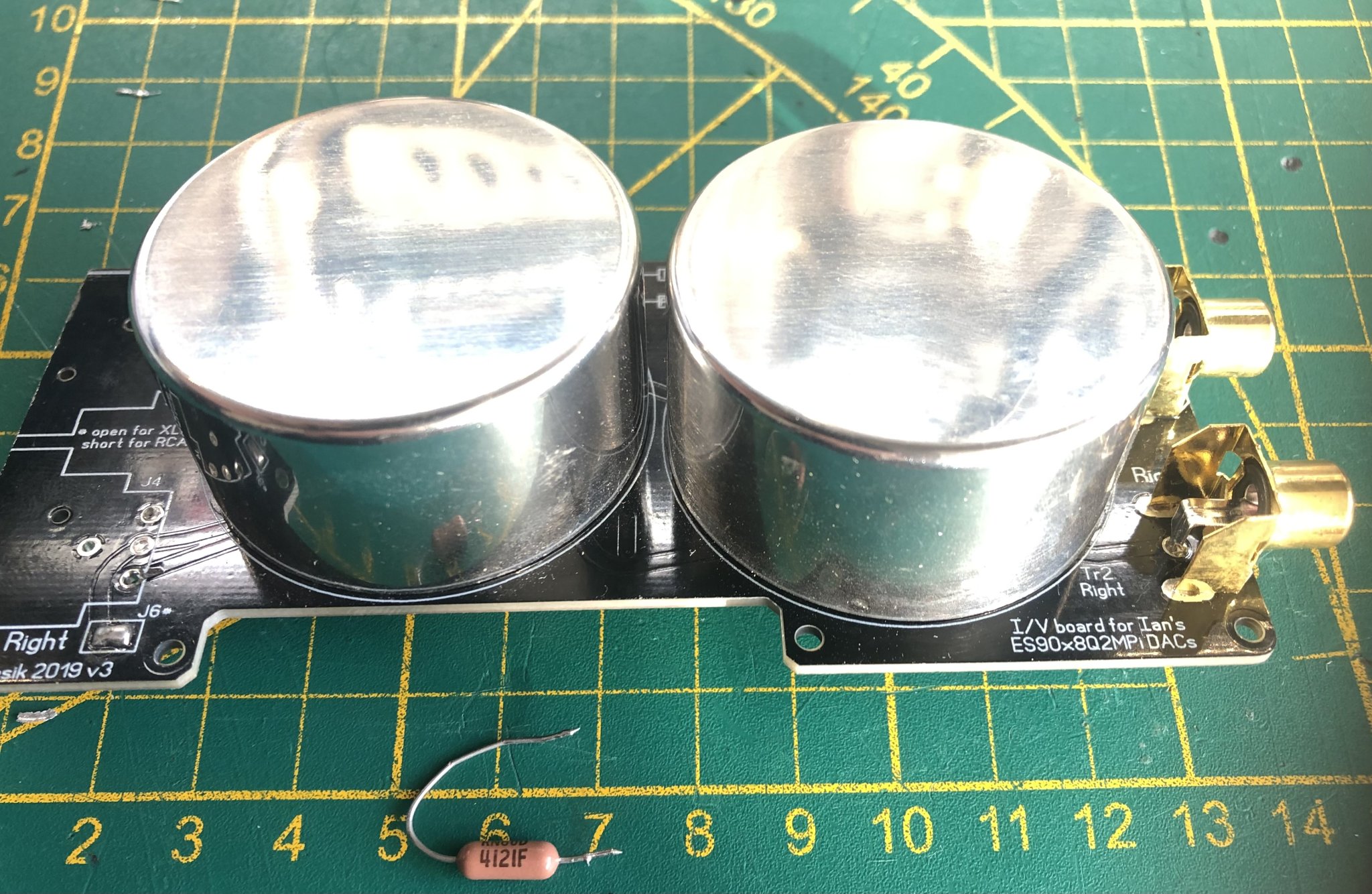

Some years ago I ordered the IV board for Ian's 90x8Q2M dacs (bisesik 2019v3). Still working fine. My questions:
  • What is the best I/V resistor value? There are some stock Dale's 4k12 in now on the secondairy site.
  • Can I use these trafo's for my other Ryan D3 TDA1541 DAC and 4 deck DDDAC?

Hello Werner,
Please use 100R across the primary with ~13k across the secondary coil instead of 4k12 across the secondary. 100R resistors should be as good quality as possible. Wirewound or AN tantalum/niobium or Z-Foils, etc high quality audio resistors.
Sure you can use trafos with D3 or DDDAC.
Ivan.
