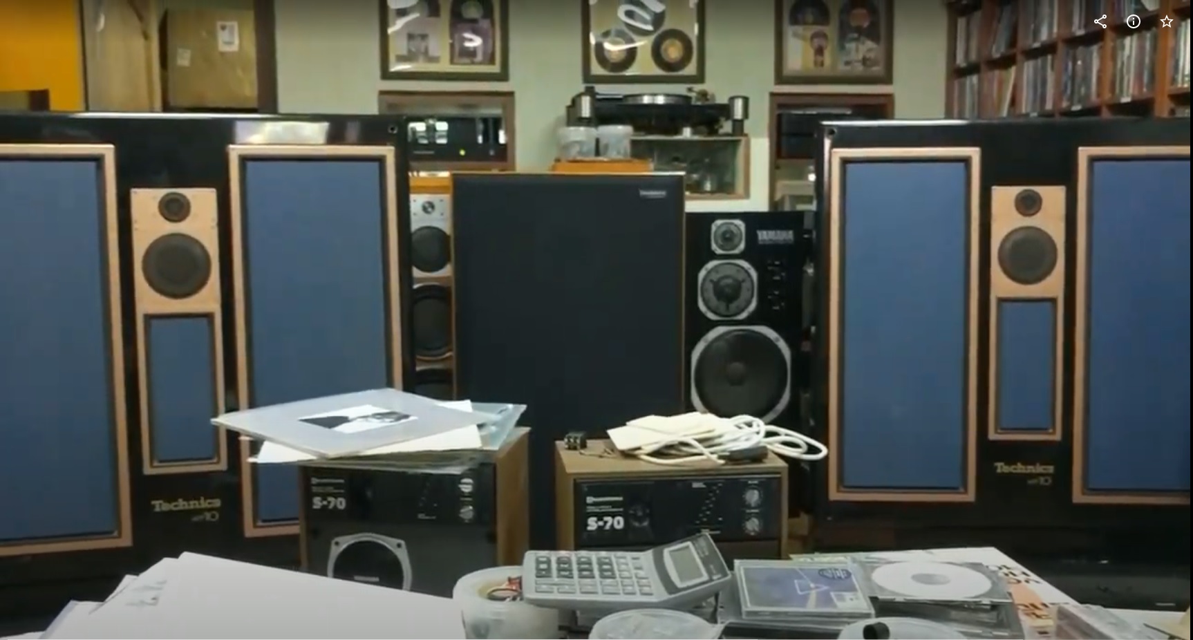

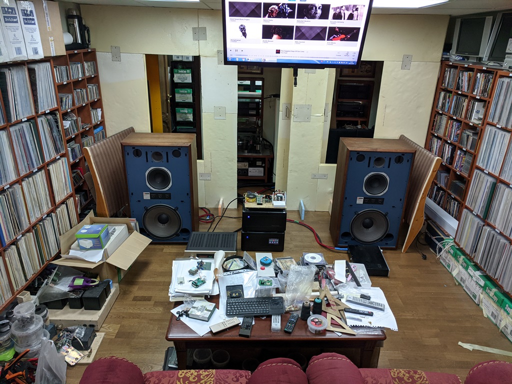

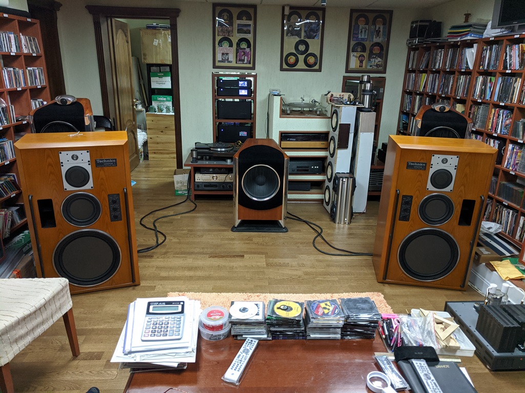

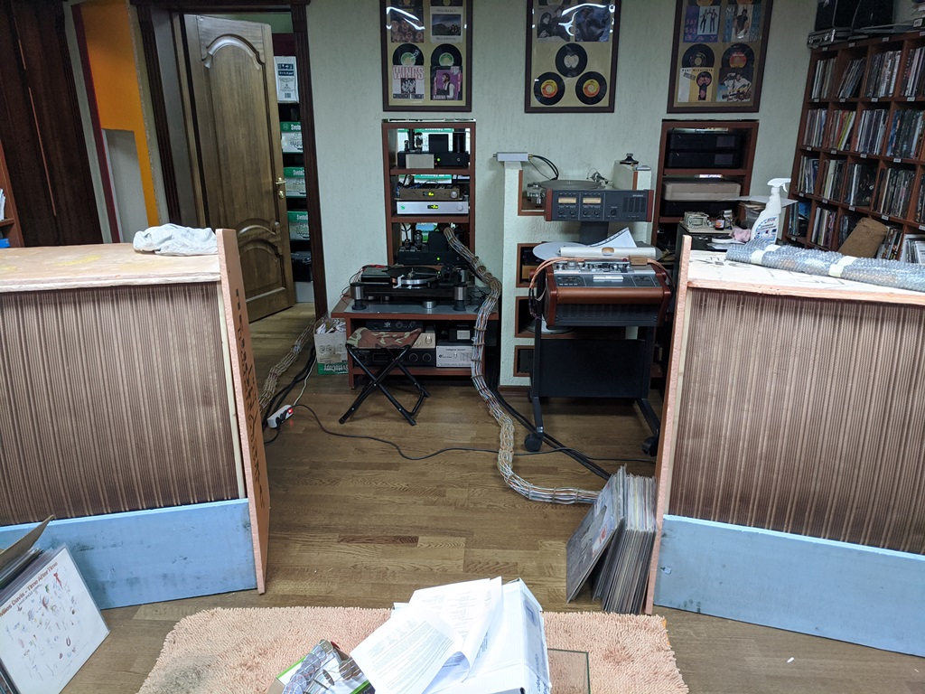

Can you tell us more about your system?
Well, it is easier to show. I have another larger room and it sounds better there for sure, but I prefer to have access to it 24/7 rather than negotiating with my household every time I need to check this or that. So this tiny room (~9 sq.m.) is the technical room at the same time.
Video (xiaomi A3) is exact the moment of the record takened by ribbon-mic, showned on previous post.
Shared album - ???? ???? - Google Photos
I do not limiting myself by my system only. I have access if needed (and time to time it is really needed) to many "cool enough" systems of my friends/familiar as well.
Thanks for sharing the photos, some interesting systems there.
What drivers do you have on the open baffle? Did you use these to record the bass demo track? (LF_sample_160.mp4)
Panels are the NXT technology of some russian guys. It uses so called shakers. Dayton may be? I don't know. Yes, LF_sample_160.mp4 is exactly what is shown in video, smartphones are simply can't record LF as professional mics.

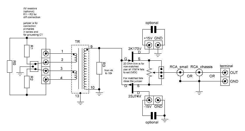

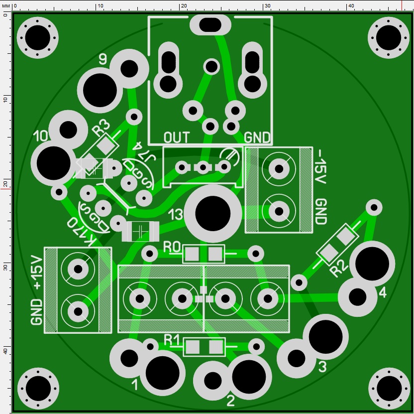

Here is the version of PCB using jfet buffers. SE output ONLY.
Some tips:
1) To have quick access to both PCB sides (for jumpers re-settings, components resolderings, etc.) it is better to have possibility of transformers dismounting using the receptacles:
5391-0-15-15-07-27-10-0 Mill-Max | Mouser Europe
2) M3 spacers 4mm in height for proper gap between PCB components and transformer plate will be needed to place as well.
3) Better to use a matched pair of 2SK170V/2SJ74V (output impedance better, no offset) instead of using the trimmer between transistors Sources (for set zero output offset).
4) For better thermal/current simmetry stability it is better to tight this pair of transistors together using a copper foil and/or small radiator.
5) The PSU quality is VERY important. Based on my experience I highly recommend to use UCs or/and battery PSU for powering jfets.
All the corresponding files (CAD, gerbers) can be found here:
View attachment jfet.zip
