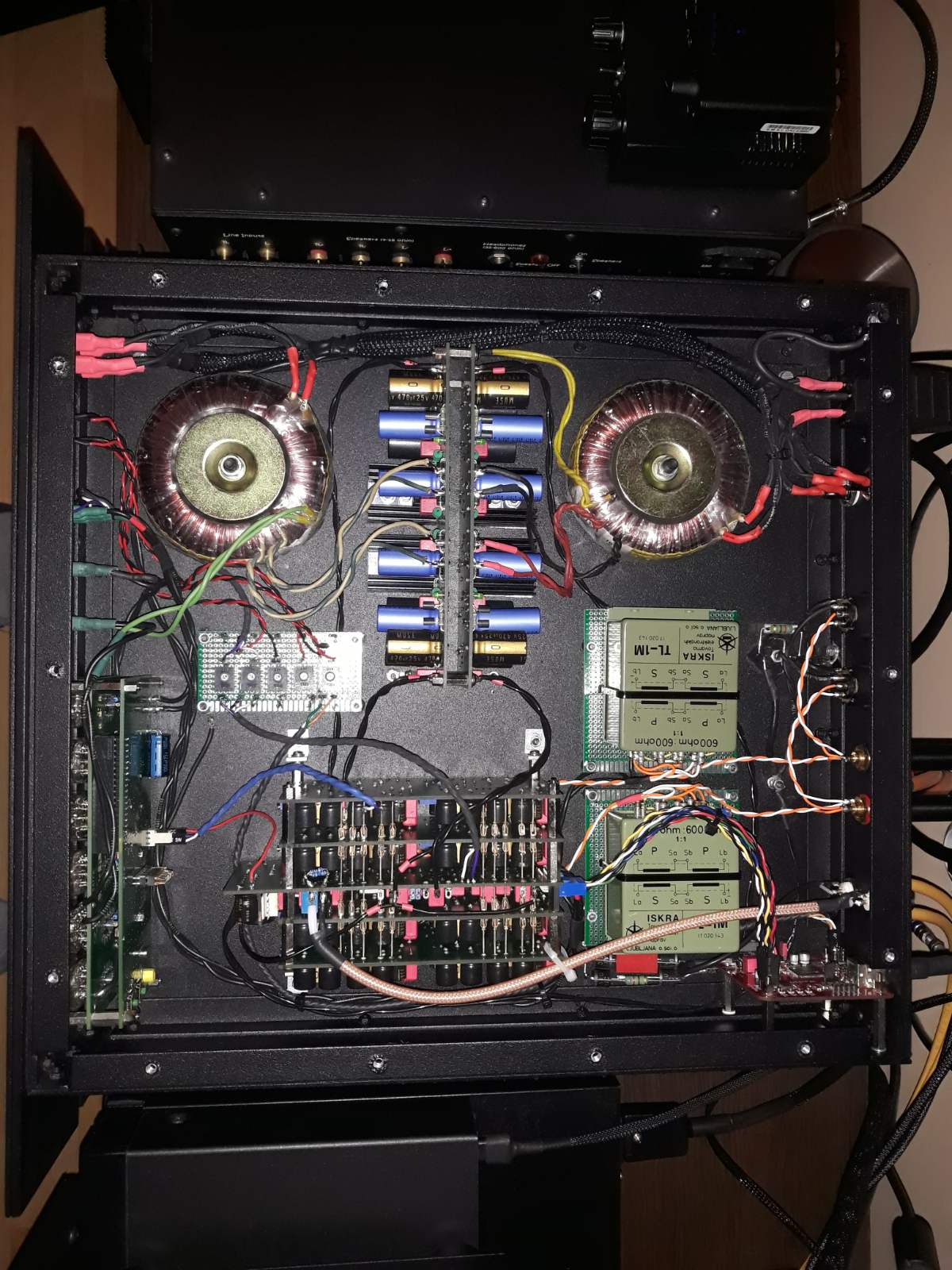

@kartick, I've calmed down for now with ISKRA transformers 1:1 at the output. They are wound on a torus, inductance 1.4-1.5H, ohmic resistance 20ohm. The bass is very good with 4 decks, they sound a lot better than Cinemag. ISKRA (used) I paid locally only 30eur/pair. I will follow developments with your DDDAC regarding output transformers.
My estimate is that the ideal transformer for a DDDAC with 4 decks should have a primary of about 3-4H, and with 2 decks around 6-8H due to the frequency range at low frequencies. Sowter is at primary 3.4H and not 0.7H as you wrote. With just a couple of mV DC offset, there is no problem with any transformer, aig gap is not required.

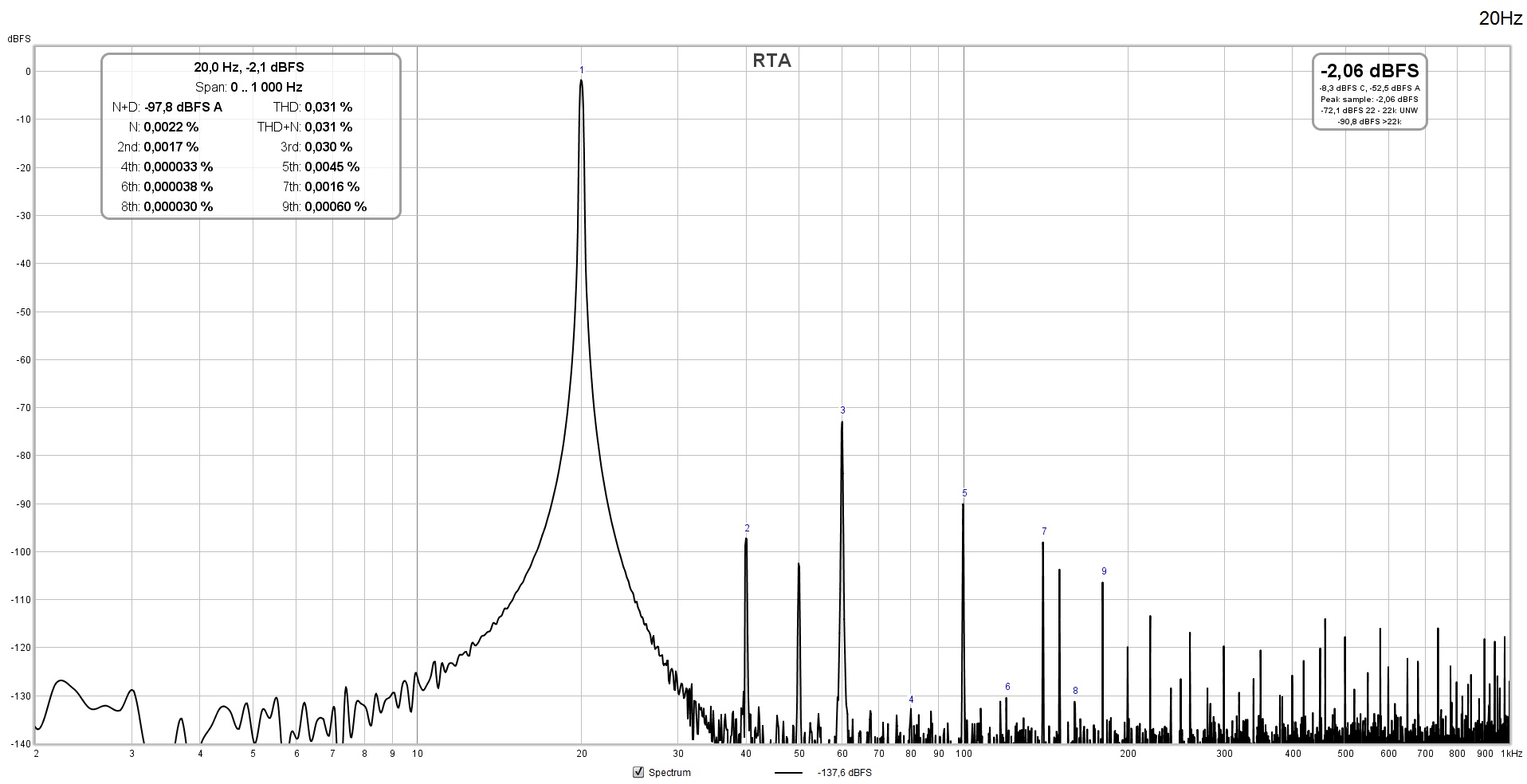

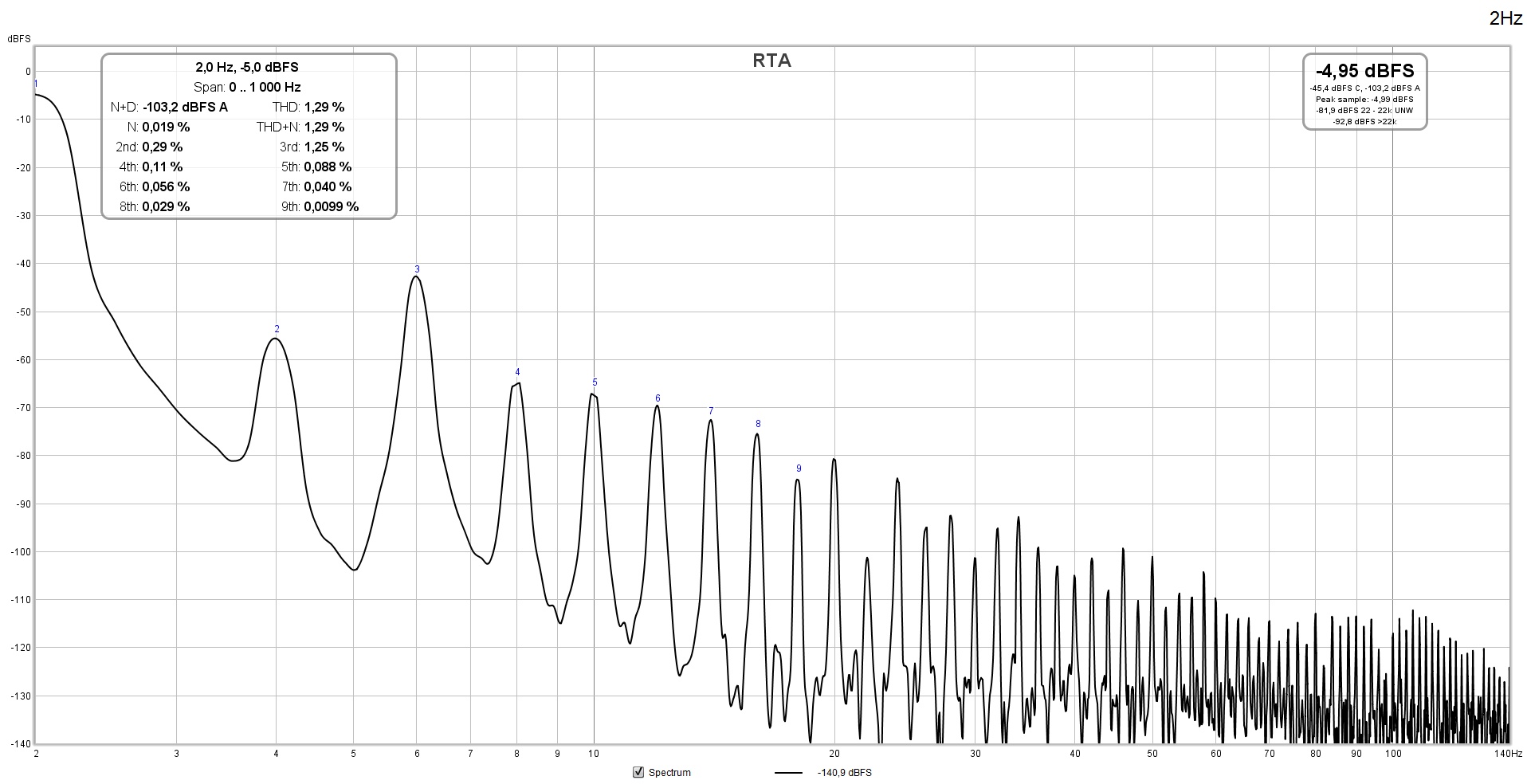

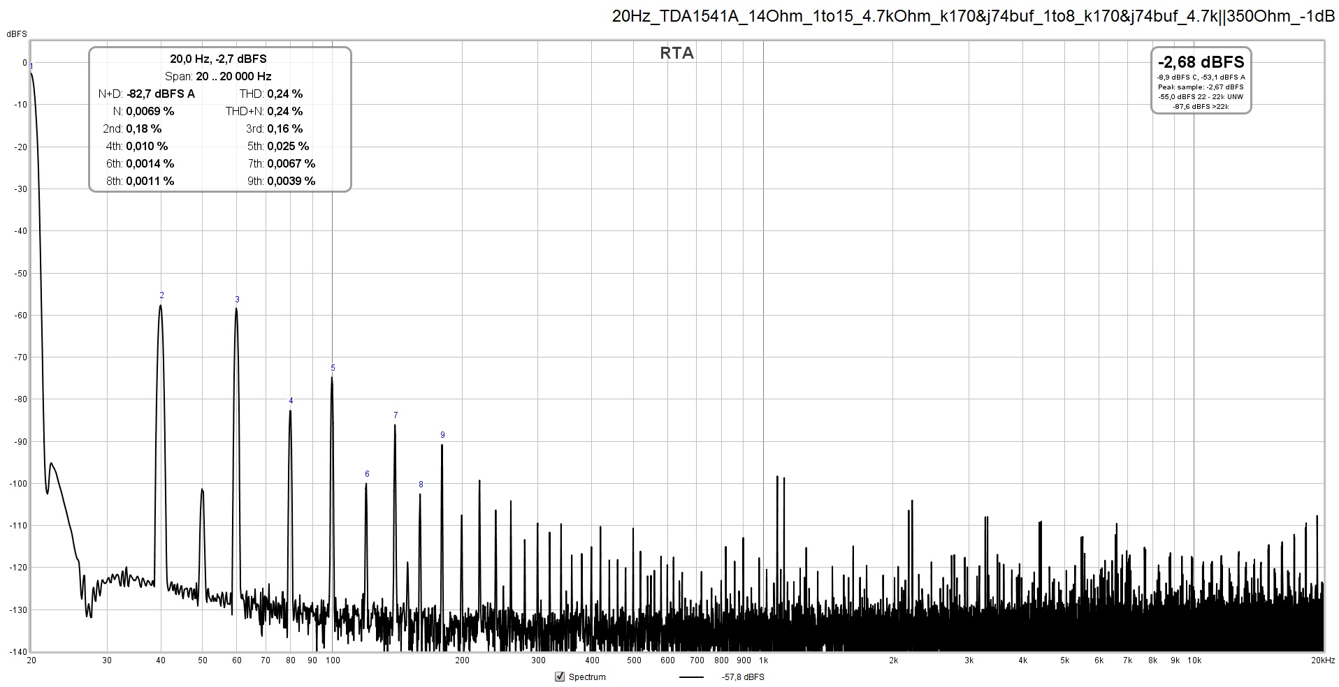

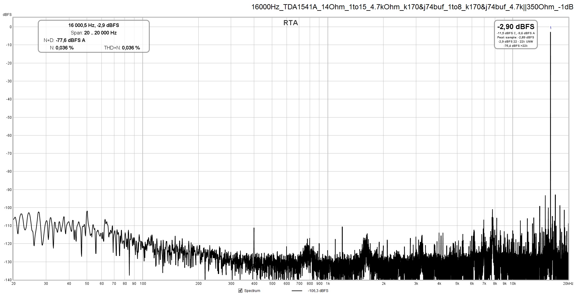

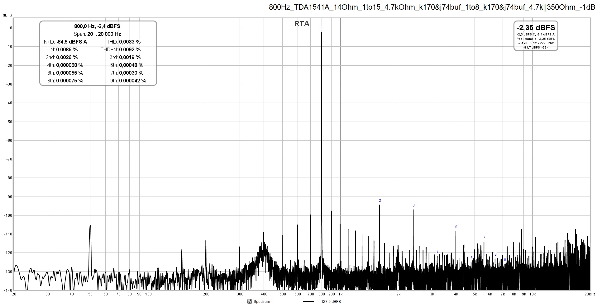

Meanwhile I have done a homework around the TDA1541A. The truth is pretty well known from other 1541 users, that the i/v impedance seen by DAC should be not more than 20 Ohms to get the undistorted signal within all the range. Here are some measurements.
Configuration is: TDA1541A (SE) loaded on to 14 Ohm handmade resistor -> 1:15 trafos-> 4.7k||k170/j74 buffer (current follower) -> 1:8.3 trafos->4.7k||k170/j74 buffer->350Ohm||RCA.
i/v seen by DAC is ~8.4 Ohm. 0.12Vrms after first transformer.
Output (@1kHz): 1Vrms (impedance ~15 Ohm)
LF: -2.5dB@5Hz

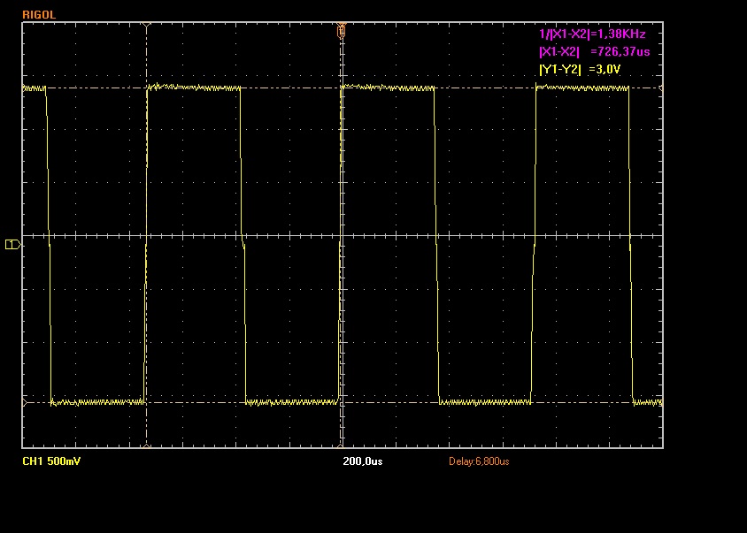

HF depends on Player, better to look at square signals:
LF: -2.5dB@5Hz
