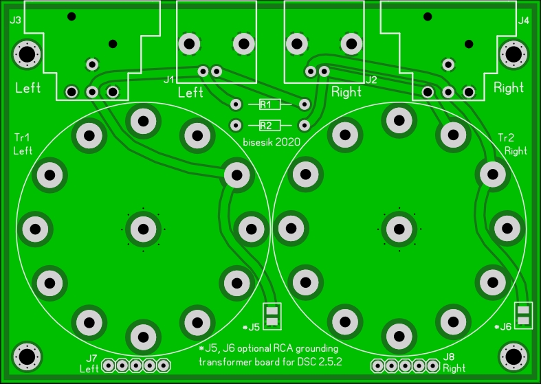

I am now ready to try a pair of your transformers on the output of a AK4490/AK4493 DAC .
What is the size of the pcb supporting a transformer ?
What is the connection diagram with the new 13-pin format ?
The input impedance of the connected amplifier is 50-75K ohms. What resistance value do you recommend in parallel with secondary ?
Thanks.
Nounouchet

What is the size of the pcb supporting a transformer?
100x71mm

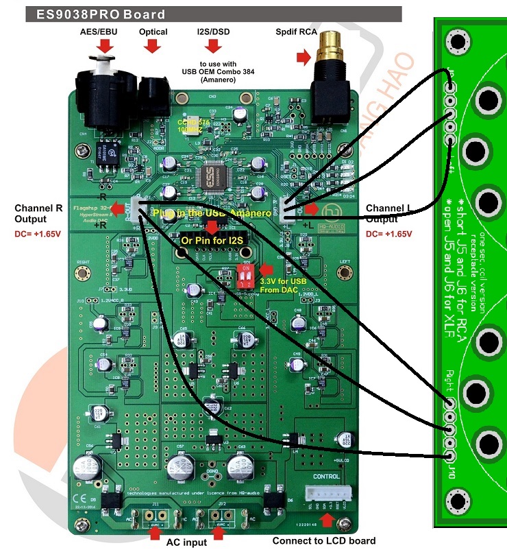

What is the connection diagram with the new 13-pin format?
Simple: one primary to +/- of output, one secondary to RCA\XLR with one resistor in parallell (jumper for grounding RCA to avoid "humm" presented)
The same like without transformer as it will be 1:1.
Thanks.
Ivan

I have a question on my transformer (1:2+2) and the original ian adapter board.
so it looks like the board and transformer layout support either two 2+2 secondaries or one 4 secondary.
If primary is on bottom, the 4 secondary is on top, and the 2+2 secondaries are on the sides.
The rework instructions I'm looking at look correct if you have one 4 secondary, but incorrect for j3 if you have 2+2 secondaries.
I think you should cut the trace to the secondary closest to j3, and jumper from the pad you just isolated to bottom pin of j3.
Does that make sense?
Randy
If it is about wrong XLR polarity, then yes, in case of 2+2 version it should be like you described:
Sorry Randy, I forgot that there was 1:2+2 version for you.
P.S. For all other users: if you do not know about this issue (via PM), then just ignore it, because this wrong XLR polarity connection was corrected in the next PCB revision..
Thanks for confirming. I actually added one other jumper to make both sides the same, but since I guess I'm the only one with a 2+2 and first board no one else will care.
BTW, I have been using RCA's, and didn't realize I was missing two jumpers until this morning. I added those too, but a couple of the holes are messed up so I had to jumper them too.
Yes, across the secondary coil - to stabilize the output impedance for all the frequency range. Kind of i/v resistor in common terms.
Maybe the use of ONLY one output in same time is allowed. Other XLR or RCA should not been even connected with a cable. Because IF booth outputs are plugged in Rinput from next device will take a part in output circuit? As well as capacitance of cables... About 100pF typically probably more with connectors. In reverse step transfer that capacitance will transfer directly to the primary to the DAC outputs?
I want to say that in this configuration og secondary, only one cable should be used. XLR or RCA. Other unused output should be disconnected from any cable.
Worst case is that booth cables are connected from output of the transformer to inputs on preamps to choose with selector which one to use...
It is not specific for the these transformers but for any other used in this way.
