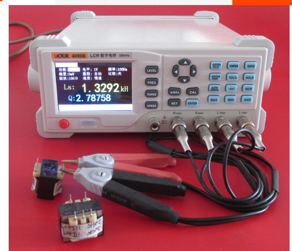

The point is that the object you are testing is their old transformer.
In addition, what is the significance of the inductance of the transformer? Using the same material to make the transformer, why are the inductances slightly different?
The real measured inductance (2-3 years after its manufacturing I think) of this EI (marked as 430H on photo) transformer is ~180H now at 100Hz. So the answer to your question pretty simple: difference in inductances are due to different plates permability within different transformers and due to wiring differences within one transformer (a bit less\more resistance), which are escalated over the time. To be honest the difference in pair of transformers even within 5-10% is a very good result as in the real transformer (not in theoretical, but in real) there is no inductive resistance only. Transformer is very complex thing and it is simply not possible to rely all the things needed for sound\music on inductances only, especcially at 100Hz only. But I believe the point is not that the object was old or new or in their absolute values of inductances. I believe mentioned transformers are still very good in terms of quality\cost. The more inductance you can get on the same dimmensions\wiring - the better perfomance - no questions. With hope that benefits (permability) will not go down over the time significally...
Chinese manufacturers said that they are used to measuring with 100MHz, so that they can measure different transformers with the same basis. They also said what you can also use 100MHz for measurement.
Sure they can measure at any frequency, but this particular measurement showned on photo (declared in specs) done at 100Hz.
The really interesting\sensitive things happens in another aspects of transformers. Seems that such regular (EI thick plate based) transformers simply stops to be transformers at higher frequencies if they have such a big amount of inductance\wire length, because the capacitive resistances between coils becames dominant over others. Transformer becomes... becomes... becomes capacitor

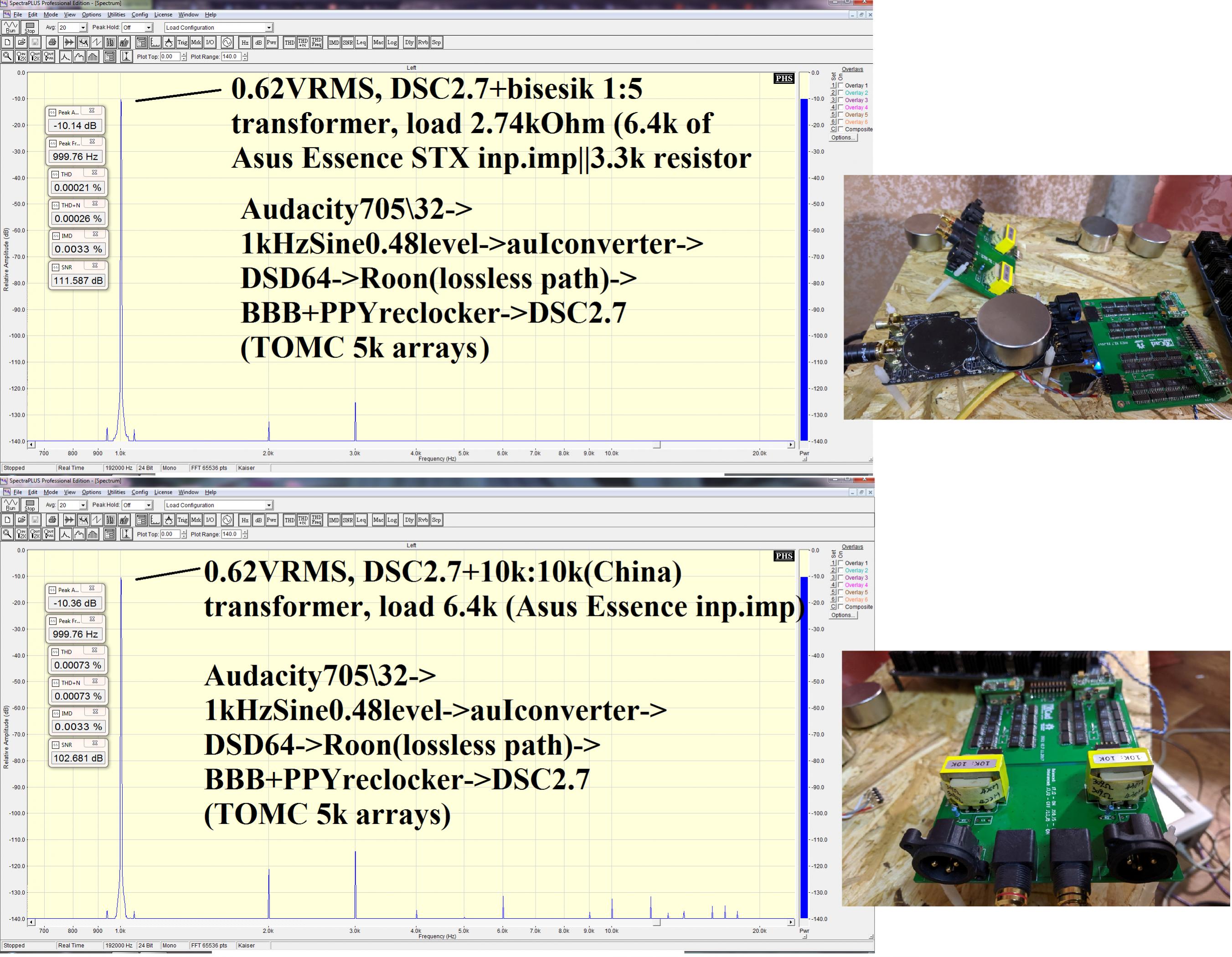

And if takes into account that 1:1 transformers are poorly suitable with current-type DACs (I believe DSC works better in current-output mode, similar to ES90x8 btw), and taking into account that step-up transformers works as LPF what is higly needed for DACs (Delta-sigma\SDM output especcially, remember Rasmussen filtering
🙂 ) - things becomes clearer a bit.
I know why this approach poorly works on other step-up transformers and clearly understand why people prefer 10k:10k over 600:10k of the same-type transformer, but it is another storry...
Clearer just "a bit" - because measurements very often are going in parallel or even in wrong direction when you comes closer and closer to the music in opposite to sound.
yunyun, I suggest to make the necessary comparative measurements from someone else, but AFTER real comparative listening within system that have no limit after DAC in terms of quality of following components. Reading your posts, I understand that I will always stays too interested person in this thread to to satisfy your curiosity
