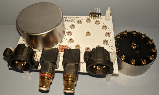

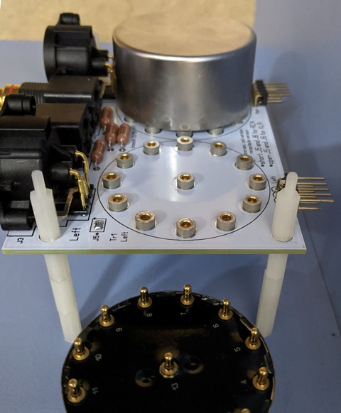

This "DSC" i/v board can be considered as some of universal type for different DACs based on my transformers. For the prototype was taken a printed circuit board from Pavel (ppy). Genuine RCAs on it are really very well manufactured. Сosty compared to other PCBs because of more expensive parts used on it. But I believe the components on it are the same now with that which are used many hi-end audio manufacturers.
The price for assembled PCB including receptacles (really costy parts) and genuine RCAs\XLRs even without transformers will be more than 100$. How much exactly - do not want to calculate without real demand 🙂

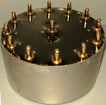

I have a pair of prefinished transformers made by silver wire. Turns ratio is 1:4. Can be splitted up to 0.5+0.5:2+2 for owner before shielding can finalization.
Price is $1000 for pair including WW EMS shipment. Details via PM please.

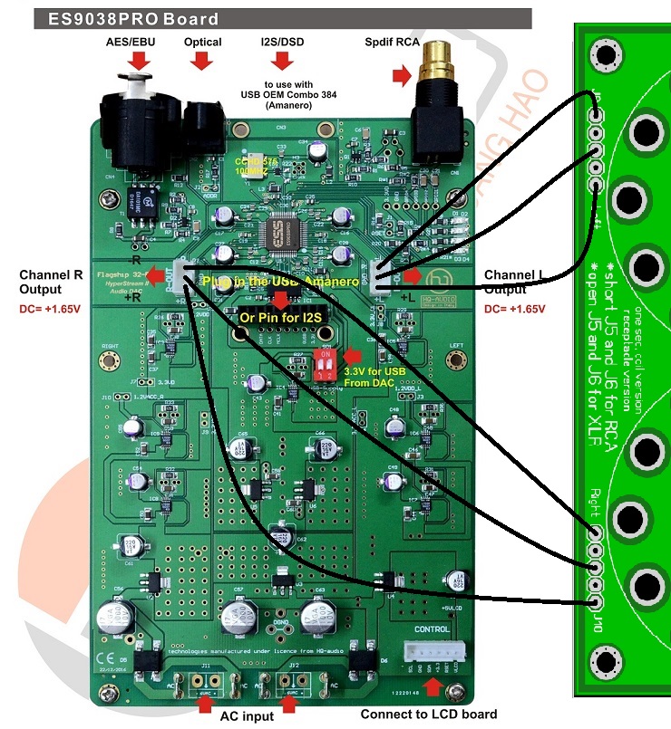

I got a bisesik transformer for Ian ES9038Q2M (XMOS + FifoPi + dual mono ES9038Q2M). Thank you very much!
