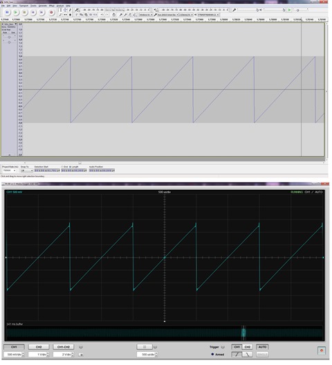

I suppose I have much easier method for checking phase (absolute phase) - it is the audio file with the saw signal. If it is the same in the audio editor and at the osilloscope then the absolute phase is correct.
Yes offcourse, but many folks dont have cpecific file, while for instance any soft for measuring transfer have in same time Step/Impulse response 🙂. Anyway booth methods are not complicated exept in simple transfer mode You can measure direct all-sustem and phase at one sweep?

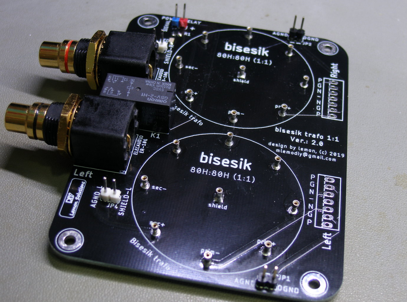

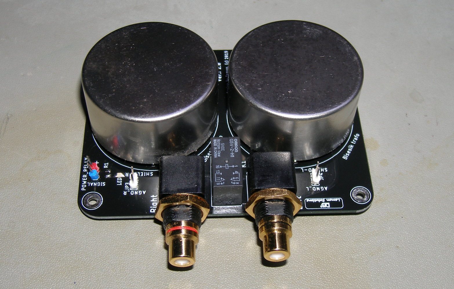

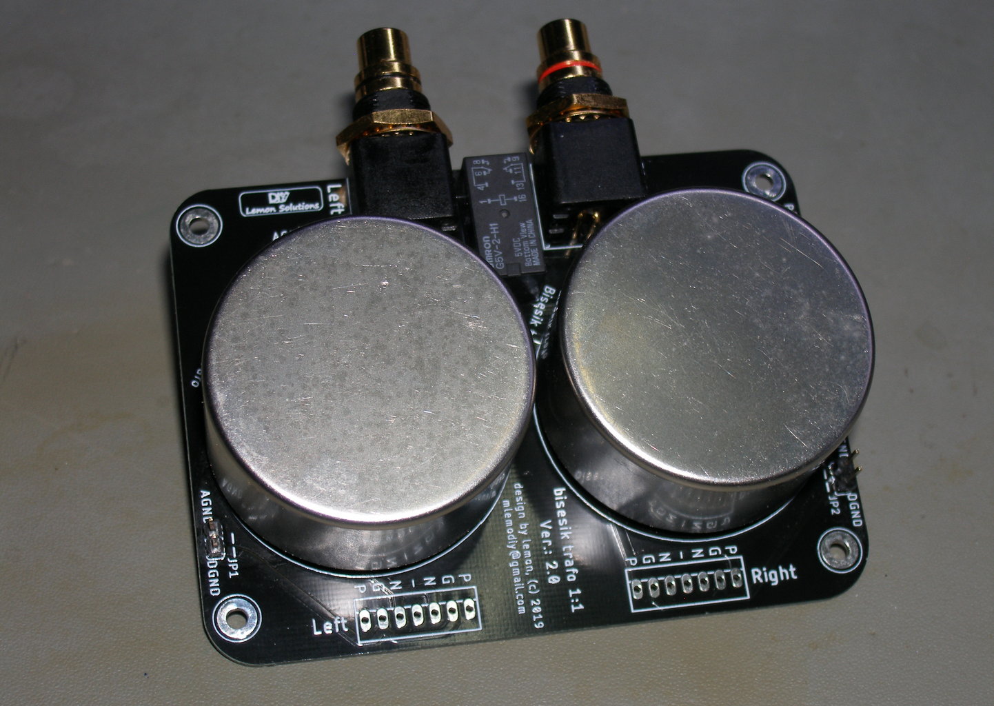

Here my pcb (bisesik trafo 1:1 with small pins) for dual mono mode (AK4490/4493/4497).
The relay is for signal mute operation via controller.
The pcb hasn't tested yet!
