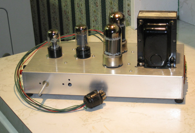

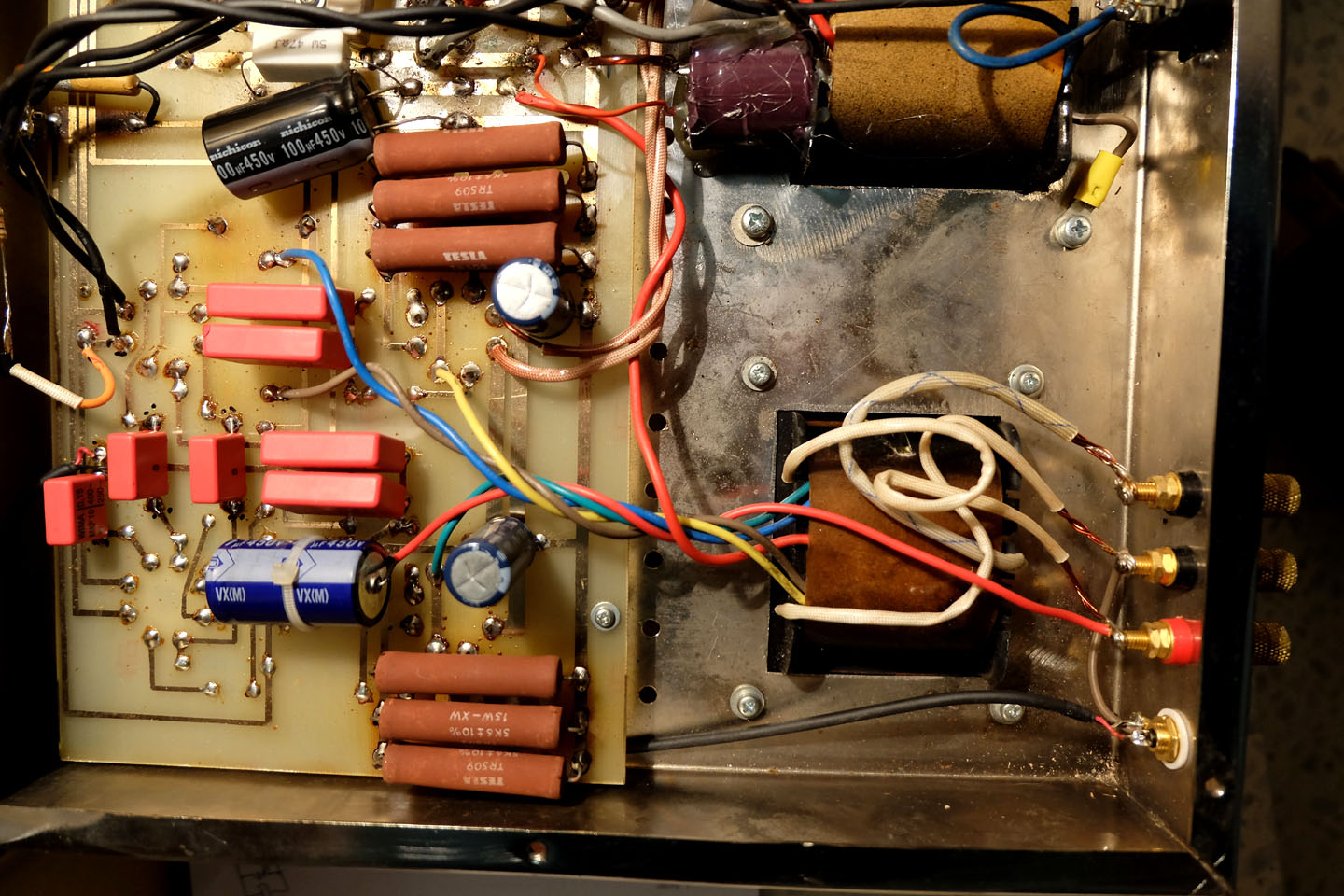

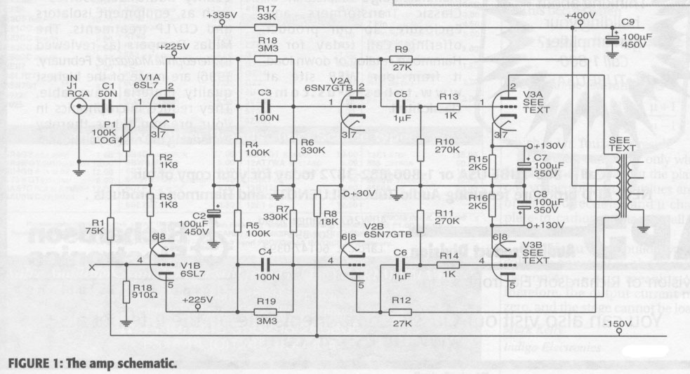

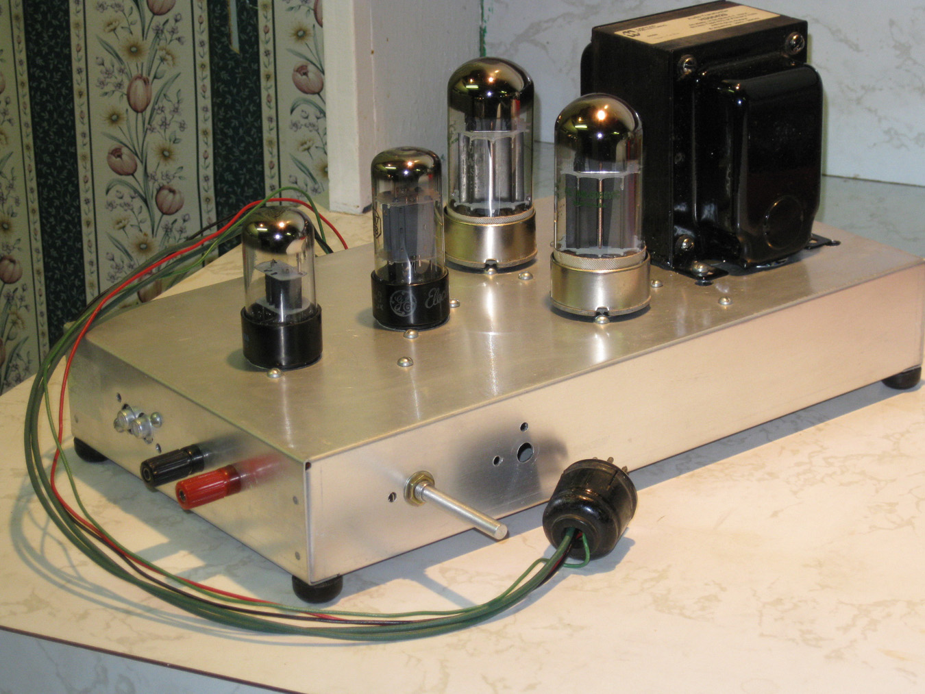

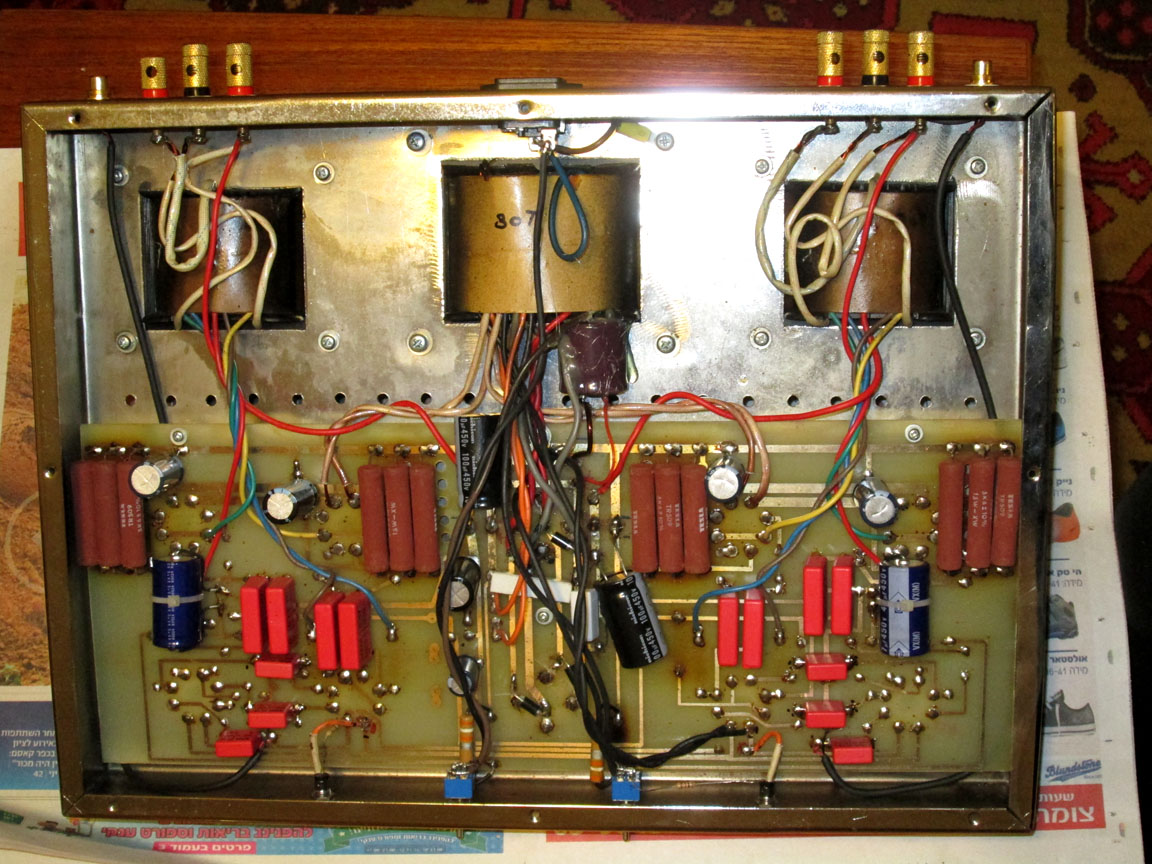

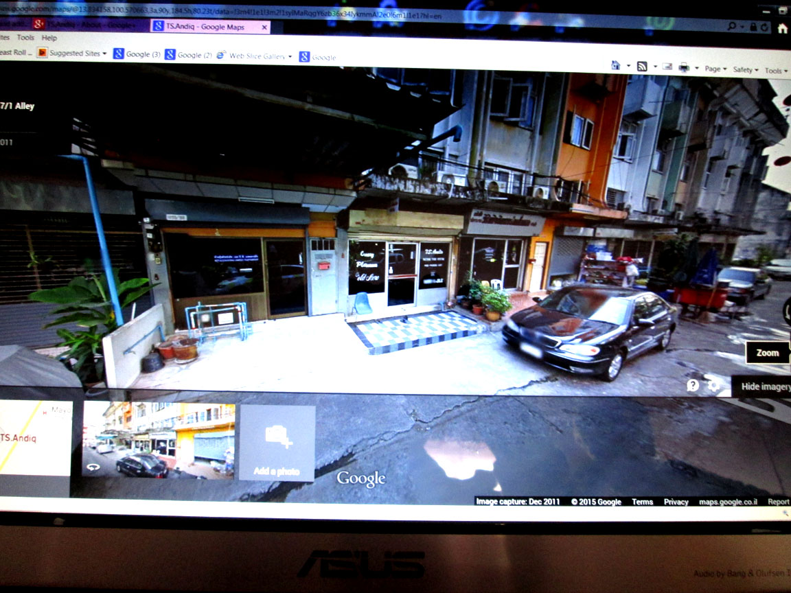

Interesting Ling, glad your memory is excellent. That last photo sure looks like that posted by rythmsandi. Is that a kit he might build? Looks very complete as is.
I was contacted a few years ago by someone in Europe who had bought a copy of something I'd published around yr 2000. The amp almost caught fire, the builder in Bankok, Thailand tried to go cheap on cathode resistors. With 50W under the chassis things got very hot. Don’t recall now what the failure was. Somehow the owner tracked me down thru a copy of the article published in Electronics World. I think the owner ended up scrapping the amp & building something else.
The amp is/was a boot strapped output section using two 6AS7s or 6080s per channel driven by a 2-stage diff amp, 6SL7 & 6SN7. About 25W audio per channel. I built a prototype only as a proof of concept. An article covering the amp was published in the May 1999 Issue of Glass Audio. And a shorter vers in the July 1998 Issue of Electronics World/UK.
I’ve replaced the cathode WW resisters with heat sinking types mtd right against the aluminum chassis sides, but really needs external heat sinks. Not my daily driver, it sits on the shelf with many other brain storms.
Looks like there is money in clones, the copier has a nice looking BMW waiting at his front door. And I guess being copied is a compliment.🙂
