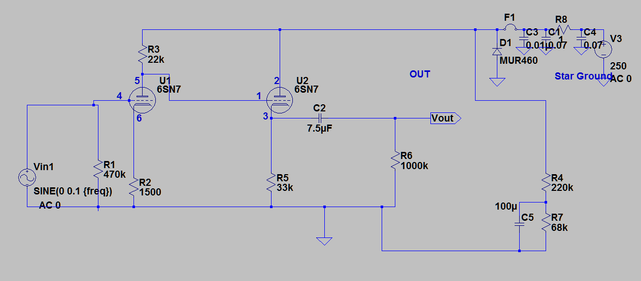

I have been using 6SN7 Mu follower and CF and I would like to order a custom-built output transformer for the preamp. Can anyone help me with the transformer spec for that? Many say the detailing and SQ are very good with output transformers.
I would like to know what is the primary and secondary resistance.
Primary and secondary inductance spec if required. The sch is as attached.

That preamp as shown does not need an output transformer. 🙄and I would like to order a custom-built output transformer for the preamp. Can anyone help me with the transformer spec for that?

Hardly a transformer needed there and you omit the most important data: what is your load?Primary and secondary inductance spec if required. The sch is as attached.

Also the "connected to nothing" voltage divider and smoothing capacitor R4-R7-C5 😕
Not too sure either about the "do nothing" RCRC filter C1-C3-C4-R8 😕
1 ohm resistor? .01 and .07 capacitors? Besides the nil effect on filtering, what do you expect them to accomplish?
And the hardly useful F1 fuse on the +V line?
Not even shorted tubes will blow any currently available fuse.
"Design" looks like randomly copypasted schematic snippets from different places.
well that psu part ive been just using a a conventional template and 1ohm is to probe current while measuring.
The resistor network R4 , R7, C5 is for heater elevation.
The amplifier input impedance to which I will be connecting the output transformer will be in the order from 20k to 100k any of them.
The reason why im considering the transformer is ofcourse said by some audiophiles and also some companies like audionote uses them in their preamps.
Perhaps it is needed to isolate ground loops.

Like said regarding the tubes I'm very new to valves and also the transformers are quite expensive so just asking a few of you to check that am I choosing the right component or not.
PS - but thank you for admitting you are new-to-tubes, and they're confusing. Yes, they are.
Take the advice now already given: you do not need an output transformer on a preamp. Period. Instead, concentrate on the values your little diagram has, at various positions. Reduce and remove things not needed (such as the power supply leading to ground … with a blôody capacitor on that path (to the right)). Its pointless.
The circuit shown ought to have a 3.8 mA quiescent (no signal) current in 6SN7 (left). This induces a voltage of 5.7 V in the 1,500 Ω cathode 'auto-bias' resistor. Which corresponds on the 6SN7 load-line datasheet diagram to … just that. Yay. In turn, the 22 kΩ anode resistor will DROP 84 volts, leaving the valve to “see” 250 - 84 = 166 volts on anode. And 5.7 v on cathode. 160 V total, across.
Without a cathode bypass resistor, the 1,500 Ω cathode resistor will be exerting a strong local-negative-feedback moderation to the already-quite-linear 6SN7's triode transfer function. The result is that the signal tapped up on the anode resistor will be quite linear. This I presume is desired.
Moving along however, the next stage has a 33 kΩ cathode resistor and is seeing 165 V on the grid. 165 V ÷ 33,000 = 0.005 amp or 5 mA passing thru. Output impedance (perhaps unexpectedly to you as a newbie…) is rather markedly lower than 33 kΩ tho'. As Fahey (or someone) said above, around 10 kΩ.
And … 10 kΩ is a perfectly good output impedance for a preamplifier, especially driving what looks like “high end” audio equipment.
The 7.5 µF capacitor … is fairly misguided though. The formula
Anyway, more than you wanted, its likely.
C = 1,000,000 /(2 π F R) (in microfarads)
C = 159154 / ( 20 Hz × 10,000 Ω )
C = 0.8 µF
shows that the 7.5 µF is 10× bigger than need be. 2× or 3× bigger is a better choice. And, taking a look at the magic-unicorn-dust cut-and-paste power-supply capacitors, you really would want to have a 0.05 µF capacitor in parallel with a 2.0 µF electrolytic. HF response, so “they” say.C = 159154 / ( 20 Hz × 10,000 Ω )

LOL… I think “rhythm” is a builder (or buyer) of fine kit-ware. But let's give him a little break: for reasons unknown, he wants a preamplifier. OK, the 6SN7 is good, he still has to figure out what power supply schematic is really useful (i.e. get out of the circuit simulator!), and so on. Hopefully, if he takes the advice of others, it'll come to fruition.
Otherwise, we're just endeavoring to educate the fella. Which is OK too.
