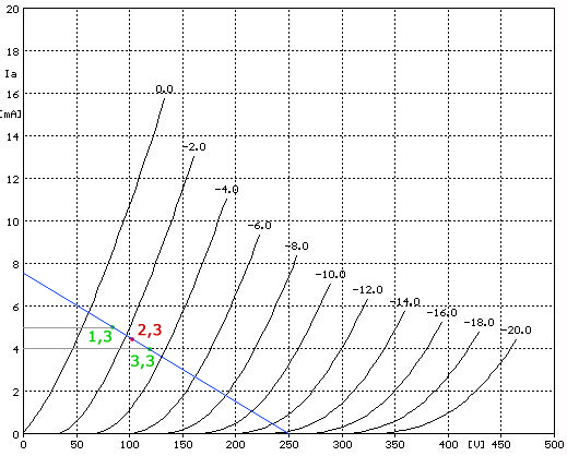

If I had to work with 6sn7 what value of inductance should be in primary to get a good LF response?I probably shouldn't butt in here; but here goes. I personally prefer the sound of transformer coupled output to capacitor coupled output. But to achieve this takes a really good line out transformer and they aren't cheap. It also requires designing the circuit for transformer output. It's not something that can be necessarily grafted onto some existing design.
Second, a 6SN7 has too high a plate impedance to drive a transformer effectively. That would require a very high primary inductance for decent bass response but that in turn would require more windings. That results in more winding capacitance which interacts with the plate resistance to kill the high frequency response. You're going to have to use a higher transconductance tube and more B+ current to bias that tube. So PS is going to have to be able to handle the extra load.
I'm currently in the process of building a headphone amp with a modified 6SN7 mu follower (Morgan Jones "beta follower") doing input/voltage gain duty. In Jones' circuit the load resistor is replaced by an PNP transistor. This has three advantages: 1) consumes less B+, 2) output of the lower tube is direct coupled to the upper - no capacitor and 3) the AC impedance of the upper tube is multiplied by the transconductance of the transistor ( hence beta follower). This presents the lower tube's plate with a much higher impedance load. The output is RC coupled to the following stage, a transformer loaded 6BX7. With a plate resistance of ~2.5K the rule of four would suggest a primary impedance of 10K. If interested I will let you know if it sounds any good when I'm finished.

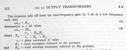

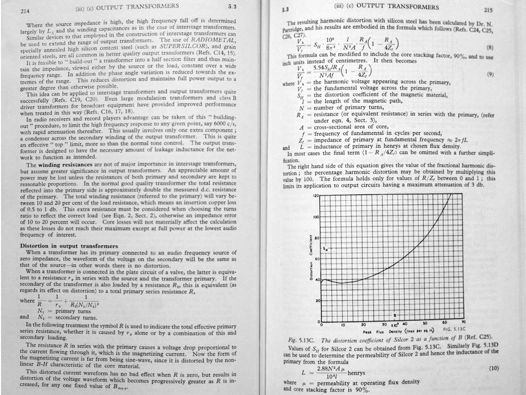

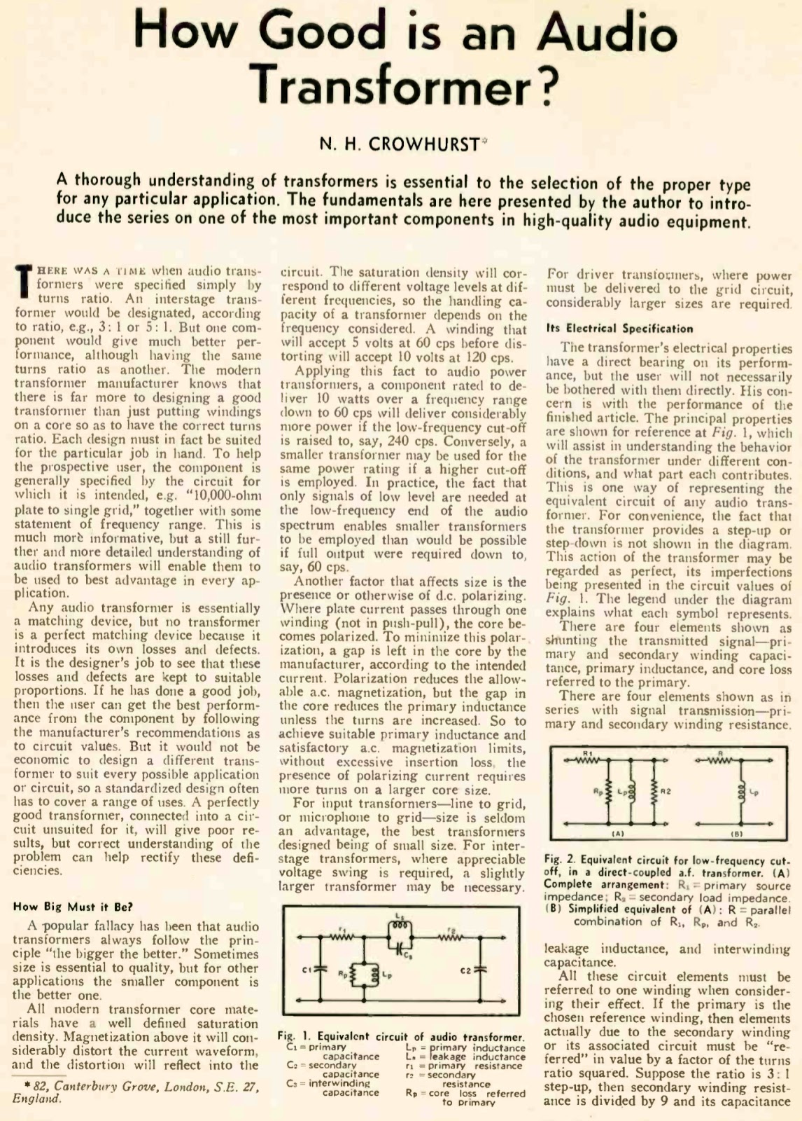

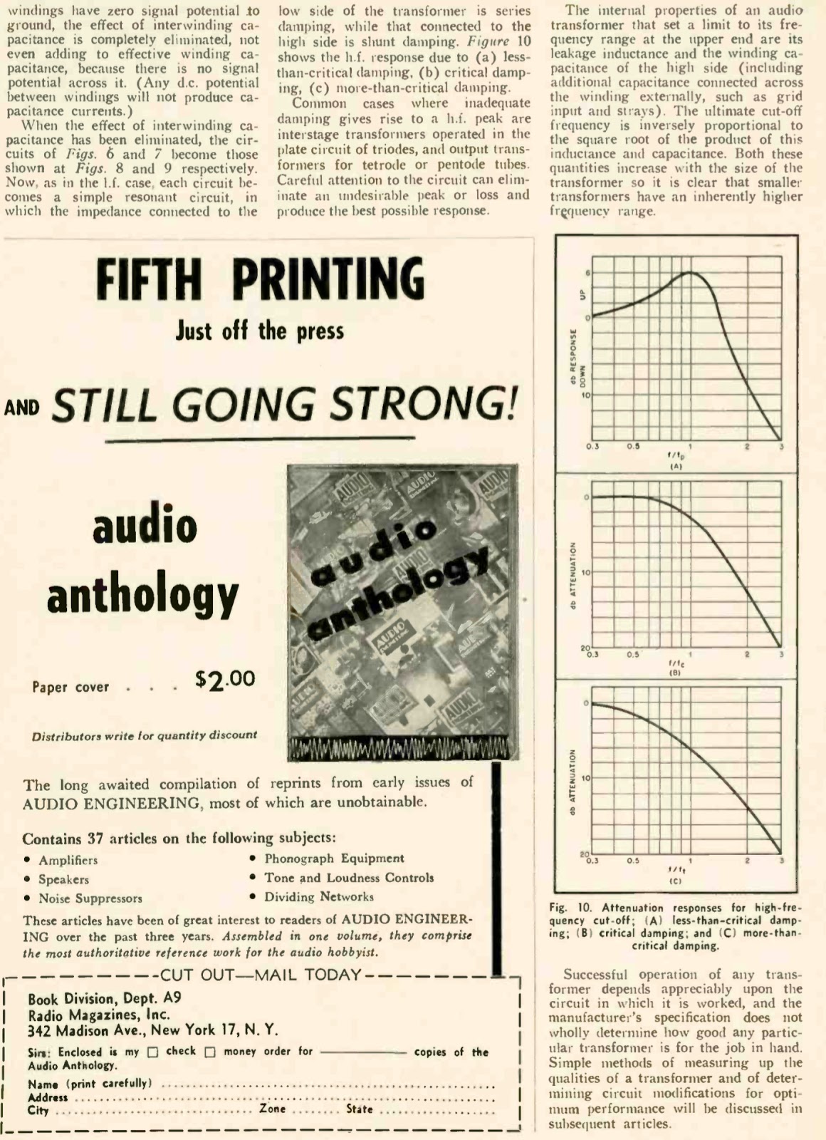

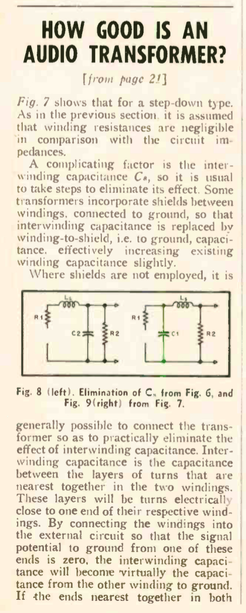

Here, have a read.If I had to work with 6sn7 what value of inductance should be in primary to get a good LF response?
