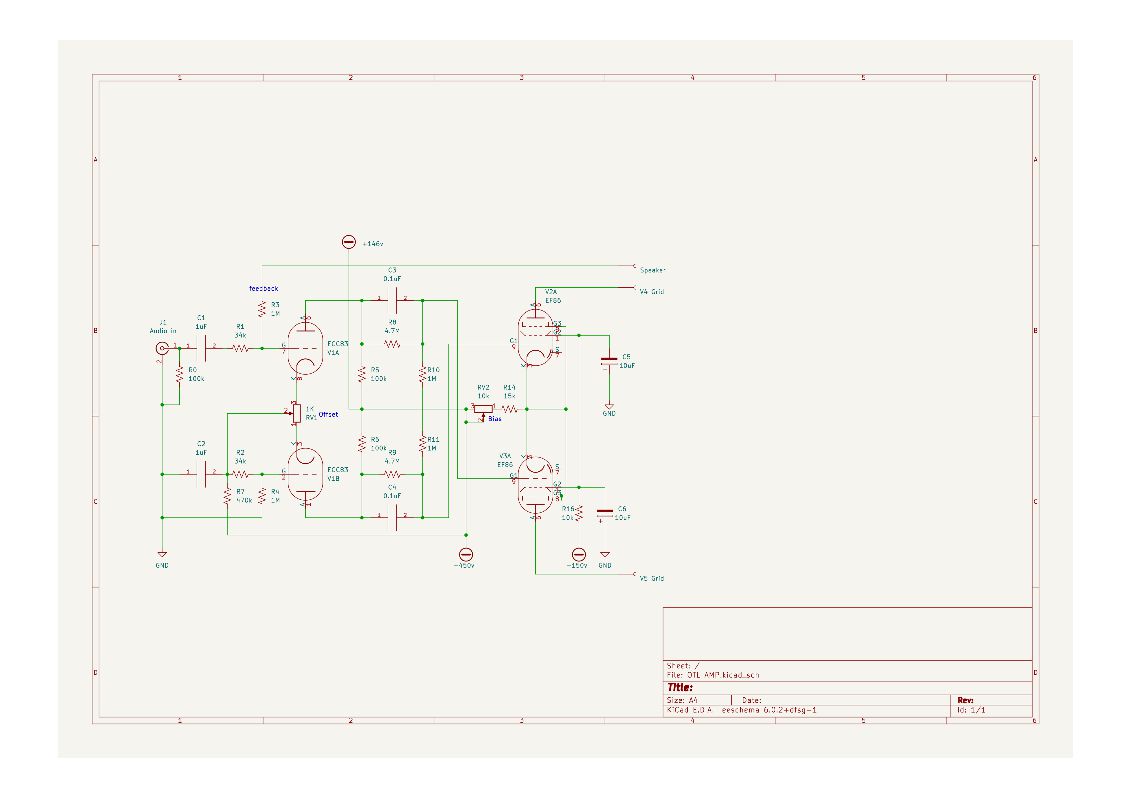

OTL designed by Tim Mellow with 4 6C33C?

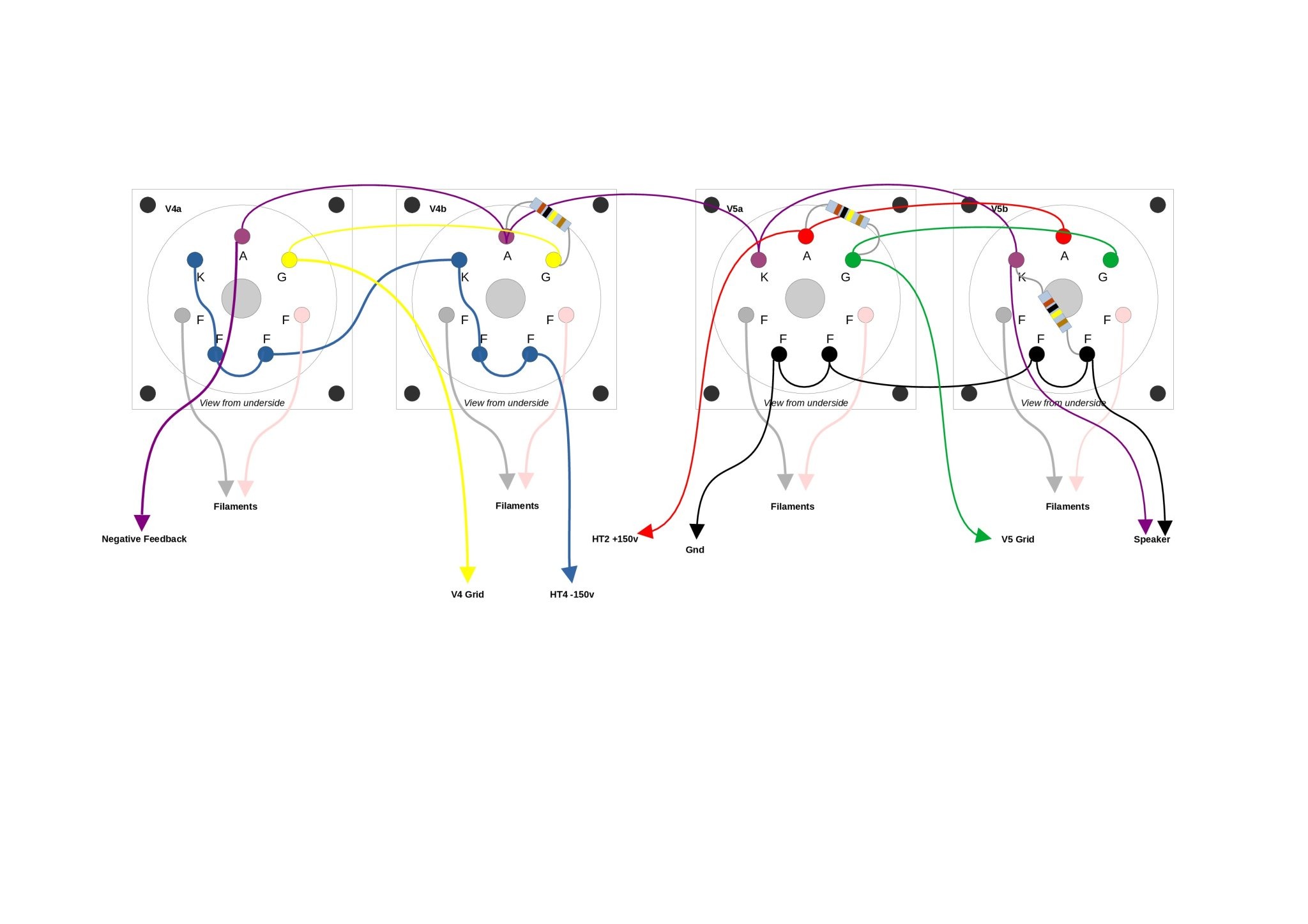

Captain, I noticed that in Tim's diagram the pins of the 6C33C tubes are numbered differently than what I found on the net, how did you identify how they are connected?
This is the driver schematic I am using, this works well. I drew this by reverse engineering the Ares Audio PCB. Also attached is the way i have connected The 6C33's, It took me several attempts to get to this drawing, as there is much conflicting information on the internet. The Ares Audio Drawings have quite a few mistakes, I currently only have 4 output tubes so i only populate, either 2 tubes left and right or 4 tubes mono. I have tried both 2 and 4 tubes and all works great.

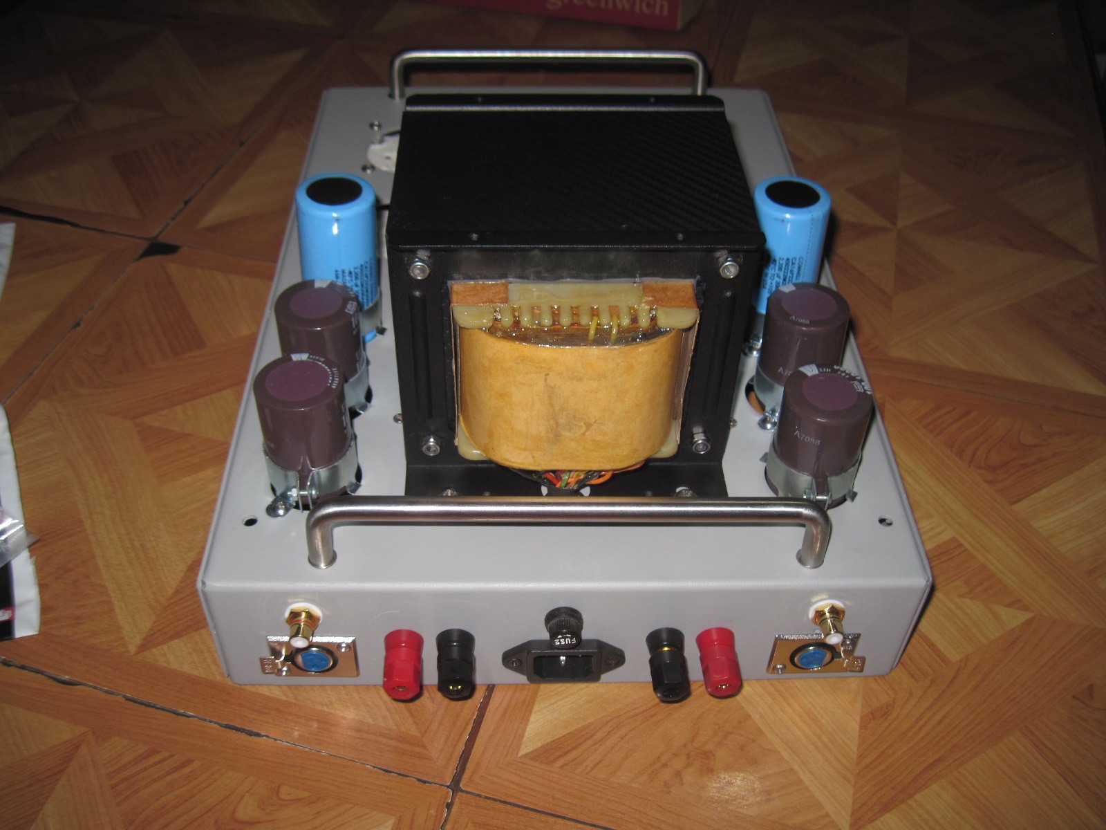

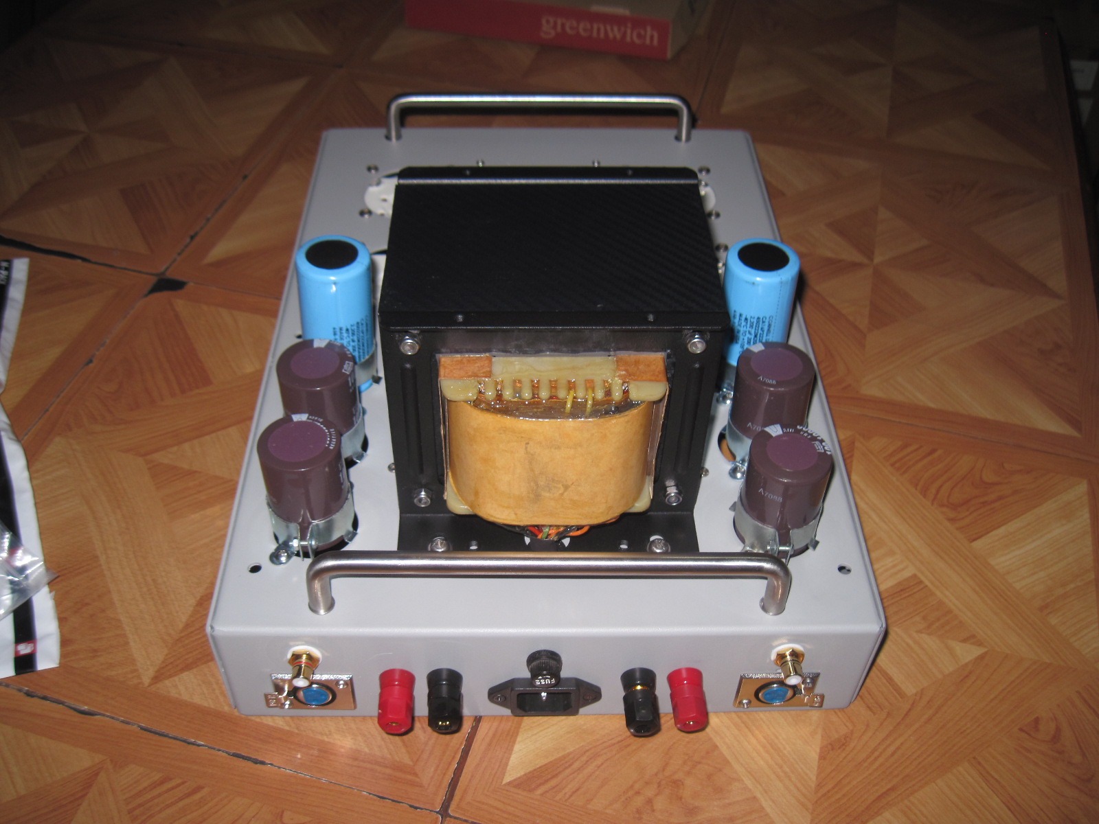

I was just wondering, you have just one transformer (in Picture) is this HT and filaments ? What windings does it have ? I think you need separate filament supplies for each tube, I am using 4 Output tubes per channel, my heater transformer has 4 x 12 volts @ 9.5 Amps (enough to power 2 tubes) so if you look at my tube wiring diagram you will see that it is ok to power the two upper tubes from one winding and the two lower tubes from another. But i don't think you could power one upper and one lower from the same winding, as the the center tap of the filaments (cathodes) are at different potentials. Are you using separate supplies in your design ?

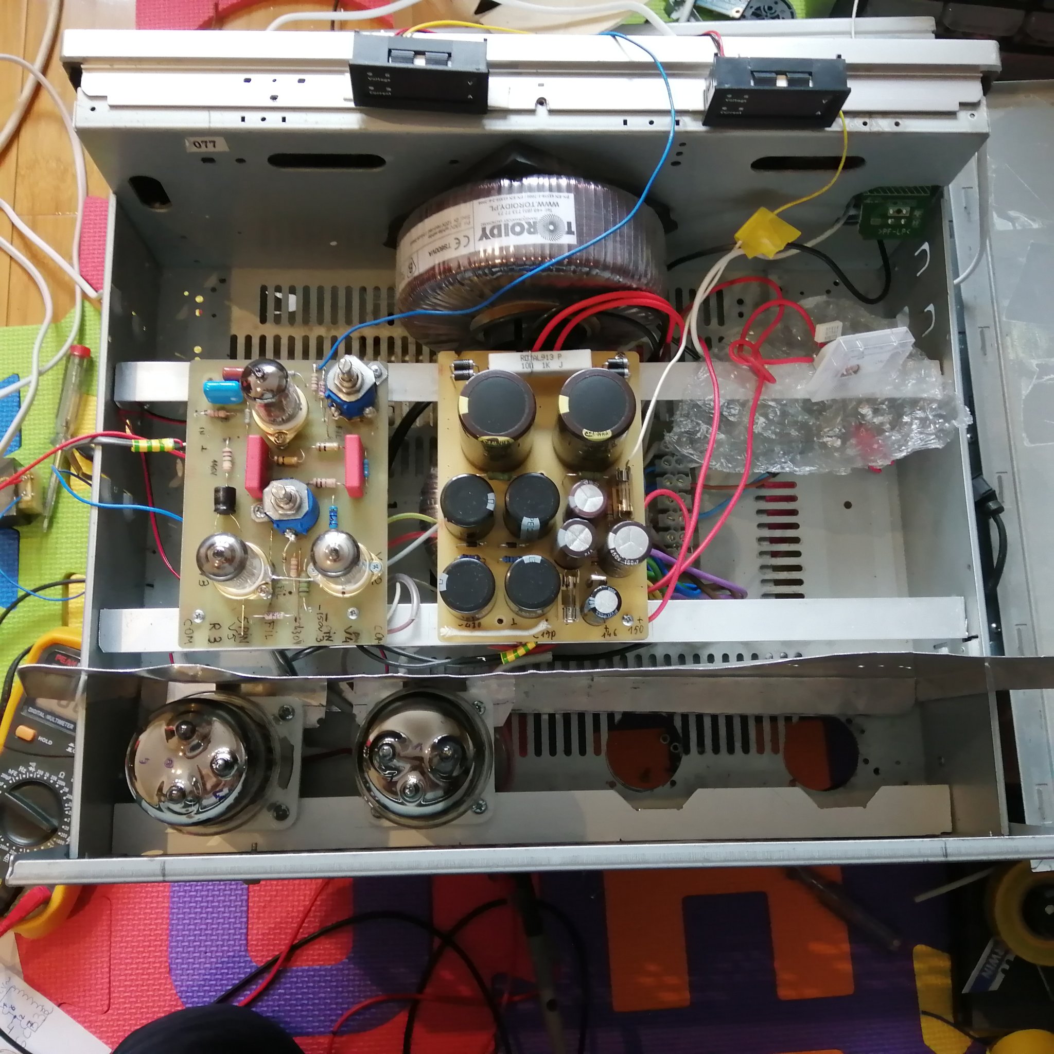

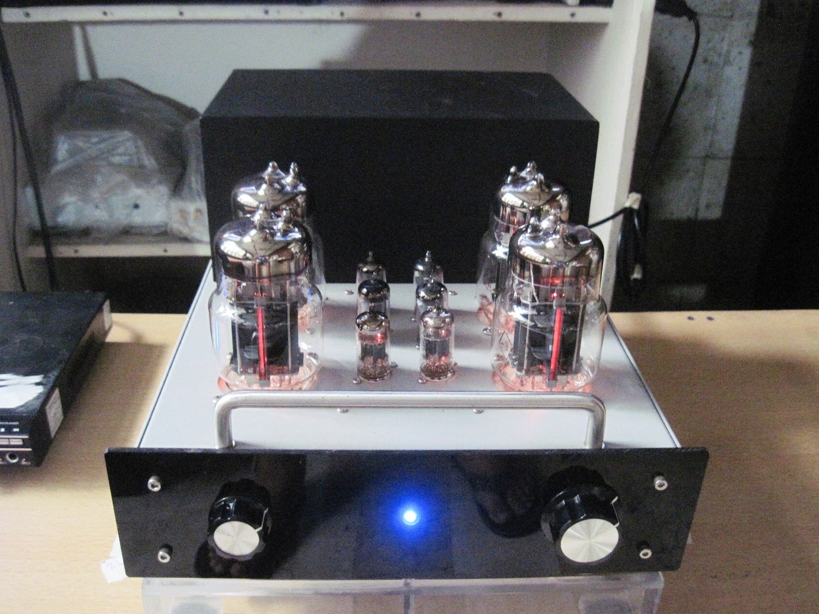

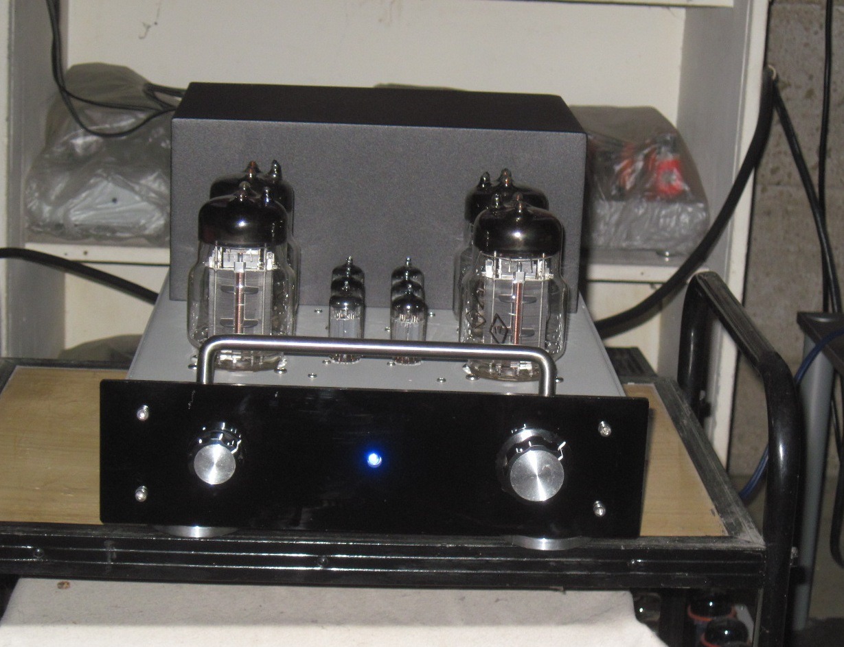

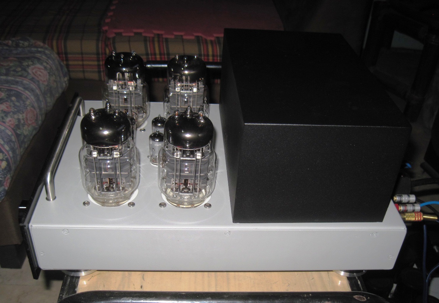

I greet you with respect, Captain. So, the transformer for the + and - 150 v rails is visible in the pictures.
The transformer for the 6C33C tube heaters is separate and is located under the circuit with the rectifier and several capacitors (it can be seen a little in the picture).
The third transformer for the heaters V1 V2 and V3 is mounted under the circuit with the three tubes (it is not visible at all in the picture).
p.s. I respected Tim's project 100%.
Mario will greet all the members, and Mooly

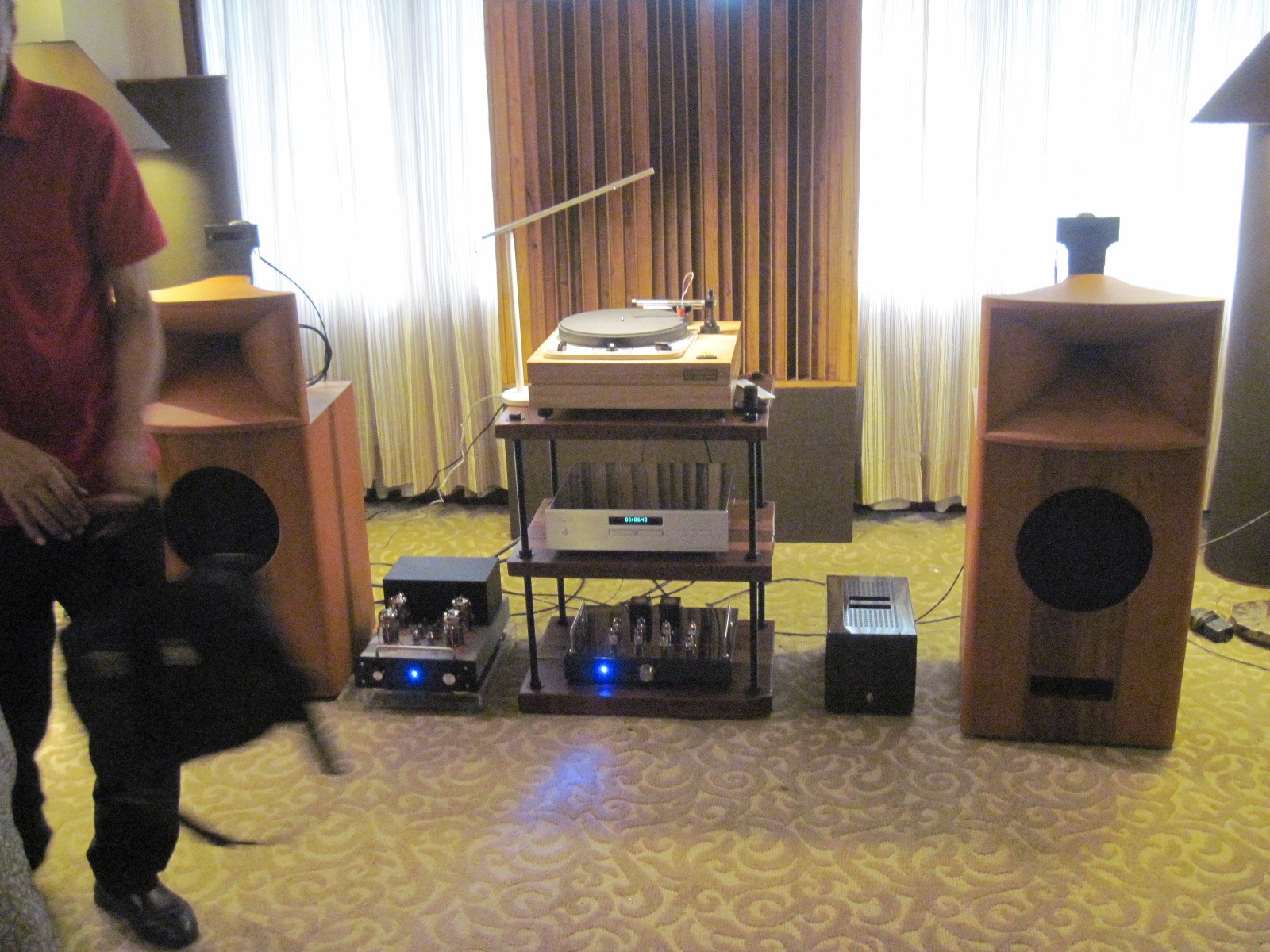

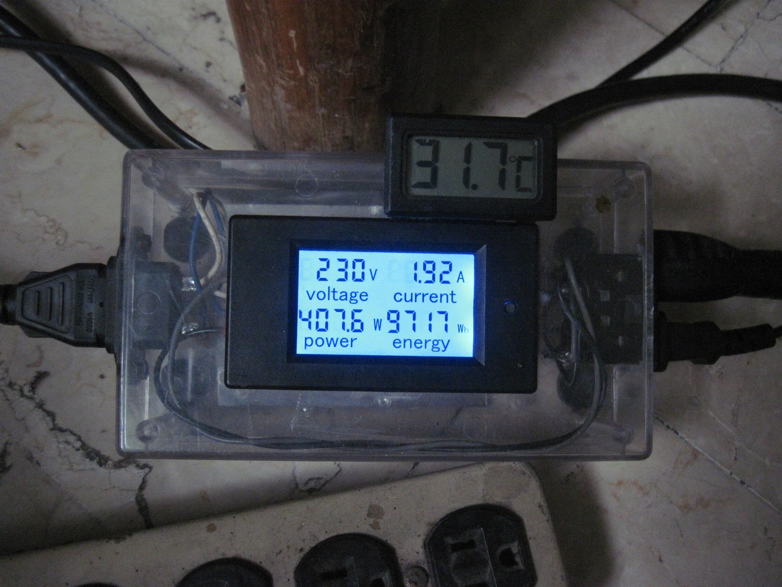

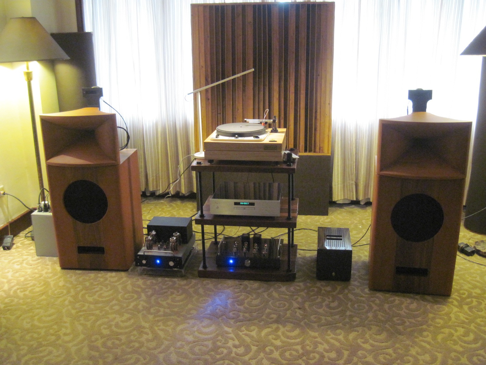

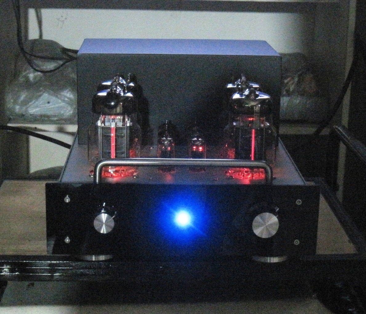

is it working ? of course it did, this is a proven design...this amp eats 400 watts of power...we displayed this in a Dusit Hotel audio show setup...way back in November of 2017

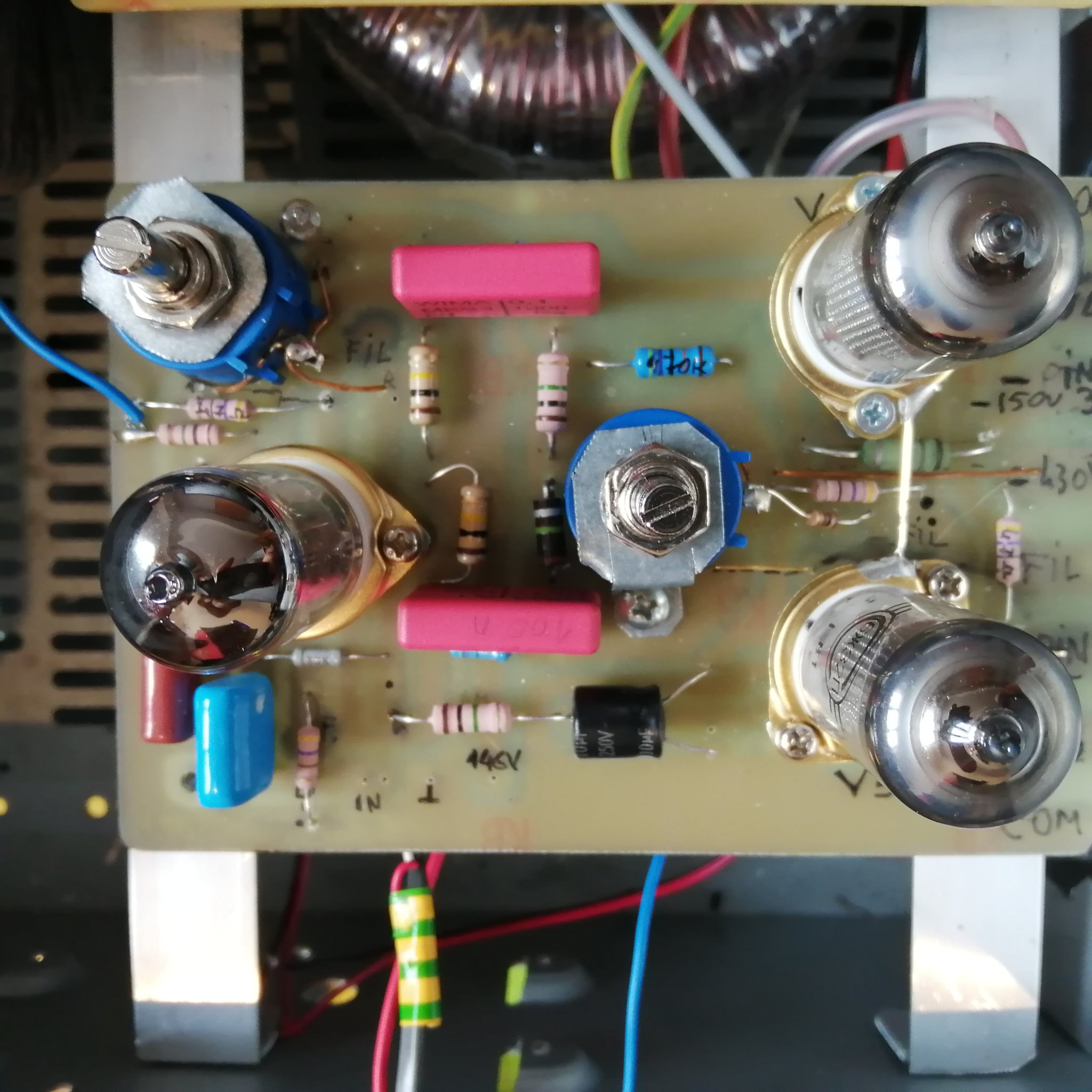

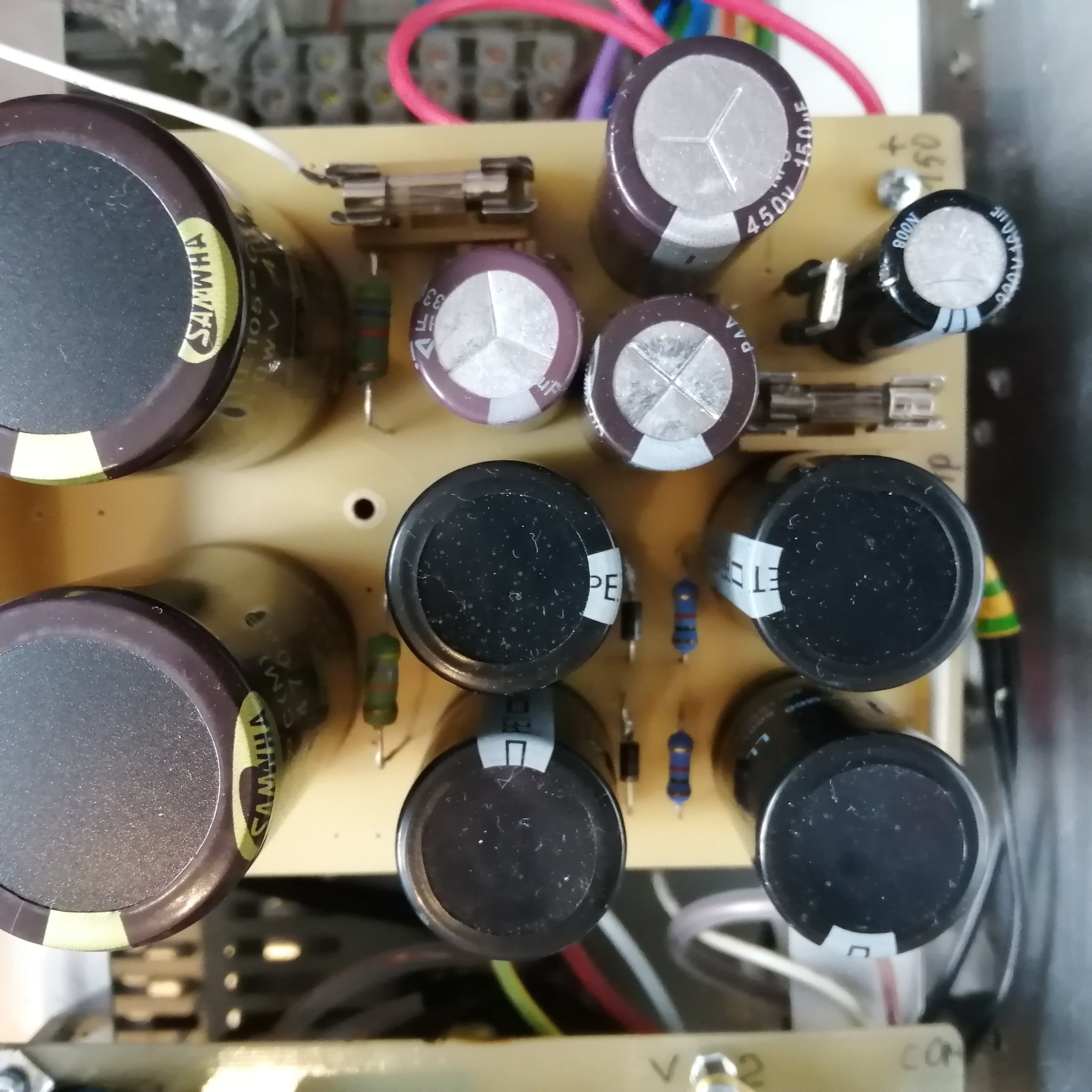

Hello Kissabout, thanks for the advice. I made one mistake when I built the pcb, the capacitor C5 was placed wrongly.
it is mounted on the grids of the tubes v2 and v3 pins 1 and there is a negative voltage. so this capacitor is placed with the plus on the GND. do not make this mistake as smoke comes out of it. I saw this aspect too late and continuing to I feed the amplifier for adjustments and measurements, probably one or more tubes or burnt.
Greetings to all members.
today I built a preamplifier with the EF86 tube.
What do I use it for?
To check these tubes because I did not find what defect my OTL has.
