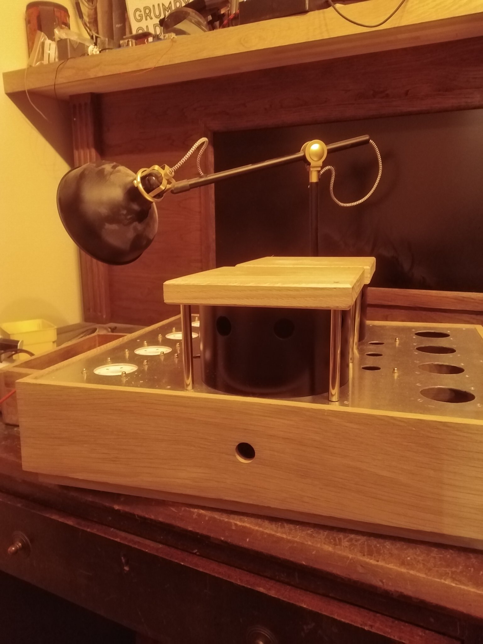

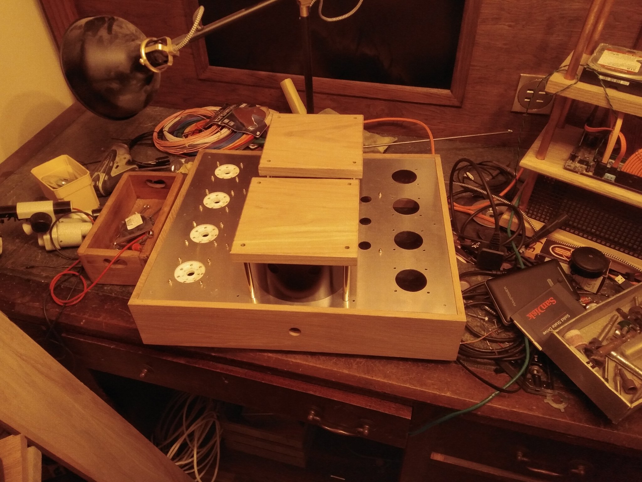

I built my amp using boards from Ares audio. I currently have the whole thing disassembled, as i am building a nice chassis for it. Work commitments have slowed progress a bit, but will hopefully be able to find some time in the next couple of weeks. It took me quite a while to get it working. I started simple, single channel with just two 6c33's on output, all built on a wooden test rig. I did try getting it going just spread out on bench, but then decided to build a test rig for safety reasons. There seems to be quite a bit of mis-infomation out there on different sites, the Ares audio has several "mistakes" (seen my earlier posts).
I used to often jump into these projects, throw the whole thing together, and expect it to work (ish), but that very really happened, you just end up with lots of smoke and loads more expense! Build it section at a time start with the power supply get that going with all the correct voltages. Then add the amplification section. In the beginning use a variac or some old incadesent lamps in series, will save you a fortune in fuses. Check and double check before applying power. You will get there in the end. remember If anybody could buy the parts assemble it and it just work out of the box then is wouldn't be anything so special !
As soon as i get it back together, i will take some pictures and voltage readings.

Saluti Captain, how right you are. It happens to me too. I used a case from a broken Akai amplifier.
I will also post some pictures.
