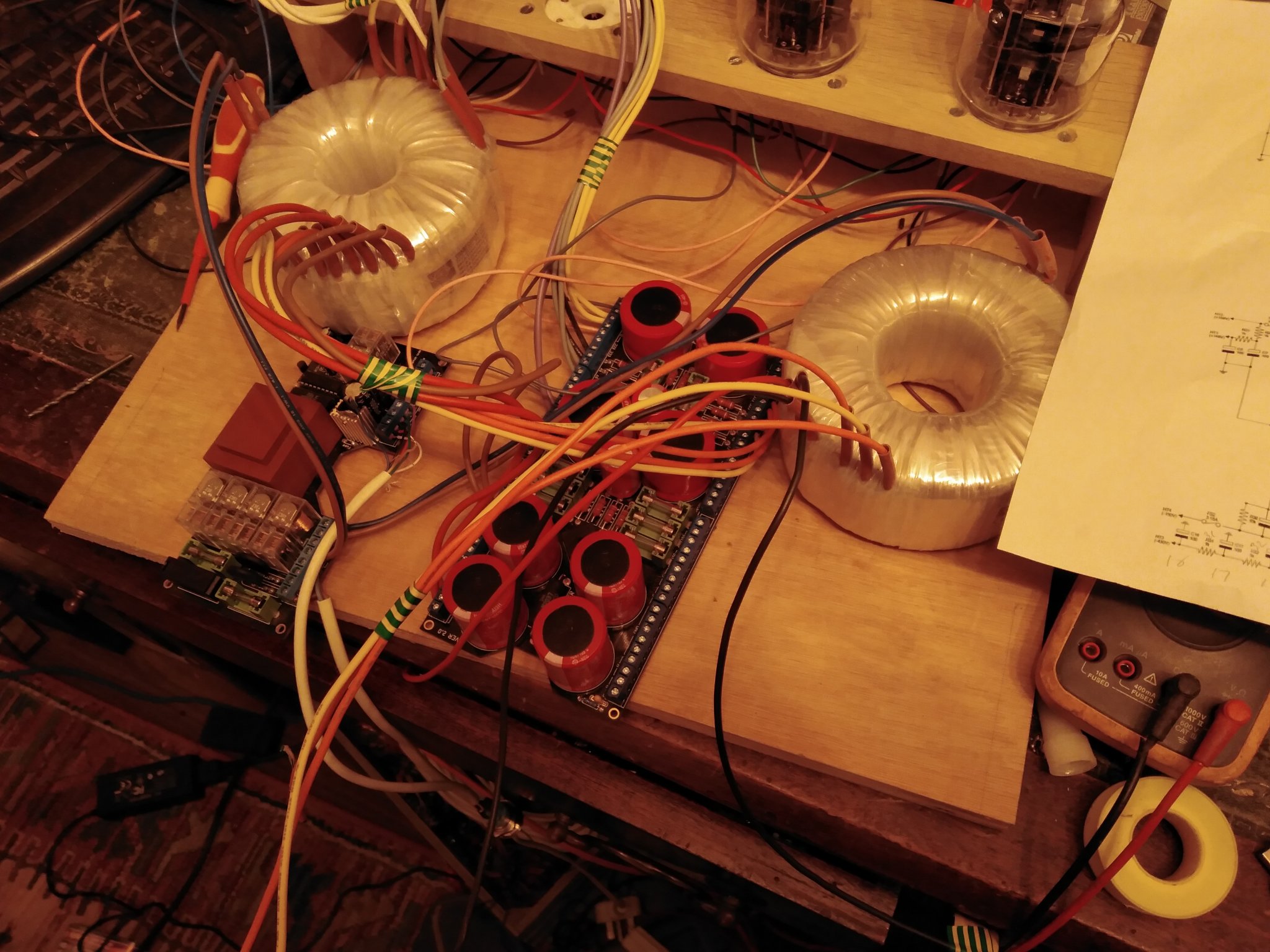

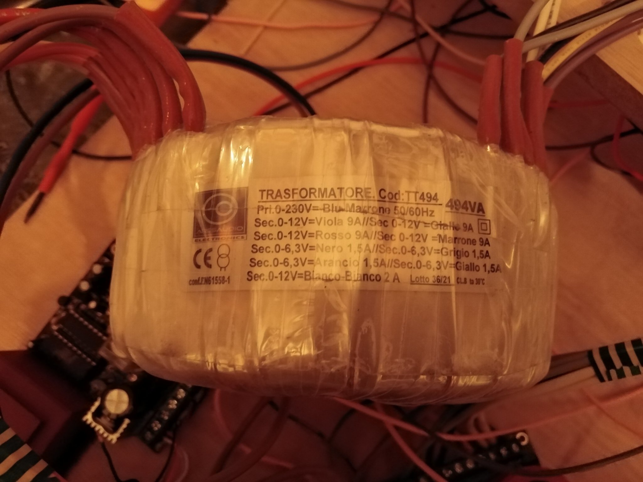

Toroids can be magnetized when shut off, depending on the position of the AC waveform. The next time you turn it on, the existing magnetic field causes the core to saturate and so there is a large inrush current. This can blow a fuse quite easily. When there is a load the random magnetic field is vastly reduced.
My ht transformer is 500watt, it has two identical 120v-0-120v windings, 250 Watts each. The ares audio pcb only has connections for one set. I have worked out the phase so I can parallel them up.

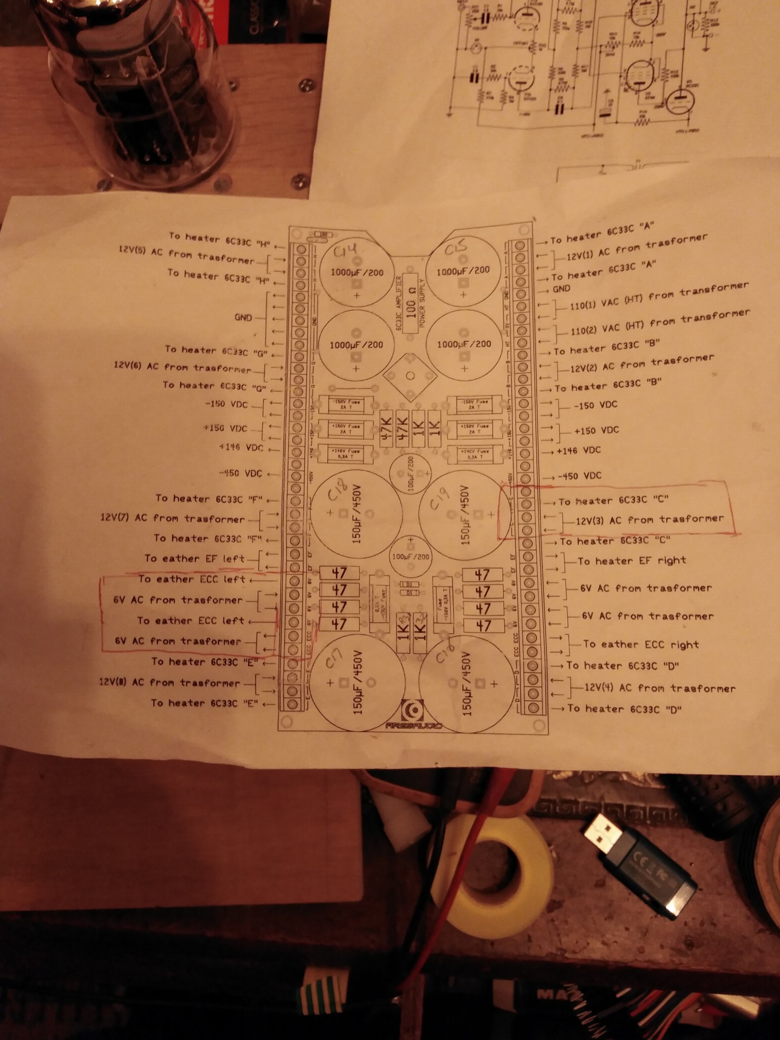

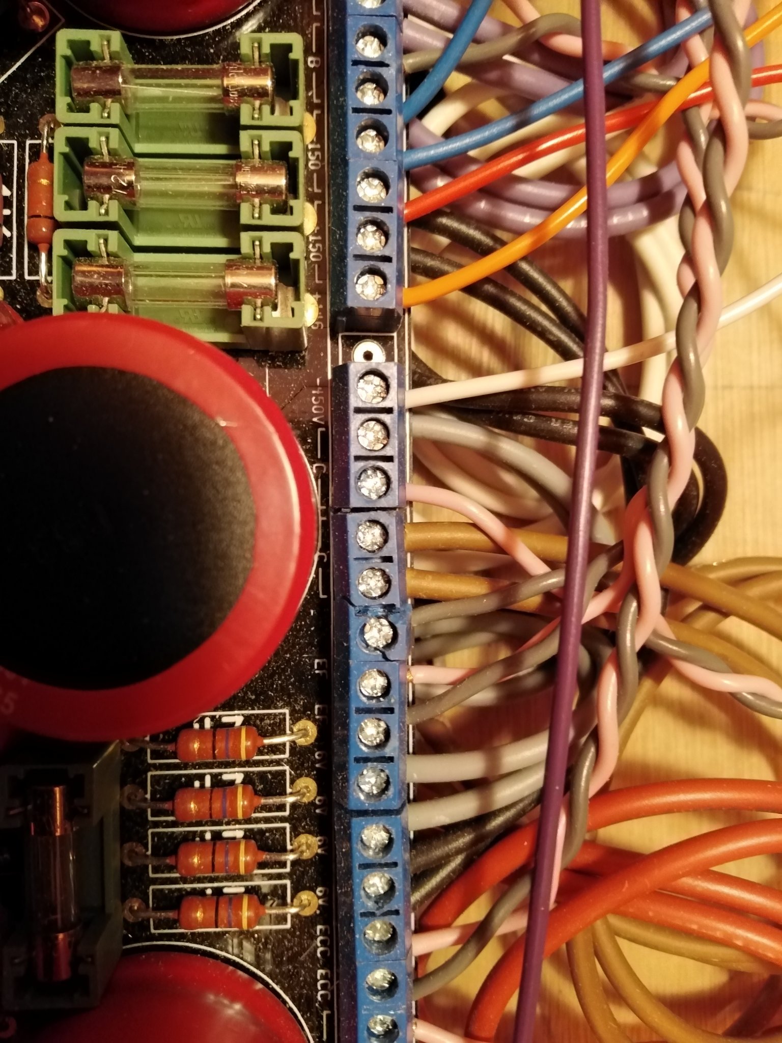

There are quite a few errors on the screen printing of the psu pcb, but if you follow the connection drawing and ignore the printing on the pcb, you will end up with less fuses in the bin than me.

I thought it was something like that. ThanksToroids can be magnetized when shut off, depending on the position of the AC waveform. The next time you turn it on, the existing magnetic field causes the core to saturate and so there is a large inrush current. This can blow a fuse quite easily. When there is a load the random magnetic field is vastly reduced.

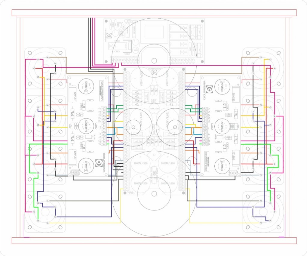

@CaptainChaos, I have never seen that drawing of the connections , the one you posted above with your markings on it. Looks like you got it from Ares, going by the font (!). Could you share it? I have a drawing with lots of coloured lines and the tubes drawn in. The more info, the better. I am in Oslo, by the way.

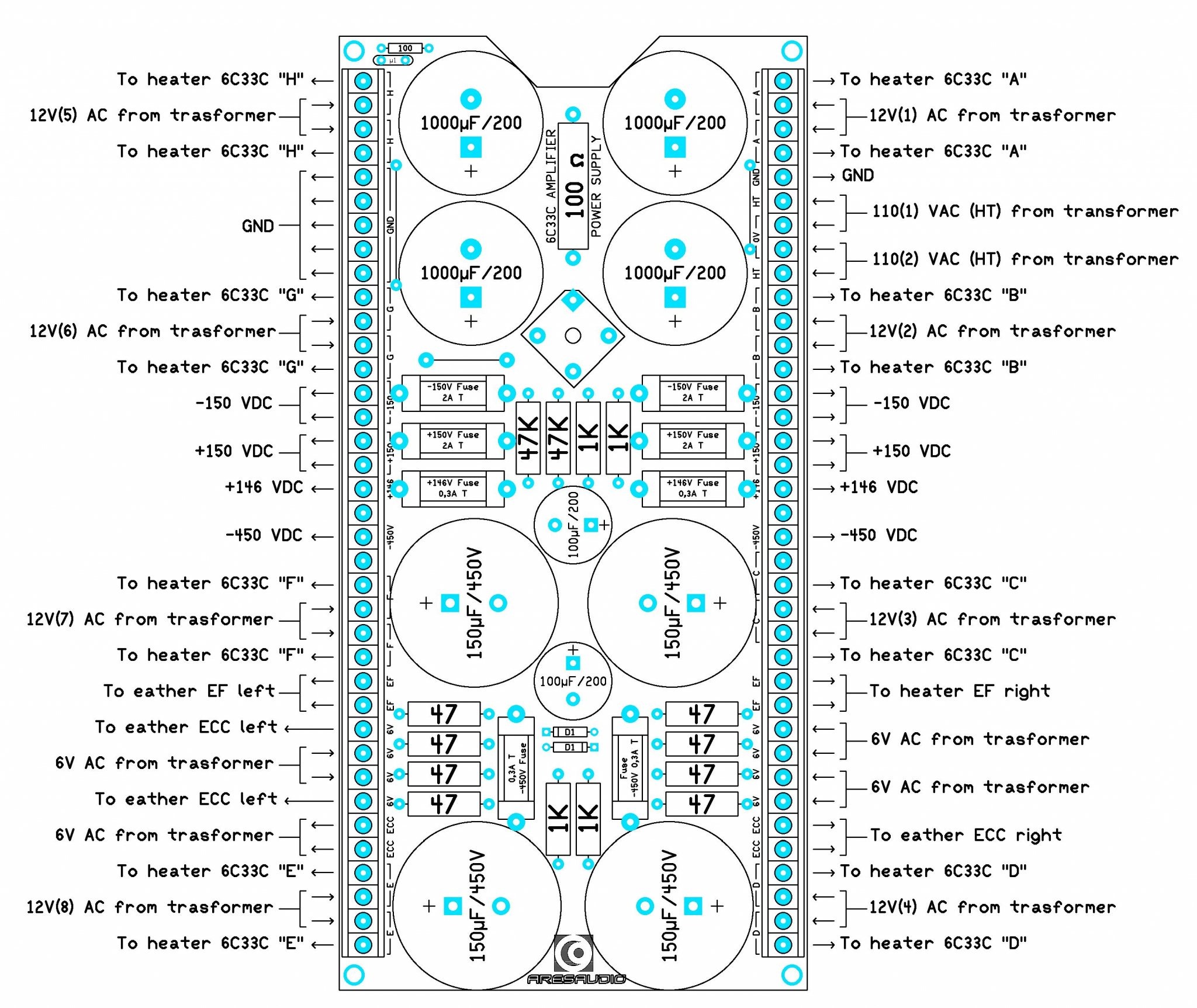

The heater cons for 6c33 (C) are marked wrong on silk screen ! This drawing is correct. and the 6volt on the left is all wrong way round eff is transformer in ect.. I have 4 X 6.3v outputs on my transformer and i had to connect all four to get all four supplies out of the board. The conections on the left do the EFF heaters and the ones on the right do the ECC or vica versa. one side connects to ground through resistors and the other to HT4 -150v

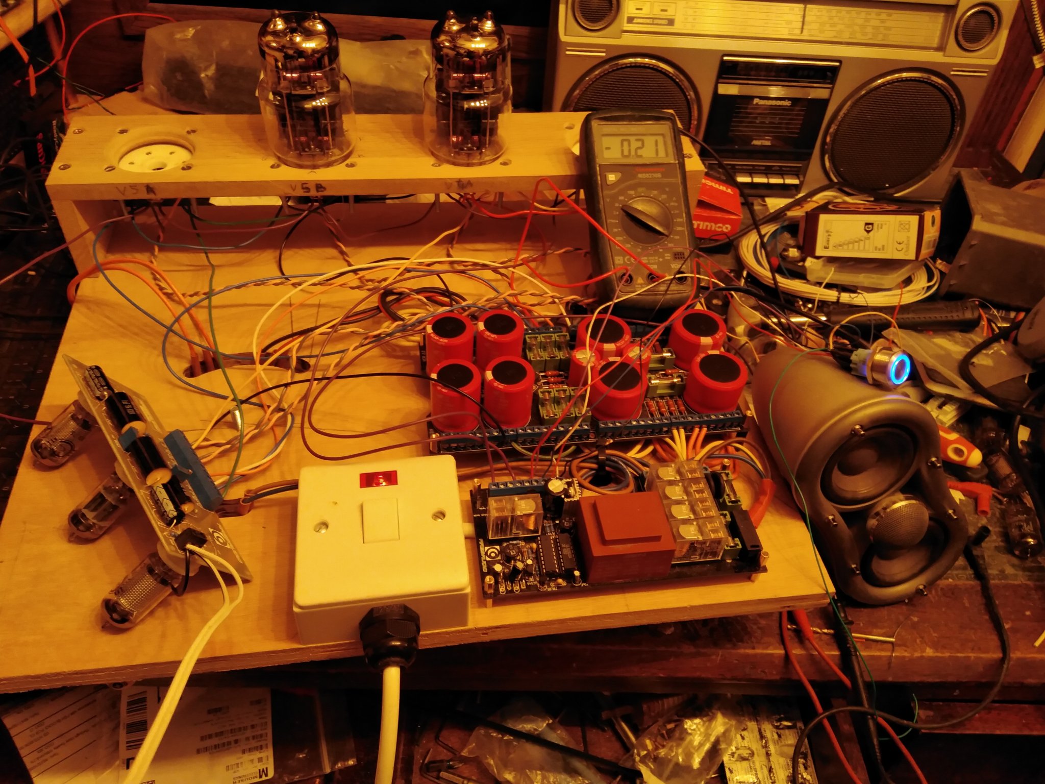

I have finely got One working channel on my Ares / Tim Mellow 6C33 OTL amp. It has taken some time to get this far. There are quite a few errors and conflicting information in the Ares information. So I thought I would outline what i have discovered.
The first PCB I assembled was the soft start / protection PCB. This went all ok, until I tried to install the relays. The pin spacing was wrong, I contacted Ares about this and they told me they were aware of this, and I needed to "bend the relay pins out a little" but the relays wouldn't sit properly on the board. So i drilled the holes larger and soldered them in all nice and flush, only to find I had created O/C tracks as the through-plating was gone from my drilling. wire jumpers fixed this, but it's not very pretty! I will sort this out at a later date, maybe Ares will correct this in later batch of boards.

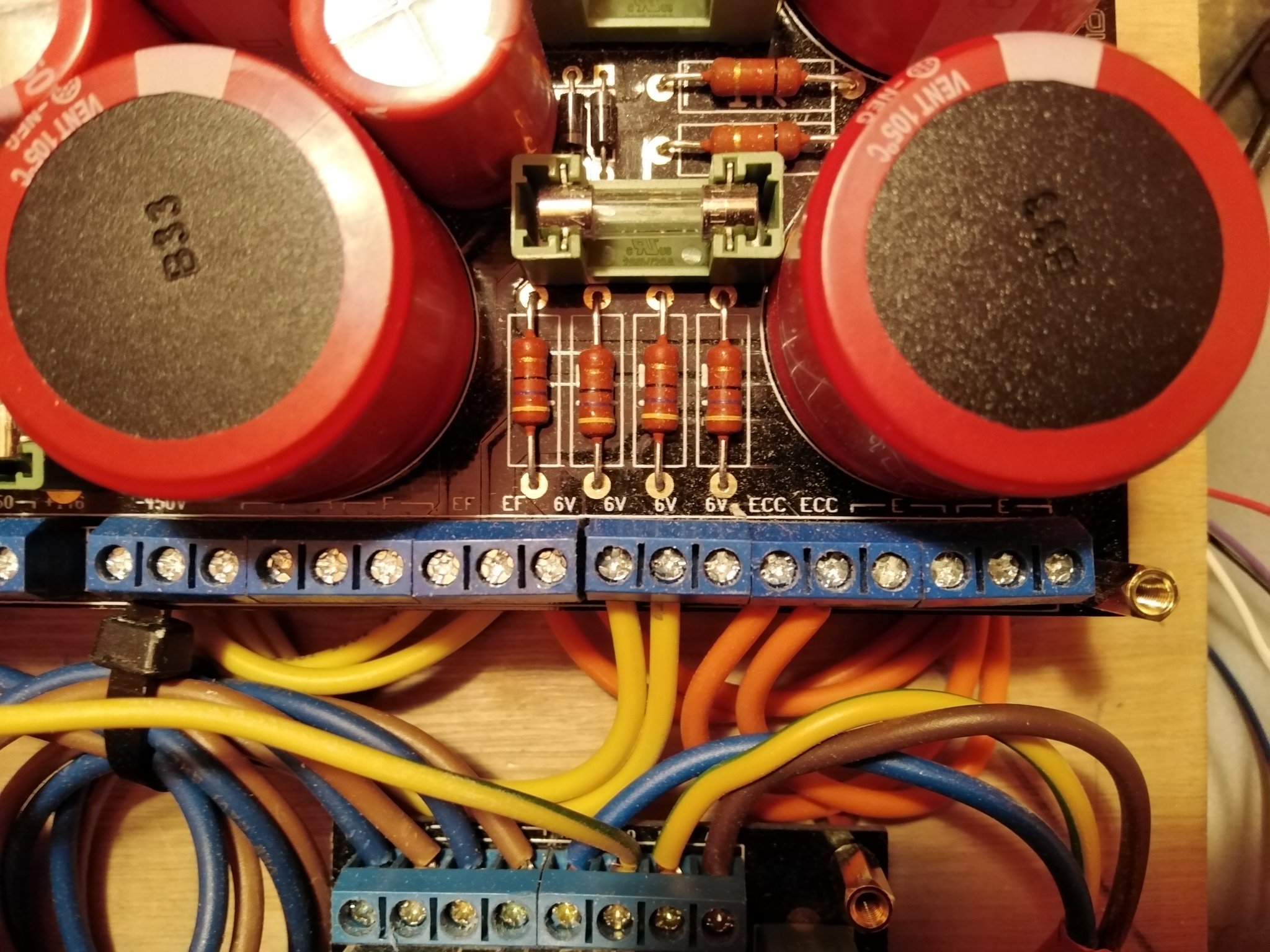

Next build was the Power Supply. The only errors on there are on the silk screen printing. Where Filemants 'C' connect. I connected them the same as the rest and ended up with a 12 volt 9 Amp short for a millisecond, until it blew the leg off the screw terminal ! I have to take responsibility for this a little, as if i had studied the Ares diagram, instead of what was printed on the board, I would of avoided this. Replaced screw terminal and broke another...all good. there are other labaling errors on this PCB. Transformer 6v in and ECC filaments reversed See pic's
The Driver PCB Is all OK.

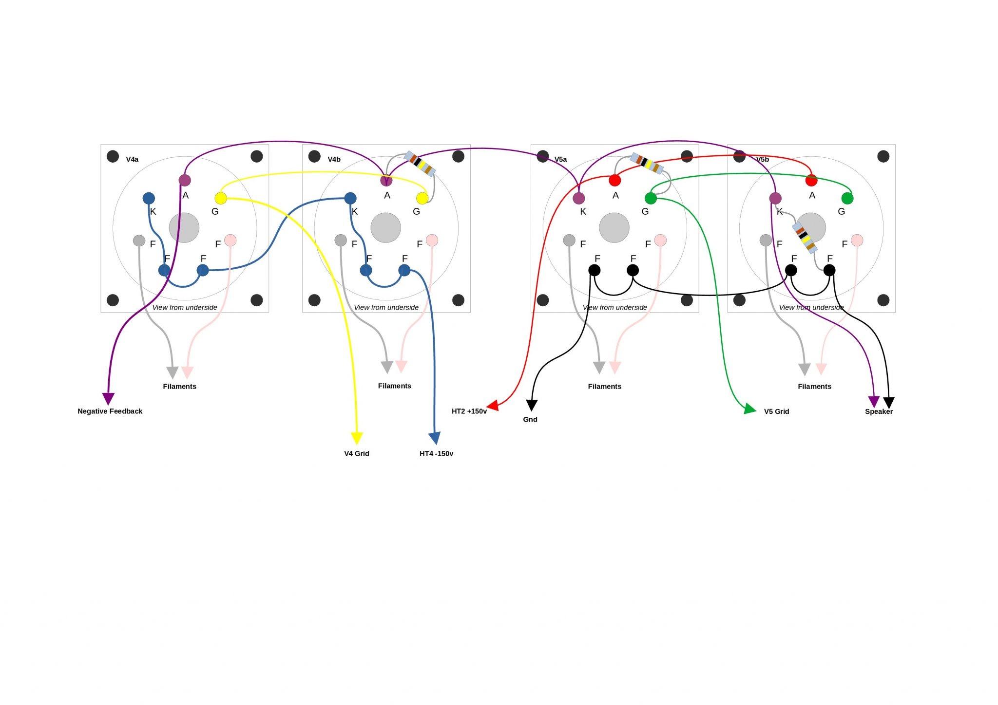

The Drawing for the wiring of the underside of the amp (new version) is completely wrong. I re-drew it and rebuilt it 3 or 4 times before i got it right. It wasn't until the last time that I realised, Ares had also the Cathodes and Grids reversed on there drawing. See my New working drawing.
Hope this will help, now to build other driver PCB, source 4 More 6C33's, and Build a nice chassis to put it in.

This amplifier is not yet in operation, now they are at the level of preparing the tubes.
So I connected all the filaments to the transformers for a period of 72 hours (according to the recommendations on the forum) In this I noticed that the 6j32p tubes do not heat up as much as the others (I think they have a maximum of 35 degrees Celsius compared to the V1 tube which you can't keep your fingers on it.
Measure the filament resistance when cold, maybe (6.3V/0.2A) 30 Ohms, or measure the heater current directly. Try to heat the pin 4,5 to burn off dirt in addition to sanding. Could be oxide formed on the pin similar to 6c33cb, is very stubborn.
Hi Koonw.Measure the filament resistance when cold, maybe (6.3V/0.2A) 30 Ohms, or measure the heater current directly. Try to heat the pin 4,5 to burn off dirt in addition to sanding. Could be oxide formed on the pin similar to 6c33cb, is very stubborn.
Believe it or not, I measured the resistance of the heater and it is 100 Ohm, then I fed the filament with the current source with 6.3 v, and nothing.
I started to increase the voltage up to 12 v...
The outcome? the filament looks perfect and does not seem to be overpowered. How do you explain this?
