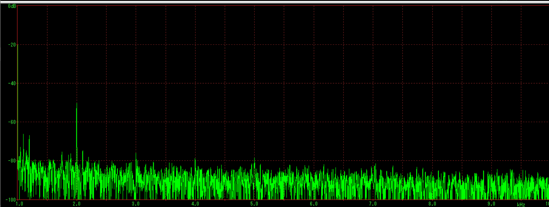

Appreciate if you can post the audio spectrum of your amp for future reference, what tube brand you use and do they have different harmonics? Here is a free spectrum analyzer that you can pick up the tone from speaker using microphone. Attached is spectrum of my amp (not Tim's)

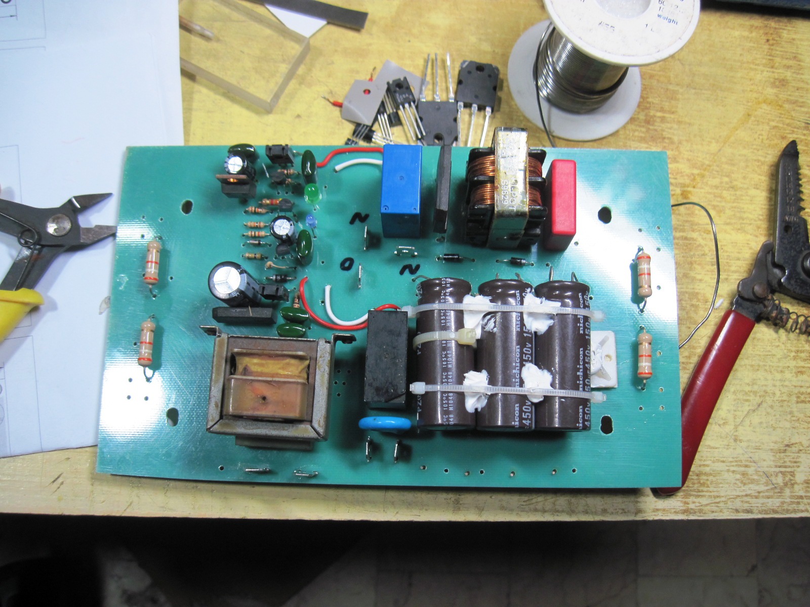

Hey, good day everyone, I was wondering the power supply circuit is for 2 channel or only one, thanks in advance.
Sent from my LG-H918 using Tapatalk
The PSU is meant to supply both channels but you could of course use two with smaller transformers. It's unneccessary extra work though. There are a good few months of work in this amp as it is. I found it one hell of an undertaking and I have been building amps for more than 50 years.Hey, good day everyone, I was wondering the power supply circuit is for 2 channel or only one, thanks in advance.

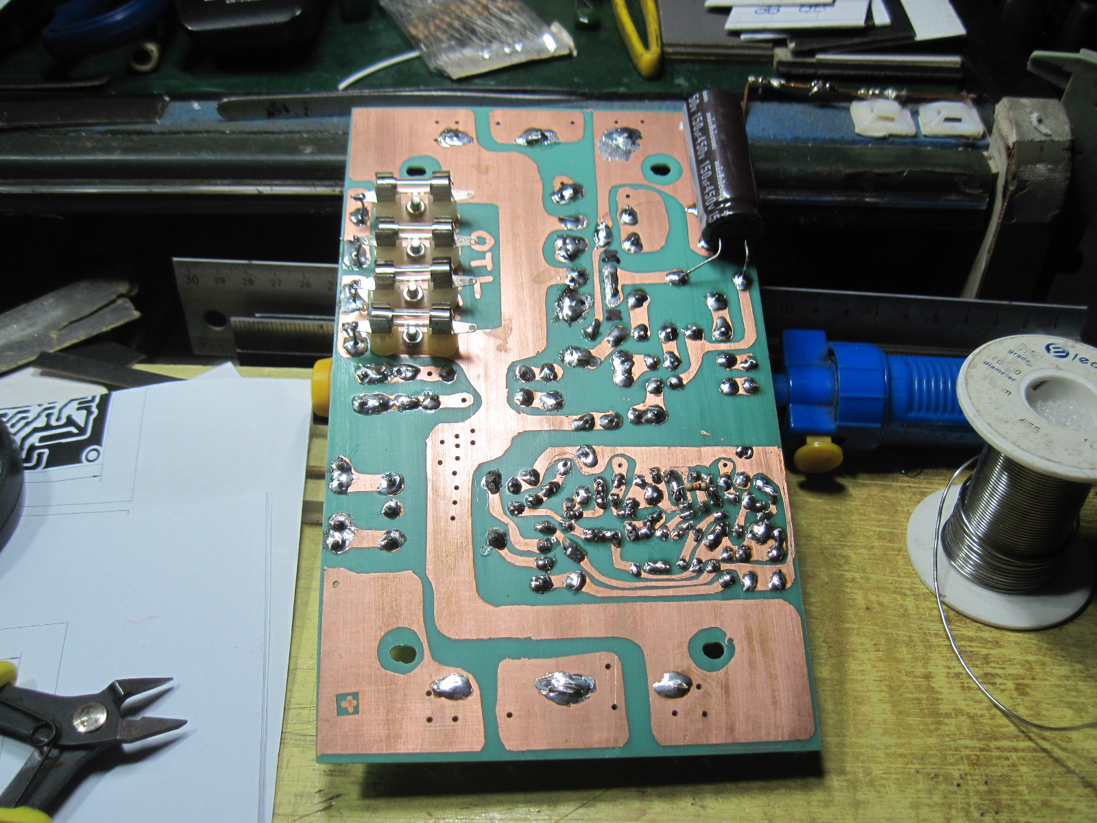

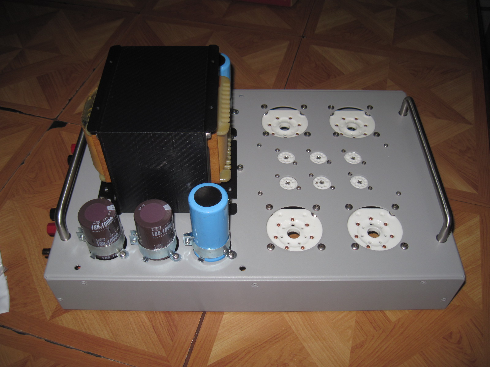

Here is a link to some of my construction shots on Google Drive. LINK

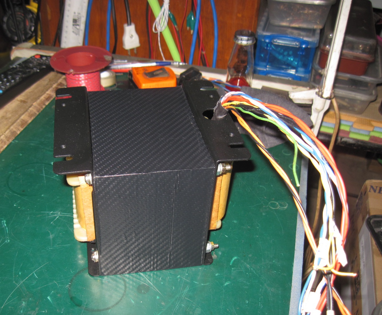

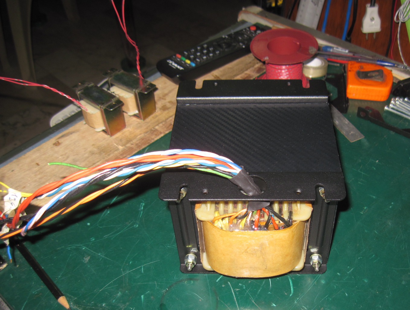

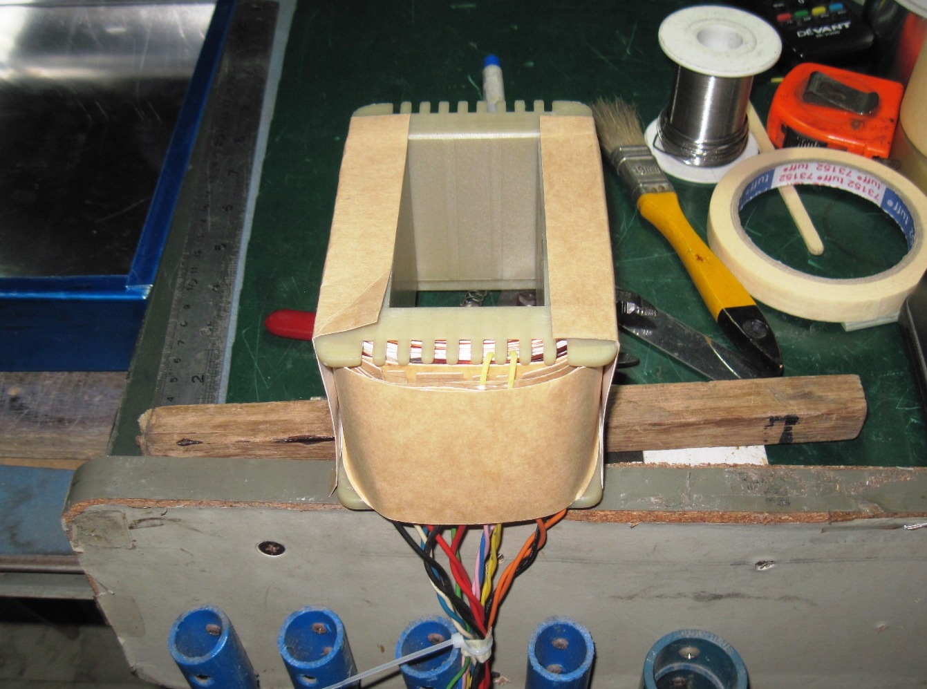

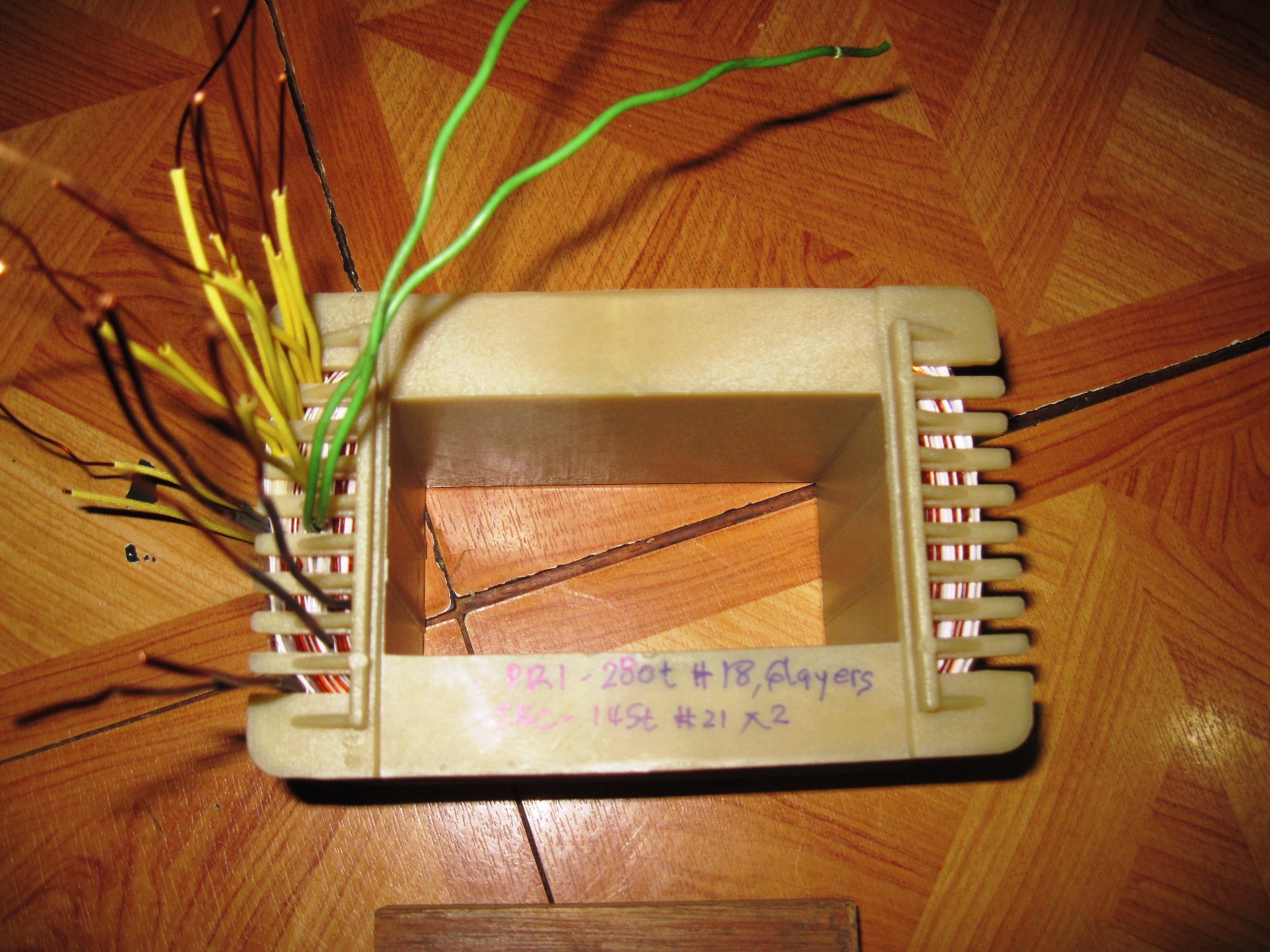

in my build i used a single traffo 1.75 inch center leg, stacked to 3.5 inches,
core rating is about 1.34 kva.....psu is common to both channels....
Did you have the transformer specially wound or was it available as a stock item?in my build i used a single traffo 1.75 inch center leg, stacked to 3.5 inches,
Can you post some photos of your PSU? can be helpfull...in my build i used a single traffo 1.75 inch center leg, stacked to 3.5 inches,
In my project (two mono-block tim's otl) I used 2x400VA for the plate supply, 2x120VA for the heaters and 2x15VA for the first stage plate supply (ecc83) al thoroidal core.
i design and build all my traffos for my projects....
i am not a commercial winder btw, i just make them for my needs...

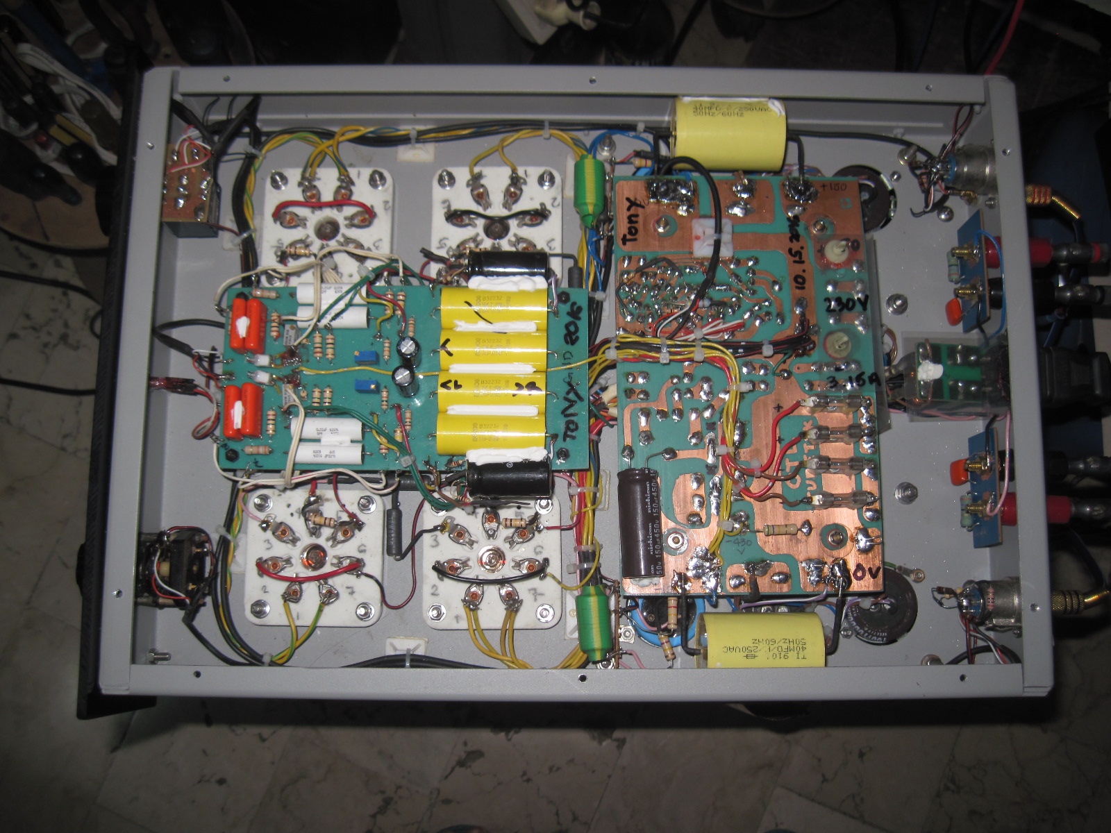

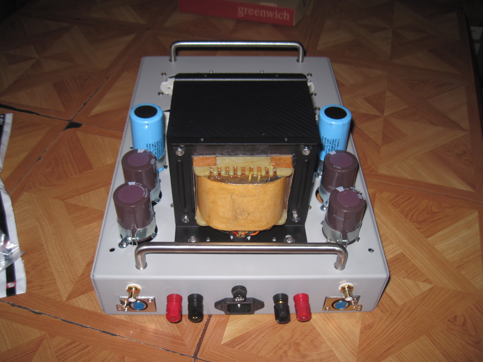

Thanks, nice work, congrats!i design and build all my traffos for my projects....
Excellent work.i design and build all my traffos for my projects....
Good work- but unless you plan to use a fan, expect troubles with melting insulation on your filament connections of the power tubes.
thanks, the lessons learned in the audio show will be put to use if subsequent builds...
