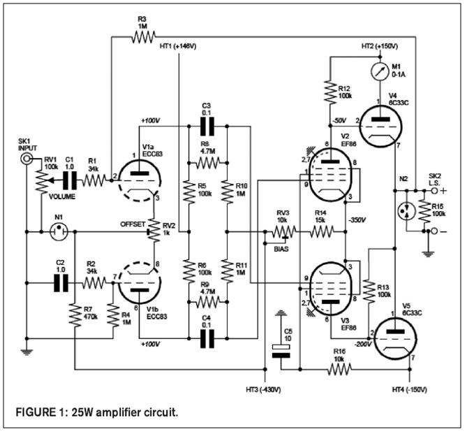

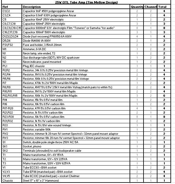

For this schematic can someone provide a parts list that they used please (or one they would use). It's just as a check-list to make sure everything is covered (when I'm costing it up), I don't want to miss anything.

The pdf file of Tim Mellow's article (accessible via a link on the thread you linked to) includes a parts list (you need to double up the amplifier parts (those appearing in Fig. 1) for stereo.

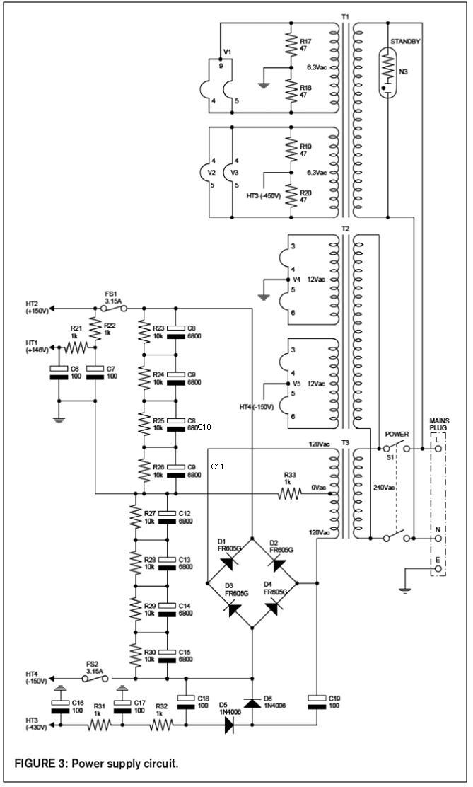

I've knocked up an Excel spreadsheet to help suppliers quote for these parts as a whole, or at least to most of them.
On the schematic (in the Excel file that I can't attach so I've uploaded a pic instead) C10 and C11 have been missed from the drawing, by accident.
I've put the exact same info in the excel file in case you want to use it (PM me) and tailor to suit, this isn't the one I'll send off merely the one in the magazine article itself (included on tab 2).
I've got the quantities right haven't I?
I thought to omit the ammeters but, while you're here, on Fig 2 Power Circuit can Caps C8-C11 and caps C12-C15 be replaced by one cap each (say 6800mF 250V) instead? This also does away with resistors R23-R30 too..?

PS I'll trawl the other threads again but if there are any things I could do without ordering please nudge me. This is to power full range 96dB 8 Ohm speakers voigt pipe.

Yes, you can just replace the series-connected power supply capacitors with one (or more in parallel) that can take the full voltage. Indeed, you can omit the ammeters. I just used a low-value resistor (0.1 ohm) across a couple of tip jacks, so that you can measure the voltage (and hence current) with a DVM. It's a good idea to put a resistor across each PS capacitor, so that it discharges after the power is turned off. Might help to avoid a nasty shock!I've knocked up an Excel spreadsheet to help suppliers quote for these parts as a whole, or at least to most of them.

you can get 50W from 3 tubes SE. A guy in romania did it 🙂. i might be able to find the schematic ..if you desire
A newbie question, if there is any benefit to replace the EF86 to some lower Ra tubes ?? 6688/7788 and even 6E5P ??
does anyone has a stability problem with the amp? after 5 hours one power tube goes red. i put amp off, waited 15 min and it works fine again.
i've heard that there's a frequence peak in output signal and it(feedback?) needs RC circuit to get rid off the peak. i think RCA otl has reactance network to correct this issue...
i don't have spectrum analyser to check frequence sweep and locate peak. 8 ohm load should need 8ohm resistor and capacitor value should be calculate when peak frequence is located....
comments?
comments?
The amp is class A totem pole PP output. But it can still output 70 watts!
I actually did as you advised but I made the resistors 5 ohms. After running multiple simulations I found that 5 ohms will reduce the power out by about 10% and raise the output impedance from 0.12 to 0.15 ohms (approx.) which is no big deal.
I'll actually probably reduce them to 2 ohms (your suggestion) and raise the voltage on the rails to +/-160 (I will have no choice with the trannys I'm using) which should push the output over 70 watts.
I also added C5 and C6 to control the bandwidth of the amp and tone down a slight high frequency resonance above the audio spectrum.
Here's the latest schematic:
is this design work perfect ?

Power supply question
Hello every one . I start work on this project(OTL amp) I do not have transformer with two voltage (120+120) But I got two good transformer with 120V each. How better used them for construction two polar power supply for Tim Mellow OTL ?? Thanks.
I am looking to make this my next build after my EL84 build, and I wanted to use an LM1084 for the heaters, one per tube.
I noticed that one of the heater windings on the Tim Mellows design is biased to ground, and the other to -150v.
Will this cause issues? Do I need a negative regulator for the negative biased winding? Or do I need a positive and negative reg on the top and bottom of each winding?
