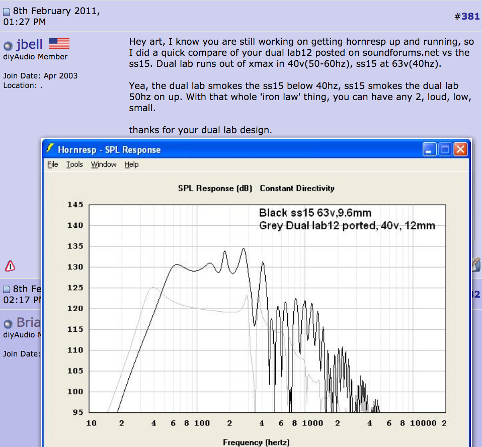

JBell's SS15 was designed to get in that ballpark IIRC:Single Sheet Challenge thread
David,JBell's SS15 was designed to get in that ballpark IIRC:Single Sheet Challenge thread
YR is not C ;^).
The SS15 starts rolling off below 60Hz, is about -3dB at 50Hz, -10 dB at 40 Hz.
