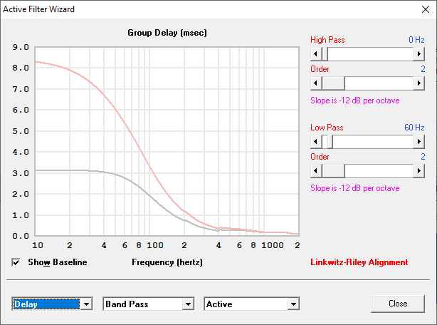

" For kicks, I ran a simulation using Hornresp, and it went like this:
- High power 12", modelled in two different boxes. One was ported, and the other was sealed.
- EQ'd the sealed box to match the ported box in terms of frequency response (ie, flat to 40Hz, dropping quickly below that). They deviated by less than 1dB across the range, so we're comparing apples to apples here.
The results went as follows:
- The group delay curves matched perfectly above 55Hz. At 40Hz, the ported box had 25ms of group delay, while the EQ'd sealed box had 22.5ms.
- The in-band cone excursion of the ported box hit 8mm one-way at 60Hz. For the sealed box, it's 38mm at 40Hz.

I ran a Hornresp sim of a PD1550 in a sealed 44 liter enclosure. Basically the response is that of a midbass speaker with an Fb around 90 Hz and a rolloff that starts above 100 Hz, and is 18 dB down by 40 Hz. Sure you can use EQ / filtering to flatten that response curve and turn that midbass speaker into a subwoofer, but that EQ is going to add its own time domain issues. Here's what happens when you use a 60 Hz LP LR filter to convert it into a -3dB @ 40 Hz box, for example.

For sure Brain, 20 years ago your Linkwitz Riley filter would have introduced group delay...
But, thankfully, in todays world with the abundance of DSP (I use Audiolensehttps://juicehifi.com/ ) one can implement studio grade time domain correct crossovers and Eq which give you the best of both worlds with zero group delay... The Raison d etre of these programmes is to eliminate group delay!
The days of using Matlab to try and force LR analogue crossovers into time alignment across all frequencies are over!

Not so fast.
FIR (linear-phase) filtering still incurs a time penalty.
It's fine for playback applications, but a 10s of ms system-wide delay would be unacceptable for DJs or live sound.
That's assuming, of course, that you can find something that'll implement FIR filters well below 100Hz - it needs a lot of taps!
With a really high sampling rate (384kHz+), you can cut down the delay, but we're once again getting towards the super-expensive end of an already high-end arena. To give you an idea, Powersoft's X-series run at 48kHz sampling rate. I don't know of anyone making PA gear bothers to run at those super-high sample rates, but since sample rate is inversely correlated with filter delay, it's your best bet.
If you would like to introduce very large FIR filters, is it not then possible to compensate for the phase shift of a ported box?

Very fast actually... Well under 10ms delay!
My 4 year old lap top (i7 core) gave me over 100,000 taps and my new ASUS ZenBook Pro UX580GD (i9 core) and runs both Smaart Live Smaart v8 and Audiolense and I can implement up to 220,000, yes two hundred and twenty thousand taps!
