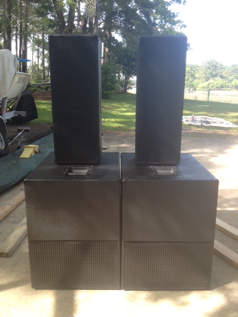

well, fired it up for the first time.
need to deal with an airleak at the 90 degree handle (its not caulked yet cause I need to round that corner over still), but it BUMPS thus far. measurments forthcoming later this week.
The suspension on the faital does seem to start getting noisy after about 15mm p2p (roughly, maybe a tad more than that).
I'm hoping that fixing all the airleaks will help with excursion control a bit.

some final notes.
at high power (almost tickling clip lights on an xti 2 4k, there is some minor panel flex (about 1 to 2 mm, barely noticable). I could have used another brace or 2 on the rear panel.
I'm going to rework the grill mounting brackets so there is a solid pice extending vertically in the horn mouth to help stabalize the bottom panel (which also displays slight vibration with heavy bass). The grill moves about 4mm p2p when I hit it with high level sines in the 40hz range, so this vertical brace should help stabalize this as well.
