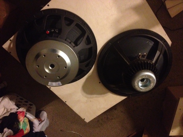

Is that a Dayton on the right?
That magnet looks so small and weird. Good to see the packaging on the Faitals was triple boxed. So let the building begin. 😀

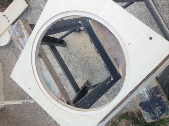

Is all material 3/4" or is the baffle 1"?
I only ask because I couldnt tell from the dado. Also I have been wanting to someday use a 1" thick baffle like DSL and was hoping your doing something similar. Anyways back to the build.

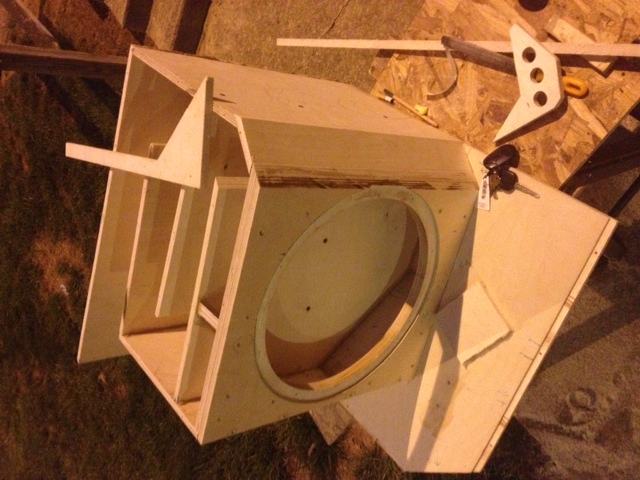

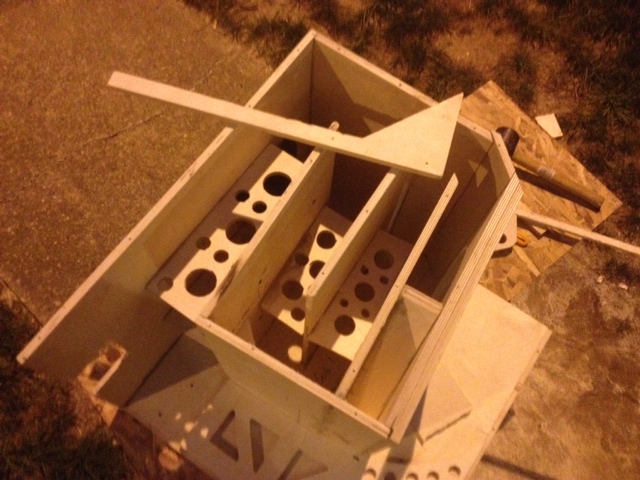

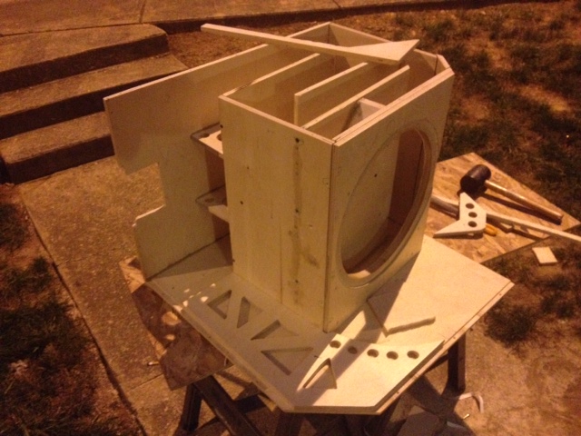

made a little more progress today before tornado warnings drove me inside...
was slowed down quite a bit by the 2 hour worthless phone call with Parts express.

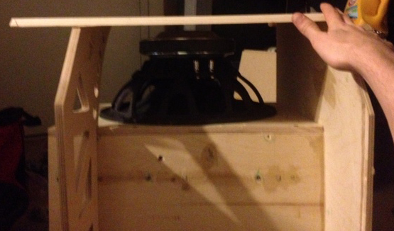

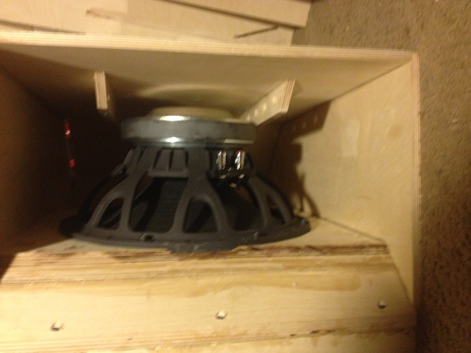

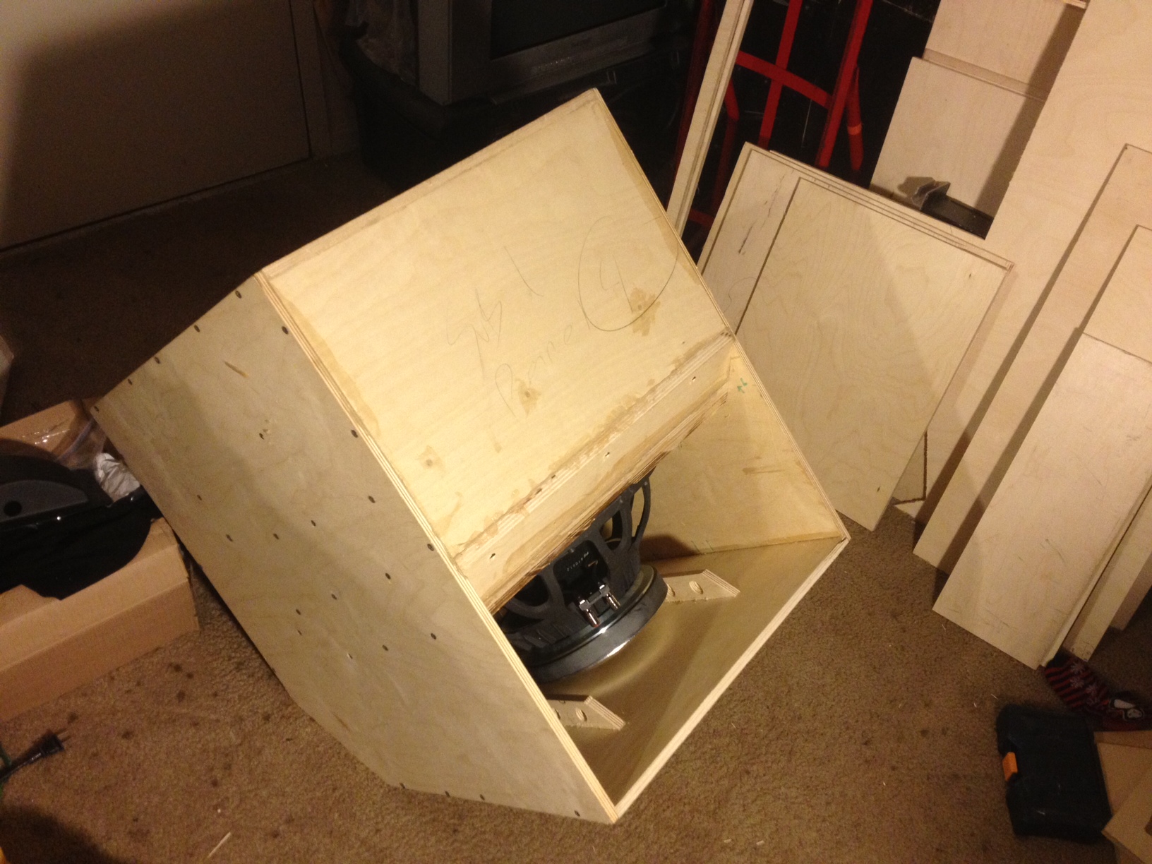

I didn't notice it before, but the mouth section looks a little "tight". How much of it is going to be shaded by the driver's bulk?
eh, its pretty shady in there certainly.
not any more than the tham 15 though (even less actually)
I may go ahead and recess another 1/4 inch.... i've got about 1.2 inches between the vent and the back panel as of right now.
I've been trying to figure out a way to incorporate the effect of the shading on the cross-section in that area. I don't think HornResp can model the effect of driver shading the mouth, at least not directly. I'm going to guess that the Fb and upper bass response is reduced, the amount depending on how much of the mouth section is shaded.
Once I come up with an equation to calculate the driver's cross-sectional area at different points (I'm going to model it as a truncated cone capped by a flattish cylinder (representing the magnet structure), I'm going to incorporate it into my TH layout spreadsheet, so I can have a better visual representation of the impact.
I expect that excursion will be slightly increased, and upper bass shall be diminished as well (with an increase in the 140 dip too). thankfully, there's plenty of excursion to spare up there...
guess we wont know till I finish (and verify I even have the right driver) and I run some measurements :/

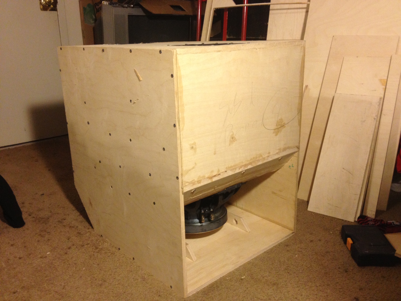

box 1 is just about buttoned up. just need to do the back reflector piece, and secure the speakon jack plate. 😀
Oh yeah, that driver's bulk seems to be noticeably reducing the cross-sectional area of the horn at that point...
that picture was just for you brian lol
like I said, its about the same reduction (or less) than the THAM15 which is generally well regarded here.
