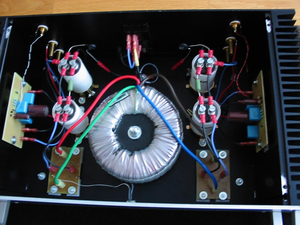

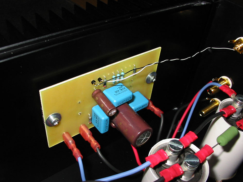

Mad_K said:Inside, don't pay attention to the colors of the wires 😀
I like that, short and direct connections! 🙂
But it was a good idea, to twist the wires , that come from the transformer secondary , to the rectifier bridge...😎

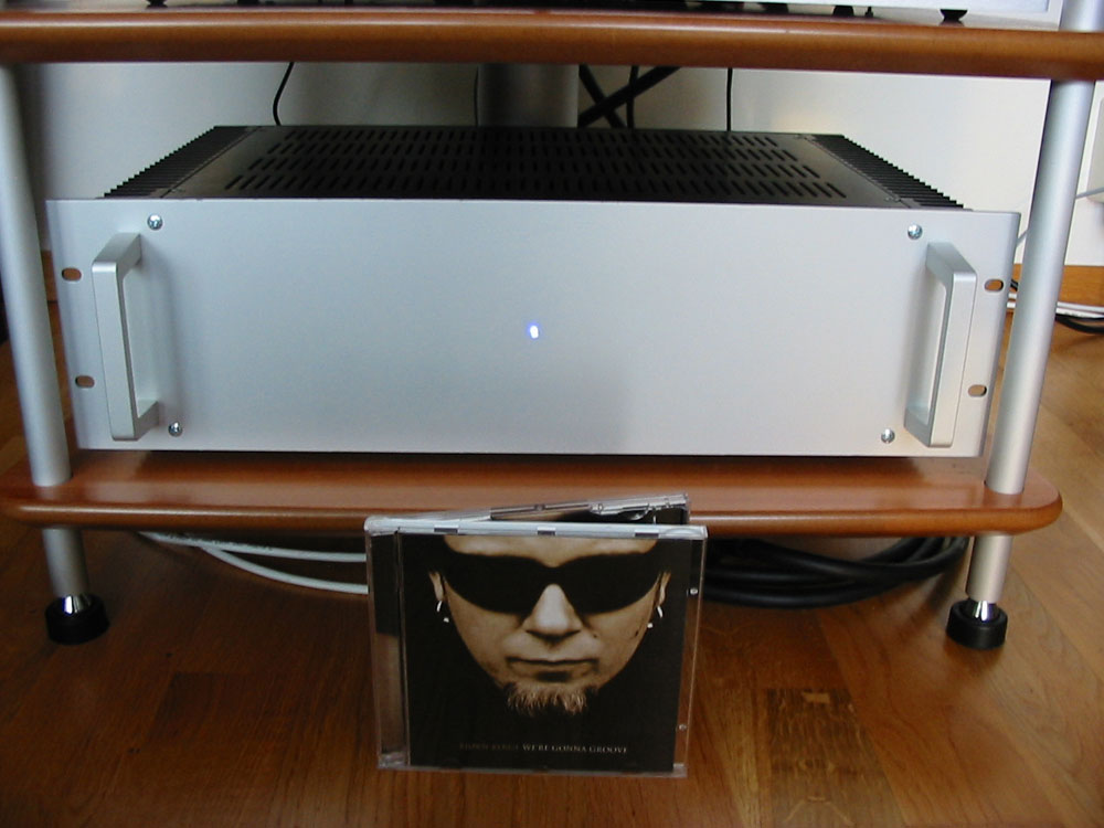

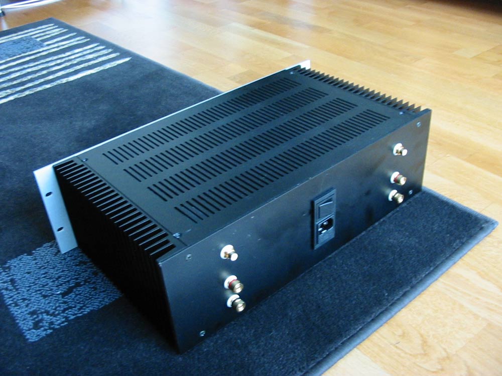

Mad_K said:Now it's time to sit back, pop a few beer's and listen to records until the grey morning![]()
It is from Fisher-Elektronik. http://www.fischerelektronik.de/
They have some nice cases and a good range of heatsinks 😉
