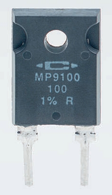

There is one thing to consider when building this amplifier.
This is how to handle heat.
There will be a power of ~60 Watt,
25 Watt in MOSFET and 35 Watt in RESISTOR.
Some good heatsinking is needed.
These ARCOL power resistors are to be put onto heatsinks.
50 Watt rated like in this page 50 Watt HS50 Series may be a good choice.
RS Components Ltd in UK, sells 5R = 5 Ohm (and also 4.7 and 5.6 Ohm)
for £1.78
for £1.78
steenoe said:The schematic says 25W at the Q (only one to choose from ) and 35W at the bottom near R8. Where does those figures belong?
Steen
What do you mean? Q1 dissipates 25W and R8 dissipates 35W

This is the resistor I had in mind, but you can use whatever resistor with the right value that can take the heat. A lightbulb might be nice. The caddock is expensive, but sounds rather nice though
Caddock MP9100-5,00-1%
www.elfa.se # 60-620-87
I missed the fact that it was dissipation figures, as Lineup made clear. Thanks.Q1 dissipates 25W and R8 dissipates 35W
Thats a very good suggestion, and easy to mount on the heatsink tooCaddock MP9100-5,00-1%
