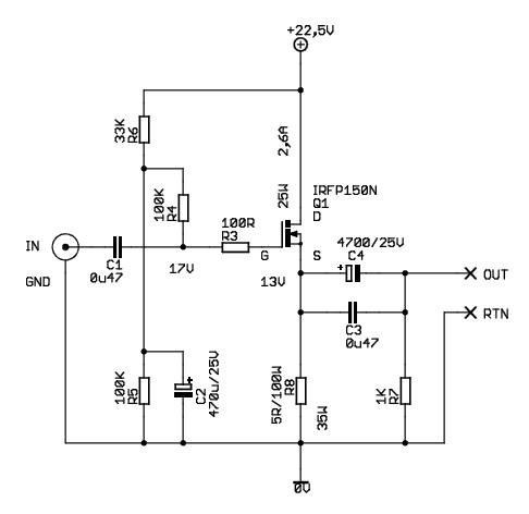

Mad_K said:Will this schematic make everybody happy? (Including my PSRR) 😉
Yes, I consider it as an improvement.

C2 keeps the input at constant potential against ground (in original design), if -V rises by 1V, then voltage at gate stays still.
Have you been had by source follower?

darkfenriz said:
Jorge, Lineup
Yes..but the source voltage is raised by 1 volt and if the gate stay stiil, the mosfet gate source have changed 1 Volt and this 1 volt will appear at the output (as noise).

And that 1 Volt rise.
In the output. Where MOSFET and Resistor is the divider.
Will it add 1 Volt across Resistor or across MOSFET?
Because surely there will be an 1 Volt increase somewhere.
And best is if load output is taken across the part of output
where that 1 Volt is not added.
My guess is that if Gate stays at same potential (filtered by electrolyt lowpass filter)
the Source stays at same potential
but any ripple or supply AC voltage change will be across Drain-Source of MOSFET.
And if output is taken across MOSFET
any supply AC change within audio frequency will also be transmitted to LOAD.
After a good nights sleep I'm even more happy. Starting to agree with you on the PSRR guys. I will rename it when it changes revision (in my book). I'll do a PCB that fits into the place of my active design, have a listen, then I'll snap some pictures and we can have some more of this enlightenling conversation. Good to see the PSRR of this thread has gotten better BTW 😉
Resitor has 5 ohms, hexfet's source at ~2A probaly 5 siemens. Ratio=25 times=28dB=not_that_bad
If I miss something please be patient and nice and explain me, because I hate things I don't understand.
BEST REGARDS
I missed something in the first version, darkfenriz.
That the C2 capacitor was attached to GND, not to -22.5V, which I thought.
This means you are right. It does not change much with new version.
But still there is a slight improvement with new version.
As in the first version AC supply ripple will appear across Power Resistor
there will be a AC current ripple in this resistor,
and when current changes in MOSFET,
this means small Gate-Source voltage changes.
This voltage change will be across the LOAD, if LOAD is taken across FET.
Darkfenriz , think that in the first grounding arrangement , you have a resistance of 5 Ohms between your signal , referenced to one rail and the other (noisy ) voltage rail....in the SE (special edition version... 🙂 ) you have a very high impedance ( near a CCS , the Mosfet intrinsic drain resistance ) between the signal reference and the other voltage rail...
Agreed, but that's not that tragic with proper star ground I think.
But still, you are right, SE is better.
The star ground don't have nothing to do with it , after all ,is in the AC diference between the power rails , that is the problem.
But if instead the 5 Ohms resistor , you use a CCS , the problem diminish...but it's still better the SE arrangement.

For anyone
who wants to know what we are discussing:
Here is newest version of OTA - One Transistor Amplifier by Mad_K
See my attchament here below.
Mad_K has posted PDF schematics of amplifier and power supply
in Post37 and Post38
- This amplifier works in Single End Class A.
- There is no voltage gain.
- There is a lot of current gain.
1 transistor, 6 resistors and 4 caps. C3 and R7 are not strictly necessary, so then we have 9 PARTS ! And it sounds very good too 😉
