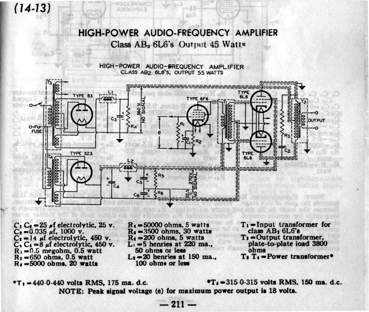

Thanks for that!In the distant past that is what some folks did. See the attachment from a 1940s RCA manual.
To me, there are some curious things in that schematic, such as C3 (main power supply filter cap) being located far away from the output transformer, and the B+ line between them being shown with electrostatic shielding. Normally we wouldn't expect (or want!) any signal voltages on the B+ rail, so why is it shielded?
Similarly, I don't understand why the ground line connecting the centre-tap of the interstage transformer is shown with shielding on it; why shield a wire that is grounded, i.e., has no signal on it?
-Gnobuddy
Those nodes are shielded because they have signal on them when input signal is applied, plus they have hum signal on them even with no signal. With low levels of bypassing, and loss of treble from screening input circuits, I think the aim is to minimise the local parasitic capacitance coupling from wiring in the amp to sensitive input stage.
The circuit uses 'back biasing' of the output 6L6's, so shielding on the IT CT makes sense. In those daze high capacity electrolytics were unknown, so Choke input filter was common, especially for large loads of great delta. You might have heard of the 'swinging choke', a choke of large inductance at small currents but much less under load. The advantage was small size for a given reduction in PS ripple & good voltage regulation. Not common now at all.
If I were to do this cct today I would add a low inductance cap of say 0.1 to 0.5 microF at the OPT HV CT to Common.
The large distance on the schematic separating the PS from the amplifier is nothing more than to make it easy to read. In the actual cct one can do whatever it takes to keep the strays to a minimum.

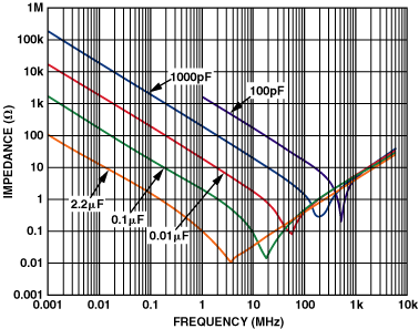

There is quite a bit of information on the web with regard to frequency dependence of electrolytic capacitors. Here is one of many-
impedance - Frequency dependence of electrolytic capacitors - Electrical Engineering Stack Exchange
The proper address for that link is- impedance - Frequency dependence of electrolytic capacitors - Electrical Engineering Stack Exchange
Here is a more complete reference, not required reading. And no test after this, but interesting just the same!

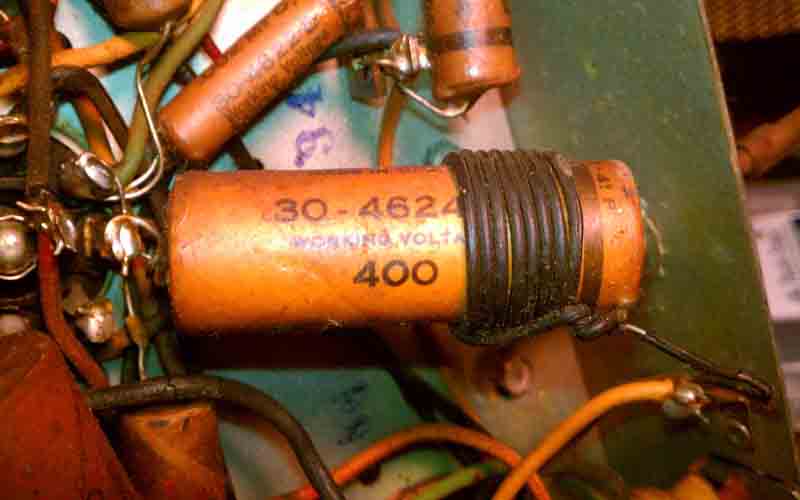

For the curious & others here are some capacitor resonances I checked 15 years ago.🙂
In addition to these examples two others come to mind. The 0.01 microF ceramic cap with 1/2 inch leads often used as the bypass cap in IF strip of tube type FM receivers is said to be series resonant at ~10 MHz. Often mentioned in the construction manuals of Heathkit, EICO & so on. I've not checked that but given their reputation I would have to believe.
Another tubular is self resonant at 455 KHz, made by Philco. It looks like any other cap but could create serious problems in any audio amp. Refer to the attachment.
Some radio manufacturers did the same with an external coil on a common cap.

The electrolytic capacitor data in one of the links jhstewart9 shows a roughly 2MHz impedance minimum for a 2.2 uF electrolytic capacitor. Since a number of other capacitor values are also plotted, one can compare them, and see that the impedance minimum seems to shift down in frequency by roughly a factor of 3 each time the capacitor value increases by an order of magnitude.
This suggests the frequency (of the impedance minimum) is inversely proportional to the square root of the capacitance; which is also mathematically plausible as this is how the resonant frequency of an LC circuit scales with the value of L or C.
Assuming that scaling relationship is reasonably correct, the 330 uF caps I use for B+ filtering in my preamp might be expected, very roughly, to have a resonant frequency in the range of 100 kHz. That is a factor of 4000 lower than the 400MHz capabilities of the valve itself.
