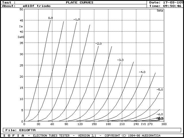

Has anyone built an amp using uhf mega steep tubes or just using theory?? Can you use the normal ways to control oscillation?Audio tubes are not very steep, but when you use uhf mega steep tube.. You asking for trouble
Is 20 mS steep enough? Working quite well in a low noise audio pre-amp.
EFP60, not a power tube but developed for TV IF has a very large gain/bandwidth product. So it is able to provide a very low drive point impedance (16K) in this cct to the following grid. And still provide sufficient gain. In an RC coupled cct this results in lower distortion.
Used lots of them in a research project when they were available but never in an audio amp. Another possibility is the 7788. Was used in the HP 1402A vertical amp plug-in for the HP140 Series scopes.
Neither one a project for the inexperienced. Some may have seen this on another thread.
