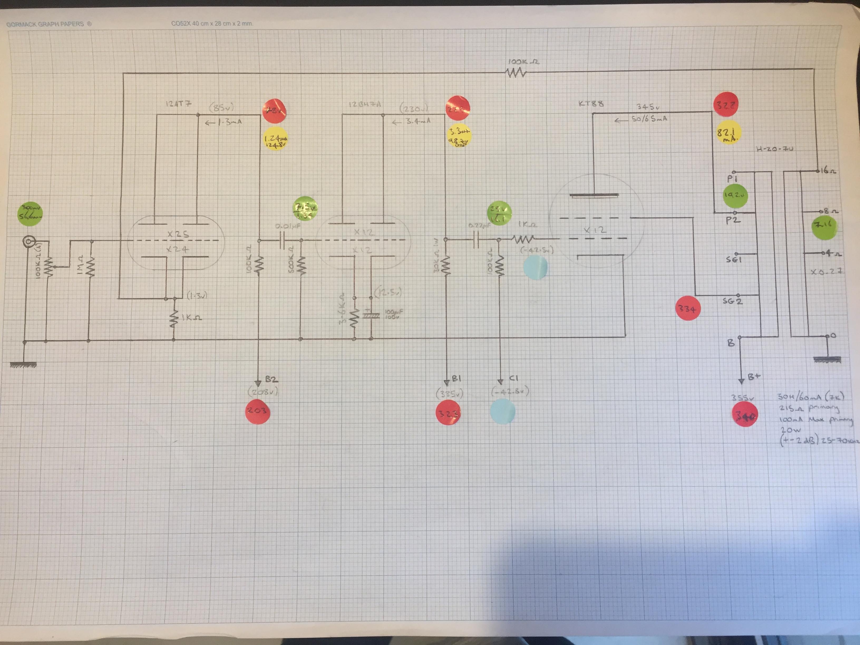

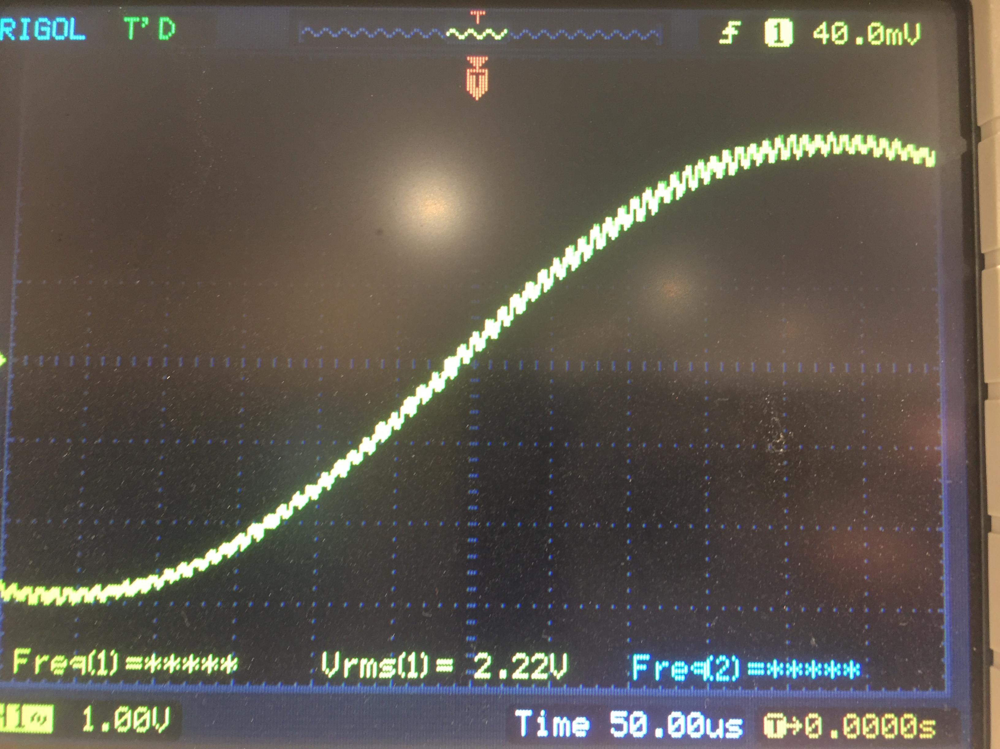

SE KT88 111.1Khz oscillation
Im reaching out for suggestions as to why i might be getting this 111.1 khz oscillation on both channels of an amplifier Ive built.
Ive tried all sorts of work arounds and experiments on one channel to try to pinpoint where this is originating. One of the last things I have just tried today is Cathode biasing the KT88’s rather than fixed bias and this has killed the oscillation.
The other way is by shunting from P1 terminal ( on OPT) to ground. this also kills the oscillation. Im really hoping to understand why this is occurring in the first place to avoid it rather than introducing more components to fix it.
Can provide more info but have attached a schematic of the amplifier stages with some measurements (although measurements may not be clear)
Cheers
Harry

You need to reduce the open loop bandwidth to form a dominant pole. Try a series RC network
from the first plate to ground, something like 5.1k in series with 180pF/400V. Make the capacitor
a little larger if necessary.

Connecting the OPT P1 to ground shorts out B+ to ground. Using a capacitor connected to ground shorts AC to ground. Of course the oscillation stops.
You have a 3 stage amplifier, and global negative feedback.
But there is no apparent dominant high frequency rolloff pole.
And there is no compensation cap across the feedback resistor the one that connects from the 16 Ohm tap to the input tube cathode.
What is the dominant pole?
The output transformer; the Miller effect capacitance of one of the tubes?
You are paralleling triodes, tying the cathodes together, the plates together, and the grids together. Where are any of your individual grid stopper resistors on each grid (connected directly to the grid pins of the tube sockets.
The input tube, 12AT7 is an RF tube (think RF oscillator, unless it is dealt with properly).
I can not read the schematic to see what the second dual triode tube type is.
You changed from fixed bias to self bias. Did you bypass the self bias resistor with a bypass cap?
It also may be your grounding techniques. You may have a ground loop (like the currents of a later stage that is causing a small signal to an earlier stage's ground point.
One time when I paralleled the cathodes, plates, and grids of a 12AY7, I had to use individual 1k grid stopper resistors, And also had to use 1k individual plate resistors, and joined the other end of those 1 k resistors to the plate load resistor (the plates were separated by 1k + 1k = 2k).

Thanks for your suggestion rayma, when you said first plate, Are you suggesting a 5.1k in series with a low value cap from the P1 terminal to ground from the OPT? or first plate meaning first stage plate (12AT7) Thanks!

Apologies but i dont understand when you said: "But there is no apparent dominant high frequency rolloff pole" Im fairly new to this and not something Ive read about.

I get the oscillation with no input and with input rca's shorted out.
The first tube's plate, the dual 12AT7.

Thanks. I tried this with a 470pf But no joy.
I have a plug in 8pin device which allows the connection of an inline ammeter. Ive found that by having the KT88 plugged into this by moving the KT88 and the assosciated wiring around has a large affect on the oscillation (while watching on the oscilloscope)
I got the oscillation to stop by sitting the KT88 (and the wiring going to it) well away from the chassis and the first two stages (150mm) and installing a grounded shield over the 12bh7a
The oscillation is impossible to remove however when the KT88 is back in its socket. Ive tried cans over each tube with ground clips as well as 4mm thick steel plate between stages. I thought initially feedback between stages but i dont feel this is true now. any thoughts?

I tell a Lie Rayma. This has worked. I noticed I had a 510K rather than a 5.1K installed.
I used a 5.6k with a 470pf as thats the closest I have and seems to have worked... Great result.. But only on one channel. As I am experimenting at the moment to figure out this oscillation I have one channel wired as fixed Bias (which is the channel your suggestion worked with) and the other channel is self biased with the cathode bypass capacitor I just installed today. Unfortunately it didnt work on this channel and the oscillation is still there.
Can you help me understand why the oscillation happened and by doing what you've suggested why this works/ the benefit of this RC filter over shunting the oscillation at the KT88 plate is? Im doing the tube amp project to learn. So more info i can take from this the better. Thanks!
The high frequency poles of this circuit are too close together, causing instability. The new series RC network
adds a dominant pole, lower enough in frequency (around 10kHz) that those higher frequency poles no longer
affect the stability. It's best to add this lower frequency pole earlier in the circuit, rather than later.
