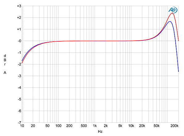

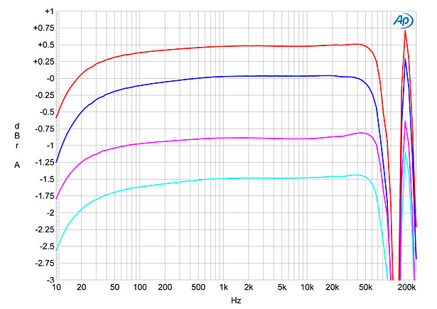

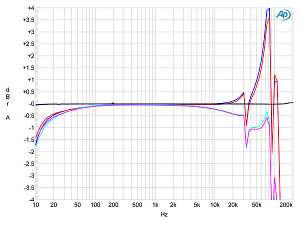

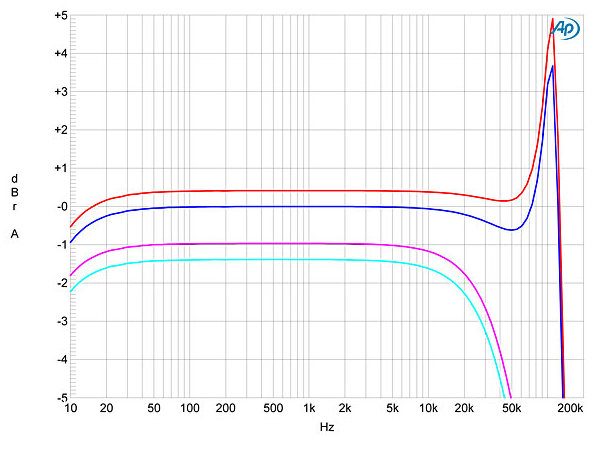

For your amusement, I am re-posting some screen-shots of a pair of ultra-expensive and highly regarded "tube line amplifiers" with problems.
Something in the circuit is capacitively coupling to the ribbon cable - that is why moving the ribbon affects the oscillation. To reduce this unwanted coupling you need to put a grounded conductor between them. Don't fully shield the ribbon, as that will introduce extra capacitance and could cause new problems. Don't wrap a wire around the ribbon, as that will have a similar effect. Just try to identify what the ribbon is coupling to, then put something grounded between them so the ribbon can't 'see' the other circuit node, or at least can't see it very well. Look for something in the circuit (physically nearby) with the same polarity signal but at a greater amplitude. Or antiphase polarity (when phase shift is finishing the job).
I had to do this with my Mullard 5-20 amp. A large polypropylene coupling cap was causing oscillation so I put a zigzag of grounded wire between it and the LTP output. Note that an LTP has both polarities at its output, so it is always possible for one of them to create problems via capacitve coupling to an earlier point in the circuit.
Thank you for clarifying for me. I have some more time today to work on the amp, my first course of action is to make a zig zag ground wire and place it physically on once side of the ribbon cable or the other. When the back panel of the amp is off there is nothing on that side of the ribbon cable to couple to, but this is when the oscillation is at it's worst. So maybe the ribbon cable is coupling to something on the main board? But then why does it get better when the back panel is put back on? From what I can extrapolate from the linked article, a guy in oz says that there is a resonance in the PI from capacitance and resistance?😕 I think he meant to say inductance? That page makes me feel that they are just guessing at fixes and haven't actually found the exact problem. Oh well I am going to make zig zag wire and report back with my results. I actually do feel this is a better approach now that I think about it. I am still going to resolder the ribbon connectors, I don't trust the wave solder machine.
Hi, and wow! Is there a transformer in the line amp signal path?
