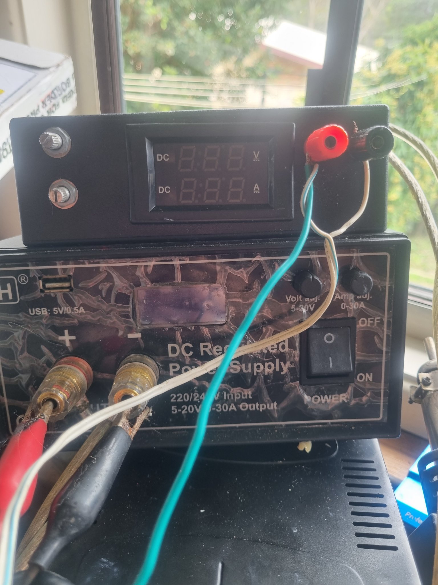

I have a (AC) 30DC supply which I use to run a smaller home made supply that gives more accurate readings under 5A. This is perfect for repairing.
If I need more than 5A I move to my larger 30A supply.(which is rarly) The reason I don't just use this alone is its current control is not accurate under around ~5A. And as u know u do need to keep a very close eye on those numbers.
Anything higher than than 30A I just move to my LTO bank 🙂

Not pretty. But I don't need pretty. I need something i can rely on and most importantly that I know very well. Have been using this setup for years and know it extremely well. 🙂
No I never put an amp on the 30A supply. Always off my little home-made that is generally capped at ~5A depending on what I'm working on. I generally don't need over 4A until it's time for a load test (subwoofer)

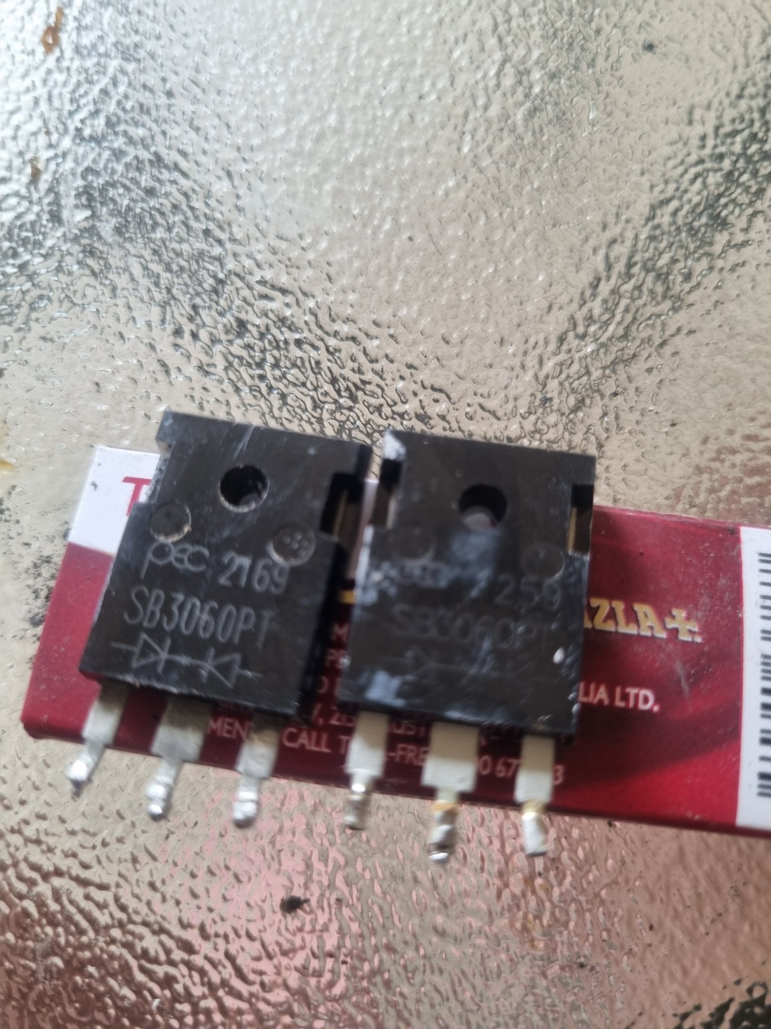

These are why the fuse In my AC power supply blew. These rectifiers are shorted so the fuse kept blowing. I'll order parts for it now and hopefully have it up and running again soon....

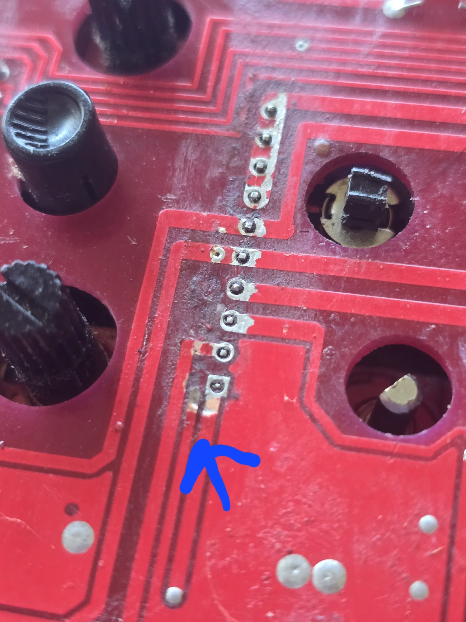

But just wanted to ask if anyone has some nice clear photos of where there output driver boards solder to the board?
I've found a stray trace and can't figure out where it goes..... no vier that I can see....
