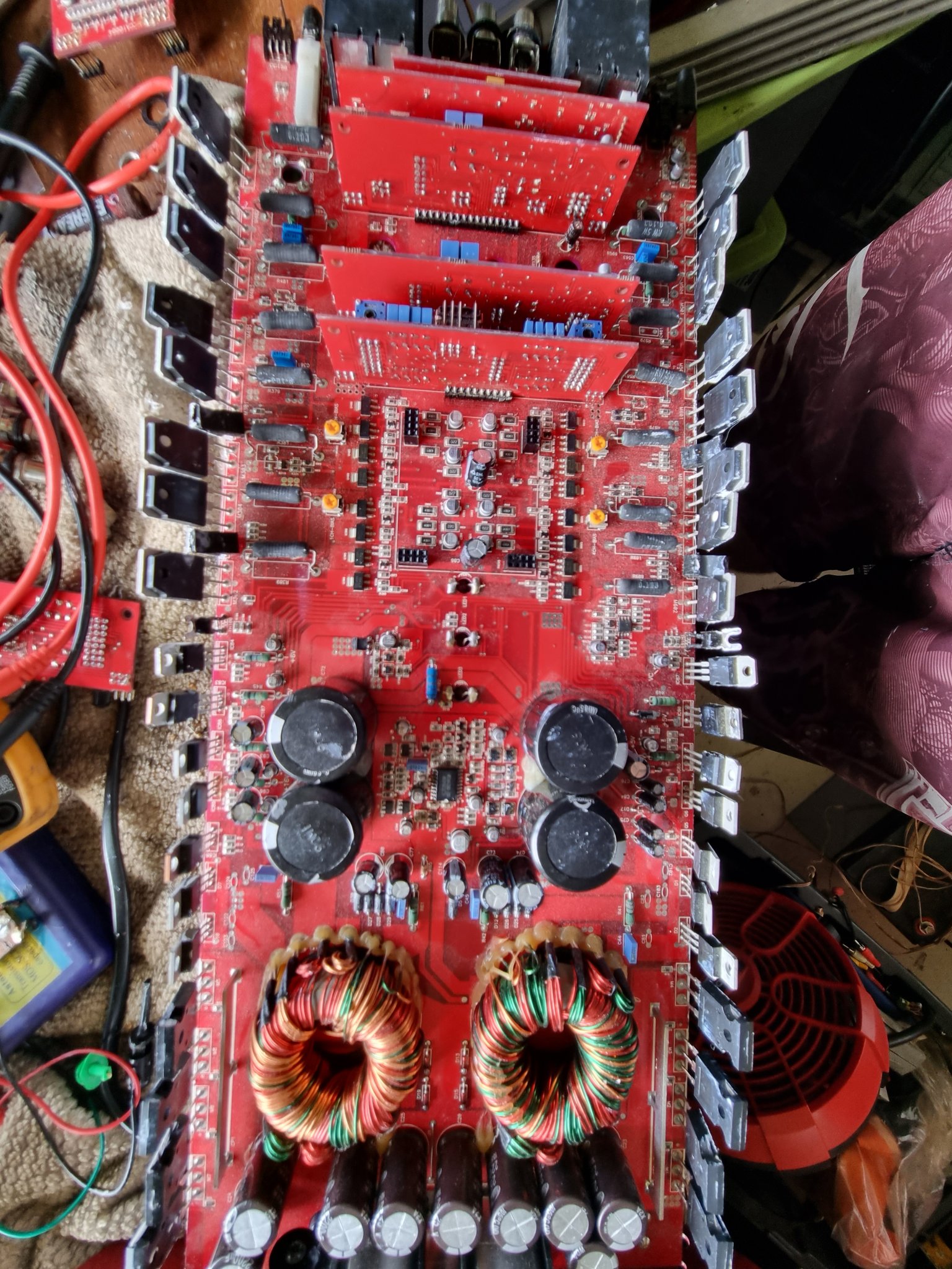

OK got an Orion hcca in for repair.
Power light was comming on but no power supply switching.
Owner said he saw the over voltage light then had no audio.
I noticed R768 was open so replaced that and swapped out the PNP it runs as it was shorted.
Amp now tries to turn on however just draws a heap of current and will switch on off on off ect. Only can see switching for a second before it restarts.
I'm brand new to class A/B. All output transistors seem ok.
All power supply mosfets seem ok...
If I remove Q713 the power supply will switch fine with no issues. But I'm not getting auxiliary voltages up in the output section....

Don't know exact model perry it came to me missing all its covers.
All I know is its an Orion HCCA 4 channel class A/B

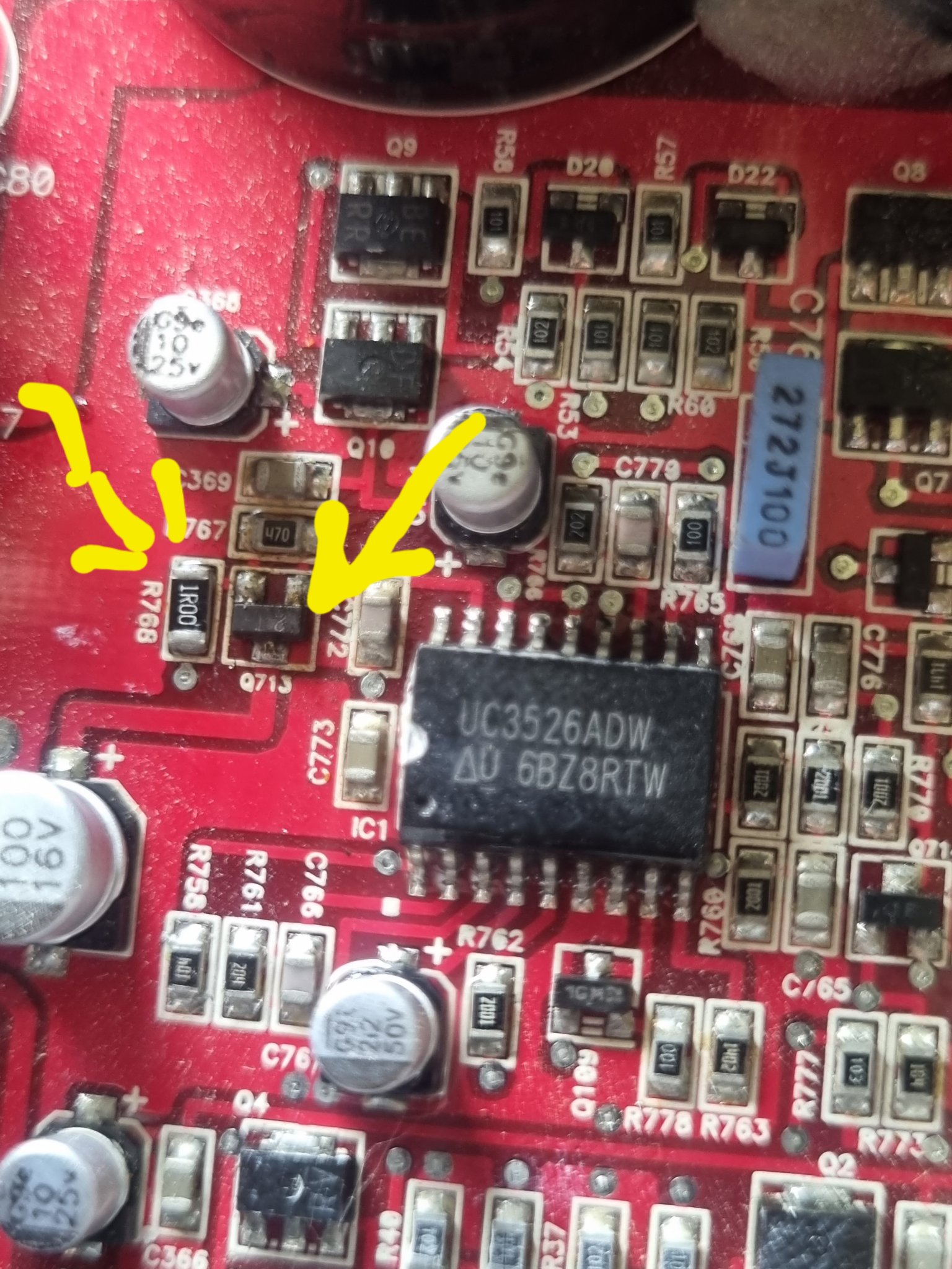

R768 was blown open and Q713 was shorted. Replaced both resistor and just put a PNP i had laying around into Q713.
I don't have a scematic for this amp unfortunately but looking up diagrams for the main chip it does require a PNP in that place
(Disregard the missing driver board im going to replace all the POTS. They broke when disassembly

The rear channels play fine with Q713 removed. With Q713 It won't build proper drive in the power supply.
Front won't work regardless. I suspect it may be due to a faulty POT on one of the cards.

I don't know this board/circuit but that transistor is used to help increase the 5v output current.

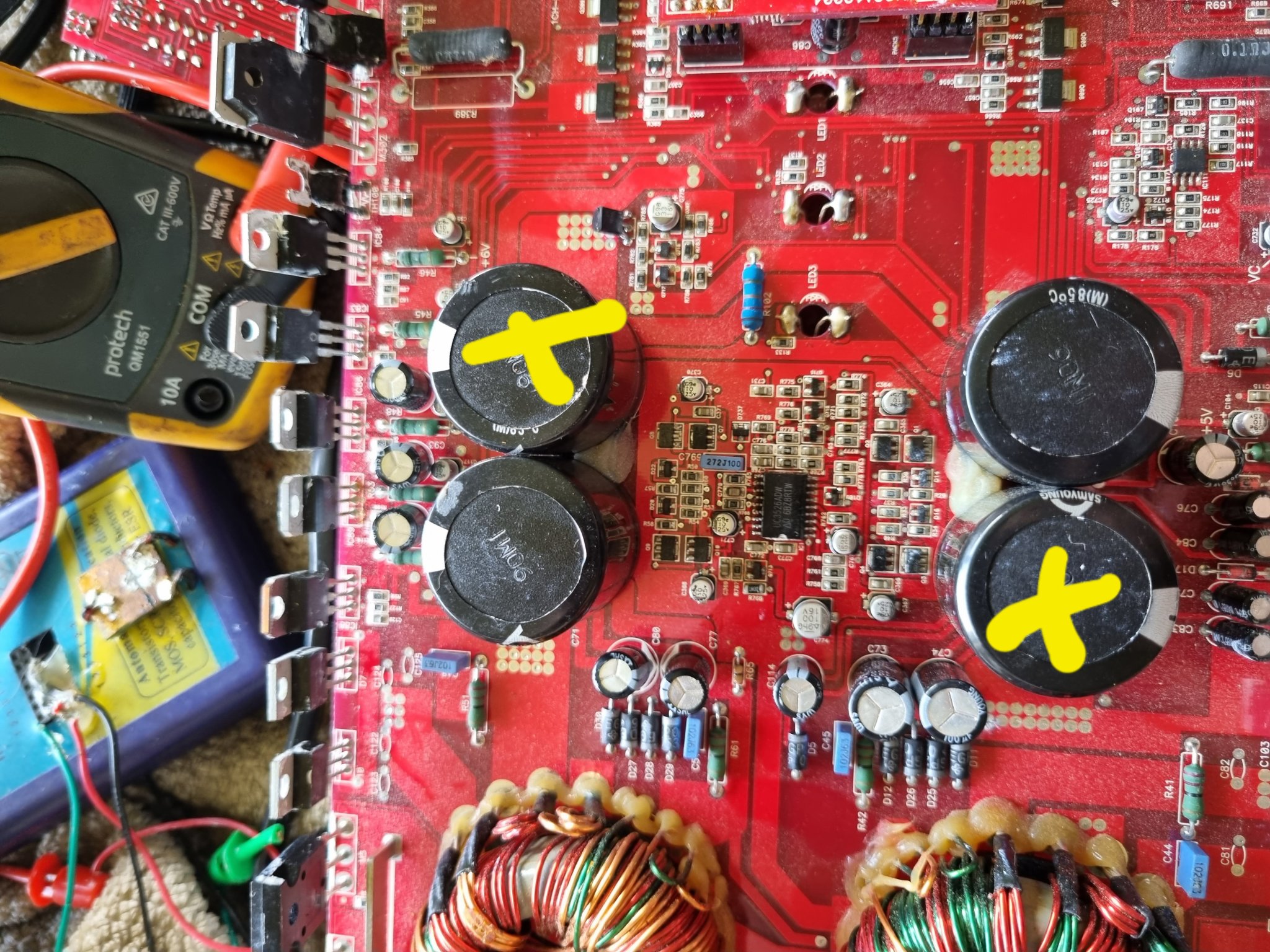

I noticed these 2 rail caps are showing a short. There still in circut and there is voltage in the board. Not sure if that may be causing it.
Do u think mabey one of the 072Cs have gone on the front channel? Seems with that SOT23 removed it works fine. Just nothing on the front channel ever.
