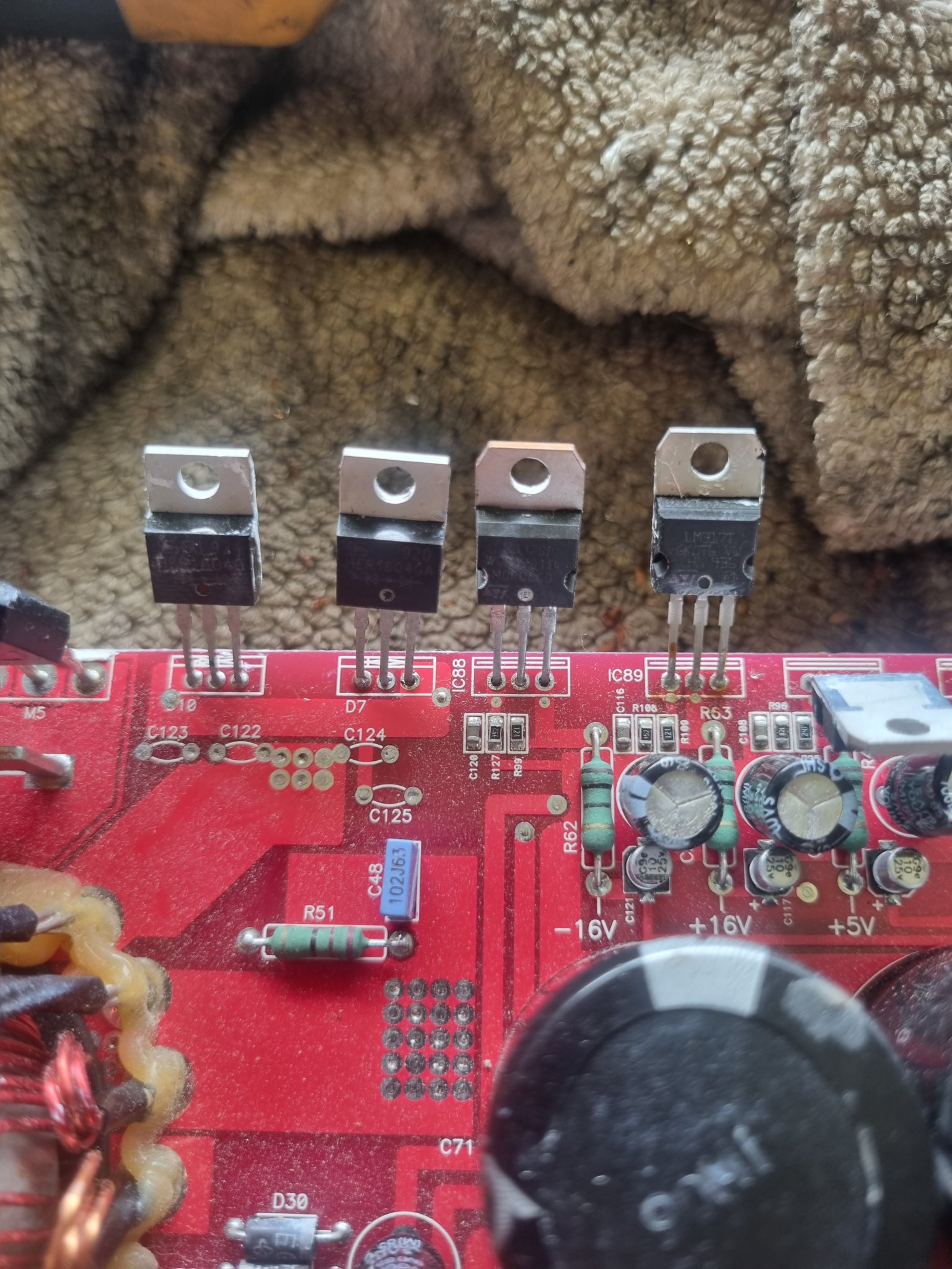

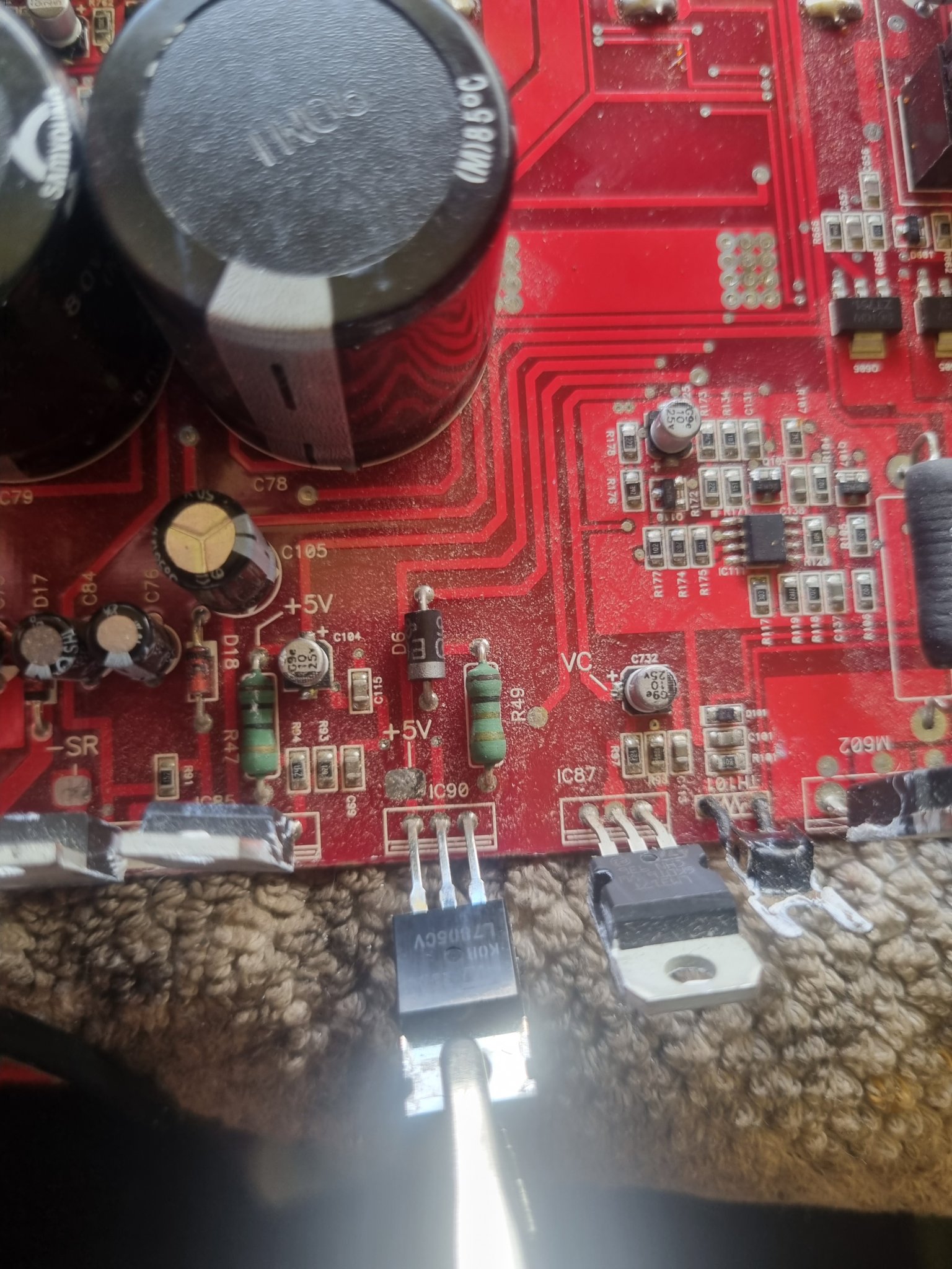

The regulator will only short once I apply 12v remote.

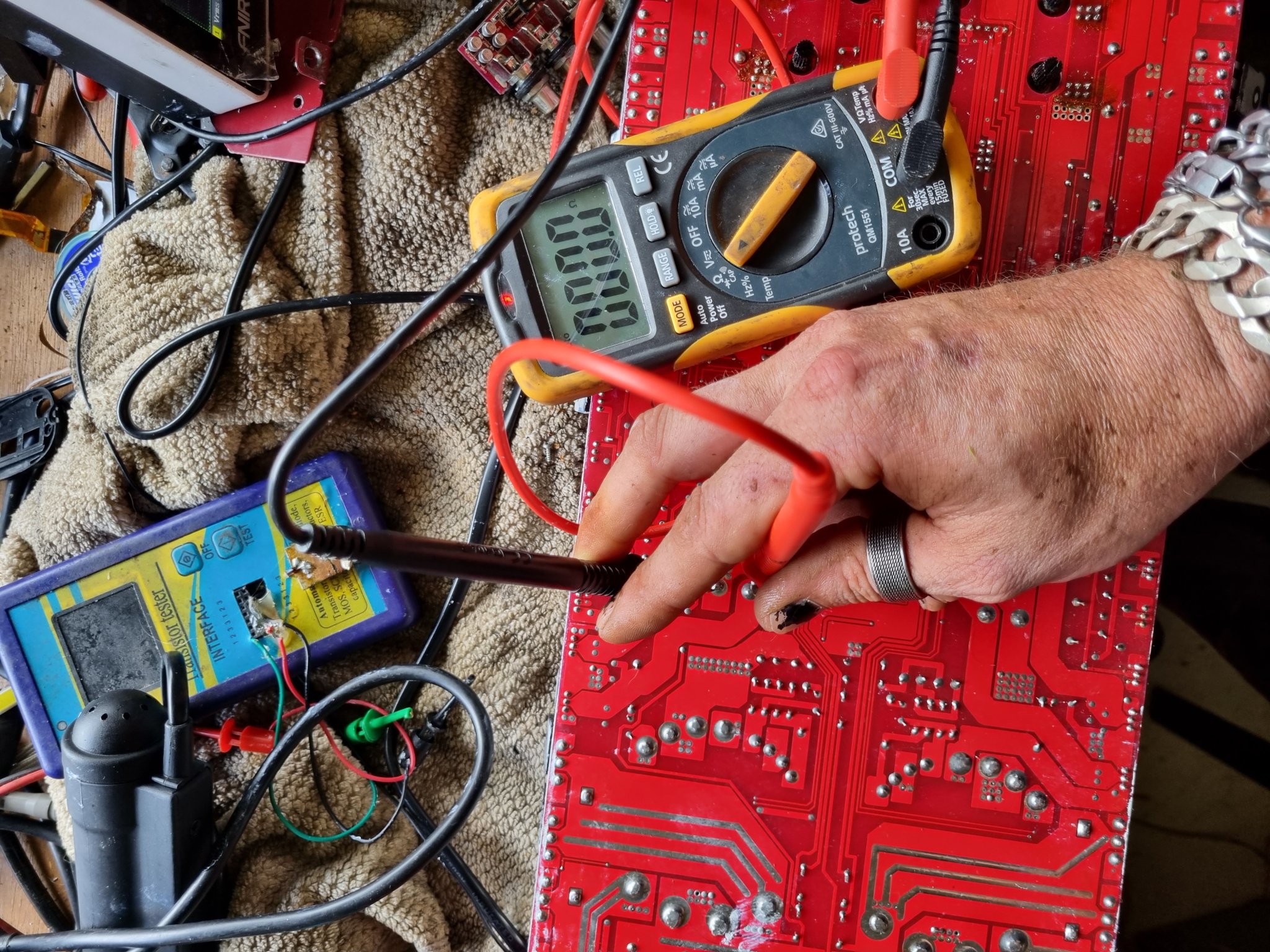

As for the rail caps I'm not sure but here are photos showing they are infact shorted. No volatge in the board when I took these photos and probes were on for a good 40 seconds before taking photo.
Please excuse the horrible photography it's hard to hold probes and take a photo

There is only a short on the rail caps when power is in the board. It appears.......
I just removed the LM337 and my tester is saying it's faulty...
With power in the board I'm reading 38v on all rail caps... so I guess there not shorted....
I'll order this LM33 and see what it improves

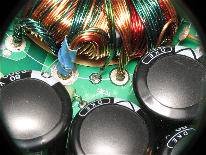

The secondary side of the transformer will be on the audio side of the transformer. The secondary has two bundles of wires of two different colors. Where those two colors are combined is the center-tap.
The attached is not an Orion but it's the same layout. Yellow and green windings on the outside (go to rectifier inputs) and the combined windings, which are the center-tap.

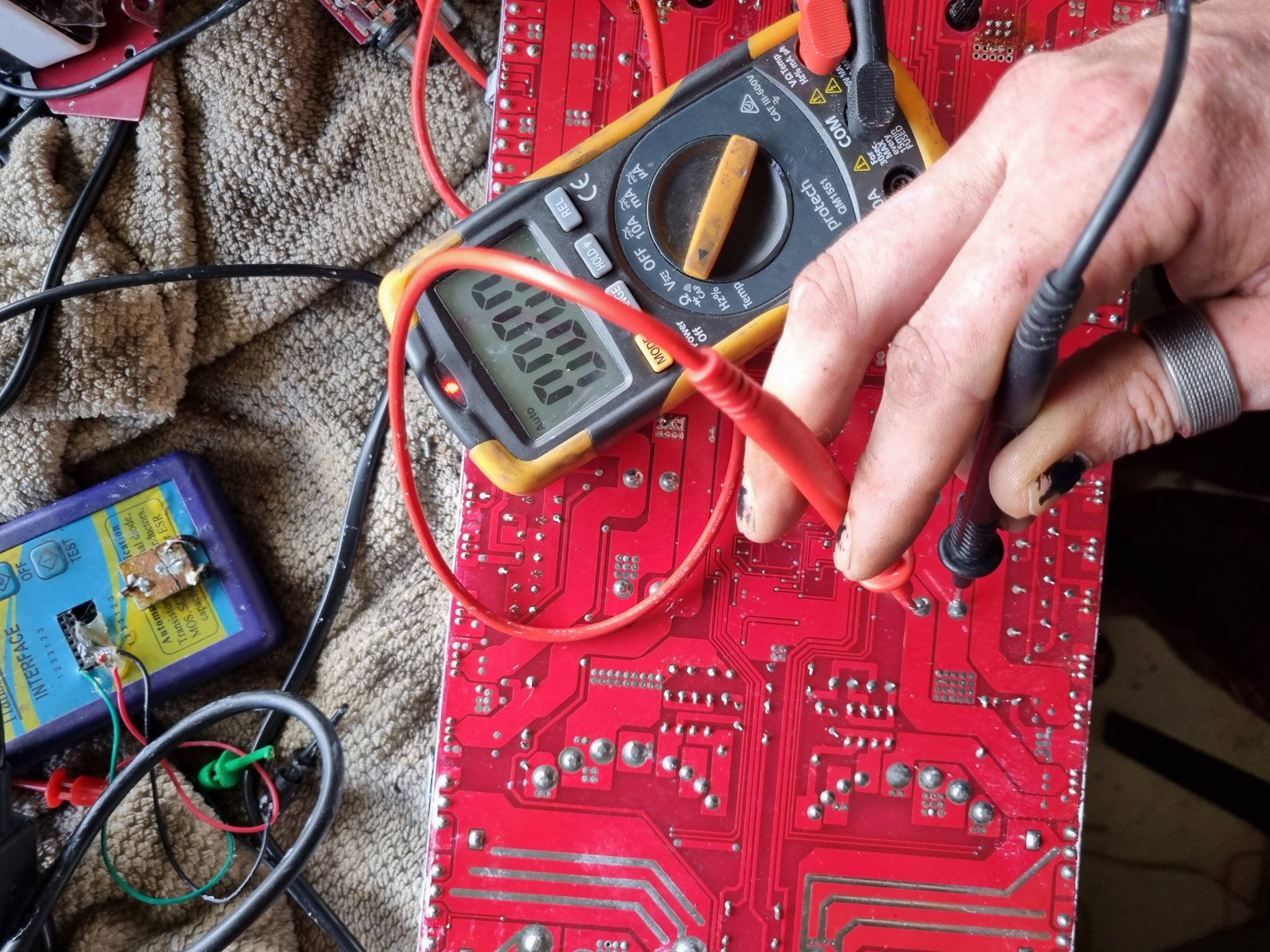

Negative probe on here which is a direct connection to non bridged negative speaker terminal I'm now seeing both plus and minus 38v DC rails. On all output transistors.
I'm seeing what I would suspect as normal (ie) base collector and emmiter I'm seeing 0v base. 38vDC collector 0v emmiter. Or 38vDC base 0v collector 38v collector. So there are no voltages where there shouldn't be. In regards to output transistors
